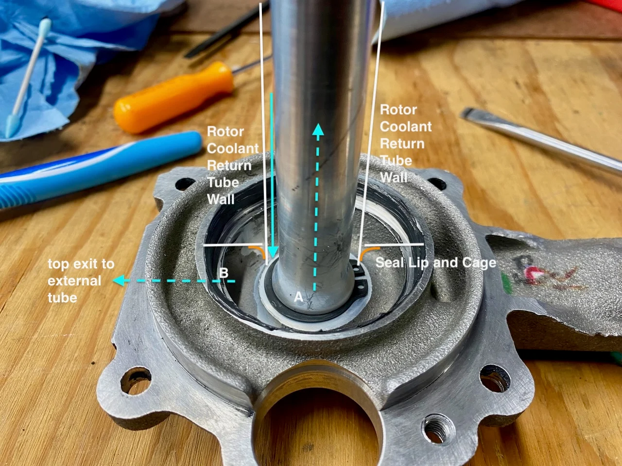

Proper rebuild process+questions seem to be
1. arc spray repair of damaged shaft
2. plating for rust protection, polish to roughness spec
3. unfortunately it seems arc spray shop don't plate, plate shop don't spray (main business is chrome parts to restore old cars)
4. locate a PTFE seal (still impossible seeking traditional high quality brands, so custom made / AliExpress Ceimin)
5. grease? what kind? where? work better with multi-lipped seal?
A lot of variables. Tesla provides no info/parts. Rebuilders aren't disclosing at this level of detail. Just enough to market their service.
My arc spray shaft region supposed to be stainless, I guess question is that enough rust protection? If so does it cover sufficient region for an intended seal? Single lip seal probably doesn't matter. But if Multi-lip + grease in intra-lip cavity is best result, then multi lip is far wider region which may still need plating+polishing to cover the entire region.

Coolant Seal Grease Update
Confirmed with LDU rebuilders they also believe Tesla use grease on shaft and coolant seal during install and its the reason for finding it on speed sensor.
However, many PTFE seal installation guidelines explicitly say clean and dry installation and note grease will ruin the seal. Confirmed with LDU rebuilders they follow these guidelines with good results. My guess is Tesla may use some grease to help reduce chance of lip damage over the leading edge of the chamfer on the shaft (accommodating tech's skill variation?). Most PTFE seal's media facing lip will be ~28mm (or even smaller) depending on profile and will be smaller than the chamfer lead-in tip diameter. It is critical the chamfer's tip is smooth, free of burrs as it is basically the blind PTFE seal install tool. SKF (and many others) provide good summary on the care required on PTFE seal installations. Summary outlines difficult (blind) install scenarios where burr free long lead-in chamfer is required ( https://www.skf.com/us/products/industr ... tions/ptfe )
As a side note, my spray metal repaired shaft has some tiny burrs on the chamfer tip. Close inspect shows the chamfer is likely spray flamed over and polished but leading edge not rounded to remove burrs. Pre spray flame repaired chamfer shows visible concentric machining rings but no sharp edges (all rounded over). These rings are all gone post spray flame repair. Will take it back to rebuilder to clean up the burrs.

Post Metal Spray Shaft Chamfer Analysis
Here is what happens to the chamfer post metal spray
There are 2 problems
- Since metal spray is porous, the chamfer tip is slightly rough unless cleaned up. Ideally, the tip would be rounded off slightly.
- Chamfer is not milled down so the chamfer tip diameter increases slightly. While its small (probably < ~0.25mm) There isn't much margin as PTFE lip diameter are frequently smaller than the opening.
Chamfer tip diameter is now about 28.5mm (didn't measure original)
Ceimin's coolant facing lip ID is 26.5mm. Other seal designs can be slightly larger
Seal lips will slide against this tip during installation. Elastomer seal can handle more imperfections but PTFE's hard plastic like material will micro cut easily with lip profile an additional variable. SFK's PTFE seal installation outlines a "long" chamfer is desirable for difficult (hinting blind) installations. This would have improved the margins on the LDU.
Anyway, very high care and precision work to prepare the shaft and seal for installation. Having multiple shops involved (say metal spray + plate + mill/polish) probably makes it more difficult. Potentially a reason Tesla LDUs use some grease.
For my effort, need to find a way to get a nice smooth rounded tip to avoid potentially damage the PTFE seal's sealing surface on install.
Modifications to the Metal Spray Process
Probably a good modification if possible is to mask off the chamfer (if not damaged) to preserve the original size and finish.

Microscope Closeups of Metal Flame Spray
I'm guessing
- PTFE seal lip will not survive sliding over porous chamfer tip
- pits (or filler) on the finished shaft surface (naked eye see as tiny specks on other wise smooth surface) unknown for sealing performance.
Probably chrome plating will yield better results. Or more likely use speedi sleeve with FKM elastomer seal. Repair shaft to narrow tolerances probably can't be accomplished with regularity.
UPDATE
Spoke with spray flame shop, they use a sealer to fill the porous holes after metal spray. Here is an example
http://diamantpolymersinc.com/thermal-spray-coatings/
https://www.ep-coatings.us/thermal-spra ... y-sealers/
Curing these seems to require 200C heat in above link. My rotor shows signs of baking (some color hues on metal surfaces) and remaining spline grease seems cooked/dried.

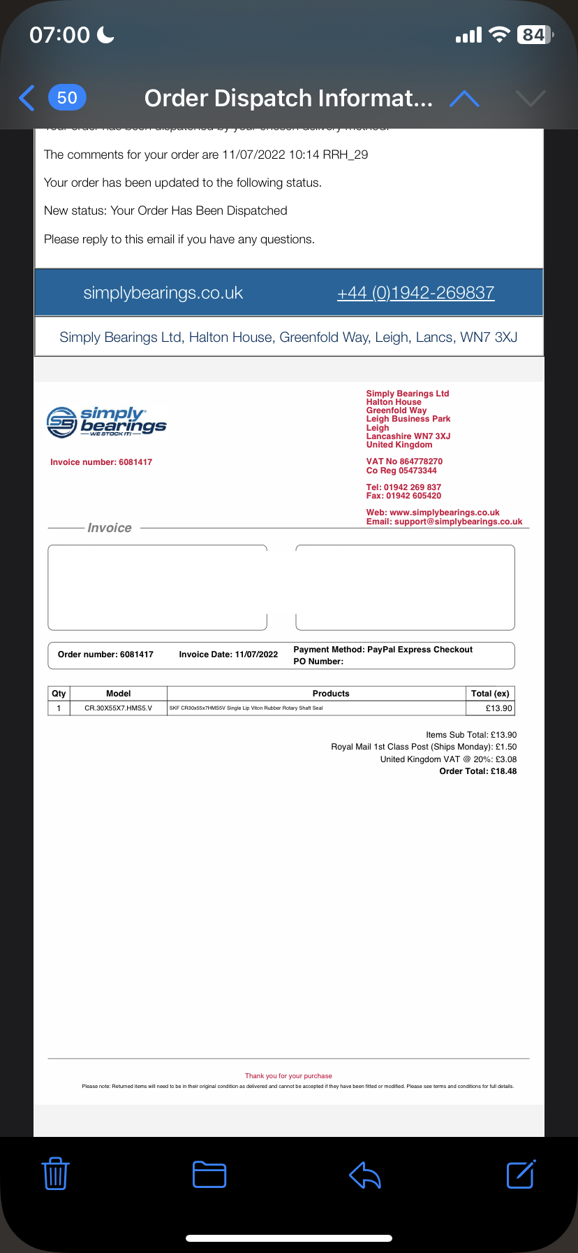

Yes, with this seal (to be used with Speedi sleeve).
SKF CR30x55x7HMS5V Single Lip Viton Rubber Rotary Shaft
Summarized LDU rebuild seal rotor shaft decision choices. Probably 2 main options
- If have pristine rotor shaft surface -> Ceimin triple lip seal without shaft surface prep
- If poor shaft surface -> Speedi-sleeve (with sharp leading edge seal installation protection) + SKF FKM / @muelhpower single lip PTFE
Also noted easy to strip inverter mounting bolts and considerations on refinishing the shaft surface.

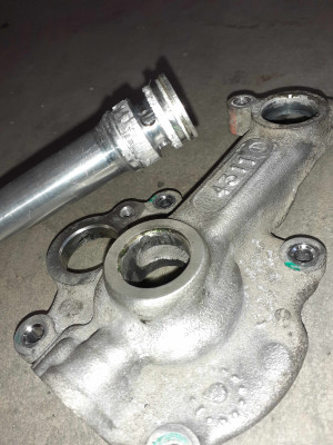

The coolant delete manifold has been found. Looks like its on the latest Rev U LDU. Unfortunately, can't just buy the redesigned manifold from Tesla
https://teslamotorsclub.com/tmc/posts/7898613/
- muehlpower
- Posts: 807
- Been thanked: 186 times

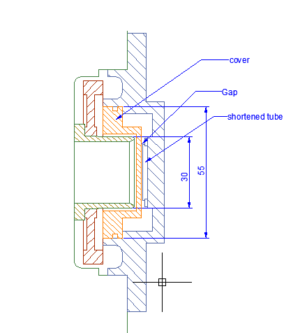

Moodifying an existing manifold should be easy. The tube is difficult to press out, but shortening it up to the retaining ring should work. Then you only need a cover in place of the sealing ring that leaves enough space for the shaft and has a gap to the shortened tube. If the gap becomes too small, a hole can be drilled into the duct below the pipe. I could imagine that omitting the rotor cooling works for lightly loaded engines, but I don't want it for my sport unit!
I think may also need to solve the coolant feed on top of the manifold. That feed is from a hole marked X in the diagrammuehlpower wrote: ↑Wed Nov 08, 2023 1:11 pm Moodifying an existing manifold should be easy. The tube is difficult to press out, but shortening it up to the retaining ring should work. Then you only need a cover in place of the sealing ring that leaves enough space for the shaft and has a gap to the shortened tube. If the gap becomes too small, a hole can be drilled into the duct below the pipe. I could imagine that omitting the rotor cooling works for lightly loaded engines, but I don't want it for my sport unit! Plug.png
So either seal that hole and route coolant externally or cut the external tube and feed it directly from a T junction in the coolant inlet hose.
If the coolant circuit through the 4.5mm hole just blend with the much higher volume out of stator inside the gearbox casing, then maybe this small circuit is unnecessary. But I don't know the circuit inside gearbox casing.
Would be good to have induction motor engineer evaluate the cooling rather than just assume Tesla's design mod is robust.
Also highly desirable to have additional confirmation Rev U LDU comes with coolant delete manifold for both base+sport LDU. Tesla provides no information so best to collect statistics.

It's a reasonable guess that the purpose of that external tube is for air bleeding the circuit (connects to high point of the LDU, moves trapped gasses on), and that it doesn't contribute substantially to thermal transfer.
- muehlpower
- Posts: 807
There is no reason to run anything externally. The water comes from below, flows around the cover and exits at the top as before. Only the space for the gap could become tight, so it makes sense to drill a hole in the channel. The hole would then be where the word "seal" is in your picture.
Ok I understand your proposal. Very nice!muehlpower wrote: ↑Wed Nov 08, 2023 5:39 pm There is no reason to run anything externally. The water comes from below, flows around the cover and exits at the top as before. Only the space for the gap could become tight, so it makes sense to drill a hole in the channel. The hole would then be where the word "seal" is in your picture.
- Remove manifold rotor coolant tube
- Custom cap to insert into coolant seal bore to close off the chamber, cap shaped to avoid touching rotor shaft and provide enough gap to let coolant flow into the closed off chamber and exit top of the manifold.
Internal routing solution would be best as there isn't much clearance externally when removing/installing LDU into Model S rear subframe.
I wonder if any LDU software update is necessary...

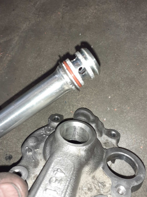

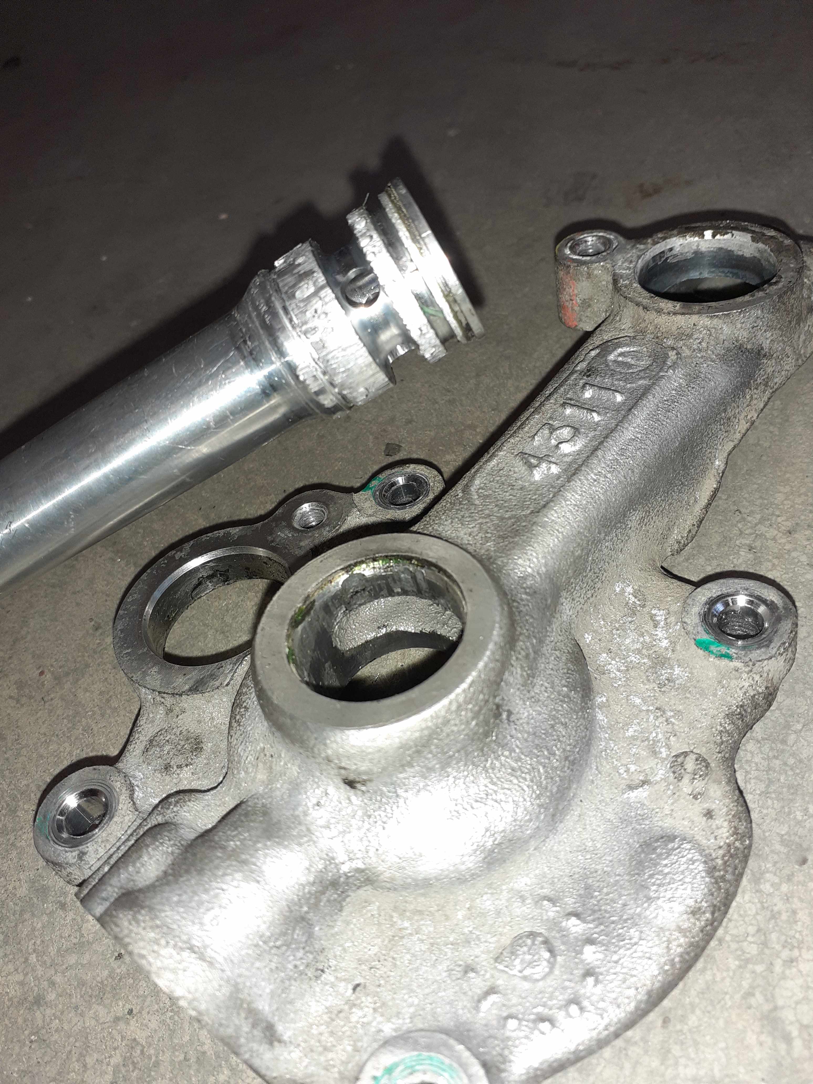

In case anyone has the idea of removing the pipe. I have tried it. It seems to be pressed in and secured with Loctite 271 (high-strength). I welded mine at the end to get it tight, as the bore was very damaged.
