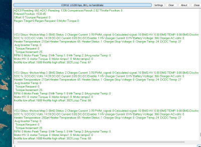

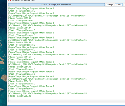

UH! I found out alarming fact!

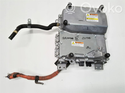

Last year i bought one Outlander inverter P/N 9410A081 in the photo...
I figured it is from 2017 vehicle.
When i was installing it it was in no way different to other rear Outlander inverters.
Now that i have setup VCU and tested throttle i could hear inverter coming online with PWM noise. I see throttle behaving OK.
But i coudnt get it to run in Drive.
So i recorded VCU report:

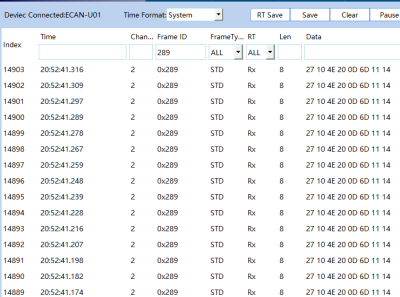

And when i couldnt get anything more from VCU i connected CAN reader and saw 0x289 telegram as it reports status... I immediately saw B7 was not in range odf 00 - 04 but rather 10 - 14! Could there be other differences in CAN reports between inverters? Anyone seen this?

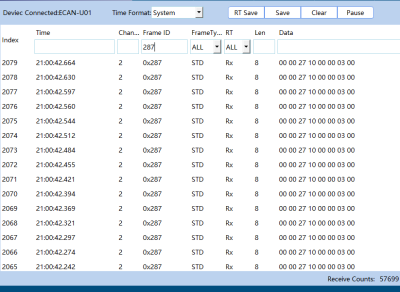

Next i observed the 0x287 command telegram...
I saw that B6 will come online with 03 value whenever i request direction...OK
I see B3 and B4 show 27 10 value for 0Nm
When i press throttle in REVERSE i get motor spinning

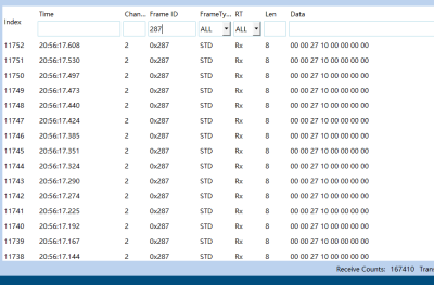

BUT when i tried to do the same in FORWARD i cant get the motor spinning, i only hear PWM hum.
CAN is stuck in 27 10 value!
I suspect this to be a problem with VCU code. But the same code runs in Mazda just perfect. I only used slight differences in transition from drive modes as i dont differentiate between ignition and start inputs, i only have start button.
Any thoughts?
Posted: Tue Jul 01, 2025 10:50 pm
by arber333
I managed to move the car now. Looks like there are some differences in CAN telegrams, but not much and i managed to go through my code and correct some timers so the code would work directly...

Posted: Wed Sep 10, 2025 9:55 am
by akoni
hi all,
just a quick question on outlander motors.
i want to have a manual on/off button
to turn off /on rear motor so that only front motor will run to save battery during slow speed.
what would be the simplest option and recommended option?
thanks
Posted: Wed Sep 10, 2025 10:16 am
by arber333
akoni wrote: Wed Sep 10, 2025 9:55 am hi all,
thanks
My answer in your thread here....
viewtopic.php?p=85965#p85965
EDIT: I would recommend you setup CAN interface to filter 0x287 telegram. This way you can turn off motors at will.
I would propose however to use only rear motor because it is slightly more powerful and rear axle drive usually means better torque use at driveoff...
