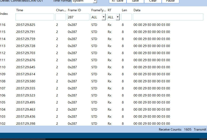

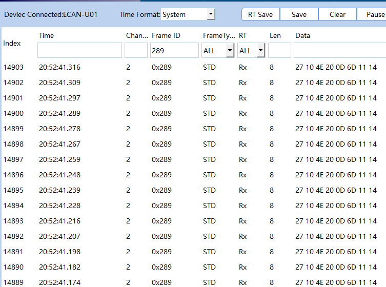

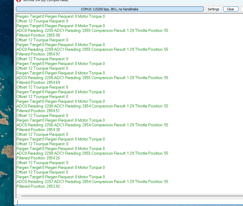

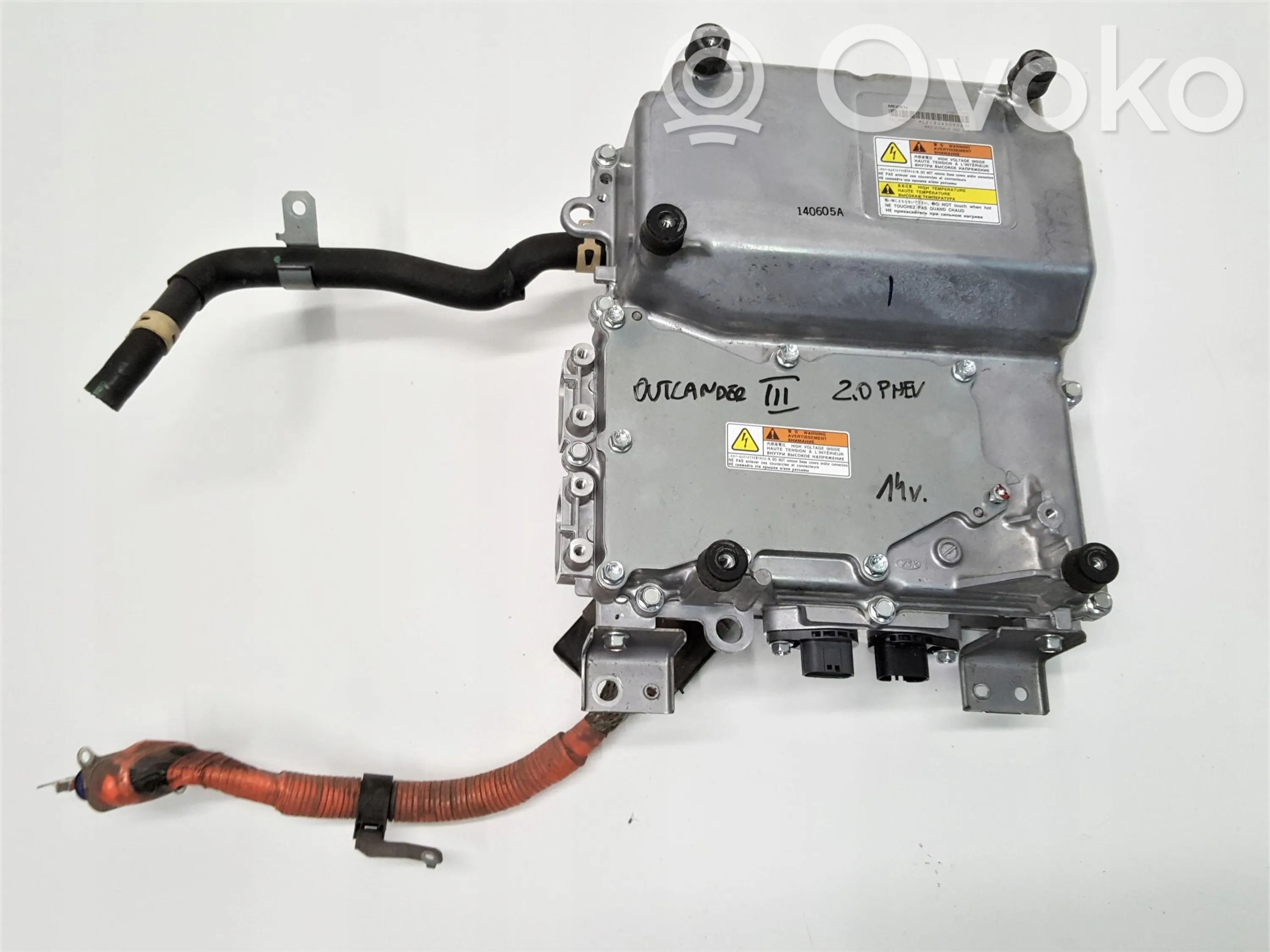

Posts: 3795
Been thanked: 411 times

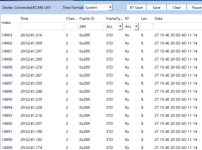

UH! I found out alarming fact!
Last year i bought one Outlander inverter P/N 9410A081 in the photo...
I figured it is from 2017 vehicle.
When i was installing it it was in no way different to other rear Outlander inverters.

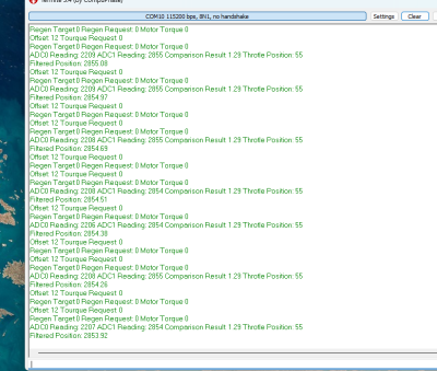

Now that i have setup VCU and tested throttle i could hear inverter coming online with PWM noise. I see throttle behaving OK.
But i coudnt get it to run in Drive.

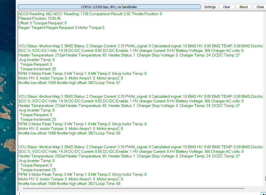

So i recorded VCU report:
And when i couldnt get anything more from VCU i connected CAN reader and saw 0x289 telegram as it reports status... I immediately saw B7 was not in range odf 00 - 04 but rather 10 - 14! Could there be other differences in CAN reports between inverters? Anyone seen this?

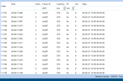

Next i observed the 0x287 command telegram...
I saw that B6 will come online with 03 value whenever i request direction...OK
I see B3 and B4 show 27 10 value for 0Nm

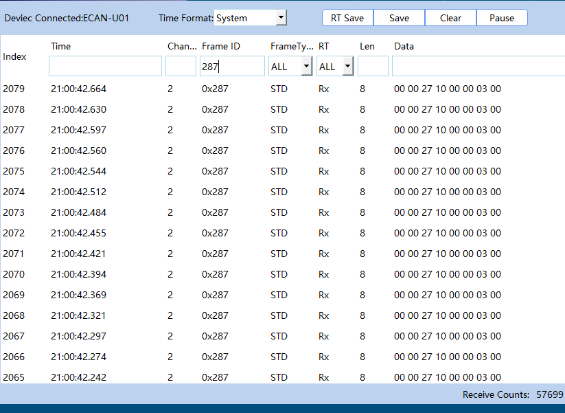

When i press throttle in REVERSE i get motor spinning
BUT when i tried to do the same in FORWARD i cant get the motor spinning, i only hear PWM hum.
CAN is stuck in 27 10 value!
I suspect this to be a problem with VCU code. But the same code runs in Mazda just perfect. I only used slight differences in transition from drive modes as i dont differentiate between ignition and start inputs, i only have start button.
Any thoughts?

EDIT: I would recommend you setup CAN interface to filter 0x287 telegram. This way you can turn off motors at will.
I would propose however to use only rear motor because it is slightly more powerful and rear axle drive usually means better torque use at driveoff...

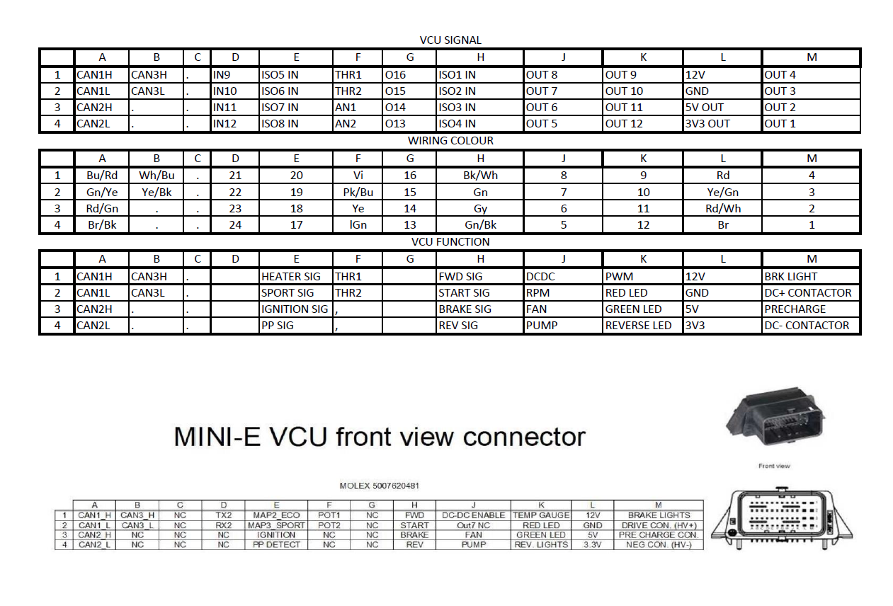

I made my own design now with the same form and signal pinout in mind. That way if i would replace first VCU with my board the thing would directly work with the teensy chip and cable harness. The only difference would be the new expanded input, output pins with two new analog pins.
After i succesfully finished Megane conversion i decided in the future i may need the same VCU type with more input/outputs. There is question to control AC signal to drive AC compressor without internal commands where there may be interlocks that are not bridged and are preventing AC to run because engine is now missing.
I will post the new board on my github...
I recorded my new signals into the original matrix where there were empty pins left.
I am now left with:
- 4 new digital inputs, row D
- 2 new analog inputs, row F under previous throttle inputs
- 4 new digital outputs at about 0.5A capability, row G
Other changes include using NCV8401 protected switch to drive main DC contactors and precharge.
All digital inputs and outputs used are conneceted through ULN2003 SMD chips.
I made provision to use zener protective diodes on analog pins.
I also setup some pullup resistors so some of the input pins could be used to work with active low signals.
Code stil works from the same repository
https://github.com/arber333/Mini-E-VCU
After i soldered the board and added connector i tested it with existing harness on my Megane and Mazda....
EDIT1: It turned out i forgot previous board uses 10K resistor pullups to 3V3 and so i need to change the code to define internal pullups of teensy chip to be used.

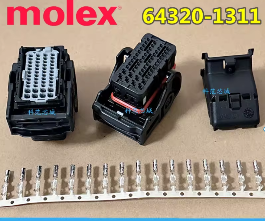

I assembled my own cable using molex connector 48 Pin 64320-3311. After i crimped those pins i needed to position those crimps so the fitting key would slide across pins and lock them in place. This means orienting pins to the side srimped part facing 90deg to the connector.
I could also use preassembled molex connector labeled 48 Pin 64320-3311, it comes with pins or preassembled and i got mine assembled from Aliexpress.
https://www.aliexpress.com/item/1005003 ... 1802LqKvps
