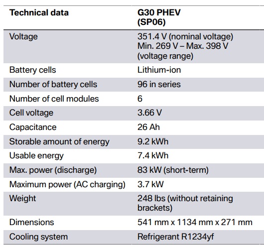

not sure if you follow my [DRIVING]1971 GMCe Lexus GS450H BMW 530e Tesla Model S powered Electruck [FINISHED] build thread but I started doing real road tests and have been reporting the results, I plan on just following the OEM specs
4.1v max is 393 volts some call this 90% charge
3.1v min is practical use that equates to 300 volts, after that the truck becomes a slug
2.8v min I think this is in theory only
RANGE: 34.9 miles
TOP SPEED: 88.9 MPH

Yes I do follow, look forward to you getting some data on current draw especially as I'm considering ditching my leaf and going over to 450h or 300hGregski wrote: ↑Tue Sep 12, 2023 2:45 pm not sure if you follow my [DRIVING]1971 GMCe Lexus GS450H BMW 530e Tesla Model S powered Electruck [FINISHED] build thread but I started doing real road tests and have been reporting the results, I plan on just following the OEM specs
I can't get Damien's S-box code to display the current draw properly while I drive, still working on it
