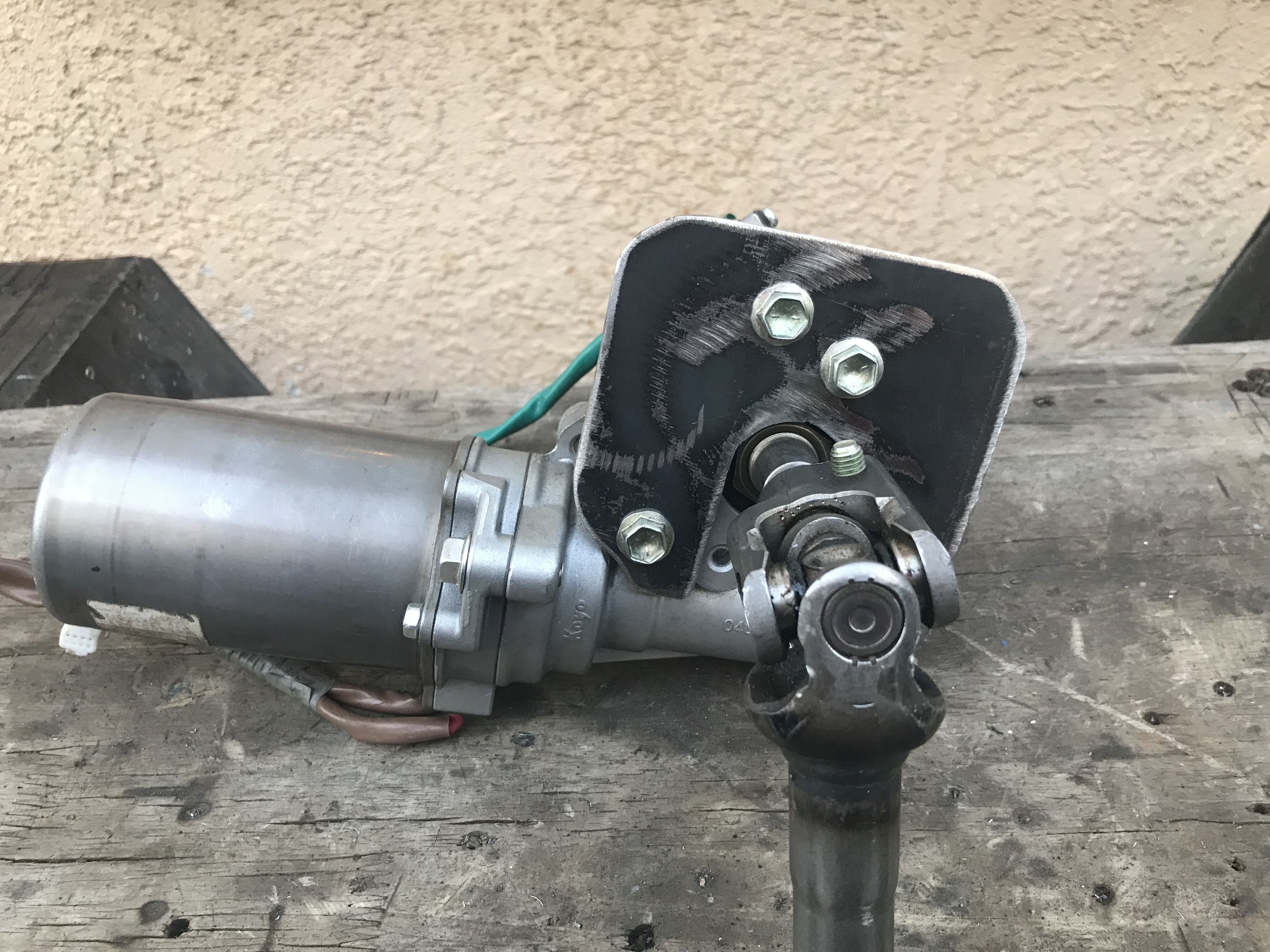

finally settling on making a plate to re clock the pivot bracket (not for tilt per say but to help get the angle during mounting) something to hang it up with sorta speak

so let's adopt this to that, as I am sure Grant makes an adapter for their Hot Rod wheels to a Prius for sure, but going that route would be cheating
I know right?! four spokes, chics luv four spokes!
oh that's cute, Grant is using metric hexeseseses so my 'merican ones don't work, great!
so how do we adopt this to that?
hmmmm, two holes align...
time for the plasma cutter
like a surgeon

ah, it's temporary

and the problems kept on coming
my rod was too short [where have I heard that before?]
this is just a mock up

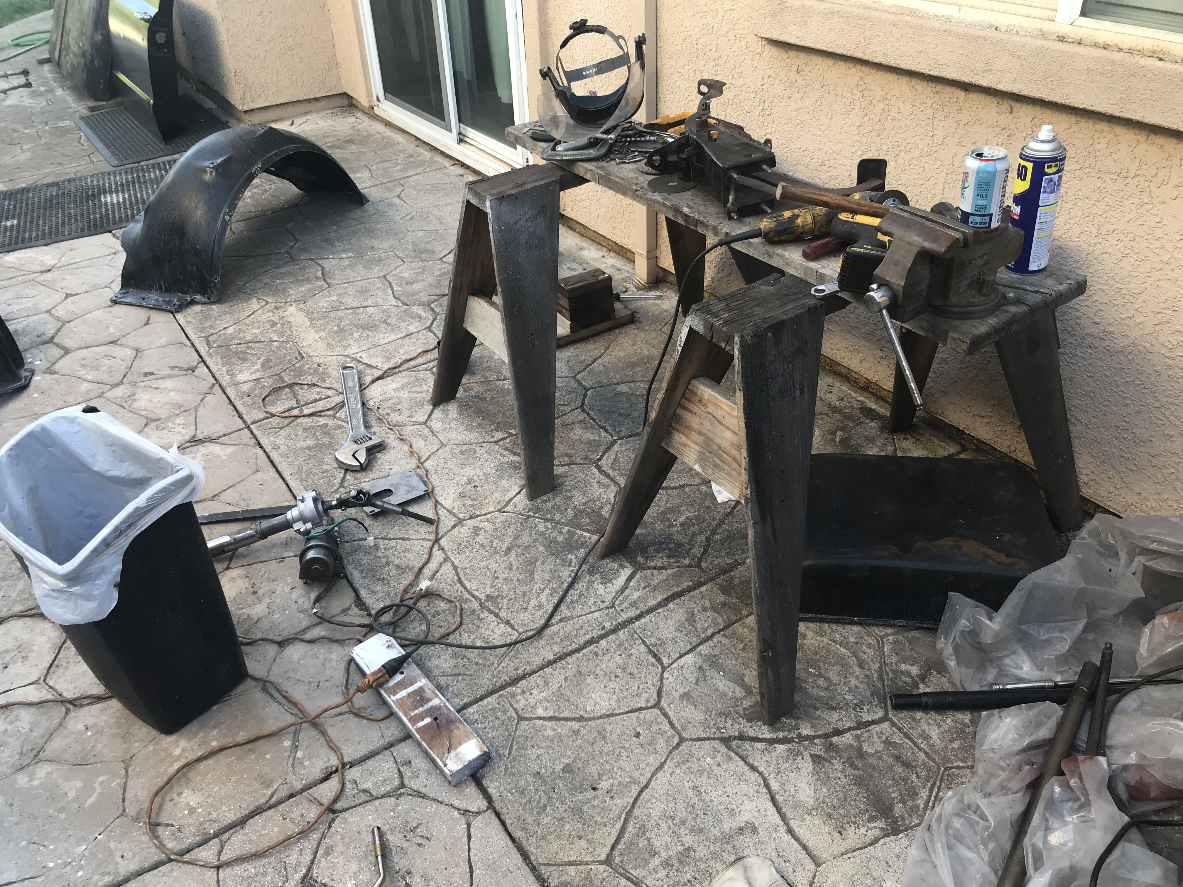

anyways, so I cleaned the garage yesterday and found this:
I believe it's called a "floor"

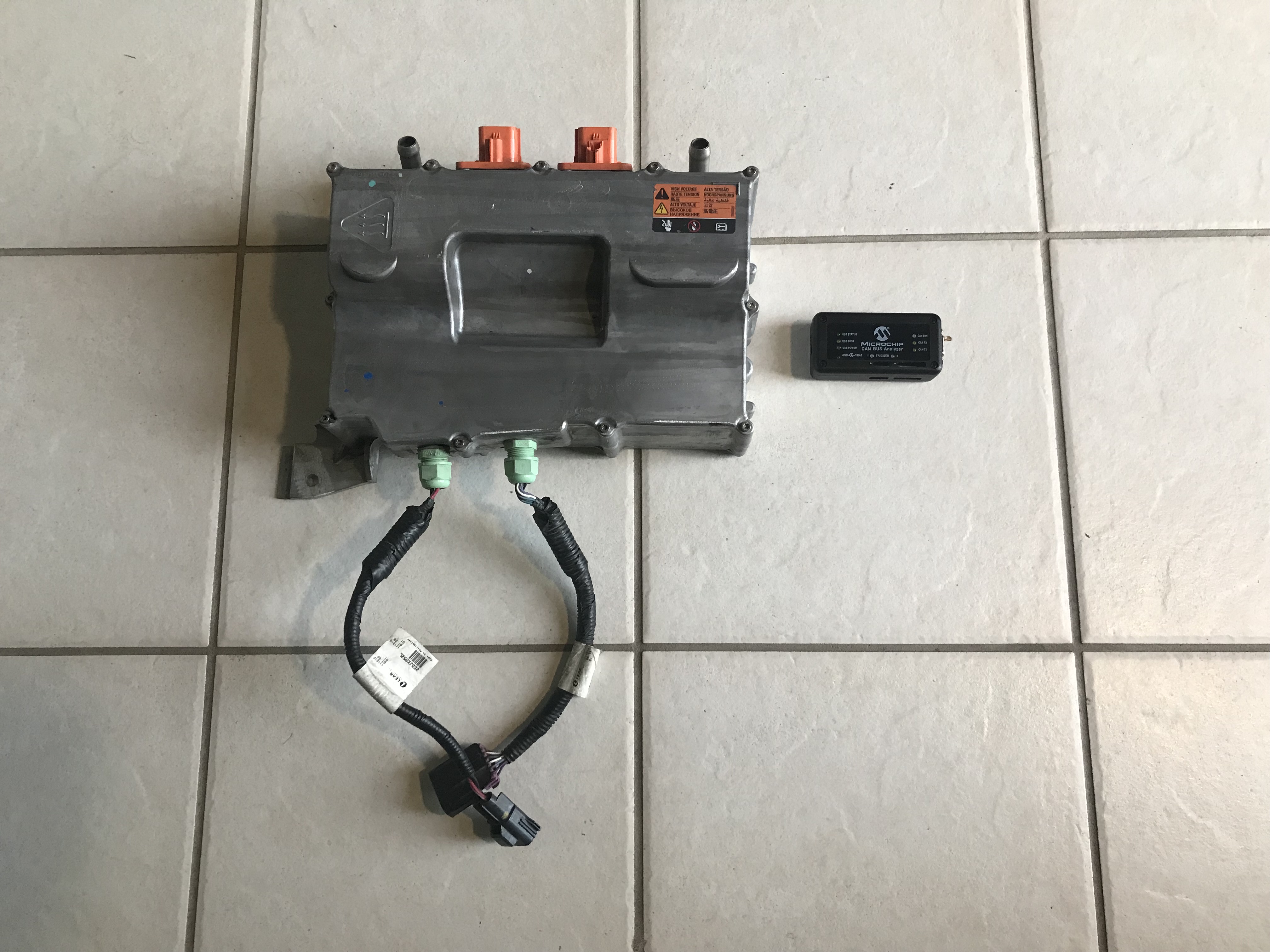

so it's time to fandangle with the Chevy Volt onboard battery charger, I put it off long enuff
my logic went like this, hey you're converting a Chevy truck, wouldn't it be cool to use some electric Chevy parts on it...

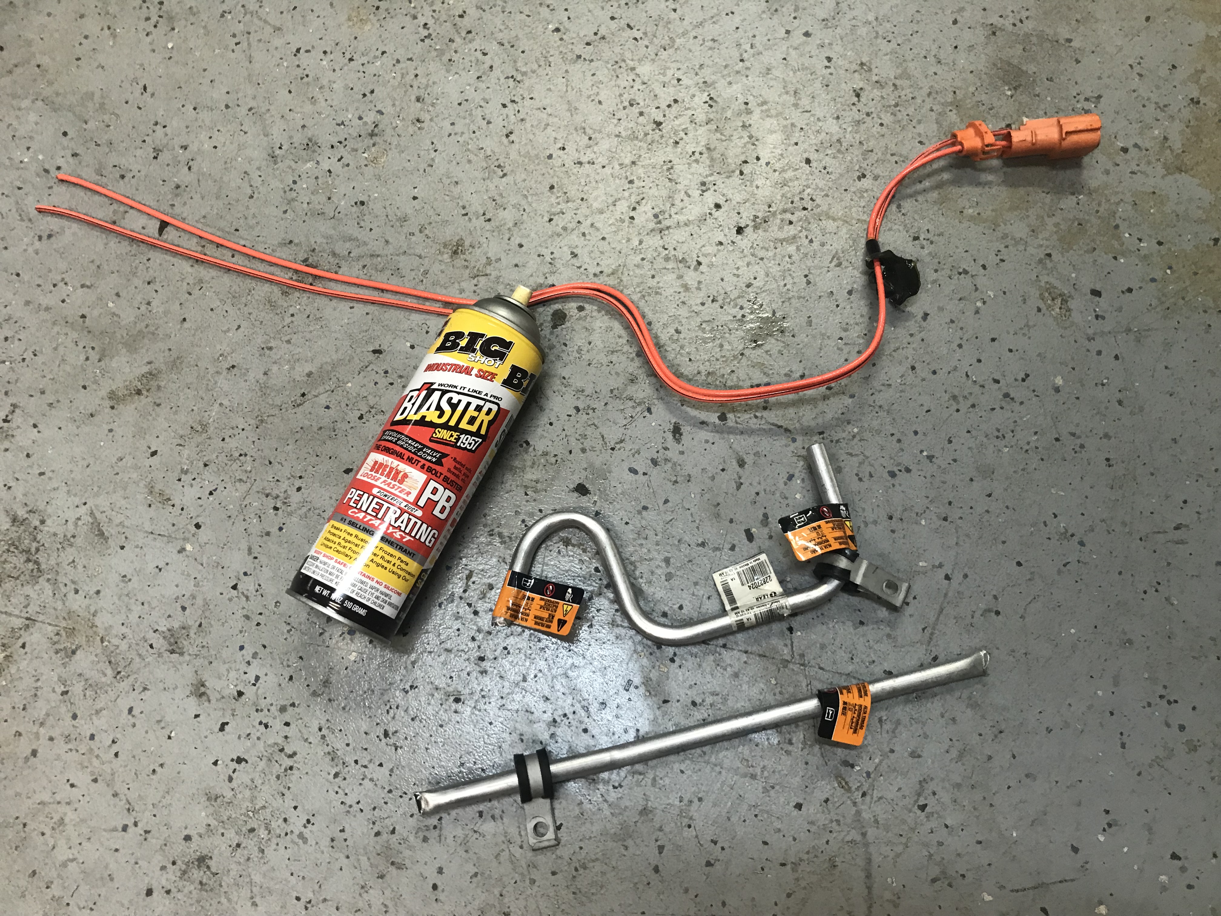

Posted: Sat Apr 30, 2022 3:16 am
by Gregski

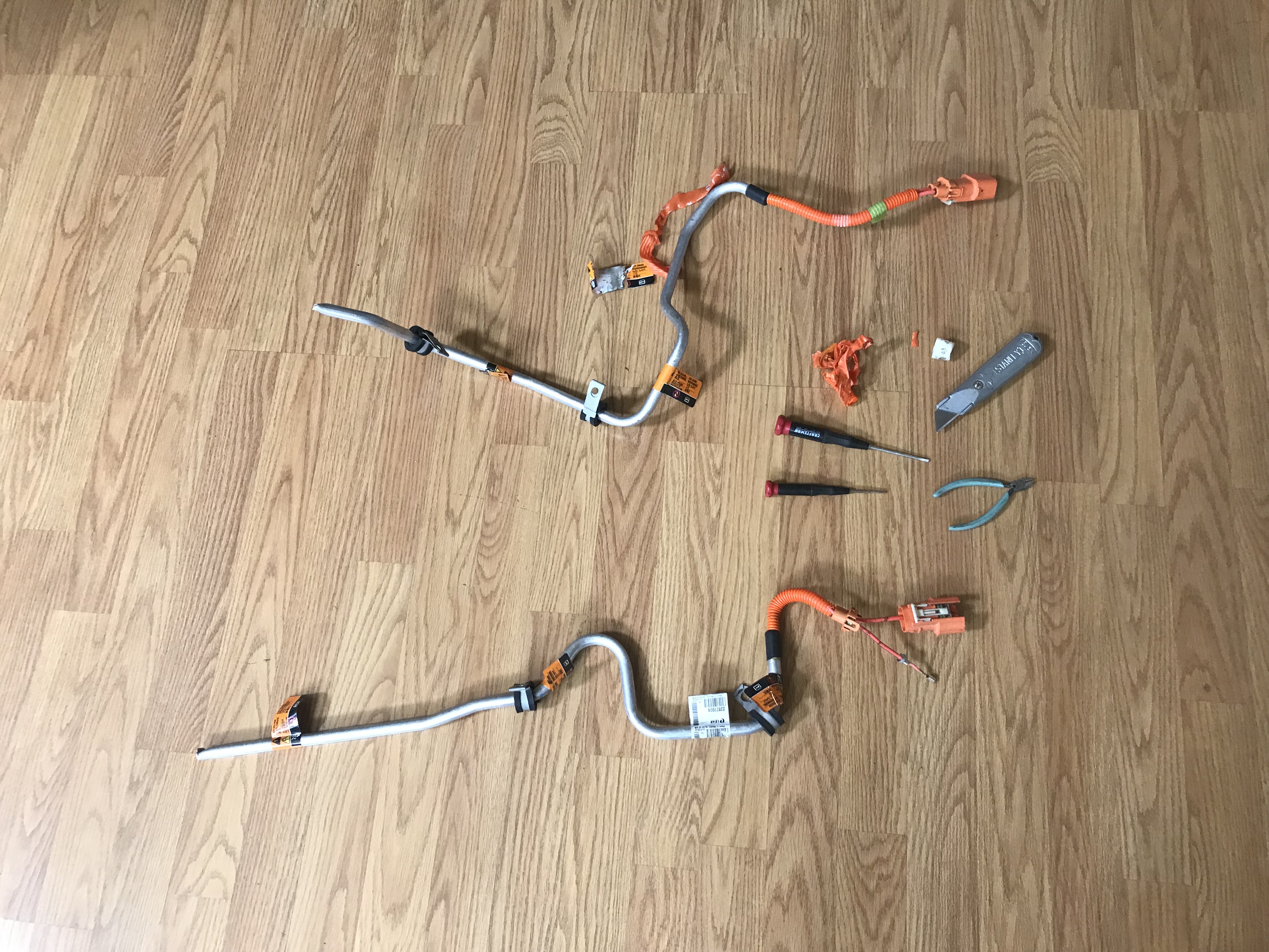

this thing has more tantacles than a Syberian octopus, so we start with the one that runs from the onboard charger to the "traction" battery
traction is just a fancy way of saying the big high voltage battery pack
this thing is incased in an aluminum pipe for you know Armageddon
Posted: Sat Apr 30, 2022 3:18 am
by Gregski
I wasted many a beers trying to unpin that thing, as it proved futile, so I cut it in half and will offer 50% of the cable to the highest bidder, or the best dirty joke muszyngr at yahoo dot com

looks like the Barberians cut the proximity wires from the charge port, so I chased those down
Posted: Sat Apr 30, 2022 3:24 am
by Gregski
and lastly I divorced the 12 volt battery leads from the CAN control side wires
Posted: Sat Apr 30, 2022 12:59 pm
by Gregski

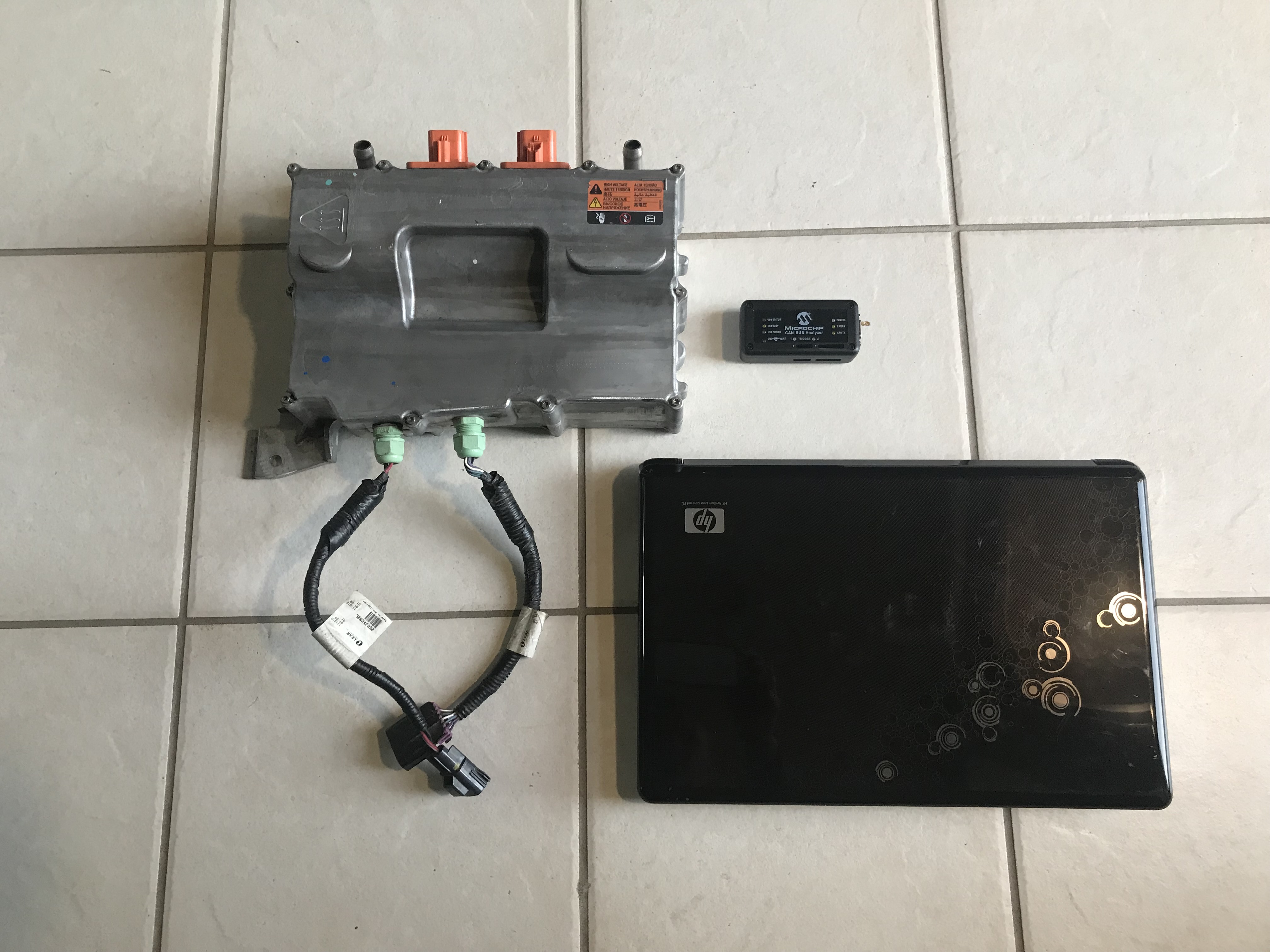

so then I hooketized it all...
Posted: Sat Apr 30, 2022 1:01 pm
by Gregski
and quickly learned that my trusty and very pink CANalyst-II gizmo CAN Bus reader tool is NOT the tool for the job to control aka send CAN Bus commands to the charger, yes it reads them, and yes it can pretty much send one command at a time, but not multiple ones at once type of thing
File that under Lessons Learned

at this point I was having so much fun I decided to do a little tutorial write up where I document my failures in public in a thread entitles: I think I CAN, I think I CAN...
Posted: Sun May 01, 2022 4:52 pm
by Gregski
armed with another CAN Bus analyzing tool, let's see what this MICROCHIP can do, it's black so it's gotta be good
