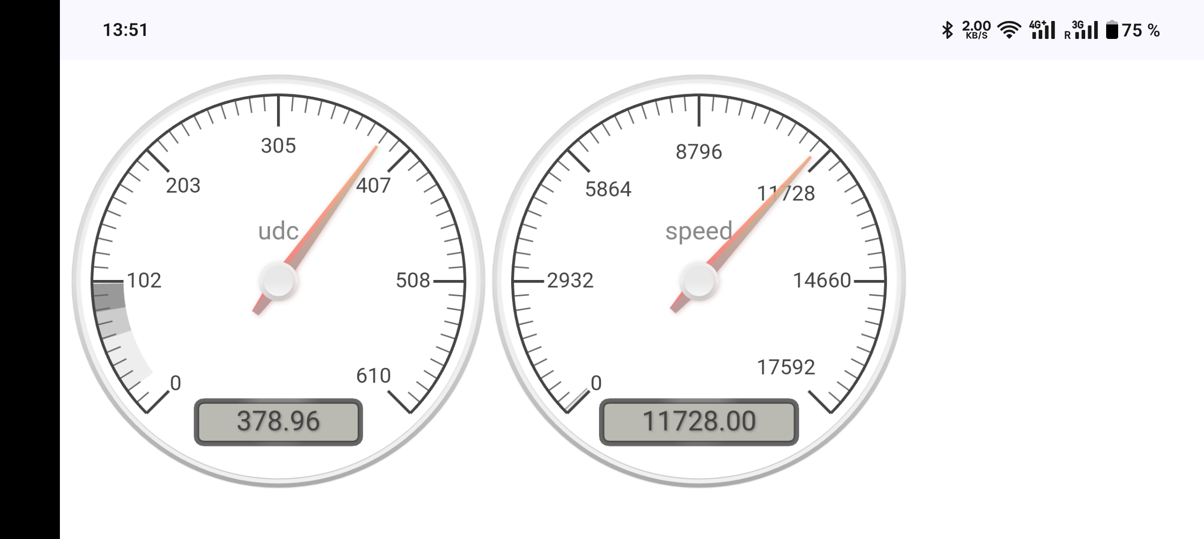

Hi. Yes, there is one significant edit. The HV signal must go through a divider of two 3.3 kOhm resistors. Otherwise, the level becomes too high after about 330 volts and the v3 board is not able to fully measure.
I soldered two resistors directly at the input of the measurement wire, through one signal itself, and the second from the entry point to the ground.
