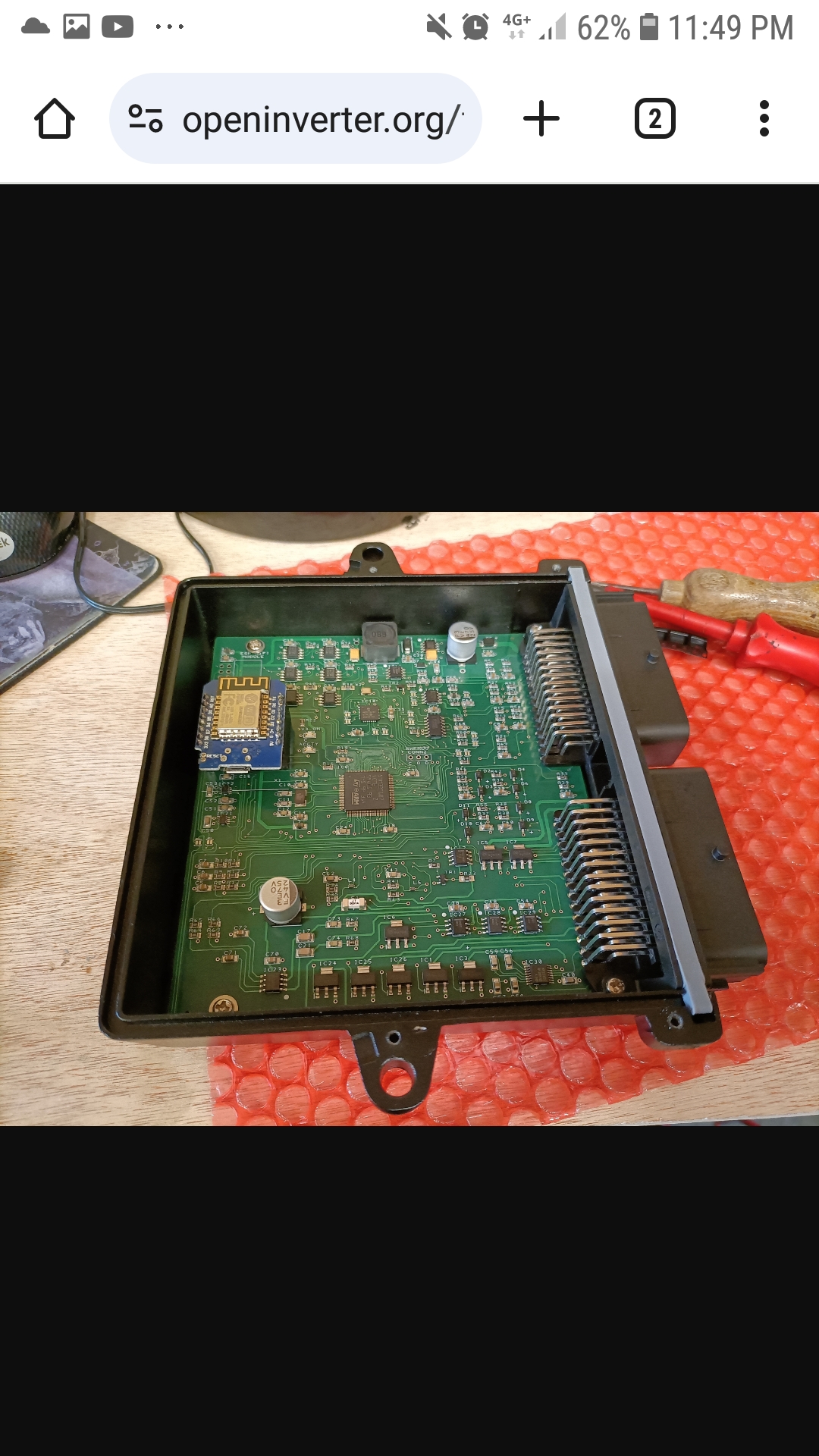

andybpowell wrote: Thu Oct 05, 2023 3:03 pm My Zombieverter arrived a while ago and now that the connectors and case have arrived I've got it all built up and tested and ready to go
Hi, on a search for which way up or down for the wifi board... and thank you for having this helpful picture,
I guess somewhere there is instruction, vid, I found one on the smaller red wifi board, but not the blue one you have.... Where abouts did you find the assembly info please... have received the Zombie board, and keen to get to next step... Thanks

viewtopic.php?p=69998#p69998
Have found the relevant assembly information,
Looking for ZombieVerter as one word helped,

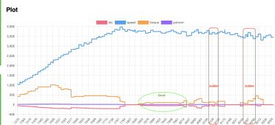

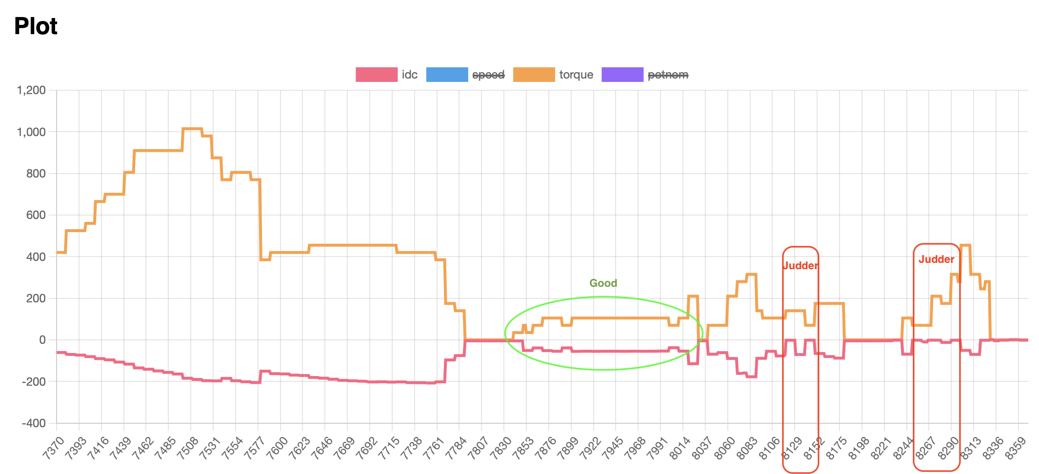

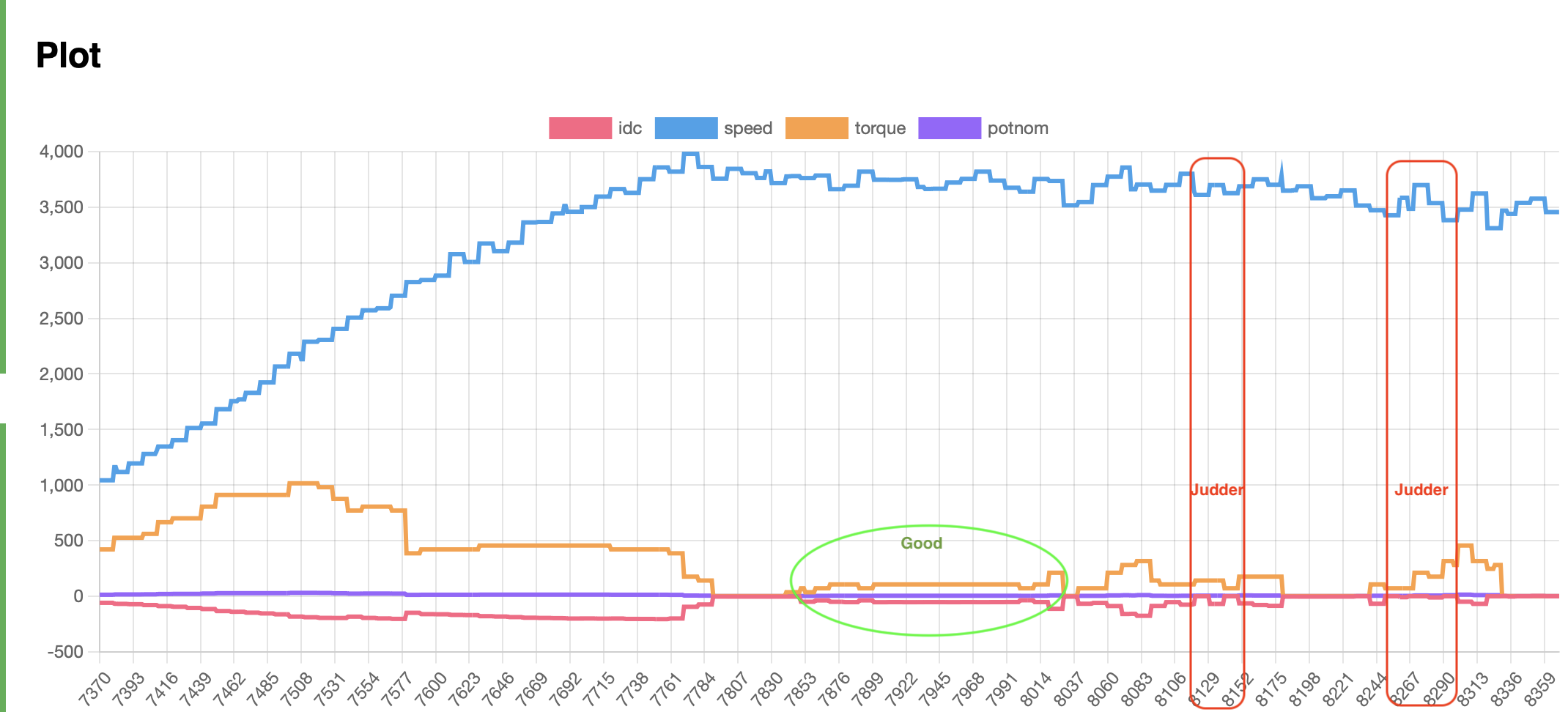

Hi Andy. I have some data to support your findings.
I'm using a gs300h inverter with a gs450h transmission. Zombieverter using GS300h settings. Voltage around 330V
When holding the speed constant and mg2 speed is around 3500rpm, after a few seconds I get juddering.
Steady speed judder
Steady speed judder
Zoom
Zoom

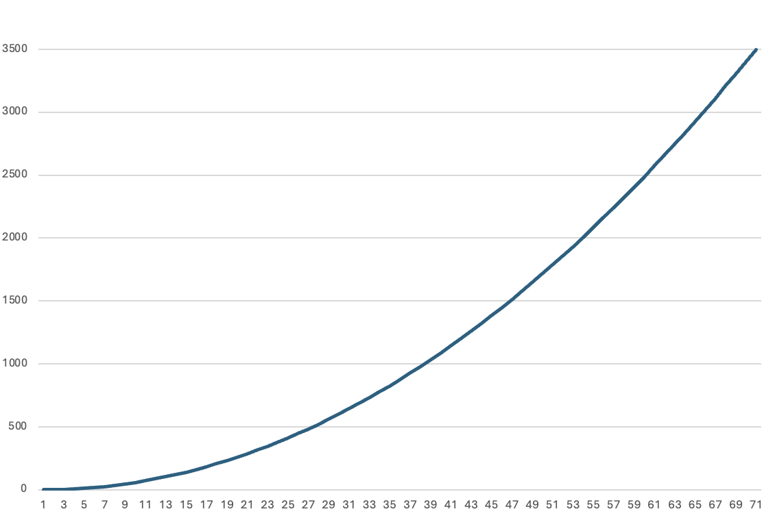

I'm currently using a non-linear throttle ramp as suggested by EV8. The behaviour is exactly the same
Non-linear throttle

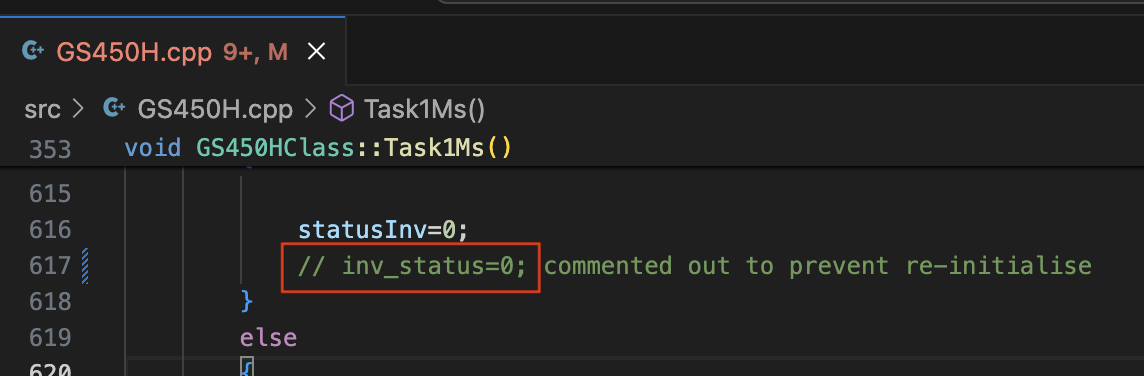

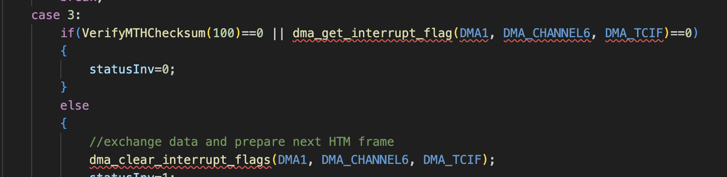

I found a workaround for the juddering that I was experiencing. I did a 30km test run at between 80 and 110km/h.
I logged the serial data going to the inverter (HTM) and noticed that the inverter is re-initialised when the juddering occurs. I assume the checksum ==0 because of noise on the line which then resends the 6 lines to initialise the inverter.
I commented out this line and now I have no more juddering
GS300h code
GS300h code
I compared the code with the GS450h code. The GS450h doesn't have that line of code.
GS450h code
GS450h code

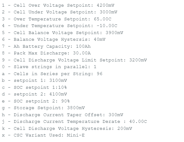

nkiernan
Posts: 589
Has thanked: 514 times
Been thanked: 95 times
Re: [WIP] BMW Z3
Post by nkiernan »

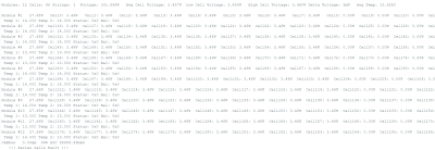

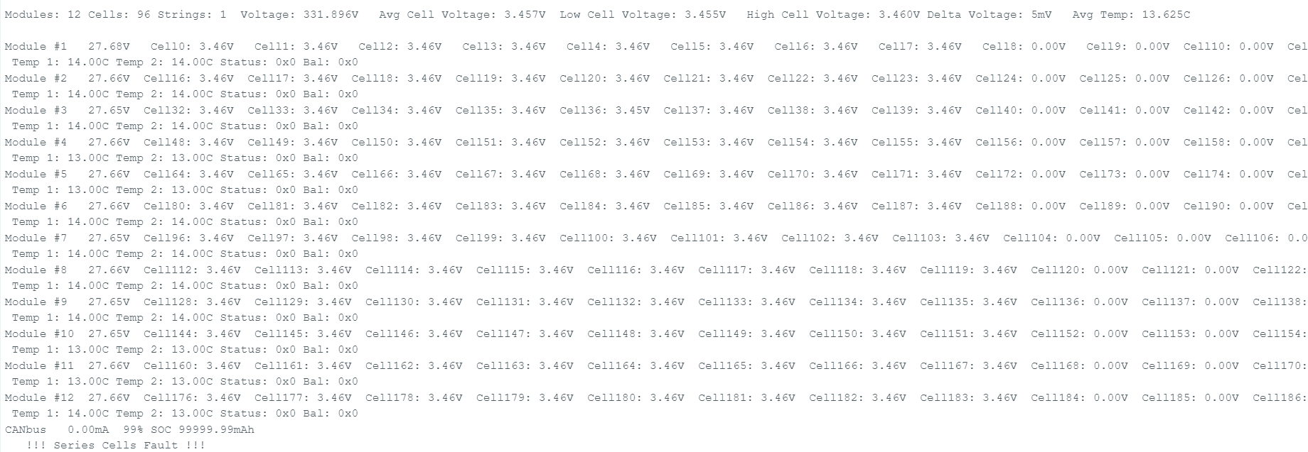

andybpowell wrote: Thu Mar 14, 2024 11:21 am had a quick look from what i can see it looks fine no idea about balancing though
Hi Andy.
In one of your previous posts you had a screen shot of the Simp serial output and it correctly showed the 96 cell voltages. Mine is trying to show 16 cells per module for the 12 modules, so getting a series cell fault. I've tried some different settings for cells, strings, csc variant. Wondering if you have a chance if you could snap your Simp settings, I might see what I'm missing! I have the X5 edit for the 12 modules already.
andybpowell
Posts: 334
Location: Southend,essex,uk
Has thanked: 219 times
Been thanked: 257 times
Re: [WIP] BMW Z3
Post by andybpowell »
nkiernan wrote: Sun Jun 16, 2024 6:52 pm Hi Andy.
it's been a while since I looked at it but vaguely remember a similar issue have you tried the i3 csc
