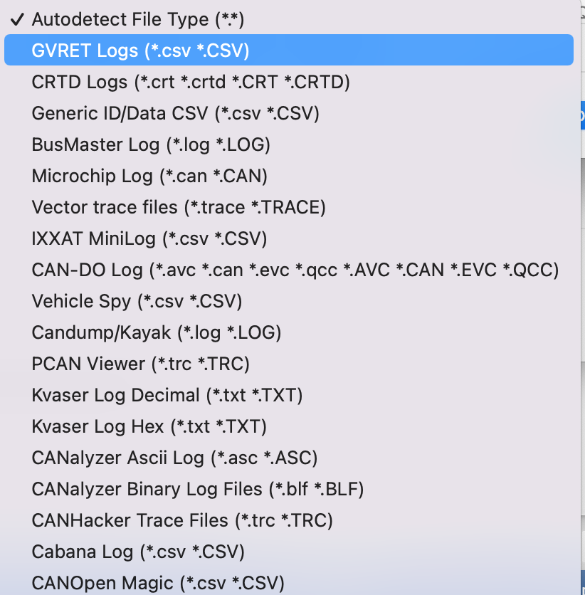

What was that logged with? doesn't open with savvycan

Damn, Savvycan doesn't seem to support that format. I tend to like using it to decode with a DBC and plotting various values.
Can it it export into a Savvycan supported format?

The software supplied with this tool doesn't allow opening files so I'll have a go at capturing using Savvycan.
Been a while since I touched it.
