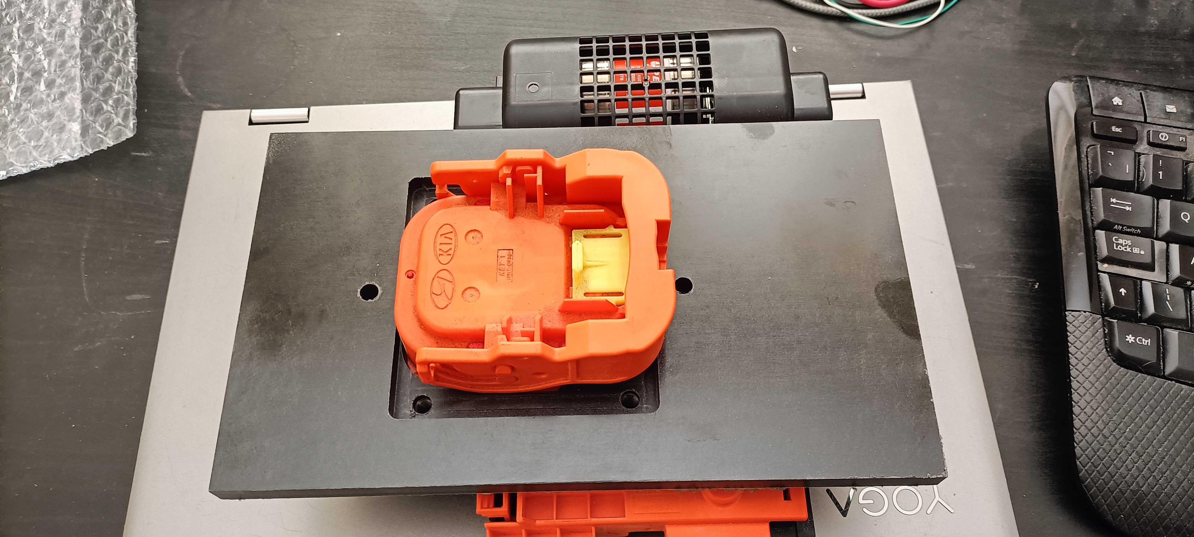

My Z3 is pretty much off the road for now as the extremely harsh power delivery makes it hard to drive safely and will tear out my bushes some of the updates in the Zombie pipeline should relieve or hopefully fix this issue so I'm doing the jobs I put off while evaluating the feasibility of the 300h which I think we can all agree has been decided as a yes it is.
My rear battery box only has a fuse, no contactor and no safety disconnect the contactor I have and is a simple fix and I have purchased a kia niro (I believe) safety disconnect which also contains a fuse, the only issue with it is that the fuse sits about 10mm higher than the mountings for the disconnect
So I made an adapter to allow me to mount it flush with the top of my rear battery box, since I dont have a 3d printer or the cad skills required I made it using my CNC mill which was probably a lot quicker than printing anyway
I also need to tidy the wiring and plumbing
