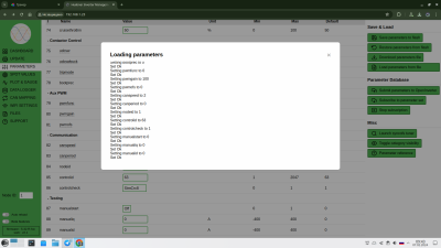

The interface is working... but there is a problem with downloading the parameters file! when uploading, the transmission fails at the end of the parameter list. Have you tried uploading a parameter file via the interface?
Re: ESP32 Based Web Interface & Data Logger
It is necessary to fix something in the code ((( according to the test results, this gadget cannot be considered fully functional.

I have to test parameter upload. What other issues did you find?
I was assembling this interface for use with your 16-channel bms. the delivery turned out to be long and I decided to connect the interface to the version 3 board. the general conclusion is unstable operation, hanging, breaking of messages. …

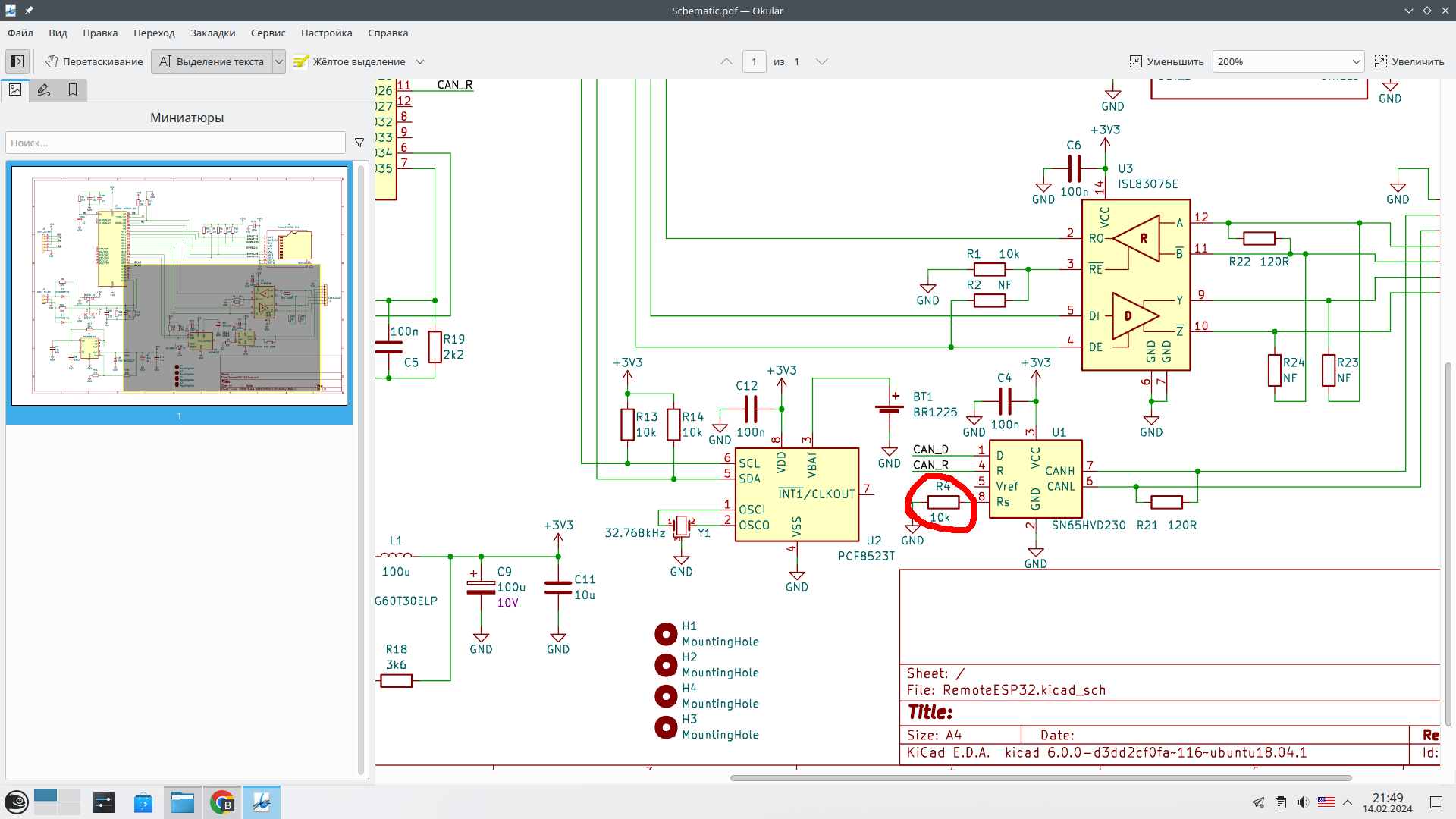

I have used the gadget some more. I found that R6 is way to high at 100k! That disturbs CAN comms. Either bridge it completely or replace with 10k. This must have been the reason why it disturbed the bus in my car.
Also it only downloaded the parameter json partly and that led to errors in displaying the CAN map. Please retry.

Exactly! On the CANLite that I based the board on that you can buy in the shop it is 100k

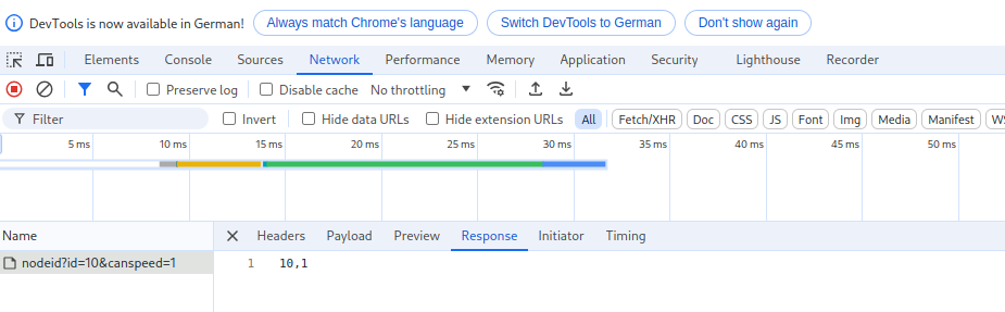

Hello,
I just installed the latest version on my esp 32 can lite module so now i have the button to change the CAN speed just under the node ID, amazing.
Problem is that it seems to not work, as in the can speed doesn't change when i change it on the button. regardless of the can spee displayed here the web interface remains with what it was initialised with ie 500kbps.
so i can't change the can speed of the focci box to 250kbps and then change the can speed of the web interface to 250kbps. I've tried to change the default speed in the code of the web interface to 250kbps only to discover that it still doesn't work.
by it doesn't work i mean that the web interface isn't comunicating with the focci box.
HW V4.5a
What am i doing wrong ?

Have you also updated the ESP firmware or only the web files?
When you open dev tools (F12 in good browsers) you should see the request going out and when selecting it and viewing the response should see something like this So two comma separated values, not just one
