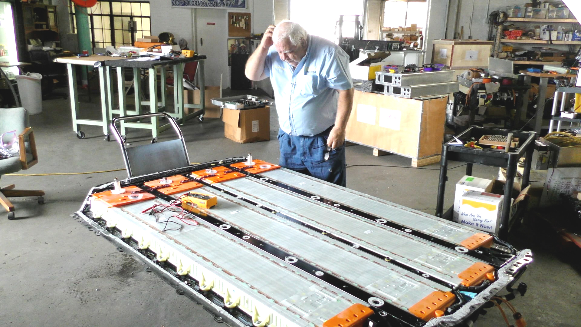

Not sure we've captured this information anywhere... Model 3 battery module information from EVTV (here);
"The two 23 cell modules are at each edge of the pack and 67 1/2 inches long, 11 1/2 inches wide and 3 1/2 inches thick and weigh 191 lbs.
The two 25 cell modules are located in the middle of the pack and 73 inches long, 11 1/2 inches wide and 3 1/2 inches thick and weigh 207 lbs."
Note: the CAD models seem accurate (here).
