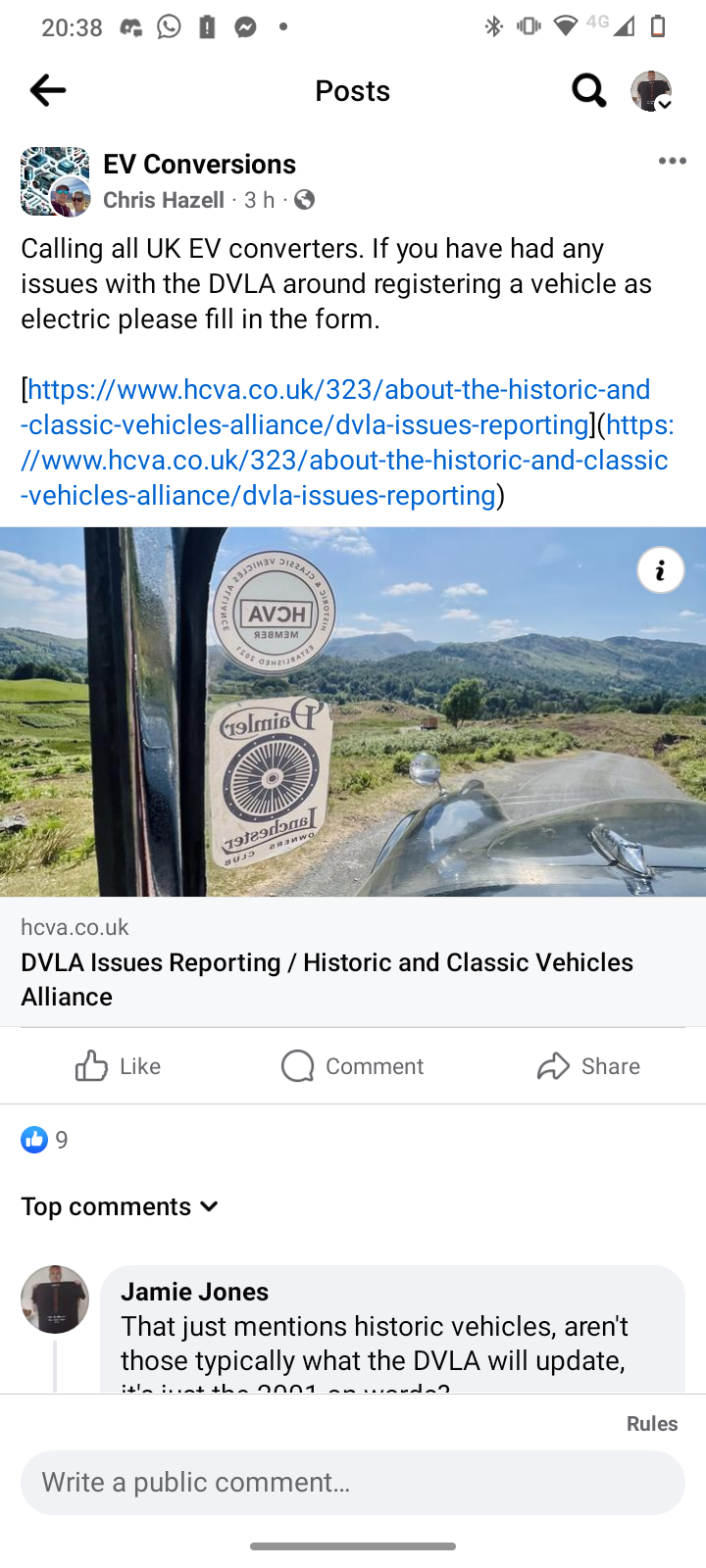

Feltham are asking for DVLA feedback, seems to be saying they're having issues with even pre 2001 now. Fill in if you can.
https://www.hcva.co.uk/323/about-the-hi ... 391sWT3nxY
