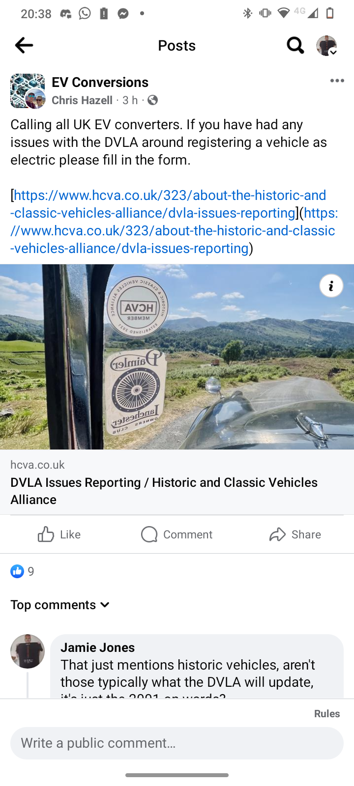

Re: Registering and changing tax class of an EV conversion in the UK
https://petition.parliament.uk/petitions/625633
out off date but need to be restarted i think
