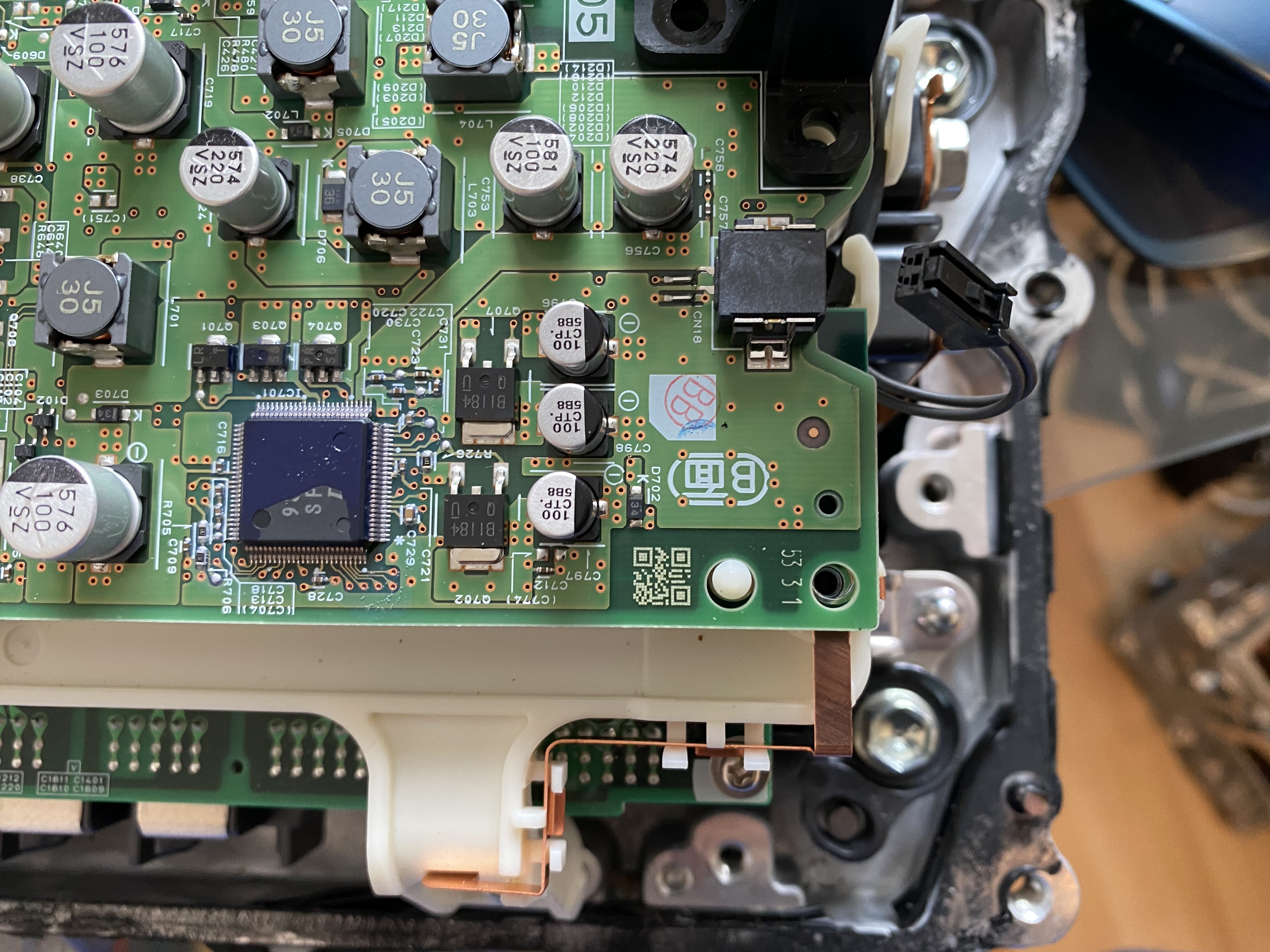

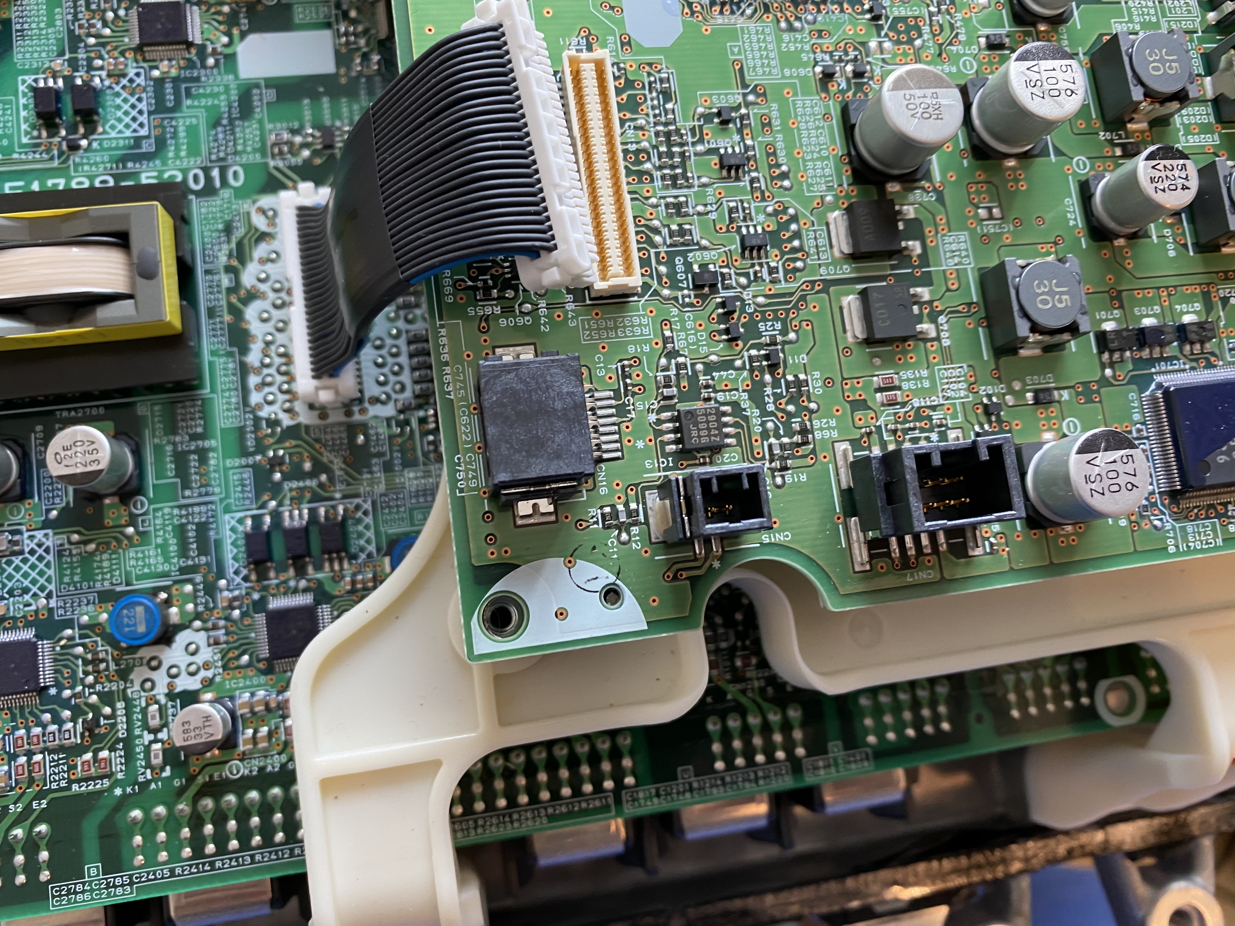

Just another data point for Auris inverters. Inverter model: G9200-47190 control board: F1759-47070 05. If I understand it correctly it's 2017 RHD.
Underneath I have an unpopulated Gen3 board from Damien as a comparison. The control board measures 143x154mm connector has 50 pins.
I shall now go and hunt for an actual prius inverter so I can get spinnage sooner!
