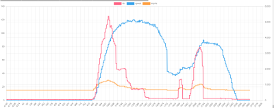

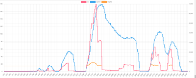

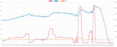

Re: [WIP] BMW Z3
Post by andybpowell »
Considering the roads and traffic around here I actually managed to get some reasonably stable constant speed runs done this morning on some level roads

barracuda816
Posts: 64
Joined: Fri Jan 27, 2023 10:52 am
Has thanked: 75 times
Been thanked: 23 times
Re: [WIP] BMW Z3
Post by barracuda816 »
andybpowell wrote: Mon Apr 01, 2024 8:49 am Considering the roads and traffic around here I actually managed to get some reasonably stable constant speed runs done this morning on some level roads
I am terrible at reading charts. What are the axis values here? When you say speed are you referring to motor rpm or vehicle mph?
