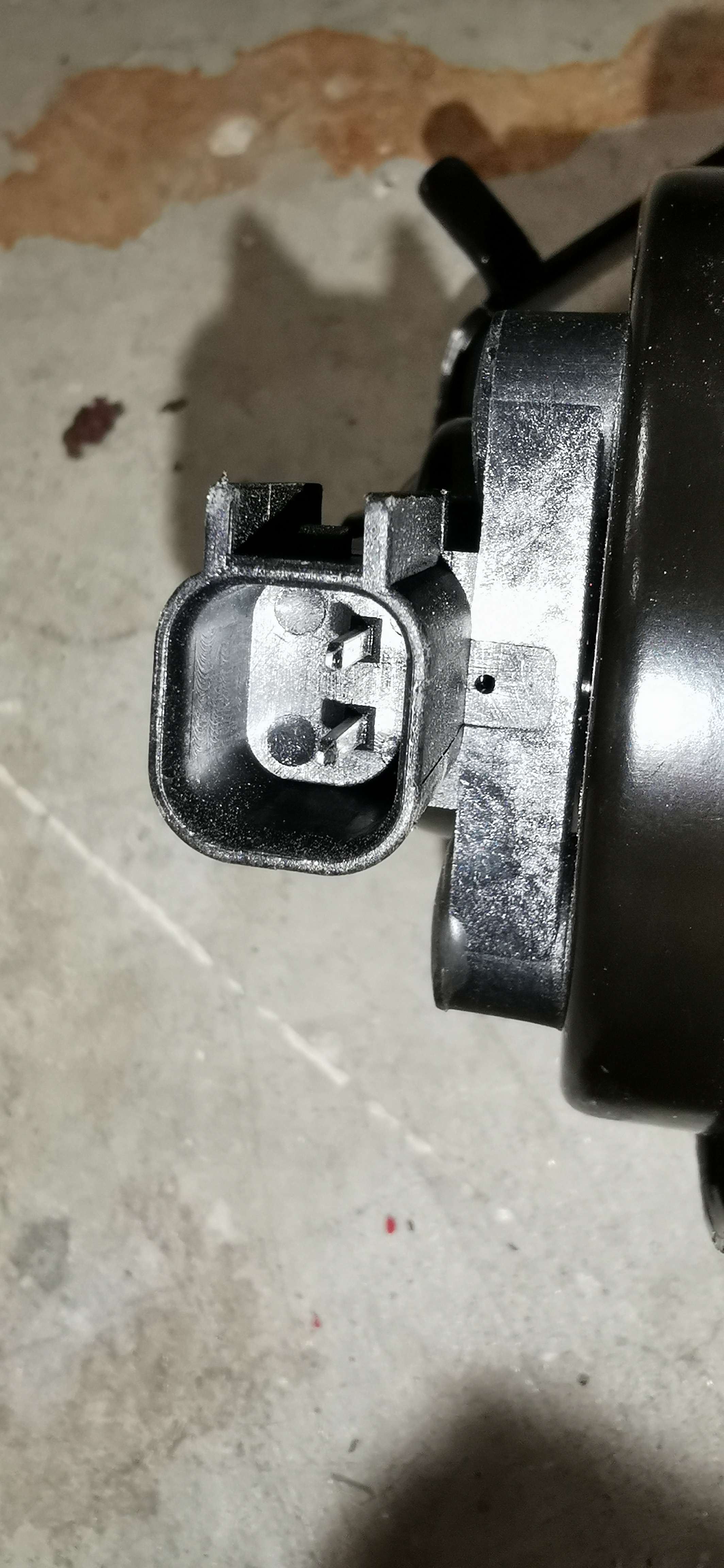

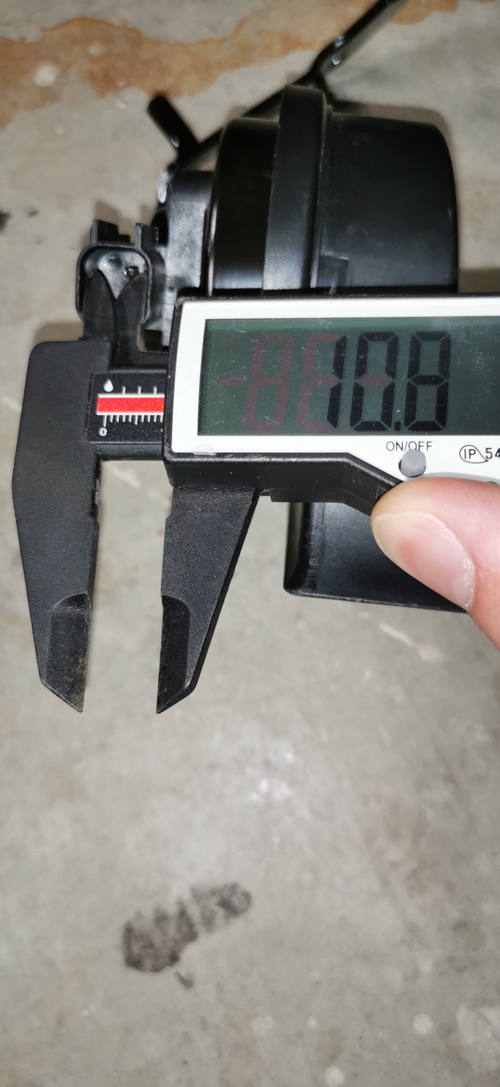

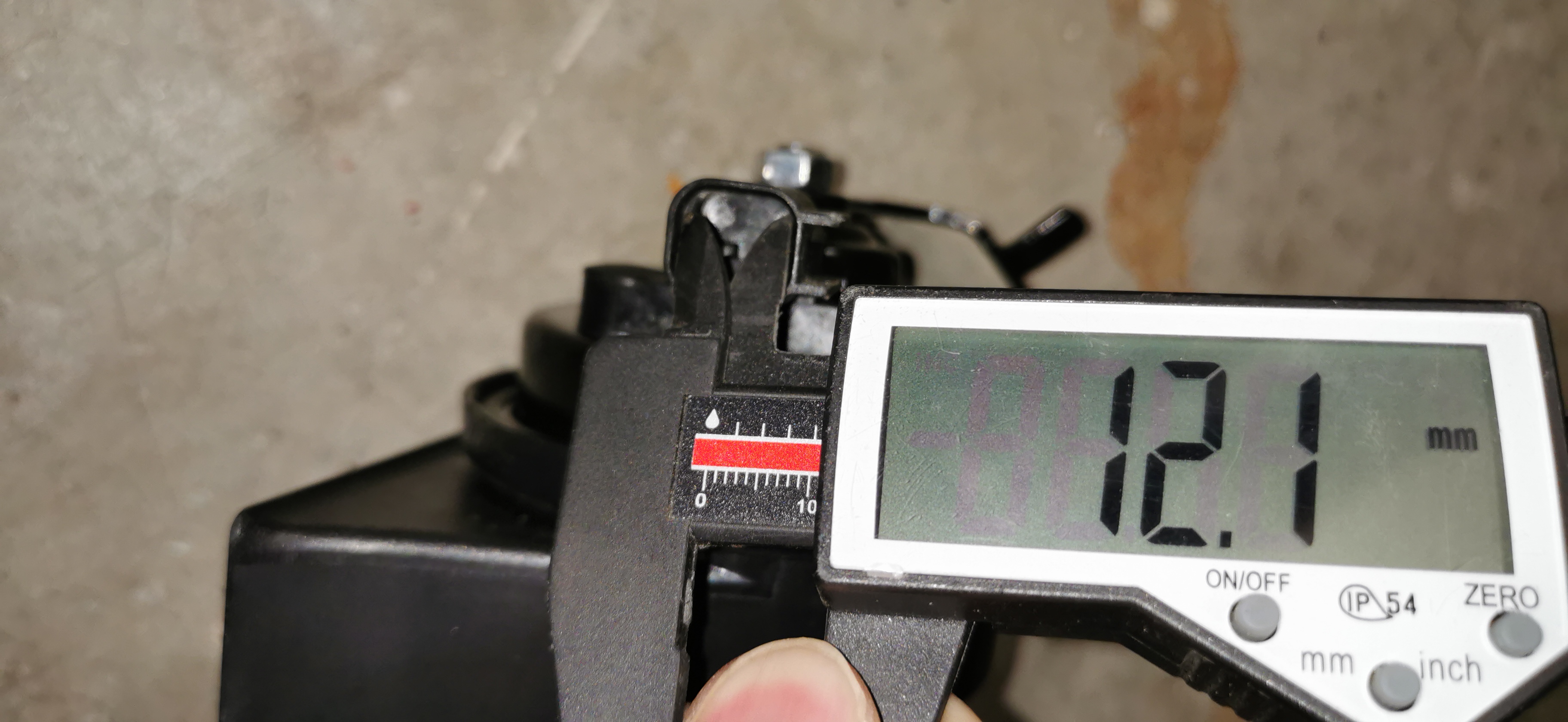

Folks.

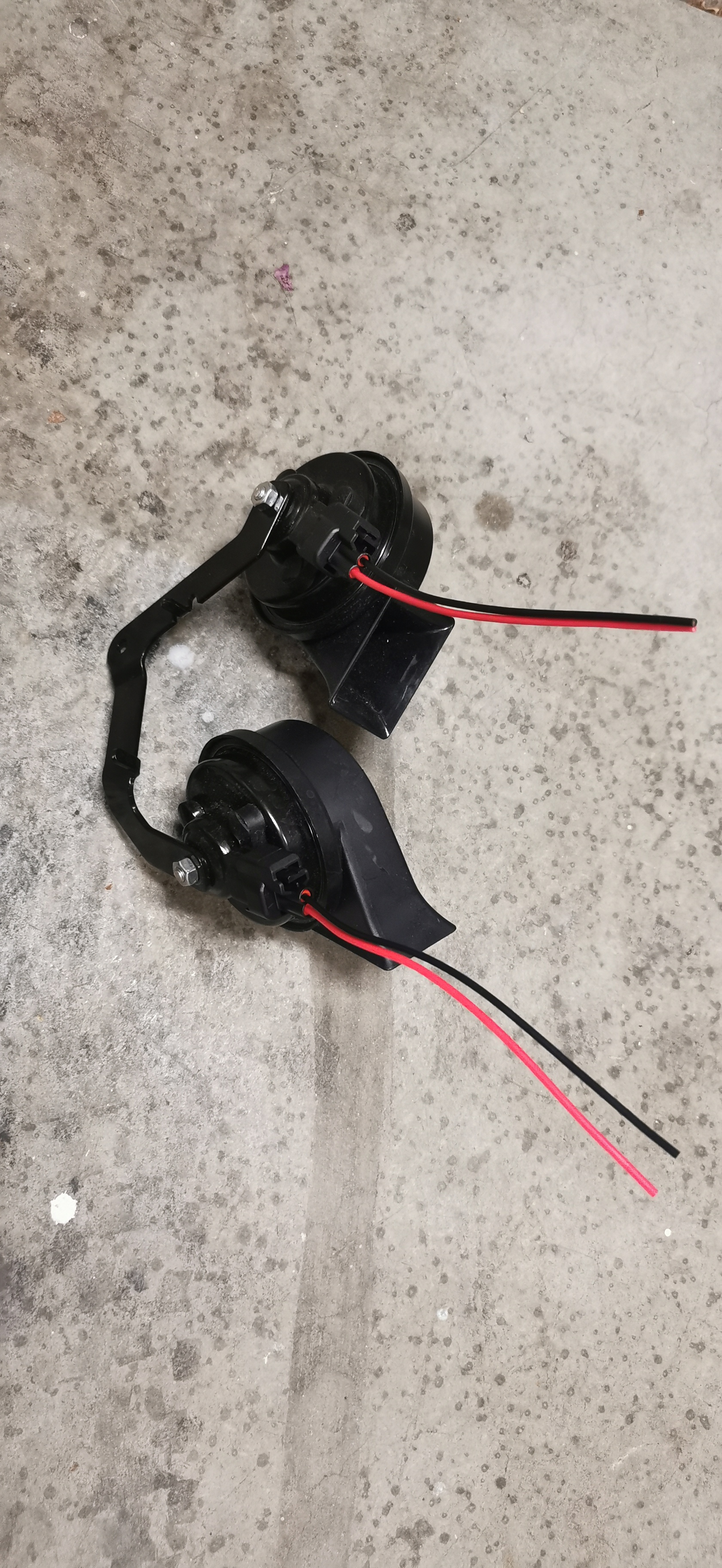

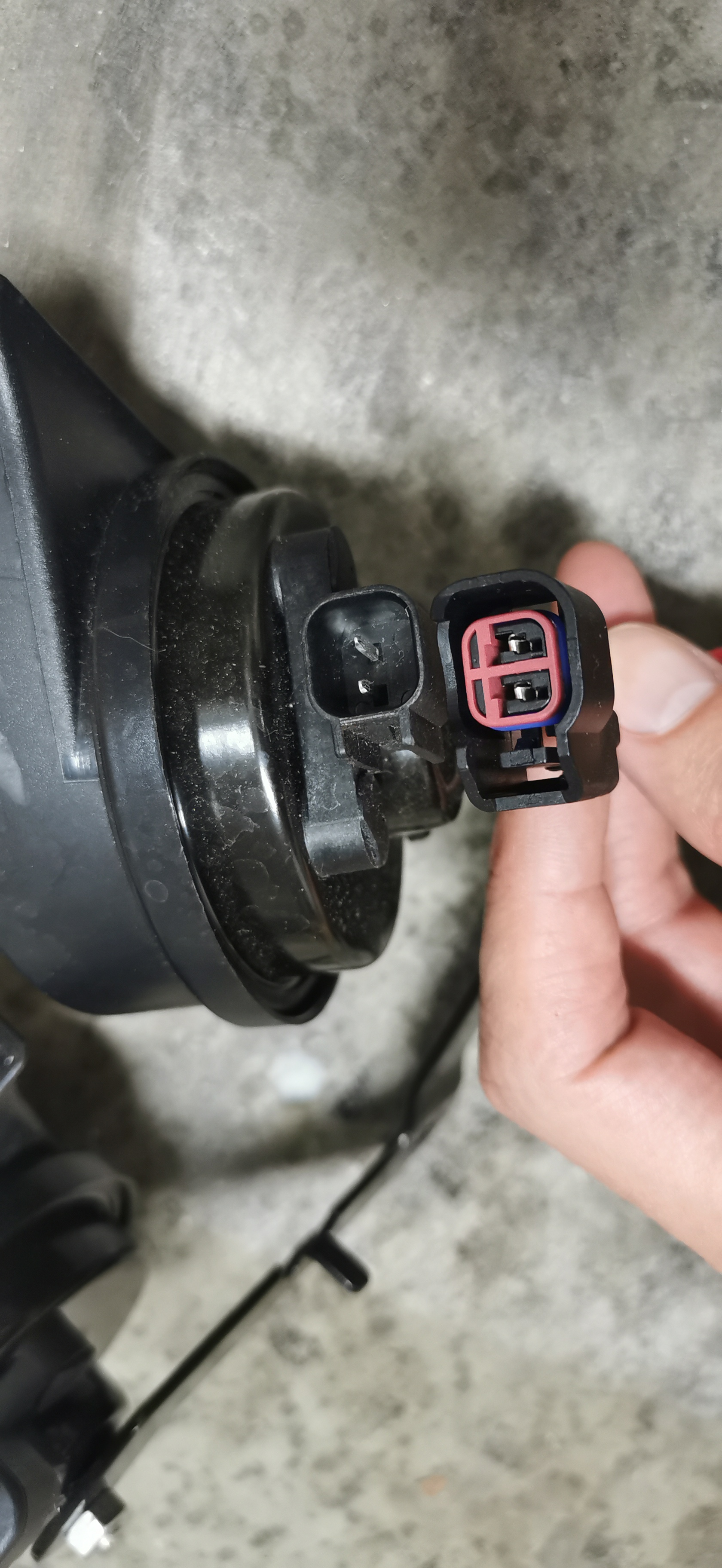

Does anybody know what connector is used for the Tesla honk?
Inside dims 11x12 mm. 5.5 mm between pins. The pins are flat, not round.

Looks like a common fuel injector connector.
Bosch US car type
https://msel.co.nz/uscar-2-way-fuel-injector-connector/
Bosch US car type

Thank you!Doig5710 wrote: ↑Mon Nov 13, 2023 6:56 am Looks like a common fuel injector connector.
Bosch US car type
Not sure if the ones I bought are Bosch, but "fuel injector" was the right key word to finding these on Amazon.
https://a.co/d/51kPAin

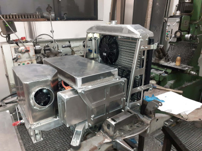

I can confirm that this part is really appropriate for installation in an EV. I just got one for Mazda for cooling system. Radiator will come packed in a box. There are two 32mm main outlets for coolant and a small 8mm outlet for deairing. Additionaly there is another hole in this radiator. Thread is M22x1.5. It is located between the main outlets and its purpose is to house thermostat. This needs to be plugged for radiator to be functional. I had another radiator which was rotten and i simply removed thermostat from that one.
Now to help with radiator mounting i made a simple 40mm channel from sheet aluminum so radiator sits inside it and to define the third mounting point is a large circular plastic fitting on the right side which i used to anchor radiator to the chassis.
Additionaly i used a simple sheet metal strip and fold it to effect a support for radiator from the top. You need to wrap the metal so it wont damage radiator fins under vibration.
For active cooling while charging (immovable car) i fitted a 80W 250mm fan i bought from aliexpress. https://www.aliexpress.com/item/1005005 ... Sh62T8WAGA
To mount this fan i used simple plastic ties with springs through the radiator fins. It is surprisingly easy.
https://www.aliexpress.com/item/4000023 ... 18023pBQBA
I tested by applying coolant in the tubes and ran the pump. System is tight and running.

I use 2 of them, the upper one for the motor and charger, the lower one just for the battery. I attached it to the three holes where the fan was originally attached.
Depending on where you buy that fiat radiator some come with a blanking plug in that m22 hole which is nice

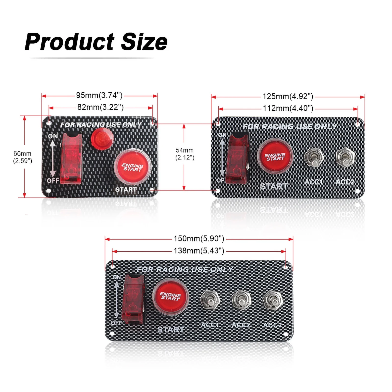

Anybody knows a good latching switch with a momentary button combo, preferably 19mm round? Doesn't need to be lockable.
Trying to combine ignition switch and start button into one unit. The ignition switch needs to stay on whilst pressing the start button.

Something like that? I have seen this kind of panel on aliexpress, ebay or on amazon...alexbeatle wrote: ↑Tue May 14, 2024 9:05 pm Folks.
https://www.aliexpress.com/item/1005004857619310.html

While I don't think that's what Alex was looking for, as it happens I just viewed a YT vid that demos the smallest model of this:

Looking for something like this....arber333 wrote: ↑Wed May 15, 2024 6:48 am Something like that? I have seen this kind of panel on aliexpress, ebay or on amazon...
https://www.kartek.com/parts/k4-switche ... inals.html
Though it would be nicer for the momentary part of the switch to be a pushbutton - press the switch shaft to engage engage the momentary button.

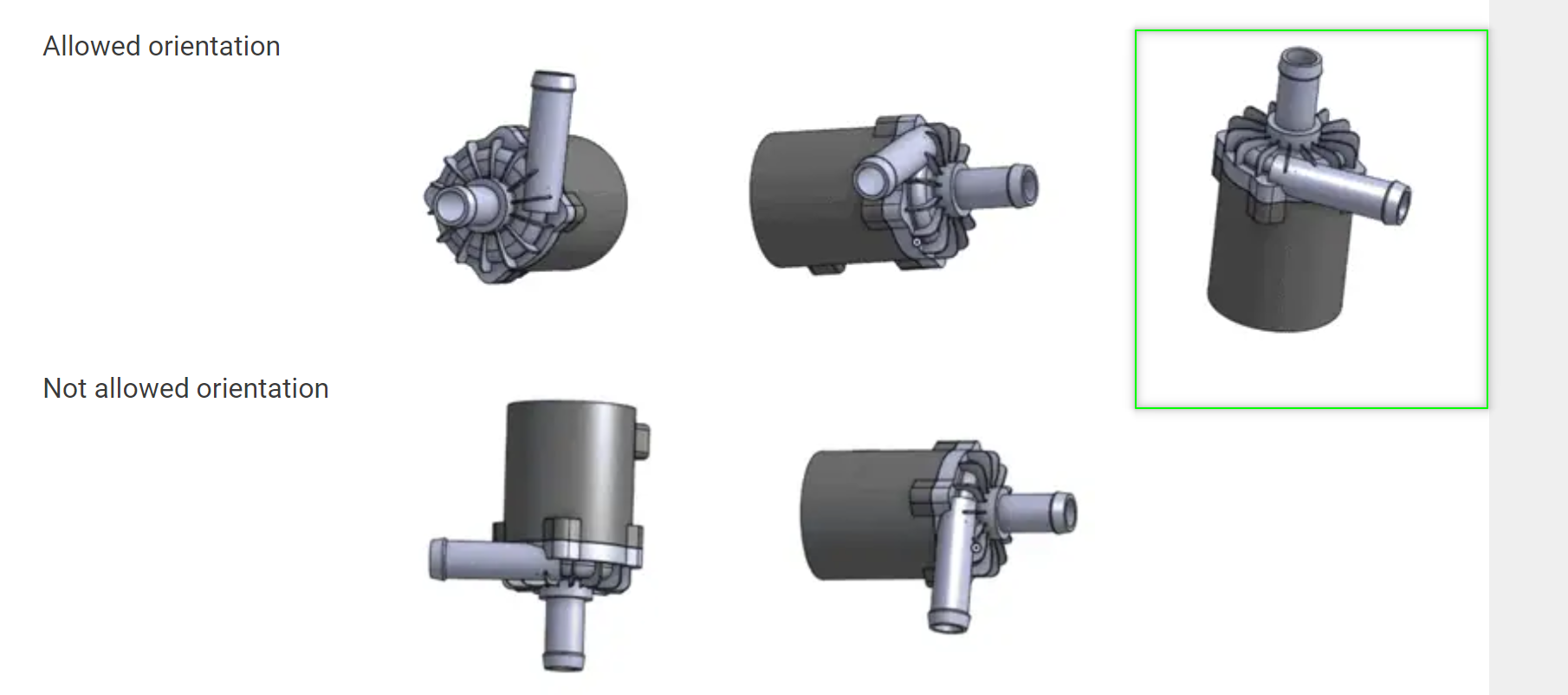

Are the Tesla/Nissan/Ford coolant pumps know for failure?
One of mine started leaking from the seals. The other one (identical) is ok. Haven't driven my conversion all that much yet. Seems to be happening overnight when the temps drop from 25..30C during the day to 10..15C at night.
From Lars' homepage (https://www.evcreate.com/using-tesla-th ... 20on%20the), my pump orientation is ok.

The early Tesla pumps, as used on the RAV4 EV, have a regular failure pattern. They don't leak, but they do stop pumping (either not running, or running too slowly, IDK). I've read about several failures of the early Tesla pumps, but none were for leakage. Failures are common, though not particularly frequent. The RAV4 EV has four coolant pumps, due to one being dedicated to a cabin heater loop with its own type of coolant.

I'm running two from a 2011 Leaf and no issues. Do you control the speed or are they full on all the time?
Did they come from a crash damaged car? Maybe a hair line crack.

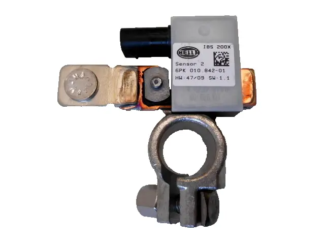

I found this part in connection with the charging management of my 12V battery. It measures current, voltage and other values and outputs them via LIN. Certainly also suitable for any consumers on the 12V side. You can get it individually from €20.- or as a kit with display for €130.- on ebay.
- Posts: 2962
- Has thanked: 328 times
- Been thanked: 847 times
The Hella Sensors, I have a bunch of them. You need to make sure you get the ones meant for caravans/motorhomes as that matches the LIN frames.
