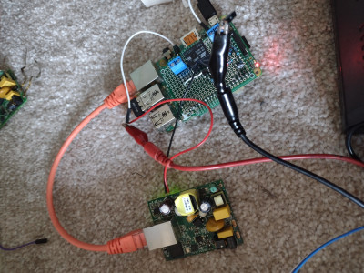

- Circontrol 50kW CCS+Chademo combo unit works now.
- This is a 100kW Delta charger (Delta SLIM 100 seems to match what it looked like)
- It communicates but wouldn't start charging
- It is a dual CCS unit and I tried both CCS plugs
- Information on the display of the unit didn't seem useful. It literally said "Oops!" or something like that, and that seemed to not even be in sync with anything that was happening on the CCS comms.
- I have no idea if the unit actually works or not
- I adjusted some timeout between attempts but it did not help

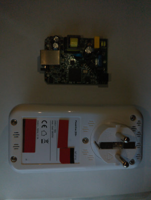

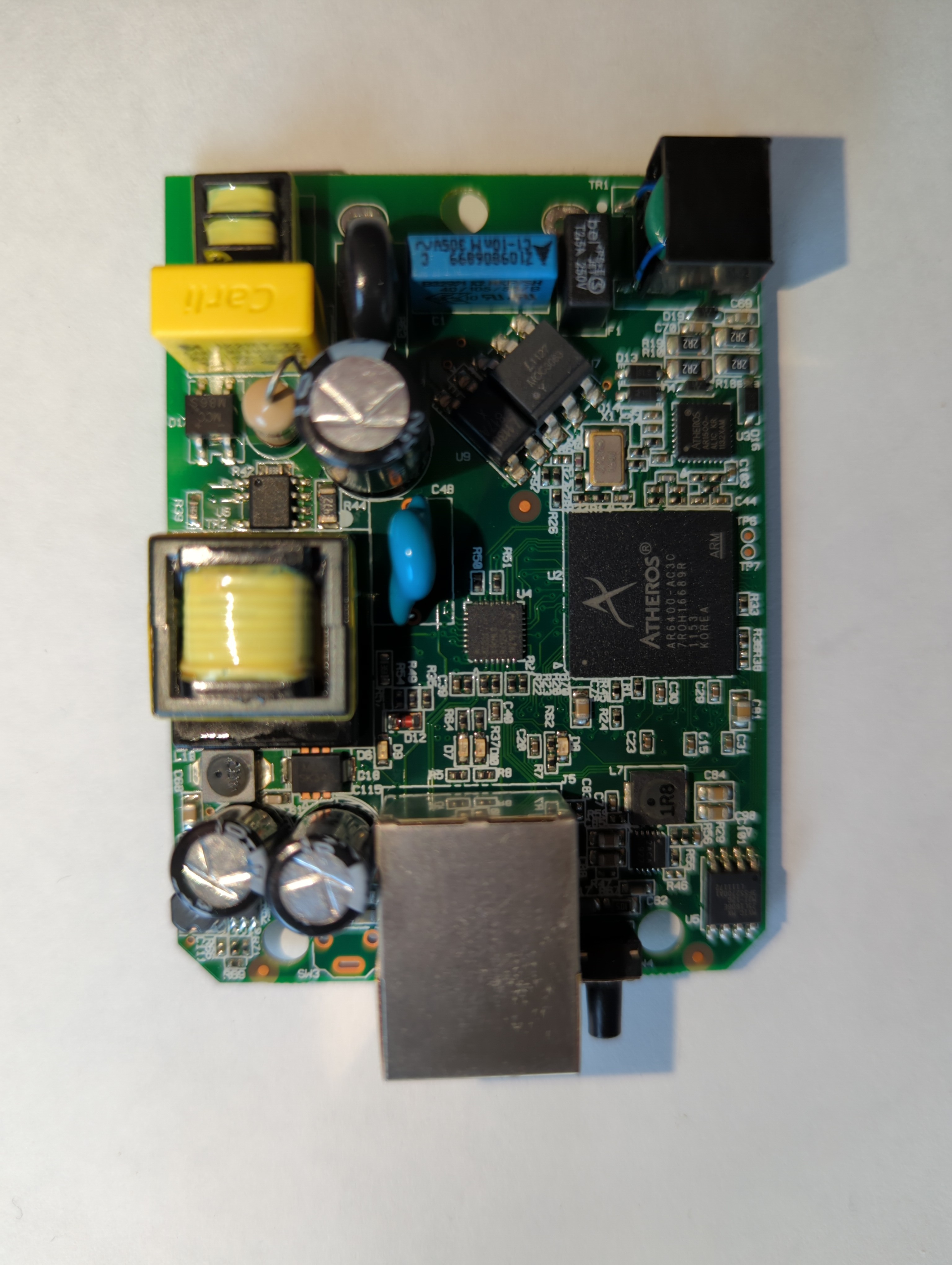

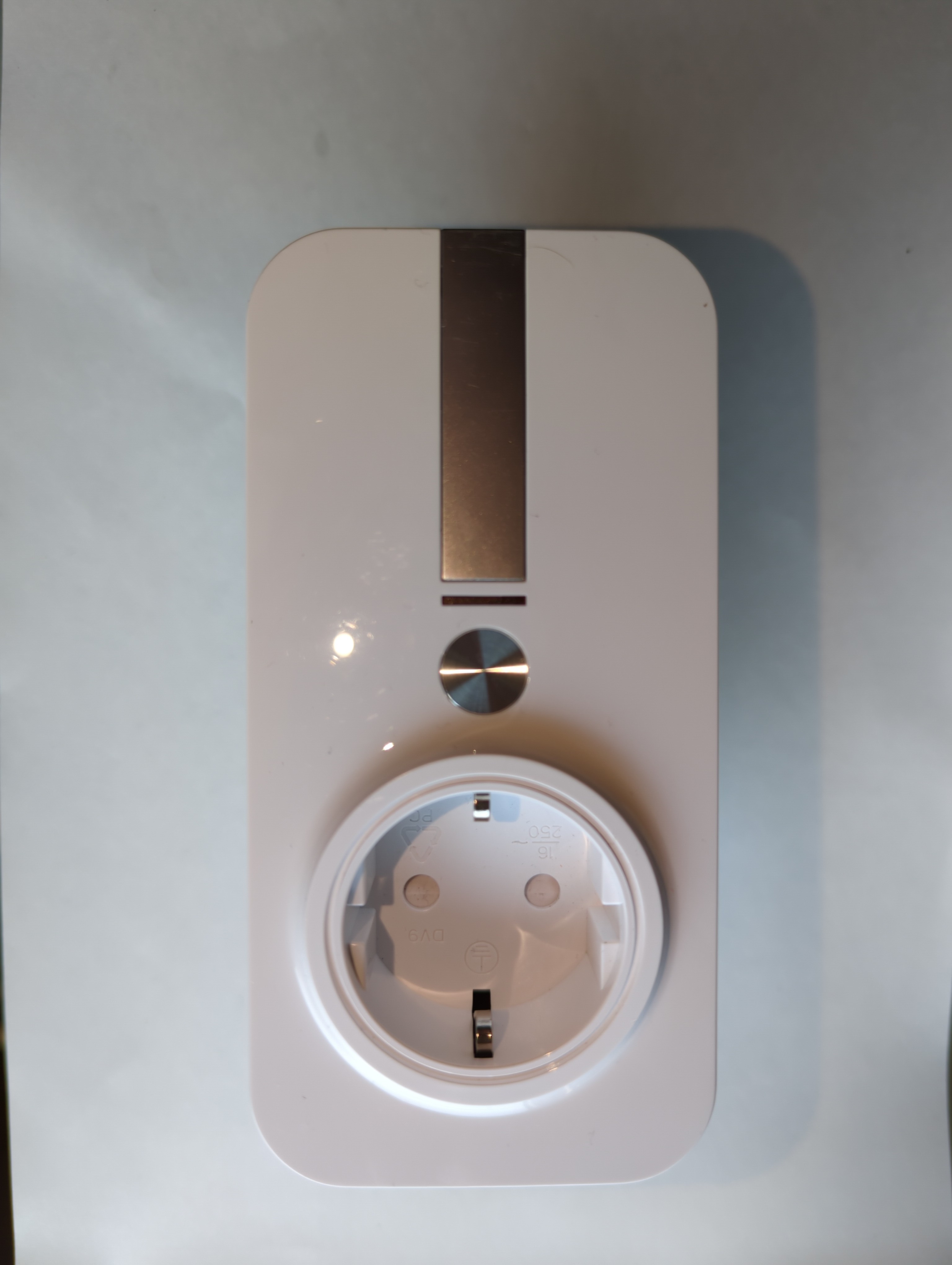

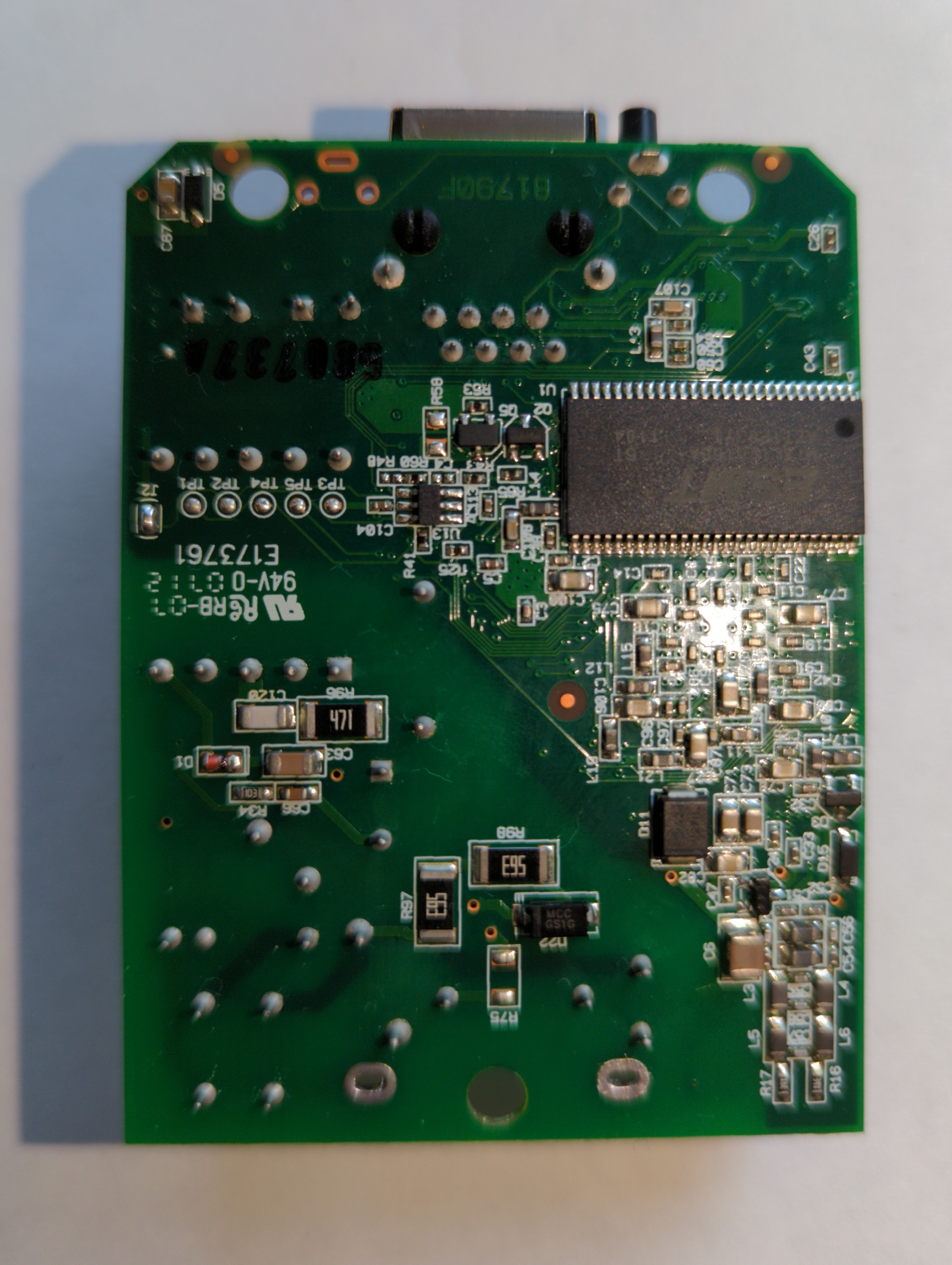

Finished some automated tests regarding the reaction in case of errors. Version 0.8 released: https://github.com/uhi22/pyPLC#2023-05-22-v08-released

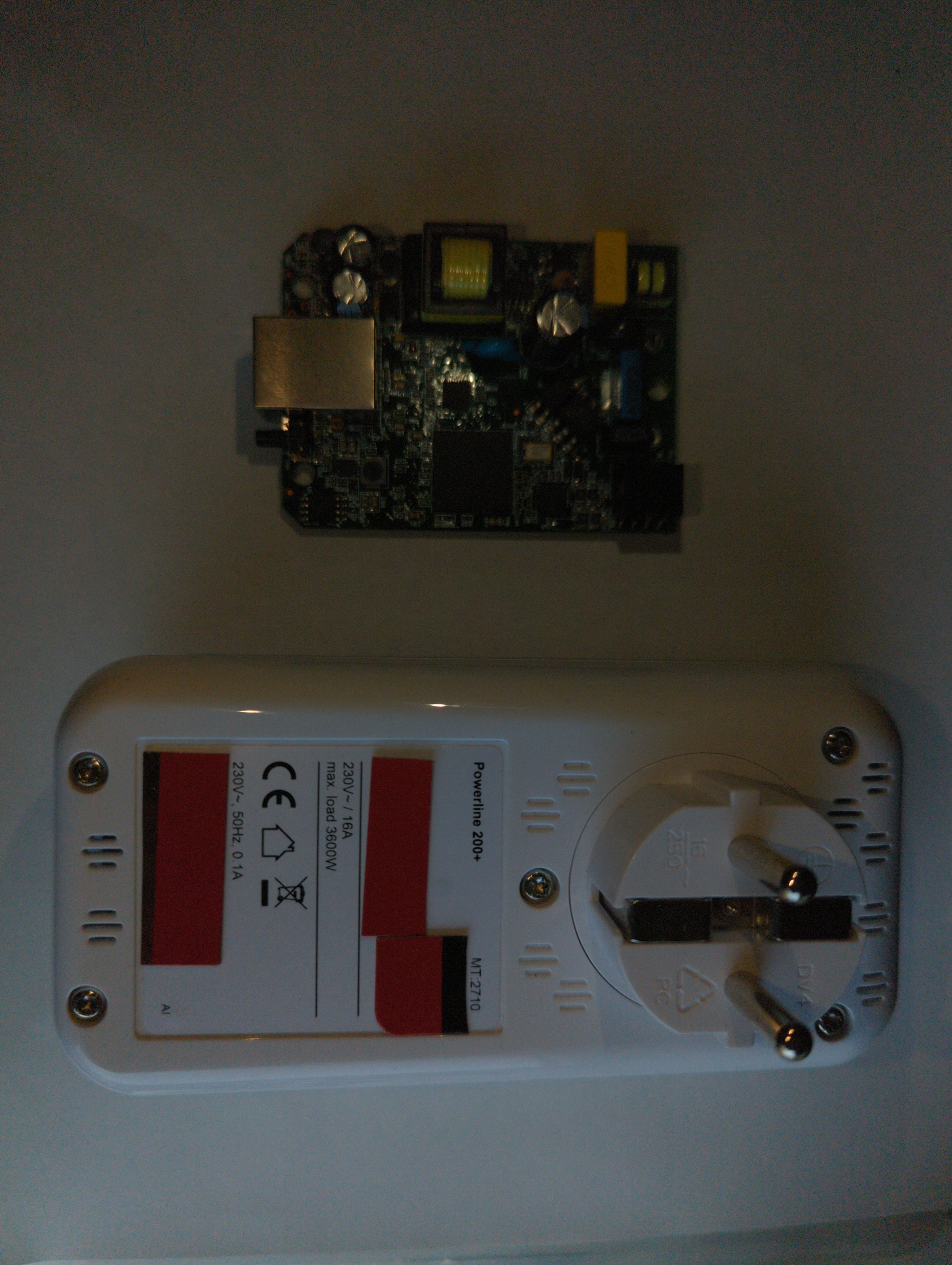

I got a single Devolo Powerline 200+ MT2710 in preparation for viewtopic.php?p=54814#p54814 . I dont have a CCS capable car.
I used the Devolo software to reset to factory defaults like recommended here https://www.goingelectric.de/wiki/CCS-T ... e-Details/ . The firmware Version of the Devolo MT2710 reported by the Devolo software is 4.4.0.05 . I have seen version 4.4.0.5 as latest firmware update for other Devolo 200Mbit devices. So i expect to be the latest one Devolo released for this device series.
The Atheros Chip is AR6400-AC30. The PCB have 81790F and E173761 written on it.
The pictures are dual-licensed CC-BY-SA 4.0 and GPL V3.0 and can be used here (MT2710 is unlisted at the moment there) https://github.com/uhi22/pyPLC/blob/mas ... ardware.md
My first goal is to reproduce this setup:
viewtopic.php?p=53848#p53848
In the setup the TP-Link is been used. Is there a special reason why?

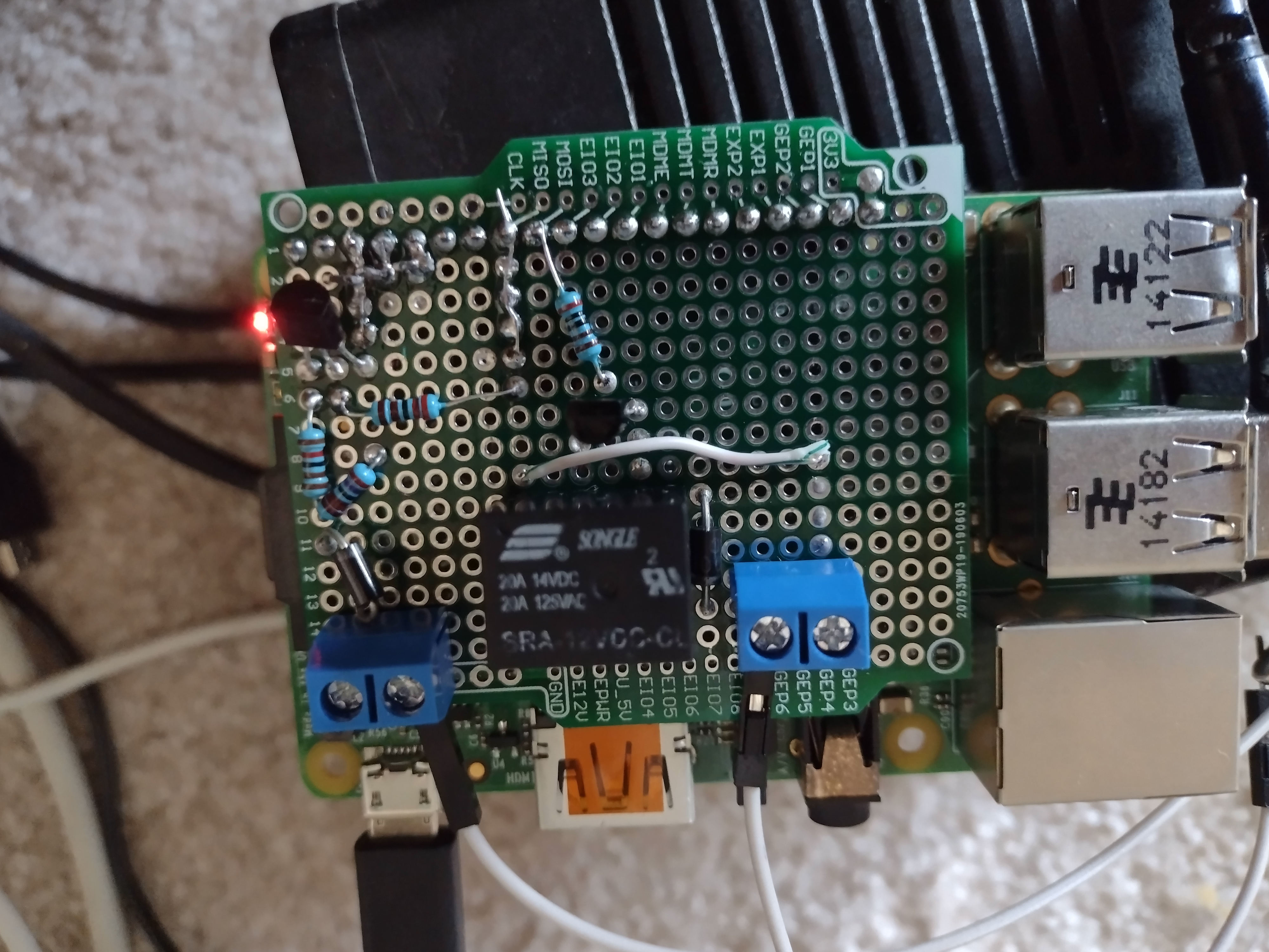

Ohh, yes. That's really bad documented. The Poti is an add-on from my side, it is not contained in the original https://www.instructables.com/Arduino-E ... ng-Station. It is just a poti between 5V and ground, connected to analog input A2.
The snipped you posted is the poti evaluation, not the stateC evaluation. The poti evaluation is used to distinguish the cases "digital communication" (which leads to 5% PWM) and "analog communication" (where the target current is coded as PWM ratio. The I_Lade_Soll_A is the target charging current in ampere, for the analog case.)
The transition from stateB (PWM between +9V and -12V) to stateC (PWM between +6V and -12V) is done by the car, when it requests power. In an analog EVSE for AC charging, the EVSE would detect this and use it for closing the big AC relay. In the DC case, at the moment this information is not used by pyPLC. I just have the LED on the EVSE, which changes from yellow to blue, but no other purpose of this detection.

Q1. In the mod of the TP-PA4010, which component is connected to CP and PE respectively? the 1nF and 150ohm.
Q2. When the CP is in 1kHz 5% PWM, how is this waveform signal sync up by the TP-PA4010 RF port modded above?
Q3. Wonder if the SECC in the DCFC needs to have your DieterHV to switch ON the HV relay contactors to make the connection to the EVCC side DC+- pins?

I plan to hack a GBT DCFC to convert it to a CCS2 plug. Starting with a 15-20kW model.
The electronics I'm planning to make are
a. the SECC side resistor-voltage control to respond to the EVCC as well as the PLC DC comm (sort of a front end of the DCFC)
b. the bridging controller to control the DC-DC converter that came with the GBT DCFC.
The motivation of this project: GBT DCFC is almost half the price of CCS2 DCFC at the same power ratings buying from China. Due to this and the situation in my country, owning and running an EV with CCS2 port is actually much more expensive than going petrol, especially traveling inter-state. And also due to this high pricing of CCS2 DCFC, there are very few along the inter-state highway which results in a longer travel time because of queues at the DCFC.
The last few questions I seek clarifications:
If I'm successful in this project, let's see if I have time to document my journey in another board thread.
So that perhaps somebody can mass produce this using much cheaper chipsets that will support finally owning and running a CCS2 EV can be affordable.
Many thanks again for your very prompt replies.

For Q1: Between the CP and the PE, there is the series of tree components: The 1nF, the 150ohm, and the secondary coil of the RF transformer. The order does not matter, also the polarity not. This means, to remove all parts on the TPlink which are connected to the secondary coil of the RF transformer, and connect the 1n and 150ohms to it.
For Q2: There is no sync between the 1kHz PWM and the homeplug traffic. In worst case, the PWM edges may disturb the homeplug packets. It may make sense to add a kind of low-pass filter at the output of the square wave. I have no real experiences in this direction, I just added a serial L, but not sure whether it is really needed.
For Q3: Regarding the power-relay in the charger, I have no experiences. Basically it needs the possibility to avoid voltage on the plug, not sure whether this needs a relay. What it definitely needs is some circuits to fulfill the cable check and the precharge. I do not have details regarding this.

Done a bit of work on my prototype, the Pi hat has CP control and contactor control, the pi's GPIOs working nicely.
Not got a CCS socket yet, but next up, I need to get my head around MAX22530 for isolated SPI voltage measuring.
