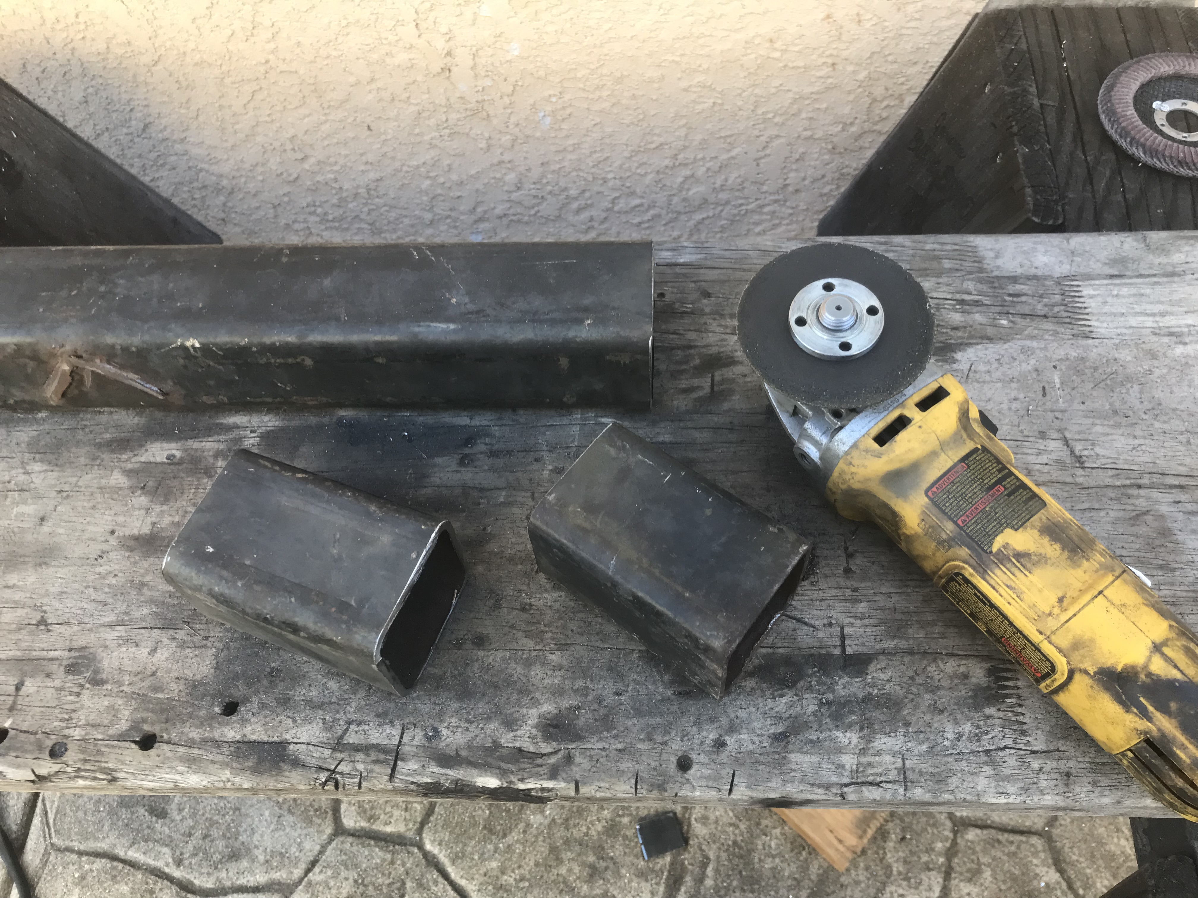

so like most I make big plans in my head and then use what I got layin' around the garage - ie sum random 2" square tubin'
Posted: Wed Mar 30, 2022 2:45 am
by Gregski
I like to class things up with rounded corners, ha ha
Posted: Wed Mar 30, 2022 2:46 am
by Gregski
one down three to go
slow is the tempo

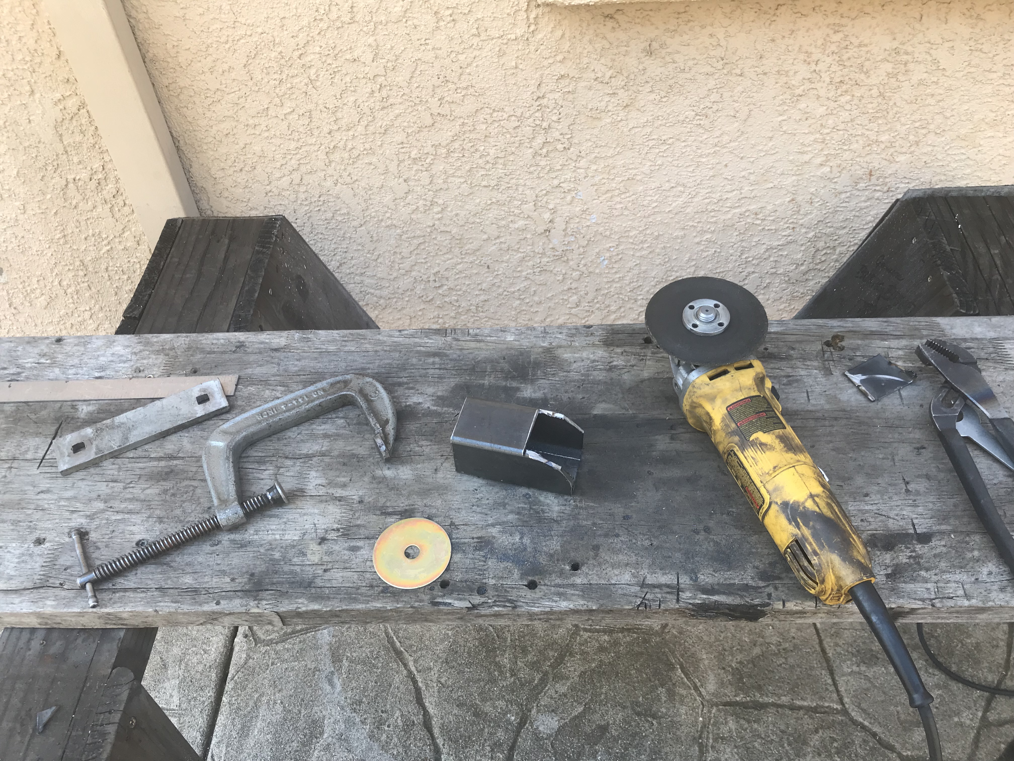

Posted: Wed Mar 30, 2022 2:49 am
by Gregski
I just trace sum random washer I find laying around
and I do two passes, first one is a ruff cut with a cutoff wheel
Posted: Wed Mar 30, 2022 2:51 am
by Gregski
and the second pass is with lap sandpaper discs (I never use grind stones, they suck)
Posted: Wed Mar 30, 2022 2:52 am
by Gregski
and that gives us this

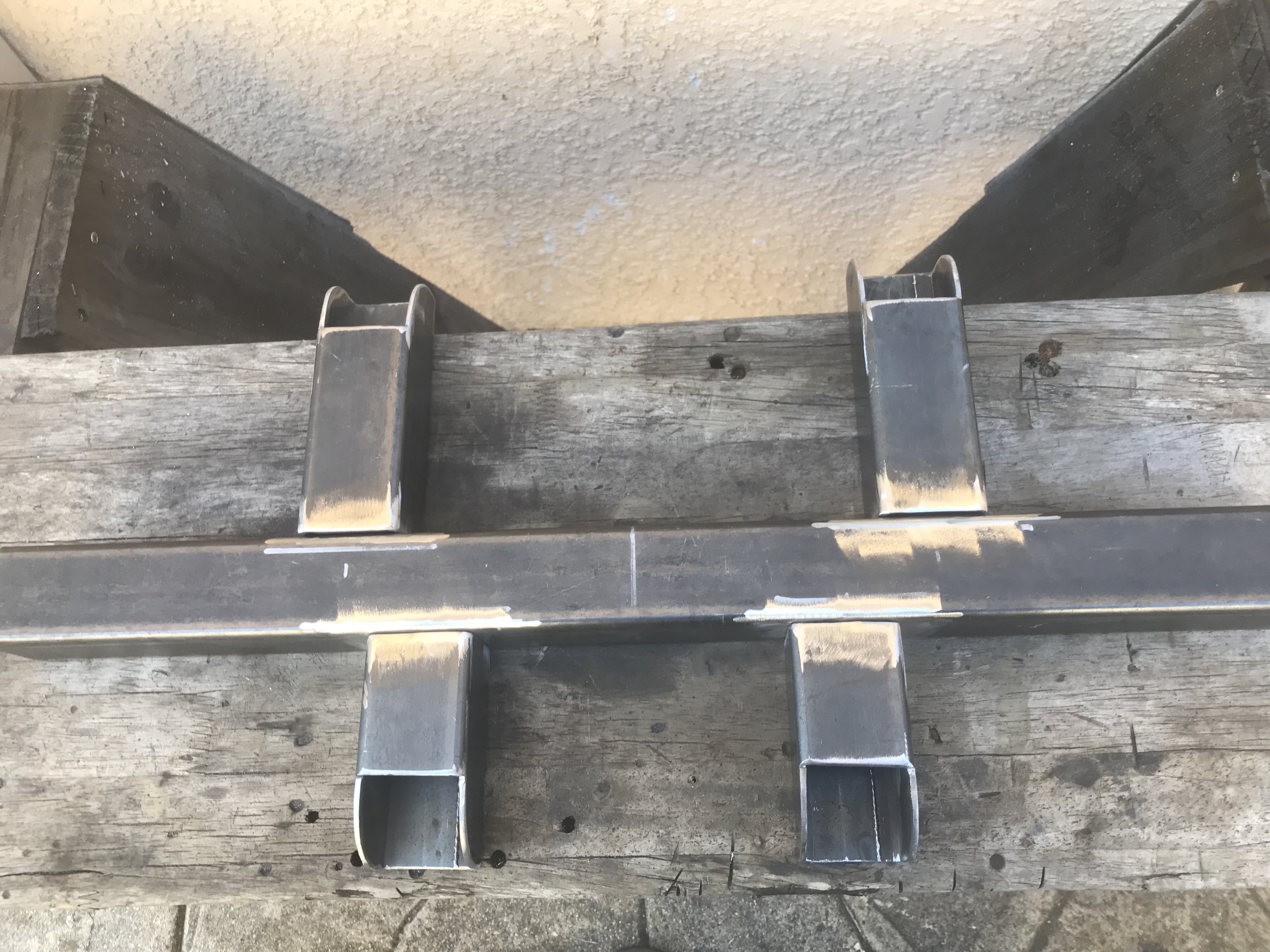

Posted: Wed Mar 30, 2022 2:59 am
by Gregski
tacking like a Boss !
Posted: Wed Mar 30, 2022 3:01 am
by Gregski
transferrin' dem holes!
Posted: Wed Mar 30, 2022 3:04 am
by Gregski
and time for the eyecrometer test

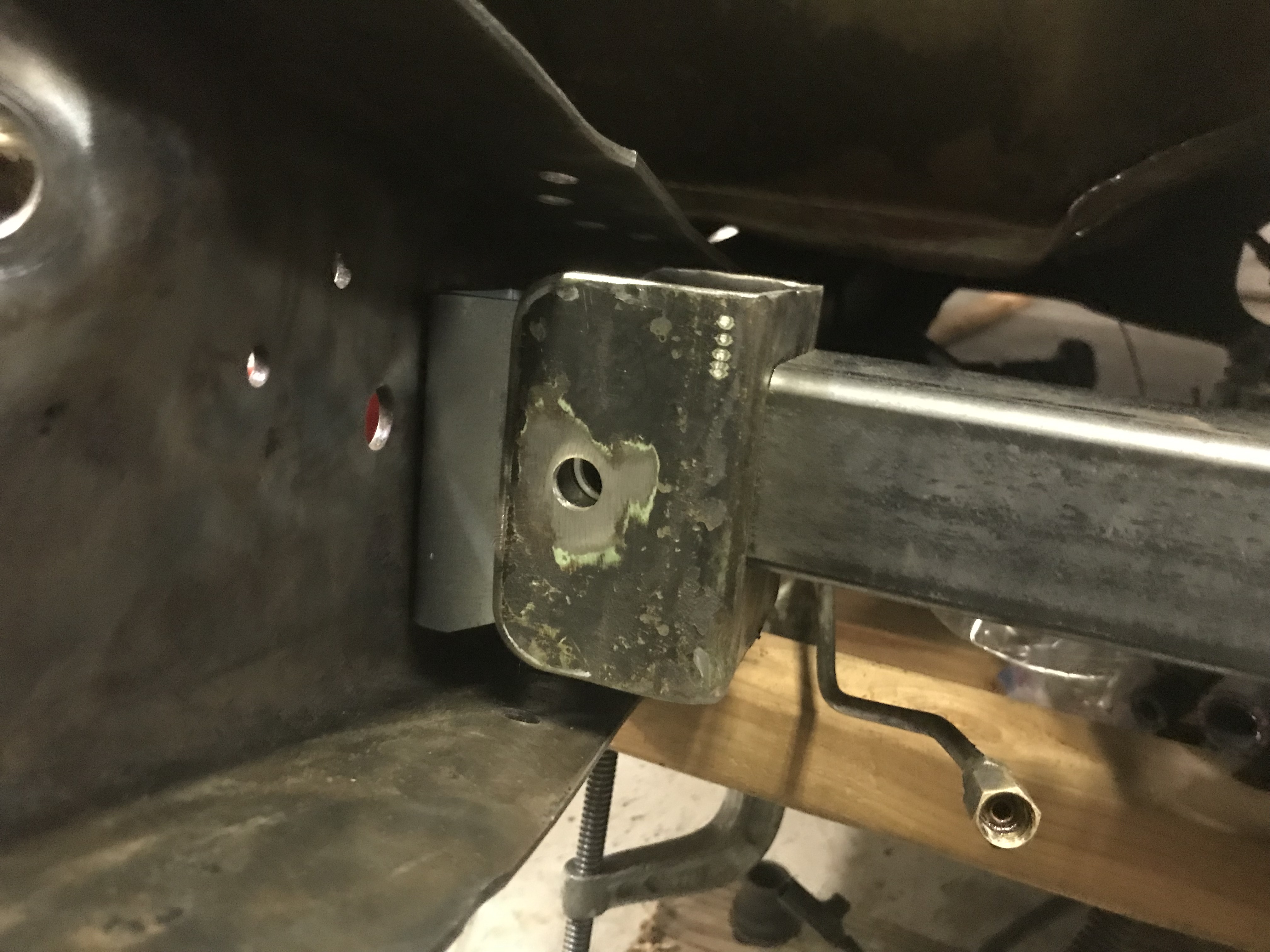

Posted: Wed Mar 30, 2022 2:23 pm
by Gregski
I seriously found this metal piece sitting at a side of a dumpster a few years back, that's the quality of parts we are dealing with here people
it wasn't quite wide enuff so it got split and will get reweldered
Posted: Wed Mar 30, 2022 2:26 pm
by Gregski
so this is what we are going for at the ends, sort of a clam shell design
Posted: Wed Mar 30, 2022 2:27 pm
by Gregski
here is what one side will look like, still needs some trimming, nipping, and tucking but you git the idear

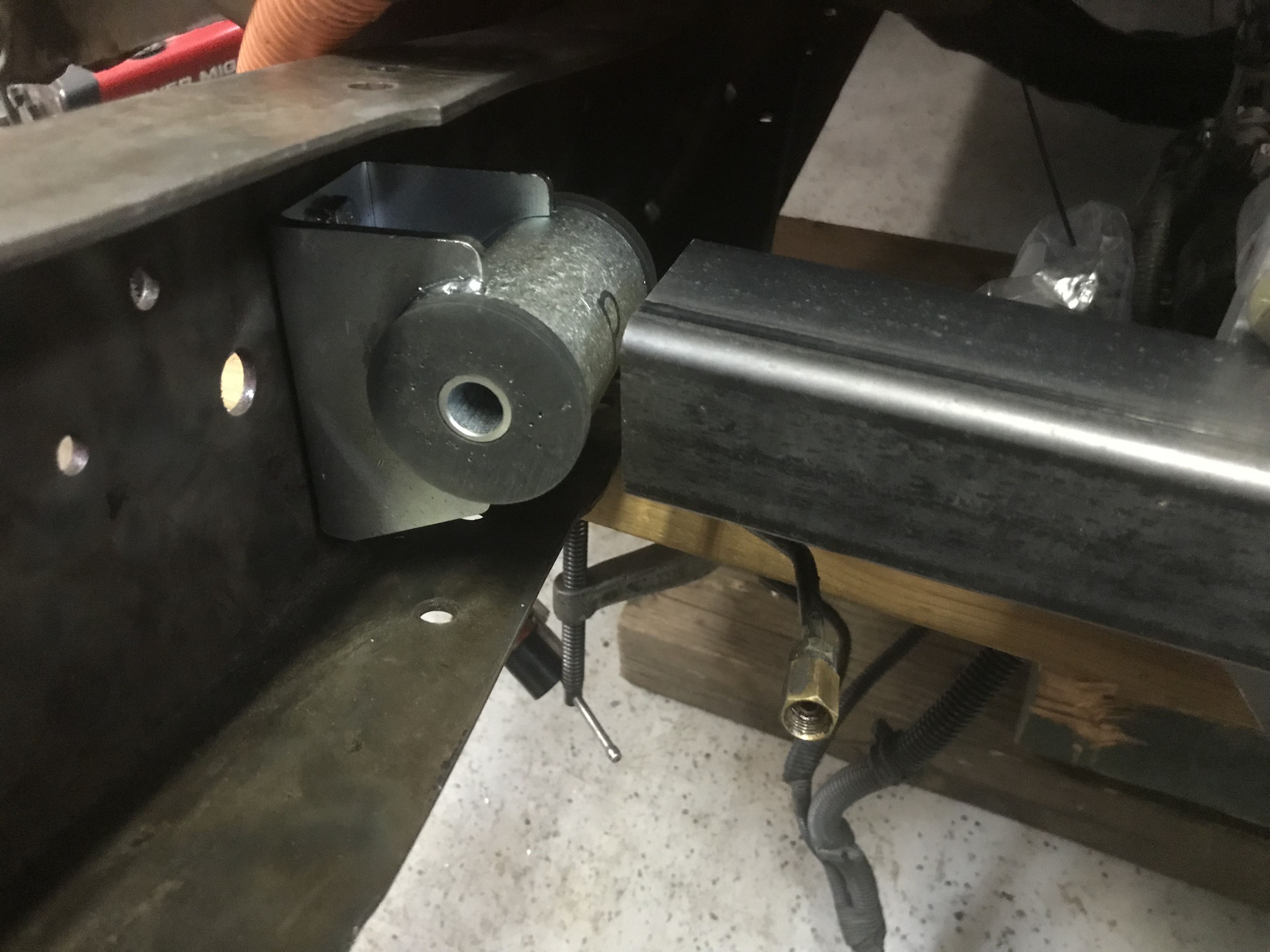

Posted: Thu Mar 31, 2022 12:28 pm
by Gregski
well dem ISOFORMA USA Amazon vendor peeps did us no favors weldering that stud aka bolt in there like that for us, shhh don't tell but gosh darn it was impossible to extract this contraption in it's current native state, so these bolts had to be liberated, thank you for using cheap easy to grind grade 5 hardware
and don't we all just luv buying new parts, just so that we have to modify 'em!
Posted: Thu Mar 31, 2022 12:32 pm
by Gregski
alright there it is, the transmission supported by a custom rubber mounted bracket, I won't lie it was a massive amount of work, but I am very pleased with the result - whacha all think? be gentle I have very thin skin (that's why I post on the Internets, ha ha)
