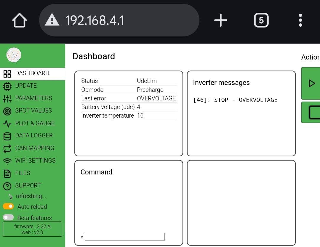

The inverter is reporting there is no HV present.

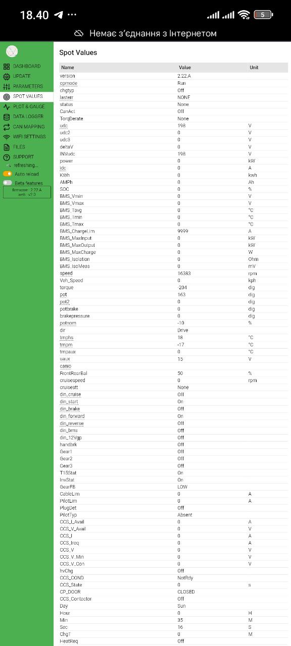

Your torque requests look wierd only got a 50 request out of.
Please plot Pot and Potnom. ensure you have setup the throttle correctly.
Also ensure all your limits are set correctly for testing.
You inverter also reports a really high motor temp, also an error state.

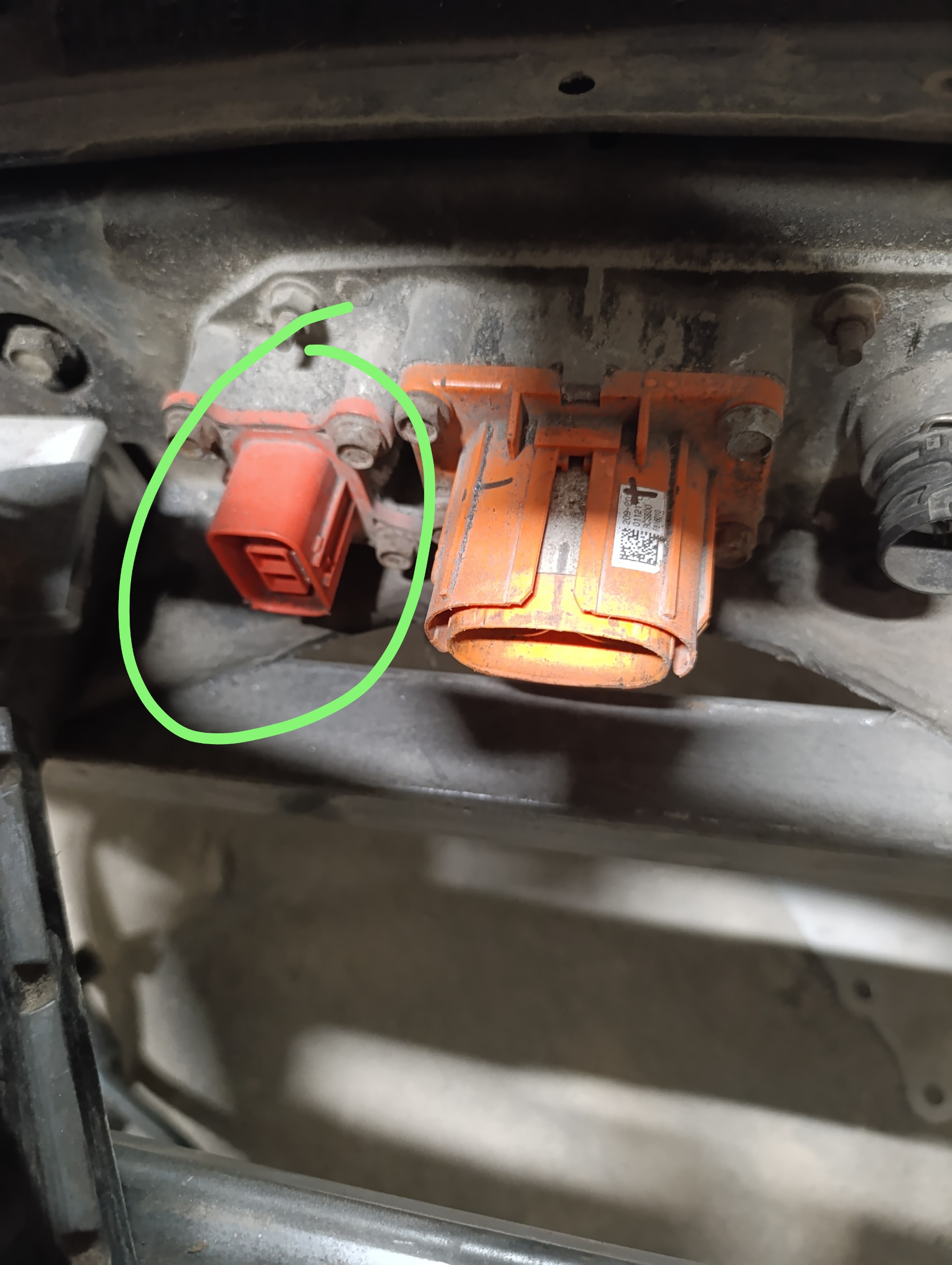

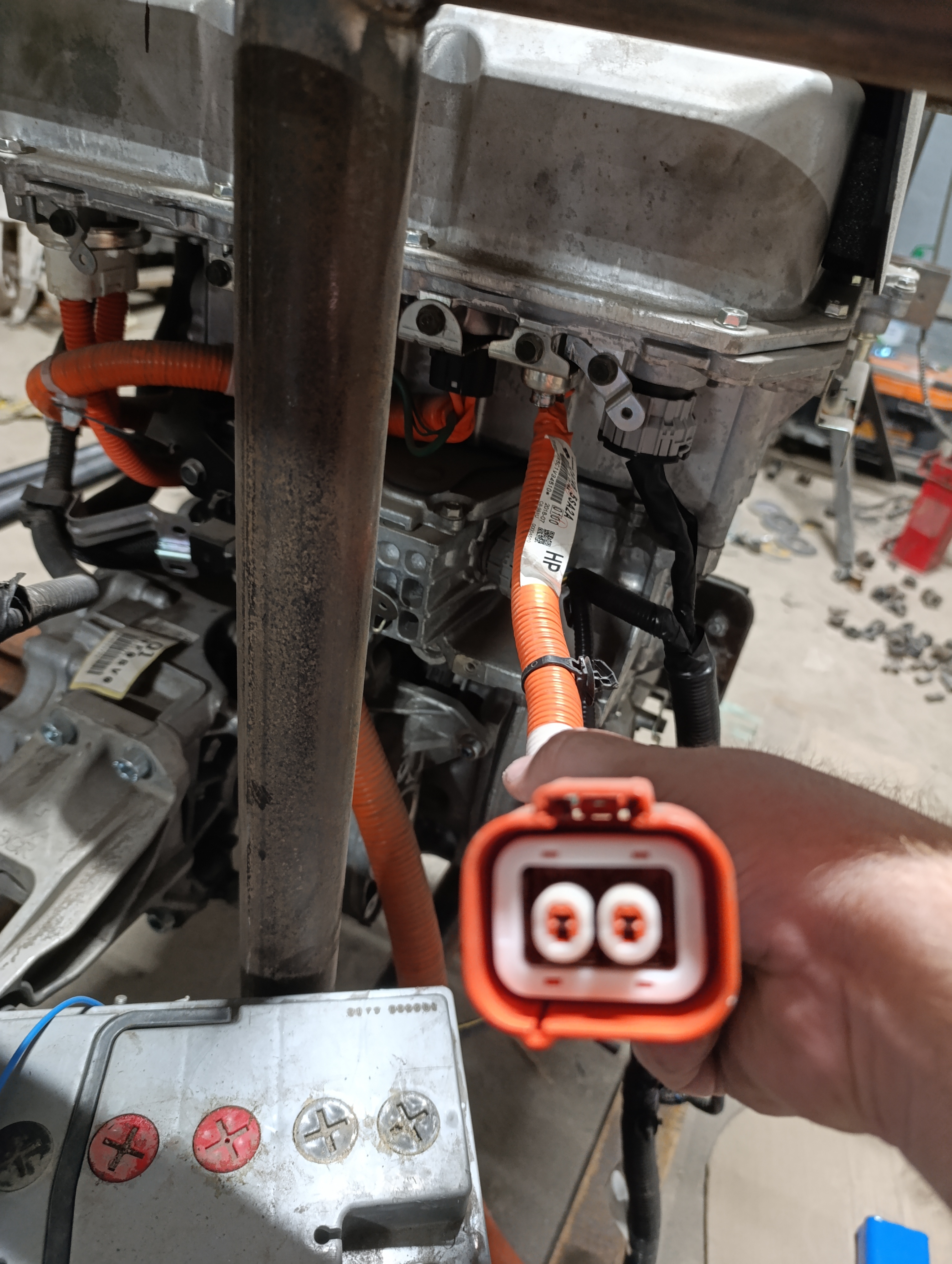

If the cooling system is not connected, how quickly does the engine heat up? Are there any coolant flow sensors in the inverter or engine? If the motor is hot, will the inverter shut it down or will it run until damaged? Also look at the web interface, which shows the engine speed as 16383 rpm. And I also wanted to ask about these connectors, what are they for? Thank you

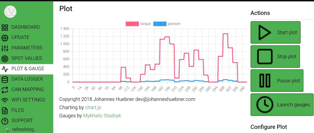

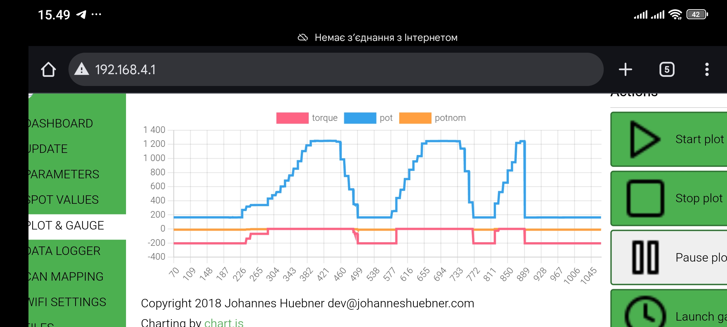

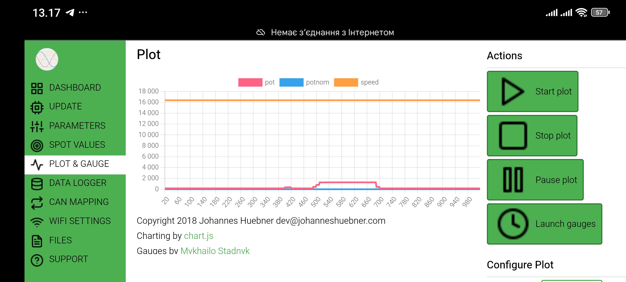

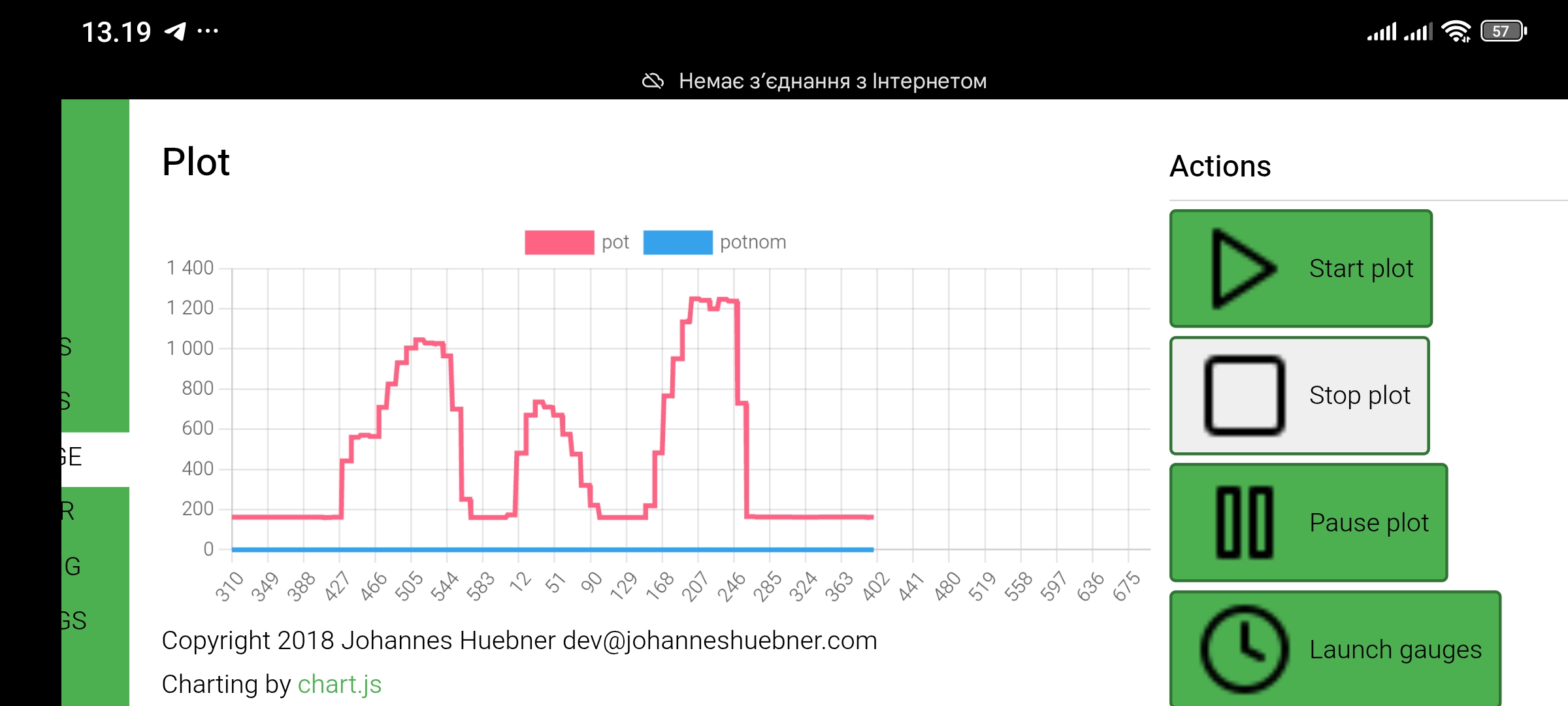

I make plot for Potnom, Pot, Speed. Potnom not changing, Speed 16383 rpm. System at start try -204 torque to stop engine. In parameters 1500 rpm start recuperate 100 rpm end recuperate. Maybe error from wrong speed parameters?

Battary 9 packeges of 6s2p (21700 liIon) near 200v, can discharge at 40 amp. In params i changed all to CAN1. Last test i recieved inverter error - [816] STOP - PRECHARGE

This parameters apear only at RUN mode. When t15stat->ON, din_forward->ON, last din_start->ON apear -204 torque. With or without HV connect, anyway. But when i press pedal torque changed at near 25% = 0 torque. 25%+ pedal position torque rise. Thats why i think inverter reed rpm wrong.

The plot does not show potnom changing, please make plot with torque. Does it go positive?

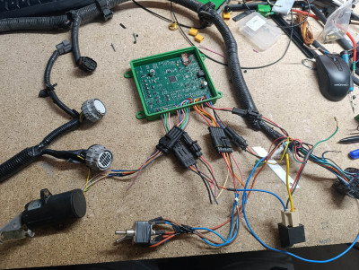

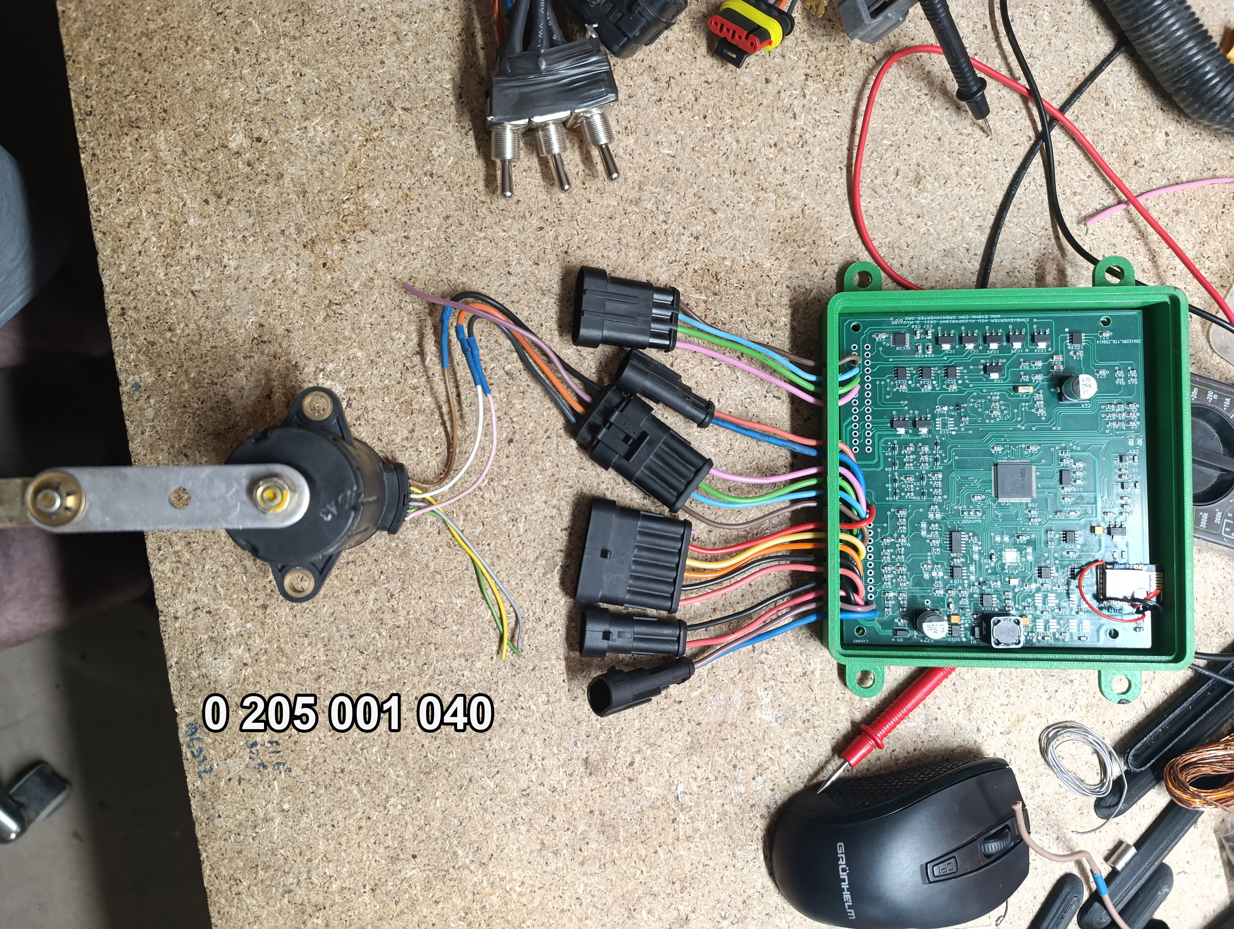

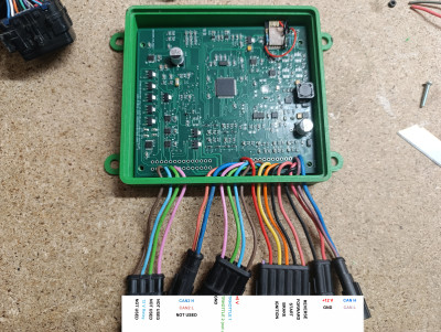

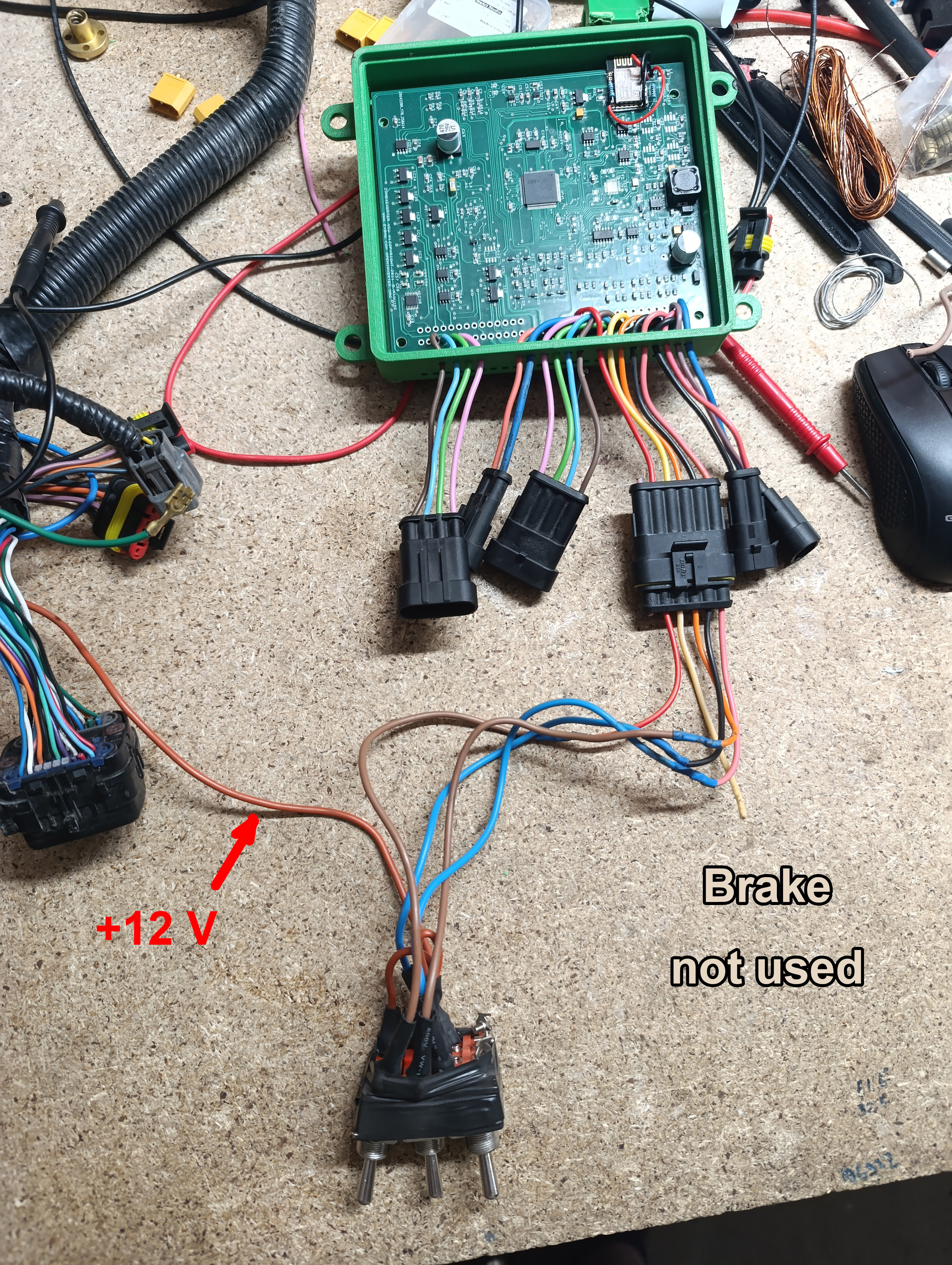

At this point you should provide an accurate depiction of your wiring set up/ and or photos.
Re: Nissan Leaf and Zombieverter minimum components need?
I was just trying different settings, no BMS at this stage but it will be. I'll take a picture of all the wiring on Monday. Thanks for helping.
Hello. I took a lot of photos of the wiring. Honestly, it's hard to understand anything from the photos, so I tried to describe all the photos as much as possible.
Tom, please tell me, can I read the errors with a standard OBD2 scanner like Launch Easydiag? You say that there are errors and the inverter does not give permission to work due to overheating. Maybe the engine temperature sensor is faulty. When I disconnected the zombieverter from the inverter, the 'torque' and 'potnom' indicators began to show correctly. When I connect it to the inverter, 'potnom' = -10 and 'torque' = -204. When I press the pedal, 'torque' and 'potnom' rise to 0 but do not move further.
