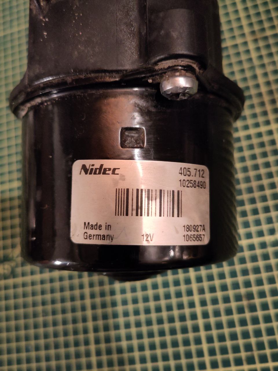

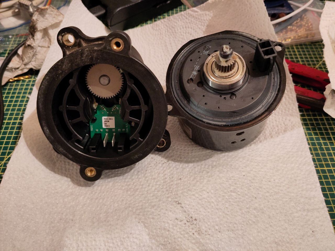

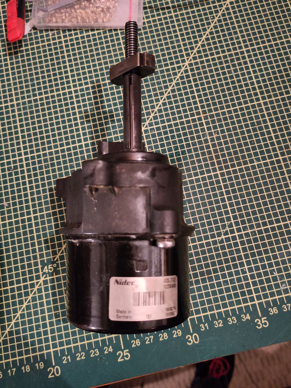

I started investigating the weak E-brake. As it turns out, when applying the E-brake, the only resistance it creates is between the lever inside of the brake drum and the ABS ring. I'm not quite sure yet, but maybe this is a design flaw? The brakes (currently, TRW GS8639 brake shoes are installed) seem to be of an old design, so maybe there didn't use to be ABS. I will search for some documentation and check whether the currently installed brake shoes are still in spec. If they are, this would be incredibly weird.
Edit: They very much are in spec. The brake material is 4.8mm thick, that's a lot more than the required 1.5mm.

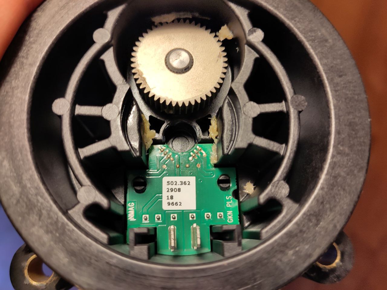

Quick notes for documentations sake (Purely mechanical):
I installed a complete brake kit (apart from the brake cylinders, since the current ones are still good and I was on my own, so I wouldn't have been able to easily bleed the brakes) made by LPR. It's identifier is "OEK 419" and I found a good deal for it that isn't (unlike most other offers) significantly more expensive than just the bake shoes and cylinders. It's made for 230mmx32mm drum brakes, which seem to be somewhat uncommon, so local parts stores didn't even have them in stock. The new kit seems to fit very well and it was easy to install. I found a simple method that doesn't require much effort or tools, but wasn't shown in any of the tutorial videos I watched:
  • Remove the nut from the handbrake adjuster in the cab (optionally measure the length of the threads for readjustment later)
  • Remove the lower spring from the brake kit, then bring both lower ends close together and you should be able to fit the assembly through the gap between the brake cylinder and the wheel bearing
  • Put the adjuster side in its final position and install the retaining clip and spring
  • Reinstall the lower spring and the handbrake cable while the handbrake lever side is still loose
  • Grab the lower metal part of the lever-side brake shoe with a pipe wrench or with vice grips and move it into position
  • Install the other retaining clip and spring
This method offers the advantage that you don't need to remove the wheel bearing or the brake cylinder (although I had to remove one of the wheel bearings later anyways).
Here's what I believe happened: The stamped pressure bar that was installed looked very similar to the one from my new kit. I think it's possible that LPR parts were originally installed, and at some point, only the shoes and cylinders were replaced with TRW parts, while the existing LPR accessories were retained. I believe the hole pattern between the LPR shoes and the TRW shoes is slightly different (I sadly forgot to check), so that the tension of the upper springs was mismatched and the adjustment mechanism didn't work. This led to the handbrake lever (which additionally has a larger cutout in the critical area than the TRW part) having a larger travel after some brake shoe consumption and hitting the ABS ring. The adjustment works now.
On one side, the ABS ring completely came off the wheel bearing (Febi 09521). I had to take a hammer and a welder to the wheel bearing, which felt quite weird! But it seems to work fine now. I will replace the wheel bearing soon, it seems to be very available as a part that was used on the Golf IV.
Two further interesting observations: While the brake is obviously a drum brake, the wheel bearing seems to be made for cars with disk brakes! Maybe, this is the reason why there was a thin distance ring (that I, again, sadly forgot to measure) between the wheel bearing and the axle flange? This might also have been a contributing factor to the issues I was having previously.
Anyways, I hope I can get my car inspected tomorrow or at some later point next week. I'm thrilled!

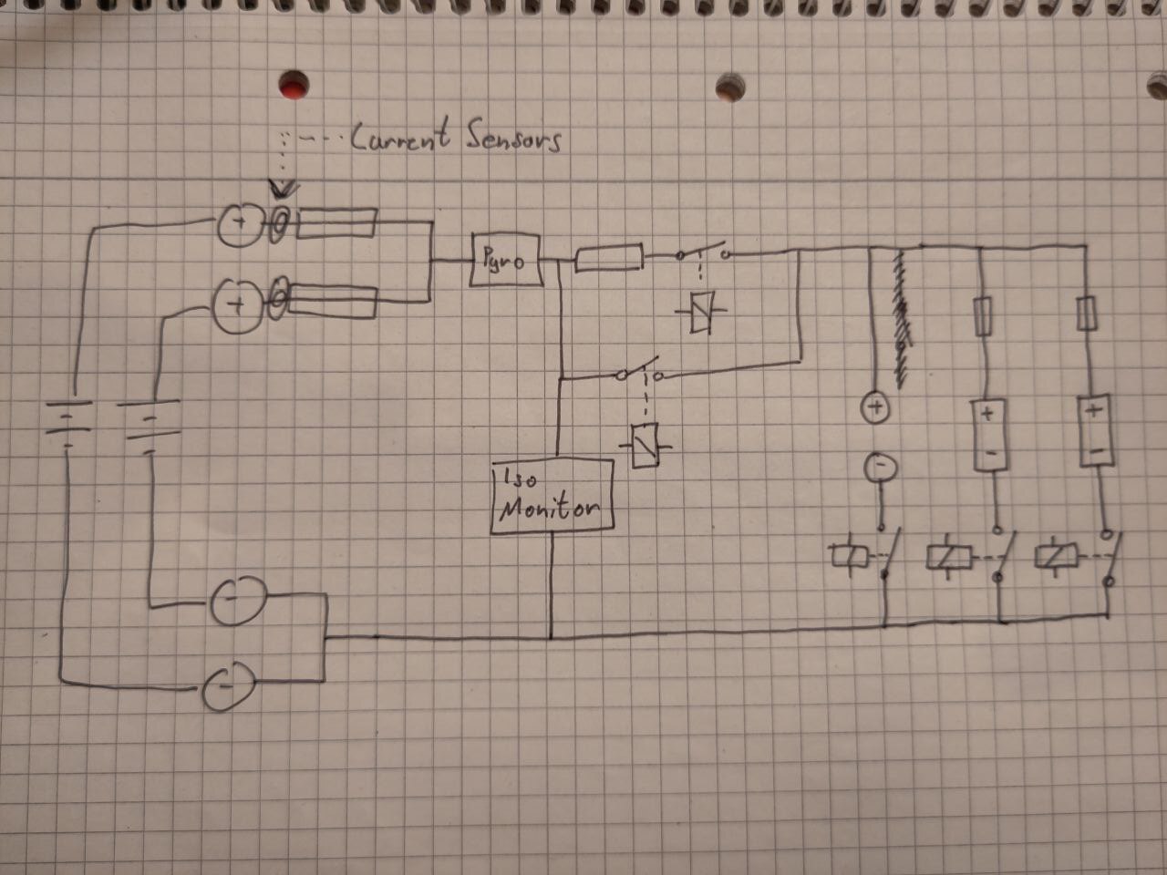

Thanks, marcexec! I thought about getting an MG ZS charger as well, since those are supposed to reach the relatively high voltage of the 104S pack. They are expensive, though and I'm trying to keep this project as low-budget as possible. Currently, I'm pondering just switching the OBC I have on and off in the 10 second intervals that it can charge, for now.
In other news, progress is slow. While inspecting the CAN log from a charging attempt, I noticed that the OBC reports 0 Amps and 0 Volts, but also no errors. This makes me suspect that the charging contactor might not even be closing. I hear multiple contactors click when plugging in the charging cable, but I can't tell which ones those are. If the OBC can't see any voltage anyways, I don't think there is any harm in disconnecting the HV DC plug from it and checking it directly. Only issue is that I can't get the thing off.

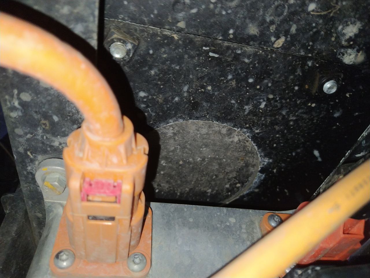

Does anybody know how to disconnect a plug like this? It's likely a Kostal-made plug, but they all seem to be different. It would probably be a lot easier if I was able to see the plug, but it's quite hard to reach on the underside of the inverter. I wasn't able to pull out the red part.
I tried connecting to the PTC HV lines (which wasn't very hard), but I can't get them activated anymore, since the battery is so low the vehicle is in limp home mode and won't activate the heater. Trying it while having a charge lead connected didn't help either.
The only HV lines that certainly get activated are those going to the inverter. It's a Bosch InvCON inverter, as it can also be found in the e-Golf. I'm hesitant to disconnect the big DC input leads, but it has a smaller connector for an AC compressor. Does anyone happen to know whether it is permanently connected to the DC input or somehow switched inside the inverter?
If all else fails, I will find someone to take the EV in tow with my ICEd van to regeneratively charge to get over the limp mode threshold. But that would be quite the hassle and I want to avoid that if I can.

marcexec
Posts: 239
Location: Dublin, Ireland
Has thanked: 1044 times
Been thanked: 111 times
Re: [FIRST DRIVE] StreetScooter Repair and Reverse Engineering
Post by marcexec »
According to the Wiki the Outlander Charger/DCDC stops DCDC'ing at 397V (~3.8V per cell for you) but not necessarily charging as it needs external control to sense voltage / stop. Even if it does, 60% is better than 25%, right?
First of all you have to get the connector off though, hopefully someone can recognise it?

manny
Posts: 197
Location: Netherlands
Has thanked: 59 times
Been thanked: 159 times
Post by manny »
Heye wrote: Thu Sep 25, 2025 7:51 pm Does anybody know how to disconnect a plug like this?
if it look like this:
te 2103177.JPG (6.73 KiB) Viewed 5109 times
I think you push the green bit and pull the red tab out a bit (might be stiff). Than push the orange bit in frond, than the connector should come lose.
Good luck

Thanks, you two! Definitely, some charging would be better than no charging. And I love the simplicity of the Outlander OBC. In another thread, @arber333 found out that the maximum voltage of it is indeed 400V. I would like to be able to charge close to 4.2V, to force the BMS into balancing. So getting the Outlander OBC would be kind of the last resort for me, to get the car going for now.
In the spirit of getting the car going for now, I managed to disconnect the connector in the middle of the INVCON 3.3 Inverter that was originally intended for an AC compressor. The full inscription is "TE 1587819 17237 2103149-17258". The trick for getting it off was to remove the gray cap first (sadly, I couldn't take pictures, because my phone was empty). That was quite hard to do and I still mangled it somewhat. I finally managed to remove it by sliding in one end of a pair of bent snap ring pliers under the plastic clip on the bottom. Afterwards, the plug could be removed by pressing down the orange tab, pulling the plug out a few millimeters and then pressing the red tab in and sliding the plug out completely. Amazingly, it does seem to be a straight (fused) connection to the big DC terminals, at least the voltage came up immediately, as the main contactors closed. The plug does have an HVIL bridge, but I overcame my constant fear of bricking something and having to go to that expensive workshop and tried without the HVIL jumper and it still worked! I'm pretty hopeful that I will be able to use that connector to charge, at least temporarily. That misuse of the AC compressor HV connector for charging is what most (all?) VAG cars with that inverter seem to do, which I find quite funny.
@manny, thanks, that connector does look very similar! It does seem to be compatible with the other one on the inverter. I don’t get why they don’t all have the same locking mechanism. I will try that out, soon.

The parking pawl motor saga continues. It remained locked basically every time I went to start the vehicle, which annoyed me very much. So I removed it from the vehicle (to unlock the parking pawl, the motor has to compress a spring, so it should be in the completely locked position for removing it) and opened it up, being careful to not let any dust/dirt/debris get into the motor or into the gearbox.
On the inside, it looks exactly like the description in the Fiat repair manual. A beefy DC motor drives a threaded rod with a weirdly sphaped nut on it over a 2-to-1 reduction gear. On the end of the motor is a magnet, that is used by two hall effect(?) sensors to register motor rotation.
The only thing I was able to do was to remove the old slightly crusty grease and replace it with some fresh grease. Afterwards, I ran the motor on a 12V battery for a few seconds, hoping that it might free up the bearings somewhat. After reinstalling it, I had to perform the reset procedure again, but it seems to have done the trick, as I was able to lock and unlock the parking pawl multiple times, without having any issues whatsoever.
Here's hoping that I don't have to touch that thing any time soon.
Notes:
  • Against the light suggestion (the words they use are DO NOT and MUST) of Fiat, I reused the bolts. At those low torque numbers, I don't see why not.
  • The geared motor (Nidec 405.712) also seems to be used in a Peugeot Partner Electric (Mk2)
  • The motor has to provide more torque for unlocking than for locking (because it has to work against spring pressure for the former), which would explain why it would lock, but not unlock.
  • Take note of the orientation of the nut on the threaded rod. If I recall correctly, the shorter flat side has to point upwards to the electrical connector.
  • I'm not an engineer, but I don't like this design very much. This issue seems to appear quite frequently, so I would guess that the motor is likely still undersized (even though it is already really beefy and heavy). The calibration procedure of having the motor slam into the endstop and observing the current spike isn't very confidence inspiring to me. They already have to have two hall effect sensors and an H-bridge for controlling the direction of the motor, how much more effort/expense could a third half-bridge for a brushless motor have been?

Speaking of higher priority, I got some weird behaviour of the HVJB inside the battery. I verified that when charging is activated, there is no voltage on the HV line to the OBC (except for the weirdness, more on that later).
To remedy this temporarily, I had the idea to connect the original OBC to the heater HV wires, since the circuity in the HVJB is pretty much the same for the heater and the OBC, so I thought I could charge by simply activating the heater while charging to get that contactor to close. Sadly, that didn't work. I didn't even get to connect them up, since I couldn't measure any voltage on the heater HV wires either (when connected up, the heater also doesn't seem to work). And I know it was working before! It really bugs me that I can't figure this out.
Interestingly, in both cases (OBC and heater), when the contactors closed, I could measure short blips of voltage (around 10-30V) on my multimeter. This feels really weird to me. Because it has to mean that something is happening on the wires, right? Sadly, I can't remember the wiring inside the HVJB and my phone with the pictures is a few hundred kilometers away right now. EDIT: I was wrong, I also took pictures with my other phone.
Heye wrote: Sat Jun 07, 2025 10:12 pm That's it for now! At some point, I might post about the insides of the HV box, but for now I want to focus on charging and balancing the modules. Tomorrow, I will start designing a safe connector.
Oh, well...
It might be possible that the HVJB is wired up in a way that would allow me to take negative/positive from the inverter wires and the opposite from the OBC wires, bypassing a broken (or non-activating) contactor, if there is one. I think I recall some weirdness in the HVJB circuit that might allow me to do that. The only effect should be that voltage to the OBC isn't cut when driving, which the e-Golf with the same OBC doesn't do anyways, so it shouldn't matter much? I still would like to avoid doing it, since it feels quite sketchy.
Another idea would be to connect the OBC directly to the inverter and build some electronics that connect to the charge port, the OBC, the cooling pump and the rest of the car. This would allow me to charge relatively normally (at least without an external charger and sketchy wiring), I would have a lot of control over the process and it might allow me to add Foccci later on. But the BMS still wouldn't be balancing after completing the charge, which is actually the main feature I want, because the cells still drift badly (on a positive note, it only seems to happen when 12V power is on, so it's likely just the badly designed BMS and not heater cells). Also, I would lose amperage control by the BMS.
If I were to drop the battery again (which I really would like to avoid, since at this time of the year you can only do it inside, which would be a problem in and of itself, since I don't have a place like that, I would likely have to leave the battery out of the car for some time and I would subject that place to liability concerns, since I'm not HV certified), I could investigate the contactors and the BMS control board more closely. If it's just a bad contactor, it would be an easy fix. But it doesn't seem to me like that's the case. Maybe there's a way I can test the contactors without dropping the pack. If I dropped the pack, I would have to at least extend the signal wires, so I can control the battery from the car and I would have to work under live voltage the whole time. I think I could do it safely, but it would suck very much. I really want to avoid doing that.
Alternatively, I could try to get a hold of a second battery pack (or even only the BMS controller board) and work on that without having the car attached at all. I might be able to write a new firmware for the BMS controller or, failing that, design a new board. This would have the advantages that I would also have a lot of control, wouldn't have to work with live voltage at all and I would likely do a better job than the original developers. Also, this would be the first step towards a LiFePo4 conversion that I would like to do anyways at some point. Of course, it would be difficult to do this legally. And if I had a second battery / a second BMS controller, why not swap it and simply have a fully operational battlestation car again? (Apart from the encryption issues, of course)
I could still go to the authorized workshop and let them have a look at it. I could also contact the manufacturer again. But remembering how uncooperative they were the last time I tried that, I don't want to. Maybe I should still do so, at least because of the whacky BMS. But how would I explain that I know the BMS is hurting the pack when I'm not even supposed to know the voltages? I think it's simply out of the question. I wish so much we had a right to repair for vehicles. Oh, well...

EDIT:
I did find some pictures and managed to piece together a quick and dirty schematic of the HVJB. Looks quite clean, to be honest. So far, I will be able to test or bypass (obviously in a safe way) the fuses without dropping the pack, but not the contactors.

Great success! Inititally, I had almost discounted the fuses as a source of error, because I was sure I would have seen some opticial damage, if they had been, indeed, damaged. Luckily, I was wrong! Measuring the voltage between the positive side of the OBC connector and the negative side at the inverter, I got no voltage. This prompted me to try measuring the other way round and indeed the contactor (which I had initially suspected to be broken) is fine! I then hooked up the OBC again, bypassing the fuse inside the HVJB with a DC breaker and (since the breaker is only rated for 6kA and I was afraid the OBC might be shorted, since something must have blown the fuse) my electric stove in series. To my surprise (and delight) it charged fine (after I added an HVIL bridge, which the OBC requires, unlike the Inverter).
As I don't want to drop the battery, I will construct a Y-cable with a proper fuse as a more permanent solution. I found a cheap HV cable with two HVA280 connectors (so basically two pigtails). VW part number: 5Q0971483B
Also, I found a blind HVA280 plug (P/N: 2103149-7). I'm quite hopeful that I can swap the housings between the plug on the cable and the blind plug, which will give me a universal (un-keyed) HVA280 connector.
This vehicle is becoming more and more usable! And now I can find out whether the currently existing huge imbalance will improve with longer charging/balancing time. Once I have built the permanent cable, I can even see a [DRIVING] tag for this thread :D (Of course that won't mean that I won't post here anymore)
