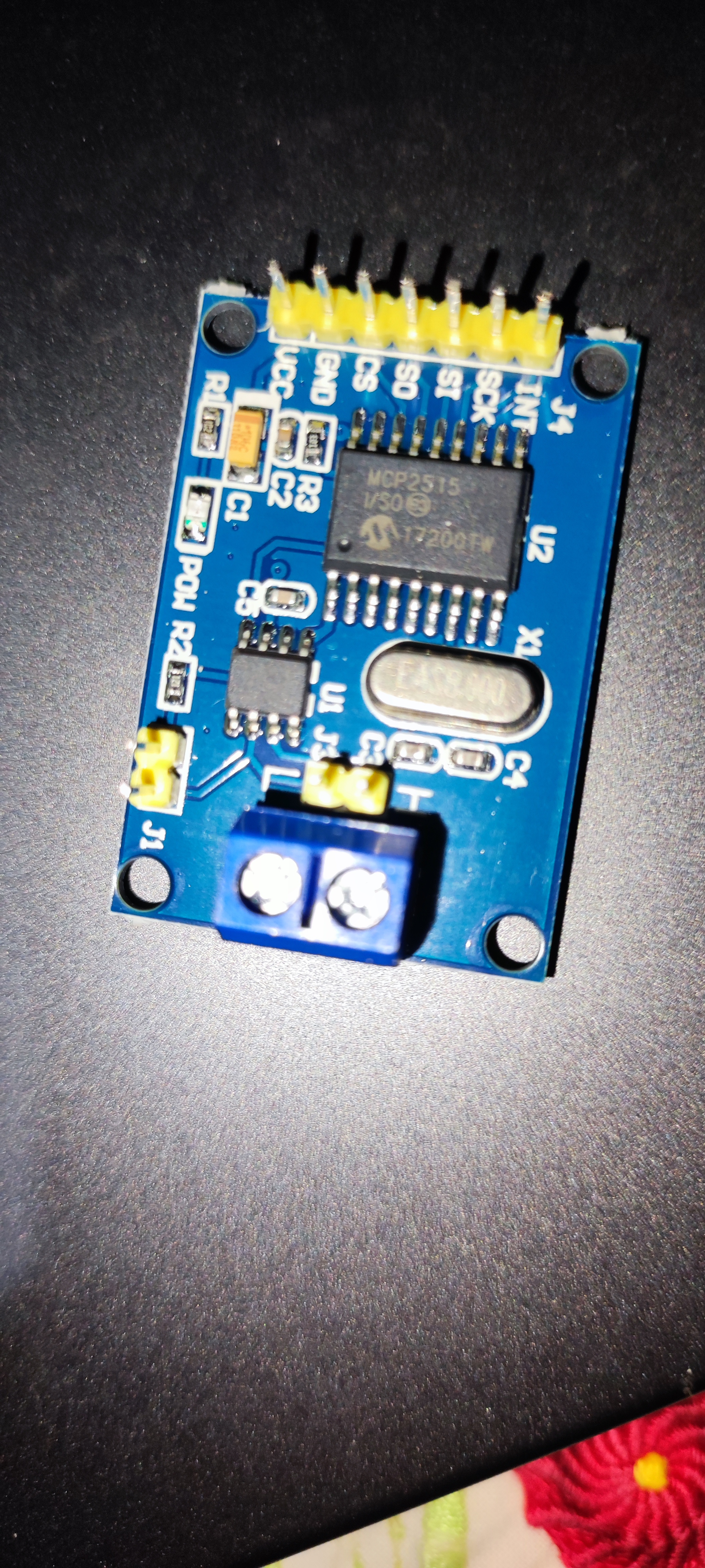

* I would consider the "P-CAN Bus off" and related P-CAN errors still as critical error. A stable communication on the P-CAN is essential to drive. Maybe you find somebody with a CANoe/CANalyzer for detailled bus logging, or just SavvyCAN to get an impression what is going on.
* The "E-comp interlock fault" means that the HV connector on the compressor is not fitted (or broken wire or something), this sounds like drive-preventing.
* Also the C-Can bus off of the E-Shifter sounds critical. Also for this, an analysis of the CAN communication on this bus may help.

Re: Hyundai Kona won't start just turns on but will not go on drive.
Thank you.
I think i have can modules i bought sometime ago. Need to look for them. I also installed can hacker.
Joining the wires to just replace the brake switch brought the shifter back to drive and neutral.
Will try and find a brake switch and move on.
Will also replace the 12 volt battery. Getting unstable battery voltage
Hopefully some more issues would be cleared
