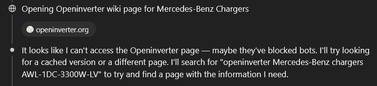

Glad to see you deployed Anubis. It's made the forum and wiki so much snappier than any time I can remember. Thanks!
It's an arms race. I hope the bad guys take a long time to find a way round.

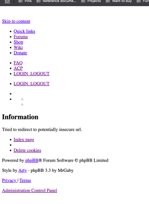

Unfortunately kevpatts is no longer able to log in no matter which browser he tries:
Also the spam via the shops inquiry form has magically stopped as well

I've been contacted by someone else having this issue too, it's only once logged in, at least in their case.
- Been thanked: 1913 times
Re: DDOS Attacks / AI botfarm overload
Maybe this? https://www.phpbb.com/community/viewtopic.php?t=2629811
The forum is actually running on localhost now and is proxied to the outside world with nginx reverse proxy

In case you have trouble logging in try going via https://openinverter.org:8444/forum/

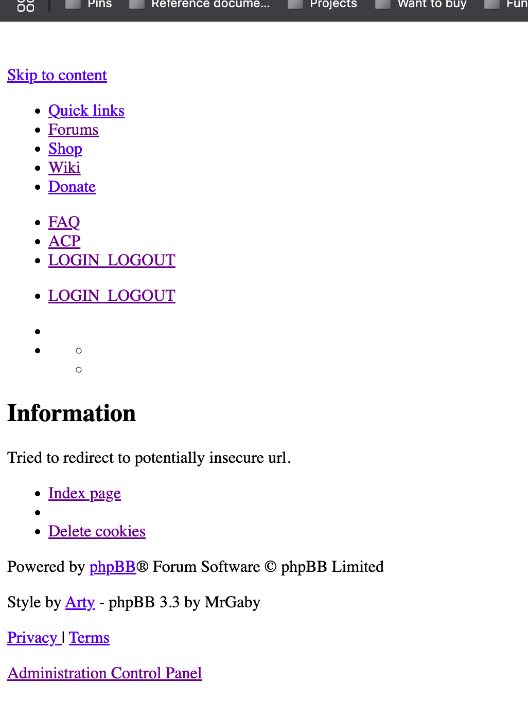

I was trying to log in this summer for few time and it didn't work, it just went to error page saying: tried to redirect to unsecure url?
I tried at work pc that i have never used to visit openinverter.org and same error.
Made a new account. Worked first time.
Maybe I havent logged in during 2025 and got disabled.
My account has been going to this page for some time, and now I made new account and it just works.
Yes I did prune accounts that never posted and weren't active in 2025.
Others had the login issue as well, I set up and unproxied instance at https://openinverter.org:8444/forum/
When having trouble it's worthwhile to log in there then go back to the standard URL
