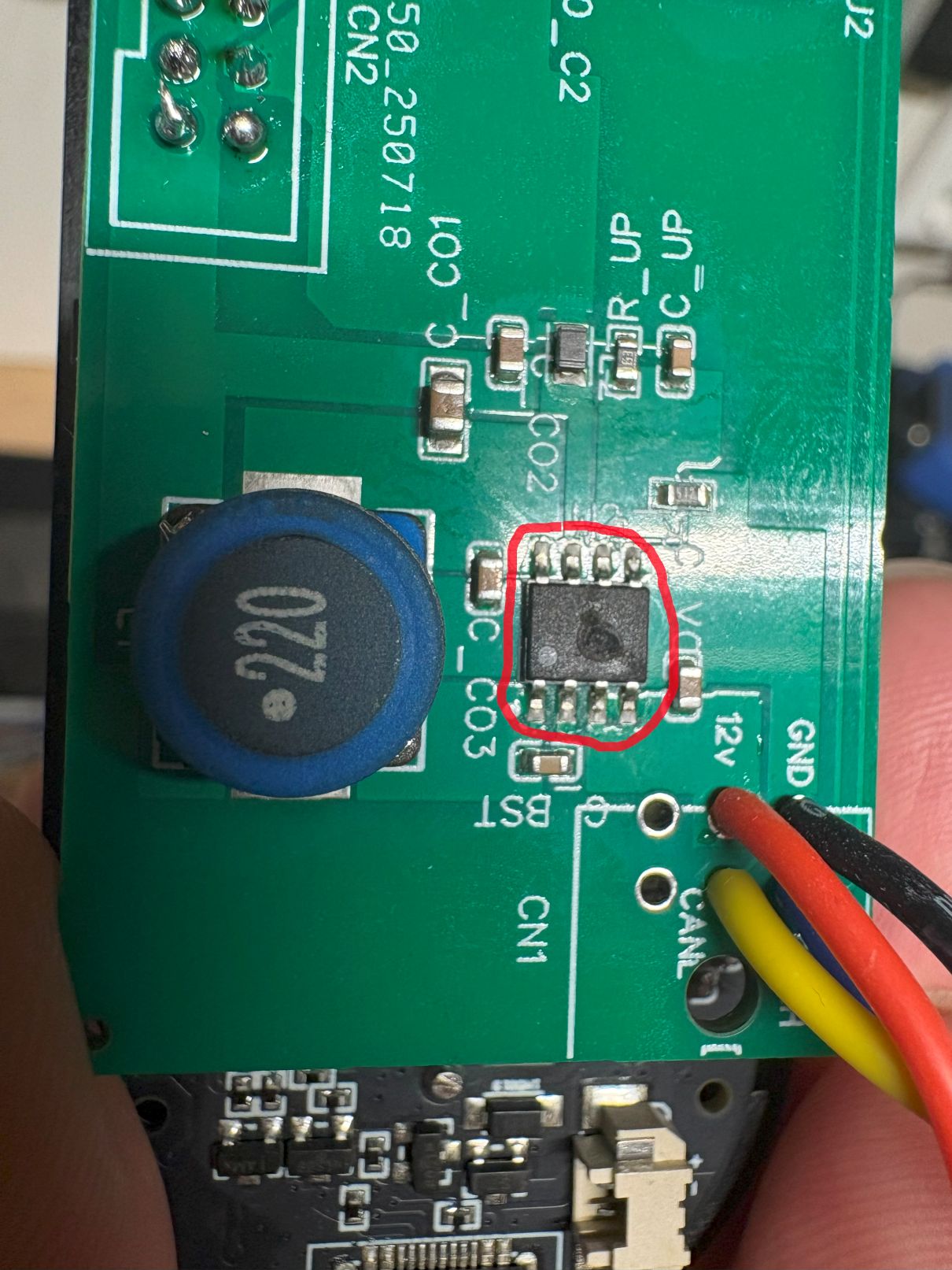

Thanks, I got it programmed and updated via OTA (now with working spiffs). If you know what you're doing it's not that hard at all
But still no communication with the Zombieverter. And when I was looking what happend on the can bus, the ground wire fell on a live 12v contact
. Resulting in smoke. The Lilygo does nothing anymore
. The board is also broken. The part circled in red is burned out. Do you know its part number (I can read D9 and the rest is burned)? Then it might still be salvageable.
If the board is beyond repair, is it then possible to use an SN65HVD230 CAN Tranceiver Module?
I have the ESP32 CAN Web Interface & datalogger, which also refused to communicate with the Zombieverter. I just found on the forum that this needs to be on can1, because the ESP32 module uses SDO communication, which is only on can1. Does this mean that the Lilygo has to be on can1? I had it on can2. This means I have to switch can1 and can2.
I try to get this communication issue solved before I order a new Lilygo.

- Posts: 1884
- Has thanked: 91 times
- Been thanked: 517 times
Re: ZombieVerter Display
That's not the can transceiver, it's https://item.szlcsc.com/137138.html but the can chip might be dead too. I've got 1 board left, I'll stick it in the post to you.
SDO should work on either interface with the looks of it, but you could try changing the ODB2can in zombie.
canInterface[1]->RegisterUserMessage(0x601); //CanSDO
canInterface[0]->RegisterUserMessage(0x601); //CanSDO

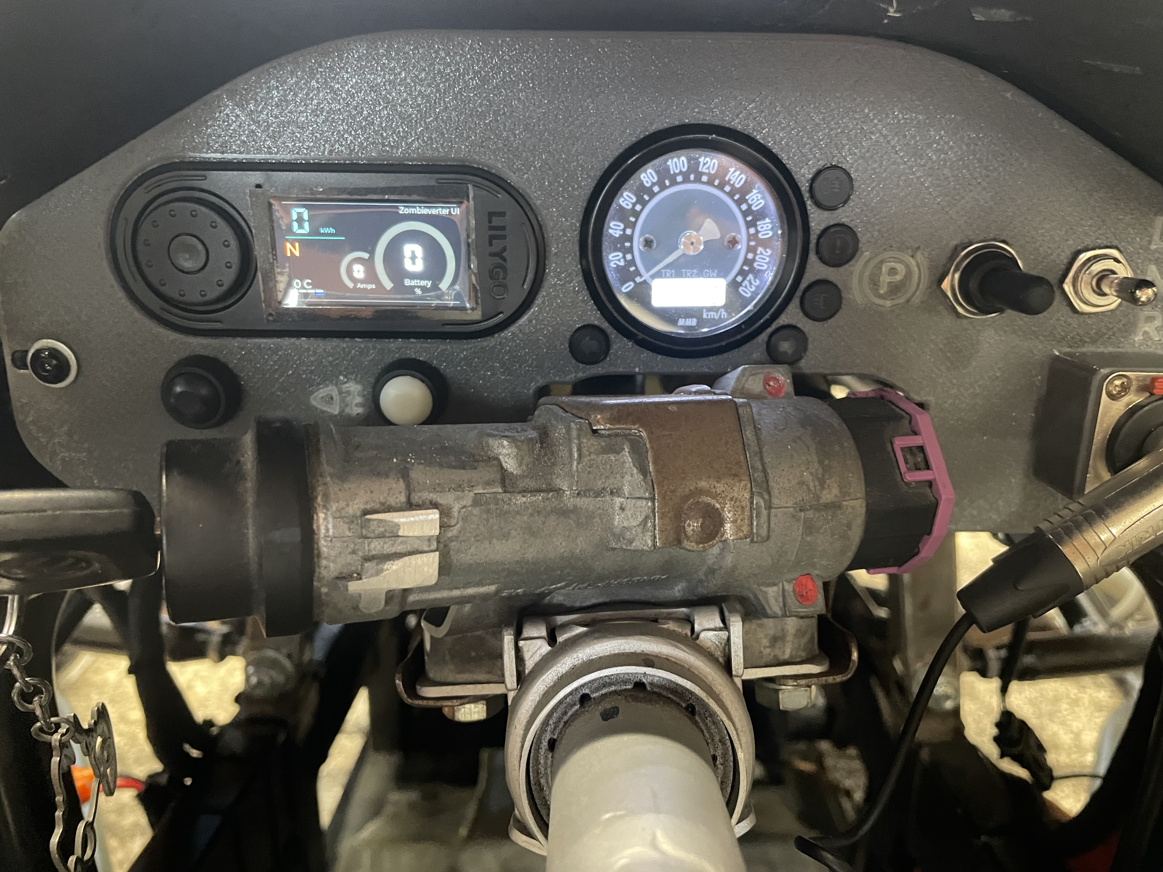

JanJouke
- Posts: 42
- Joined: Fri May 12, 2023 8:28 pm
- Location: Breda
- Has thanked: 4 times
- Been thanked: 12 times
I have the Display working. The new chip, which I soldered on the board exploded, so it is beyond repair. So thanks again to Jamie for the new board. But I also got the Lilygo working with an regular can module and usb power (so you can use the Zombieverter Display without the special board).
I made a video about it. It took me a lot of effort to get this far, so maybe the video can help someone to get it a bit faster.
