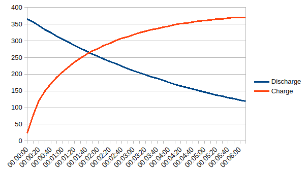

More thinking out loud :)
Measured some times (bus charged to 370V, well above threshold of 160V):
0:00 Send start command
2:15 Standby to Startup
2:25 Click
2:45 Start Boost
2:50 Error
Then the HV supply, cranked up to the max setting:
It takes 6 minutes to reach 370V and doesn't go any higher. As expected voltage drops very quickly when turning it off and steps right back up to bus voltage when re-enabled.
So now we have to time the CCS state machine to connect the battery at around 2:30 minutes. The big question is, how will cars react if they see voltage before CableCheck? I think this should be avoided, making it even more challenging.
So we precharge the inverter to 370V and as soon as we enter state CableCheck we need to turn off the HV supply
Then:
  1. Enable inverter
  2. We hope to reach ContractAuthentication after 0:30 seconds - voltage has dropped to 330V
  3. ContractAuthentication enable inverter - stay in ContractAuthentication until enabling the inverter is 1:00 minute ago
  4. We hope to reach CableCheck after 00:10 - voltage has dropped to 300V (1:10 minutes ago since we turned off HV supply)
  5. Enable HV supply, stay in CableCheck for 1:00, voltage will rise to 330V
  6. Change to Precharge, now its up to the car to proceed to the next state.
  7. Enabling the inverter is now 2:00 + precharge time ago. We can spend at most 0:40 seconds in Precharge, because then the boost converter is started and the contactors must be closed by then. So max 350V it possible
  8. Spent the remaining part of the 0:40 seconds in PowerDelivery
  9. Once we've reached CurrentDemand the HV supply can be turned off
With this timing we should be able to deliver current shortly after reaching current demand. Then its up to the car whether we can also draw current.
For cars that don't time out we can proceed to CurrentDemand as quickly as possible and the car will just sit there until the inverter has started up. This makes stuff much simpler:
  1. Assume Bus precharged to 370V
  2. We see PP, turn off HV supply and enable inverter
  3. Proceed to CableCheck as quickly as possible, say 0:30 seconds. Voltage will have sagged to 330V
  4. Enable supply, finish CableCheck let the precharging happen, say 0:30 seconds for 350V
  5. After about 2 minutes the inverter will deliver or draw current

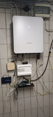

Big update on this. I have removed the old 1.5 kWh storage system and now rely solely on the Sungrow inverter to shift all the power around
I connect V2x and the stationary battery via a changeover relay. It would be great to change over from the stationary to the car battery without powering down the inverter.
To give the inverter something more to do I connected some PV panels to it:
In summer this yields 2-3x more energy than I use on a typical day. Will now stick a dumb heater in the warm water reservoir and replace some natural gas with it.
I've ordered a small cabinet to tug it all into

Re: Bidirectional charger with PV Hybrid inverter and pyPLC
Posted: Thu Aug 14, 2025 8:42 pm
by johu
Finally got around to make this look nicer.
Tied everything together in one box
Looks more tidy with the lid on
Whole system
And finally even did some labels
My label "machine" doesn't have a + sign. But I have a bit of a thing for outdated equipment ;)
Will connect the inverter directly to the distribution box above it and free up the the CEE outlet for the traditional EVSE. Plus some more cable management and it should like real shiny :)
Functionwise does the same as before

johu wrote: Wed Jul 02, 2025 7:03 pm Big update on this. I have removed the old 1.5 kWh storage system and now rely solely on the Sungrow inverter to shift all the power around
Your FoccciCape is working great.
Had to do some hardware stuff the last week. Build an Y-Kabel to break up the CAN communication between my SMA Inverter and BYD Battery and connected now the SMA on can1 of the foccci and the BYD on can0. With your scripts as basic I already managed to control the energy flow with Netzero, although I had this before with my SMA environment (Sunny Home Manager controls my SMA Inverter). This is pretty cool now, because the SMA Energy Meter publishes every 250ms an UDP packet that shows the energy flow, so your netzero with the picontrol is equal or maybe better then the SMA version - and could be controlled...
The CAN script actually only passthrough the can communication until I am able to emulate my SMA inverter another battery. The emulation on the SMA inverter seems to be a little tricky.
Regarding the Foccci and your scripts I have some questions regarding the switchoverrelay. Which one are you using for that? If I understand all scripts right you are only swiching over when the inverter is in stop mode - so no energy flow is active. Before the moment of switching to the car battery, are you precharging the inverter to the voltage of the car battery over the precharging pin? Otherwise I'm little bit anxious because my car has something about 400V and the inverter input has only something about 320V from the BYD Battery, and if, how are you doing it?
