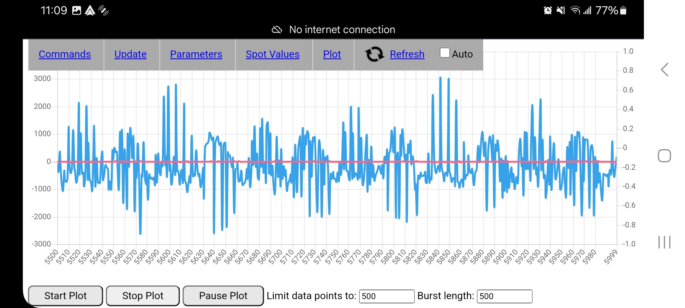

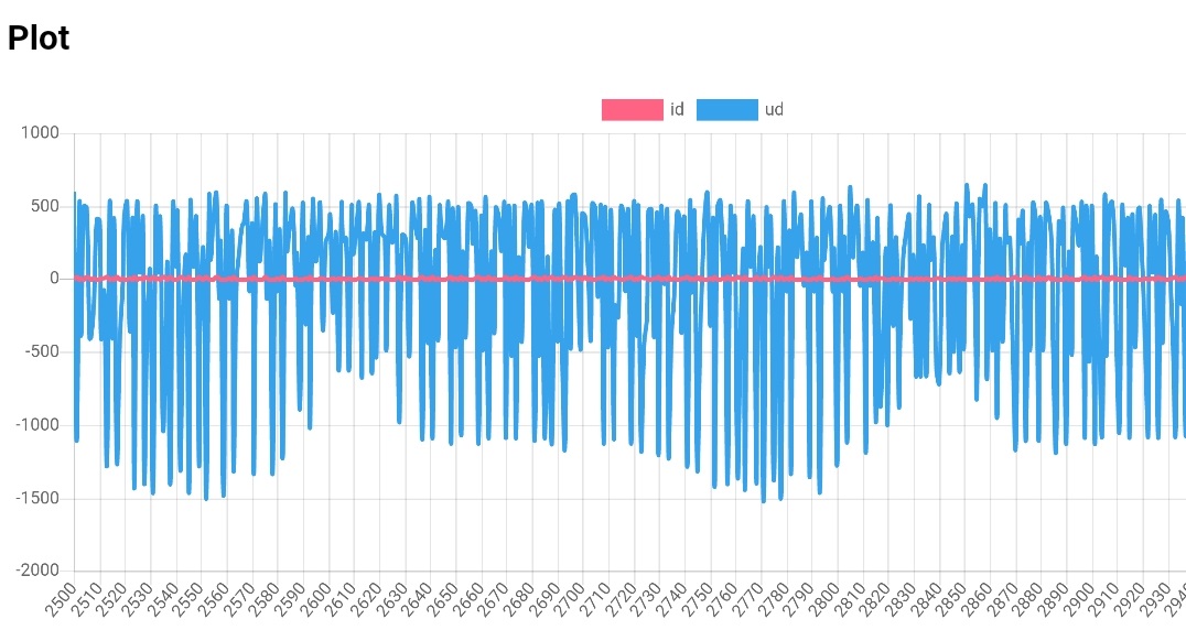

Follow up to this, I increased my fwcurmax after realizing it should probably be -500 instead of -400. That got be better acceleration at higher speeds (BMS reported 130-some kW and the battery wasn't even full!) but as soon as I let off the accelerator, it started accelerating on its own again.
I noticed the parameters wiki page says this about syncadv: "Must be set so that ud remains at 0 when coasting below field weakening speed". So I did some slow-speed coasting and ud was bouncing between 500 and almost -1500. How close to 0 SHOULD it be? Or is it more like it should be 'centered' around 0? I tried reducing syncadv from 9 to 6 and that seemed to shift the numbers to something closer to +/- 1000. I didn't dare drive faster at that setting though.
Is it possible that I should be setting syncadv to something like -10 (Or, I guess, 65525) because the motor is running in reverse?

Re: Inverter Firmware 5.35.R
yes
No, that is handled in code
advancedAngle = angle + dir * FP_TOINT(FP_MUL(Param::Get(Param::syncadv), frqFiltered));

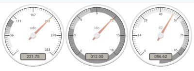

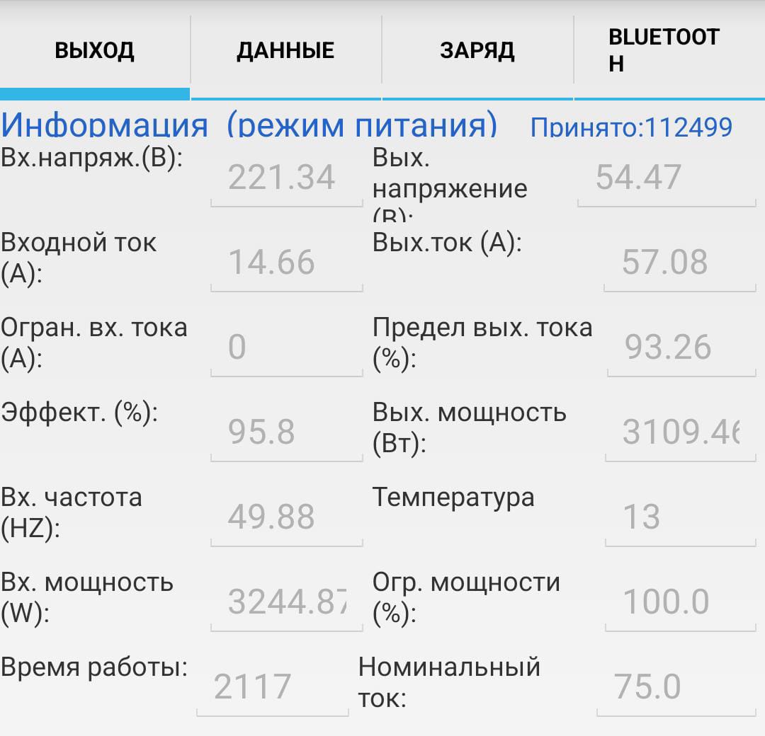

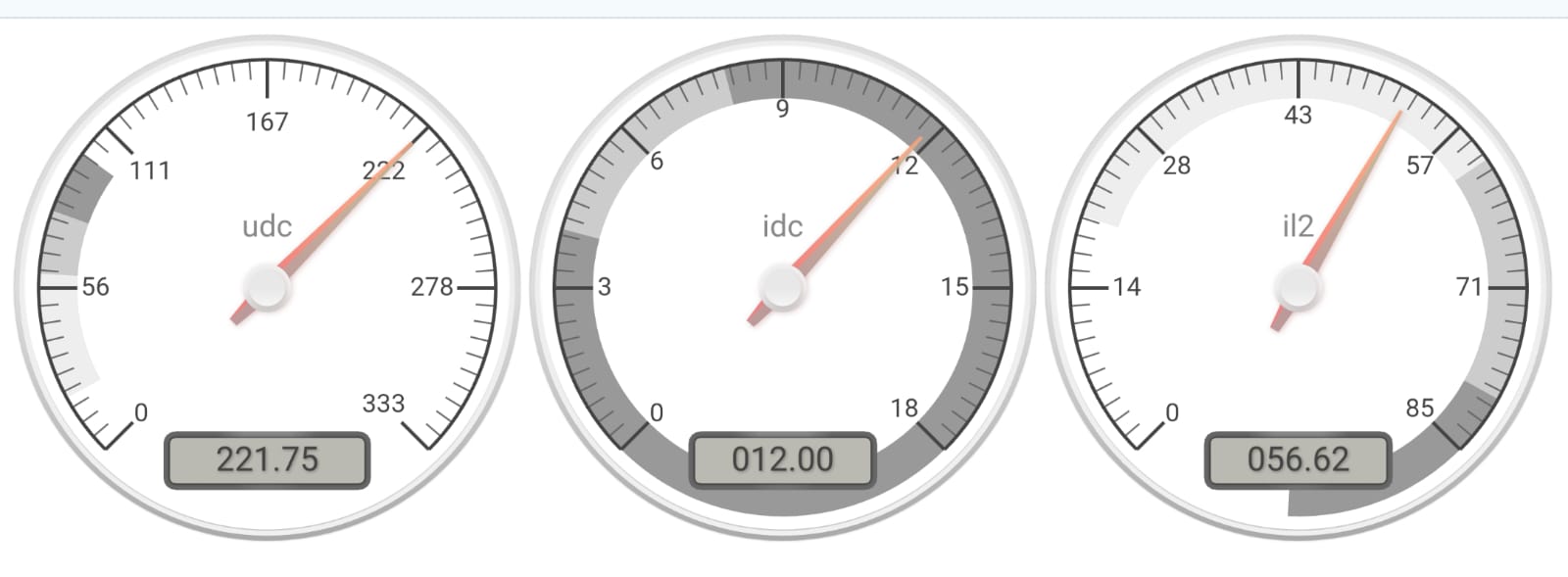

Is it possible in future releases to increase the charging current limit to at least 250 amps instead of 50?
If you use boost mode from a 220 volt home outlet via a diode bridge, everything is fine and the 50 amp limit is sufficient.
I use a 72-cell battery and a full voltage of 304 volts.
for boost mode, I use a 50 volt 75 amp power supply, but the firmware limitation does not allow using all available power.
in the future, I would like to use three such power supplies in a type-2 three-phase network, but the total current value would be more than 200 amps, and the setting allows only 50
the first screen is the operation of the inverter in boost mode. The input voltage is 54.5 volts. The input current is 57 amps.
oh, crazy
Yes can change it
