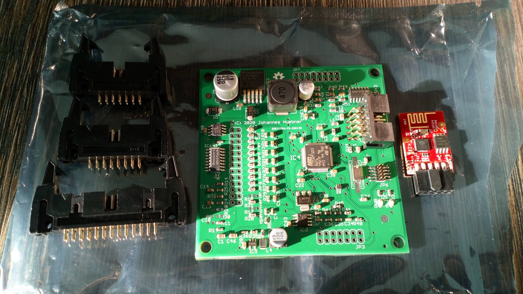

Re: Mainboard V3 FAQ
Yay! Board has arrived! It became 20 euros more expensive, but nothing we can do about that
Need to find some relays and try to connect it to prius inverter.

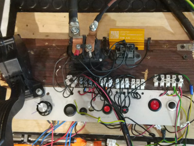

I am doing the same (on-desk car simulator). I found if I turn on the HV Manually through the pre-charge resister and then the contactor to bypass the pre-charge resister after 10 seconds, I never get PRECHARGE-STOP.
And one other on-Bench mystery has been solved, the Warn-LowResAmp. Rotate the motor and it doesn't come up either.

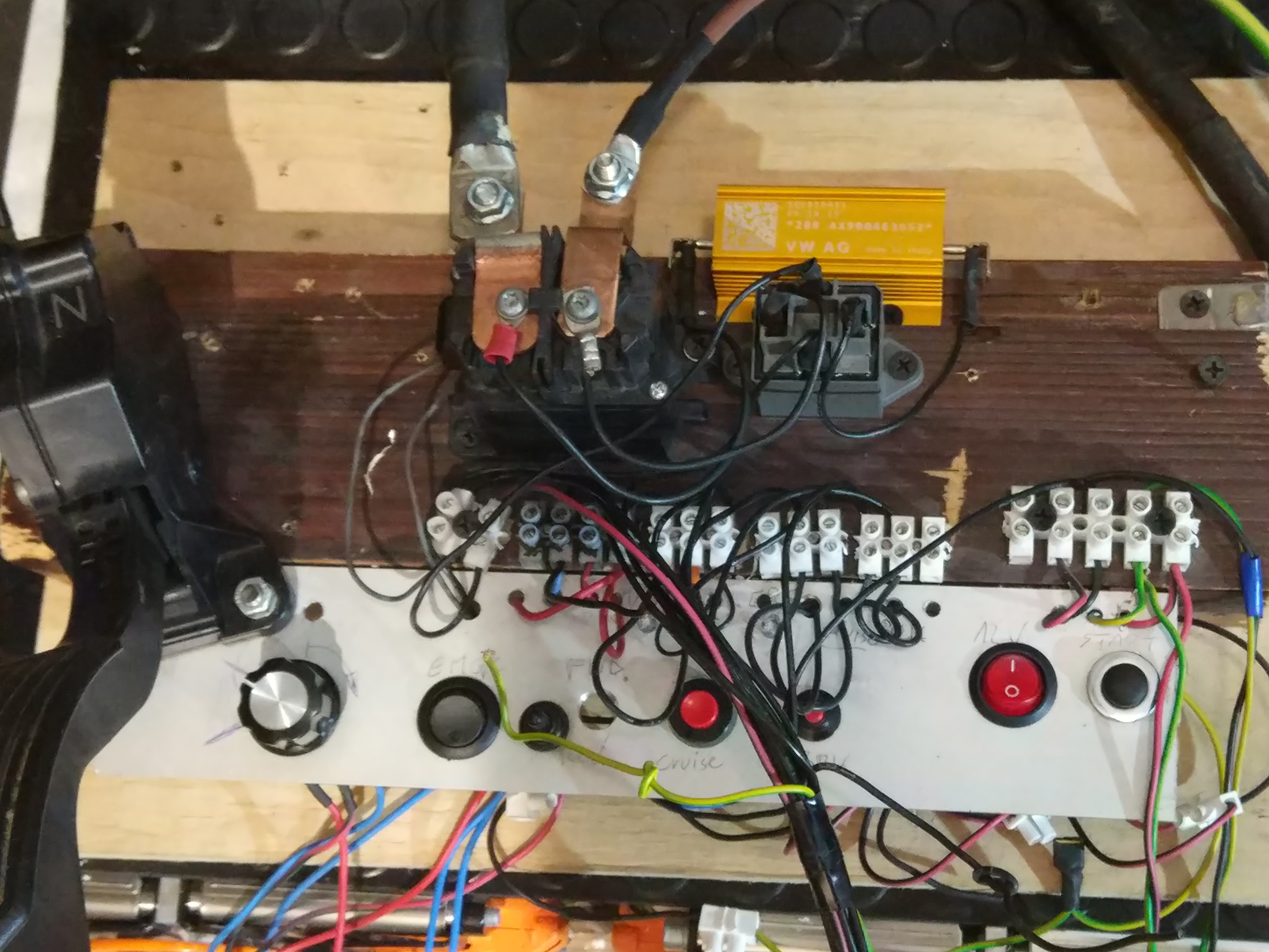

Hello again
Today, when I almost finished waterproof cover for underbody battery, delayed start of inverter I tried to start motor like always and... strange because it welded both main relays!
What I checked:
- if 12V is NOT applied to inverter, signal low (means GND) goes instantly to out_PRE and out_DCSW all of the time
- if 12V is applied to inverter, signal low (GND) goes to out_PRE and after 5 seconds opens if HV doesn't reach udcsw
Because of this probably at full current both relays close and weld contacts, because I had GND and 12V on coils
So, now is my question - what can be wrong? Is somewhere in software parameter what to do with outputs if inverter is off?
Ok, I solved this with small relay which is controlled by inverter supply, so if 12V is present at inverter power input, I have also enabled 12V to Pre/UDCSW high side.
Second - like Johannes and Arber suggest, witch emergency button I cut only direction line, but contactorst stays on, it's more safe for power stage.
