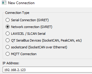

You can check the following. While still connected with the cable to the arduino IDE, open the serial monitor in the Arduino IDE. Press the reset button on the board. You should see some logging in the serial monitor.
wifiMode1
WifiMode is 'station'. Connecting to PlischUndPlum
[  1903][V][WiFiGeneric.cpp:355] _arduino_event_cb(): STA Connected: SSID: PlischUndPlum, BSSID: dc:15:c8:0a:66:3c, Channel: 11, Auth: WPA2_PSK
[  1905][D][WiFiGeneric.cpp:1039] _eventCallback(): Arduino Event: 4 - STA_CONNECTED
STA Connected[  1912][V][WiFiGeneric.cpp:369] _arduino_event_cb(): STA Got New IP:192.168.2.123
[  1923][D][WiFiGeneric.cpp:1039] _eventCallback(): Arduino Event: 7 - STA_GOT_IP
[  1928][D][WiFiGeneric.cpp:1102] _eventCallback(): STA IP: 192.168.2.123, MASK: 255.255.255.0, GW: 192.168.2.1
STA IPv4: 192.168.2.123
WiFi connected
IP address:
192.168.2.123
telnet is listening
This log shows whether the connection to your home network was successful. What do you mean that "wifican is not detectable"? You could check in the web interface of your router, whether you see the device. In my case, I have a FritzBox router, it looks like this:
It is normal, that you do not see the wifican in the wifi list of your laptop. Because it does not create a own network, it uses your existing home network.
When the SavvyCAN and the wifican is in the same network, the SavvyCAN auto-detects the IP in the connection window:

I'm back at home. I must be missing something.
I can get SavvyCan to connect only when in "field mode".
It means I can't have internet at the same time.
In Serial Monitor, there are simple "blank squares" and then "x" between them. If I press the "reset button" , the "sqares" and "x" keep running on.
Since I am not sure of my connection, I am not sure to be capturing CAN data
Edit : For info, I can "capture CAN" messages in "field mode". My objective is to send messages to different light signals and instrument cluster RPM on this cluster. This experiment is preparing me for installing and working with a VW 3.6kw charger......

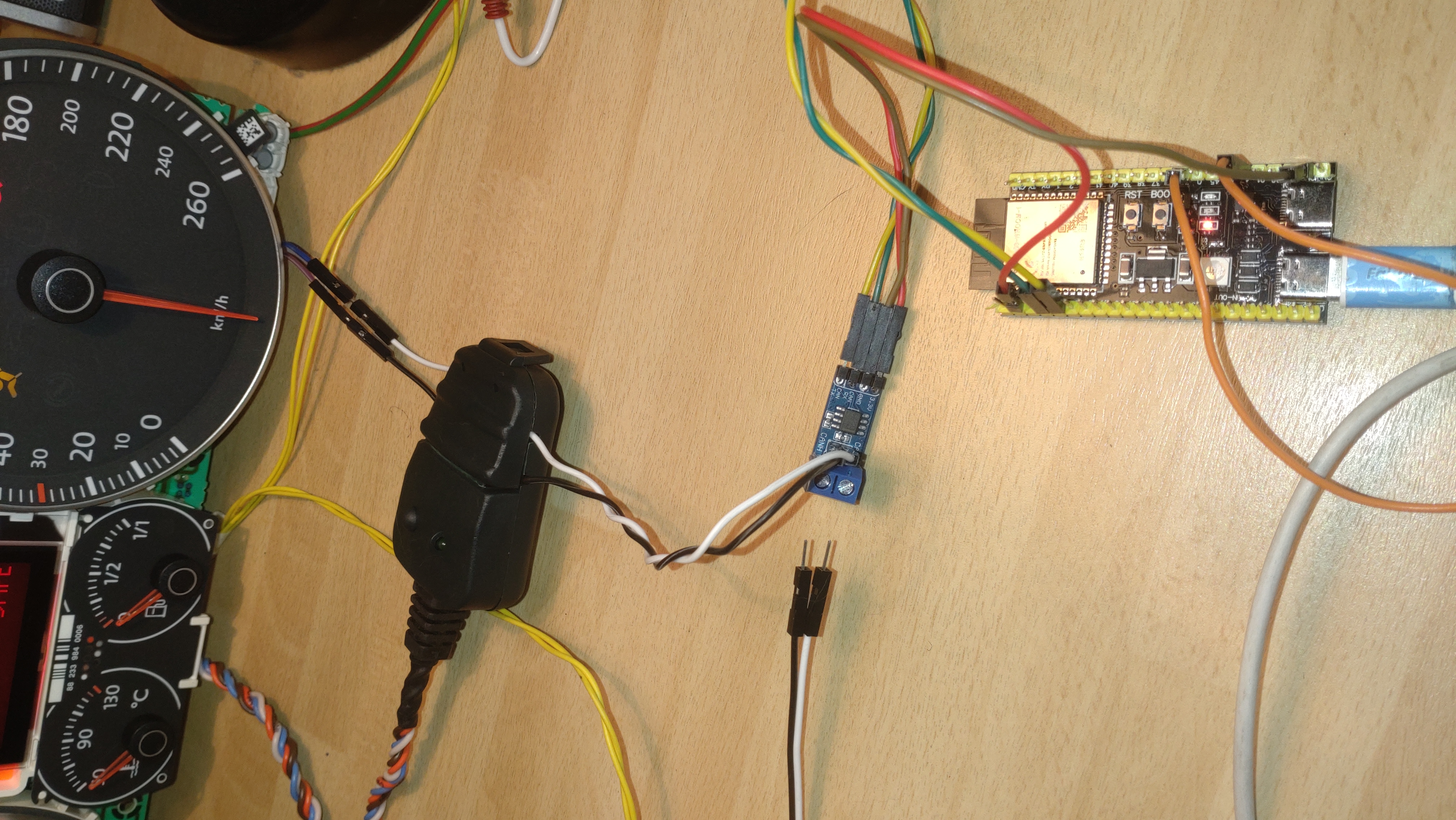

So, thought I would move this discussion here because I think my setup is linked to the ESP32 config, and hope to find a work around to use the CAN Crocodile with it.
If I connect a second CAN Transceiver in parallel to the initial one setup with wifican, the Bus seems to shut down. This is when connecting the TX and RX and/or the CAN-H and CAN-L to the existing setup.
If I simply give the Can Crocodile +12v and GND and connect it to the CAN bus, it picks up traffic, and doesn't shut down the BUS.
If I then connect the CAN lines to the two remaining connecters for CAN on the initial transceiver, the bus shuts down.
It seems I cannot conect the 2 on the same BUS.
At the same time, If I connect the CAN crocodile to my working Golf VI, the data doesn't seem coherant iether.
Any thoughts?
