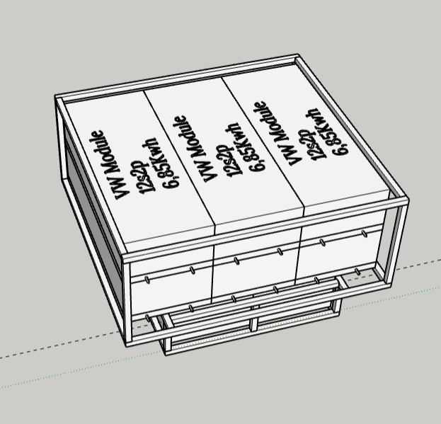

Now that the car is finally in the garage, I’m starting to think about the battery setup. I’ve decided to go with 8 modules of VW 12S2p batteries from the VW ID.3 or Cupra. And yes, I know cardboard boxes can handle *anything* :) I’ll try to scan the inside of the engine bay for better precision. I still need to figure out which mounts to use to keep the battery box stable and secure. I’d definitely welcome some help with that!
In November, I bought the battery, as mentioned—a VW ID.3 62kWh. I’ll only be using 8 modules, which gives me 55kWh. While waiting for the battery to arrive, I started dismantling the IRS. After 40 years untouched, it definitely needs a refresh.

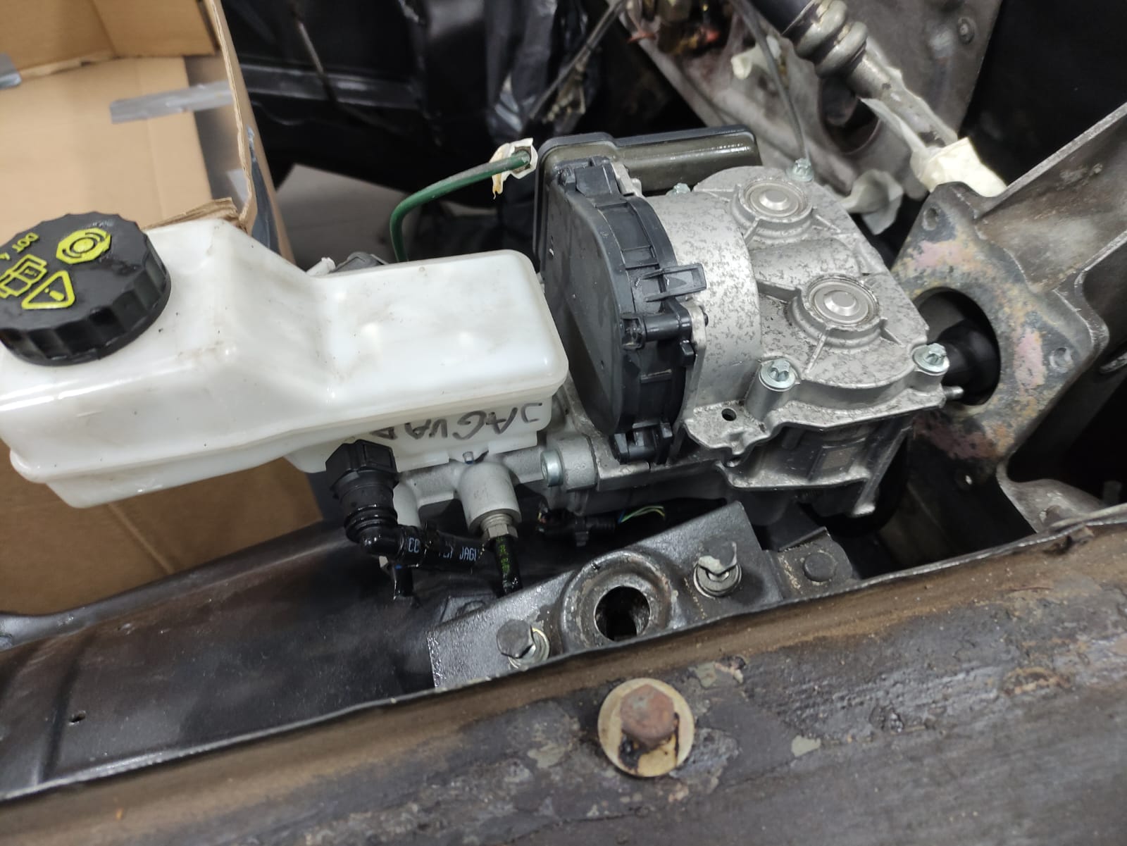

New day.. new challege
I bought the new Jaguar brake booster but, the Pushrod to pedal is too long. Now, I should swap the original one with the new one but I have no idea how to open this 😃
Re: Jaguar XJ6 V12 will be electric!!!
Posted: Tue Dec 10, 2024 11:03 am
by DVD3500
Is there space under the hood/bonnet to use spacers to move the whole cylinder back a bit?
Posted: Tue Dec 10, 2024 12:22 pm
by Tachopis
Although I don't have the hood installed, there is space above. The problem is behind and underneath, where the wheel arch is. I'll check it carefully.
Posted: Tue Dec 10, 2024 1:26 pm
by Uppertown
Have you looked at Lar's web site? Lots of useful information on the I-booster
https://www.evcreate.com/installing-the-ibooster/
See this too from Greg;
viewtopic.php?p=50084#p50084
Posted: Tue Dec 10, 2024 2:44 pm
by Tachopis
Thanks, yes I actually took the info of the part from him, very great blog. And Greg is also aware of the part I have. I just have to figure out how to reduce this Pushrod.
Posted: Tue Dec 10, 2024 2:46 pm
by Tachopis
Other option will be use other booster :) a smaller one
Posted: Tue Dec 10, 2024 2:58 pm
by Uppertown
Tachopis wrote: Tue Dec 10, 2024 2:44 pm Thanks, yes I actually took the info of the part from him, very great blog. And Greg is also aware of the part I have. I just have to figure out how to reduce this Pushrod.
The push rod should look somewhat like this;
just unscrew the clevis Cut off the amount you need ( you might have to thread a bit more of the rod) then screw the clevis back on. Adjust the length until you need to depress the brake pedal very slightly before the clevis pin will go in to ensure the master cylinder piston can fully return. Before you plumb it in check the cylinder runs out of travel before the pedal.
Posted: Tue Dec 10, 2024 3:08 pm
by Tachopis
Great, thanks I will try that. Probably I will change the clevis for the old one if fits. I will keep posted my progress. Thanks again ;)
