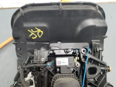

asavage wrote: Tue Jul 18, 2023 8:31 pm One issue I see -- which is also an issue with other CCS inlet ports -- is that the rated current for the AC pins is only 32A; as you know, we can draw up to almost 40A.
I just purchased a 2021 Porsche Taycan right charge inlet port via eBay; it is CCS1 and also AC 48A capable (base models charge(s) @ 11kw). On the Taycan, there are two charge ports, but only the right one does CCS; the left one is L2 only -- though 48A L2!
For any reasonable price I could only find Aliexpress CCS1 ports that supposedly can handle 40A+ AC, and I don't trust any of the sellers I saw; so many of the written specs are contradictory. Porsche parts I can reasonably expect to pass muster.
