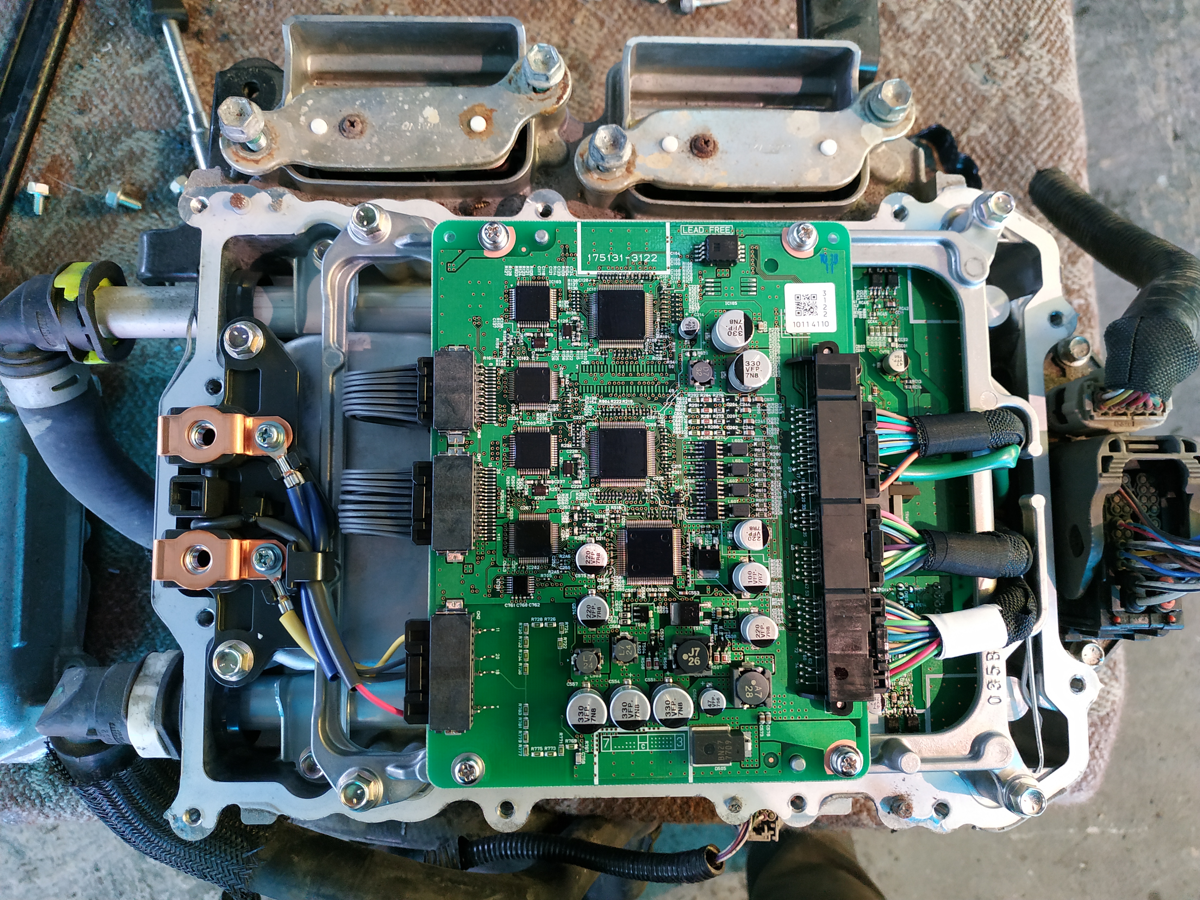

Excellent. I probably have the same Avalon - Camry inverter for the American market, the same as the ES 300h Lexus. If it suits me, then sell it to me for such a fee. There are many such invertors in Georgia. How much does the computer board cost and is it suitable?

Lexus GS450H VCM Please tell me, is this board suitable for the Camry-Avalon inverter
? You can buy it, can't you, Damian?
