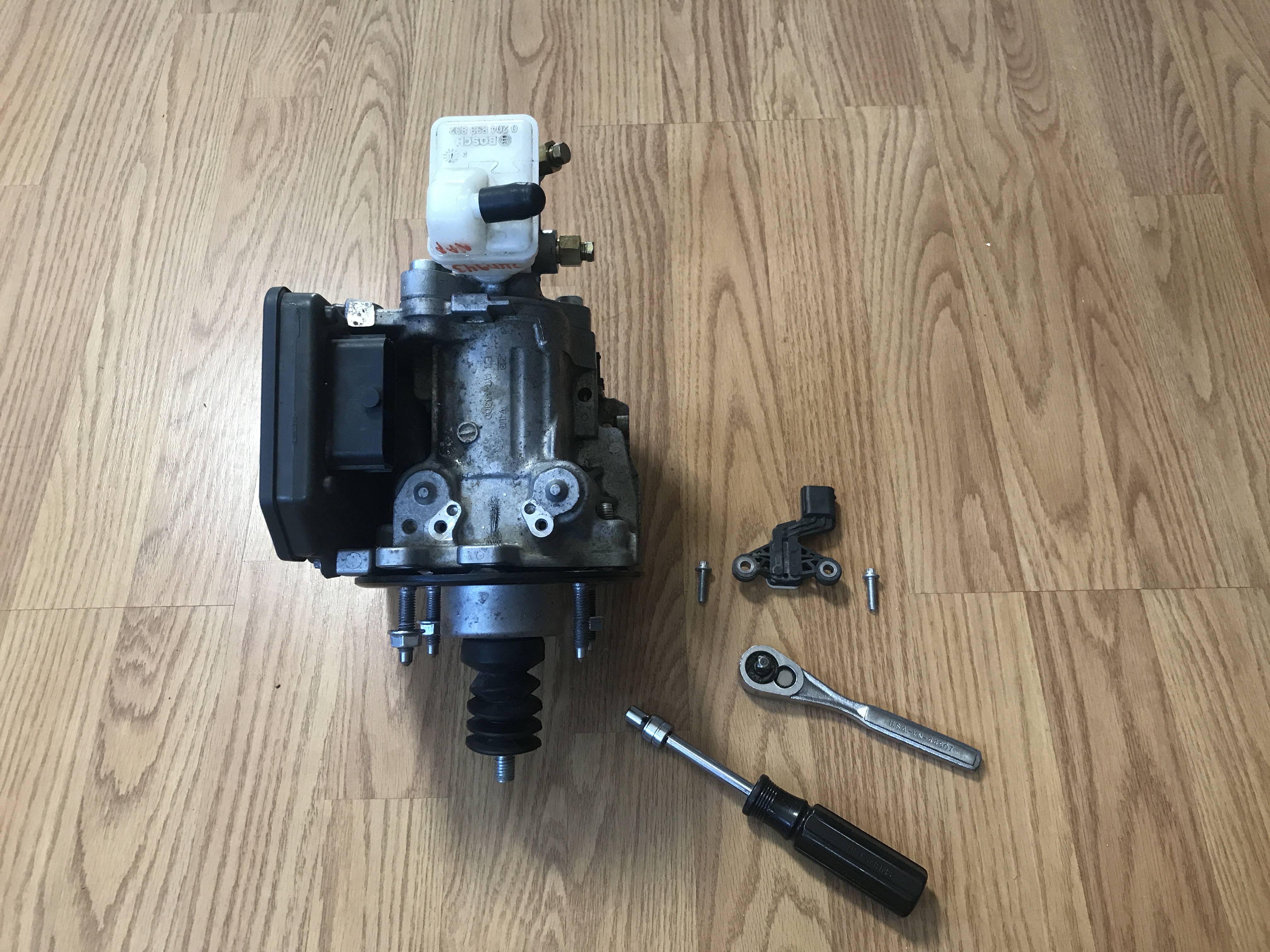

I bought a Honda CR-V iBooster Gen 1 - Now what?

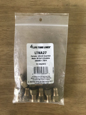

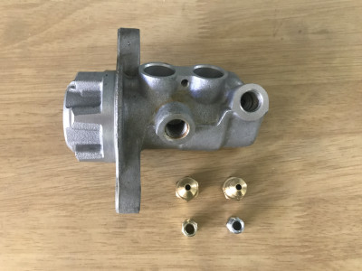

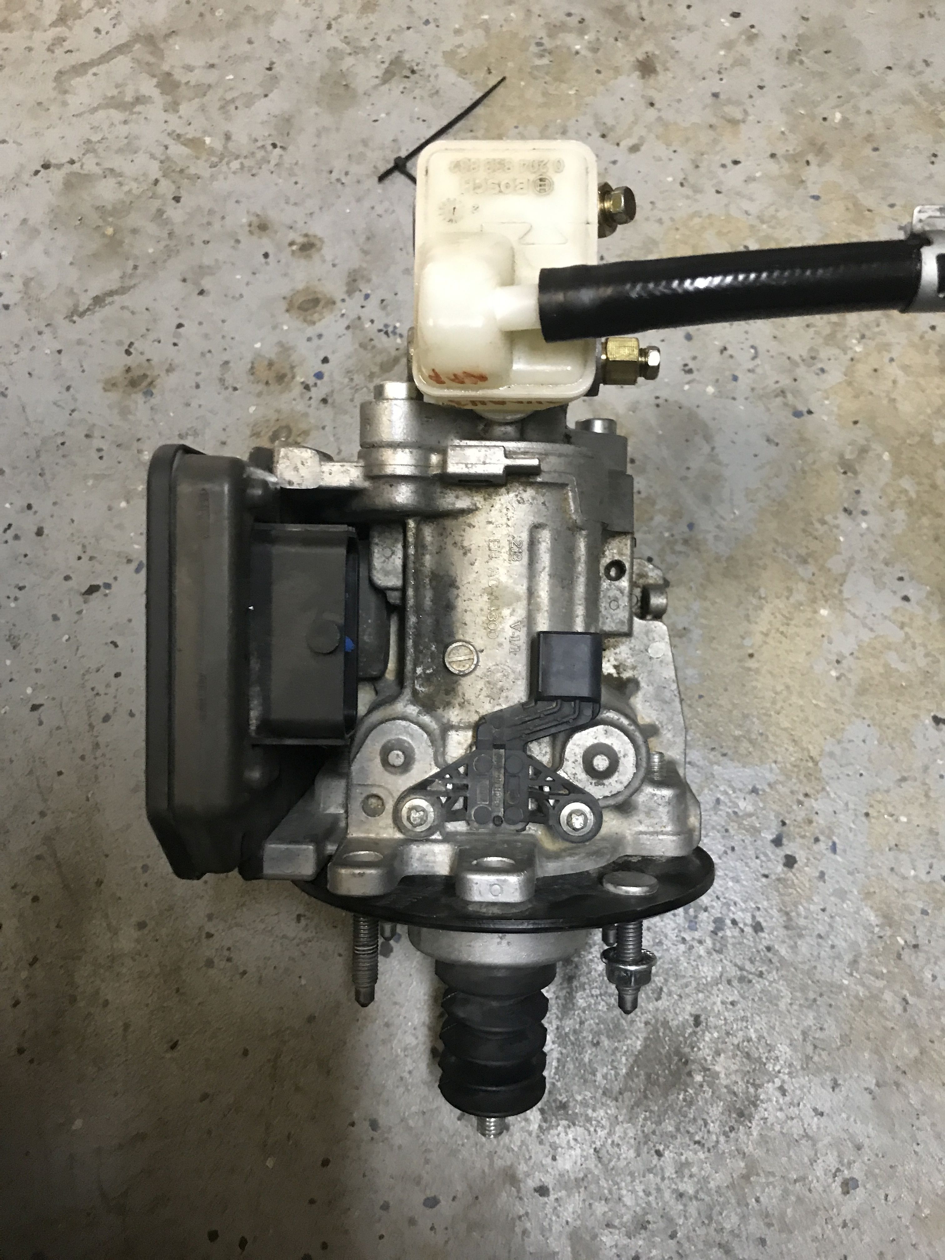

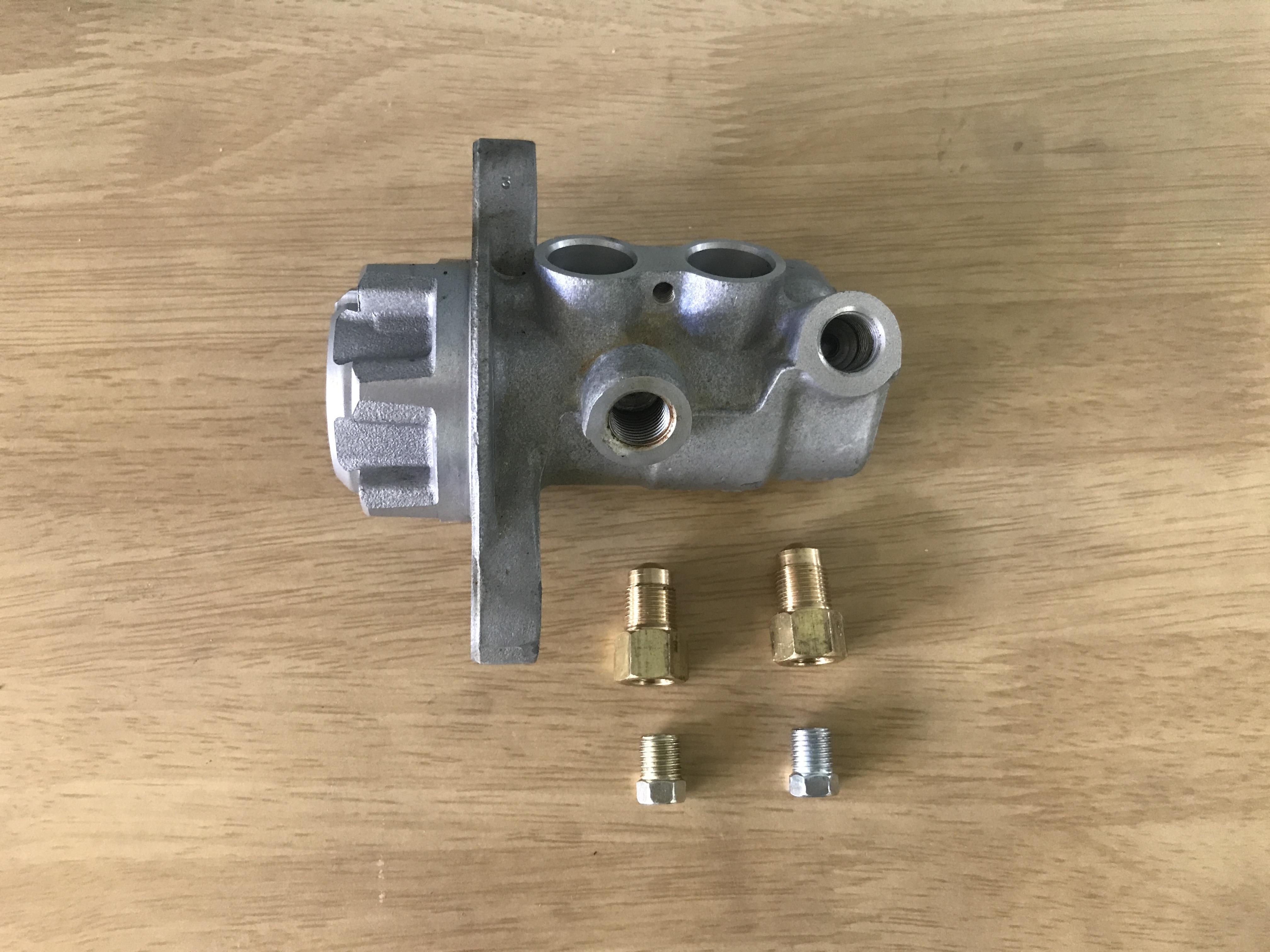

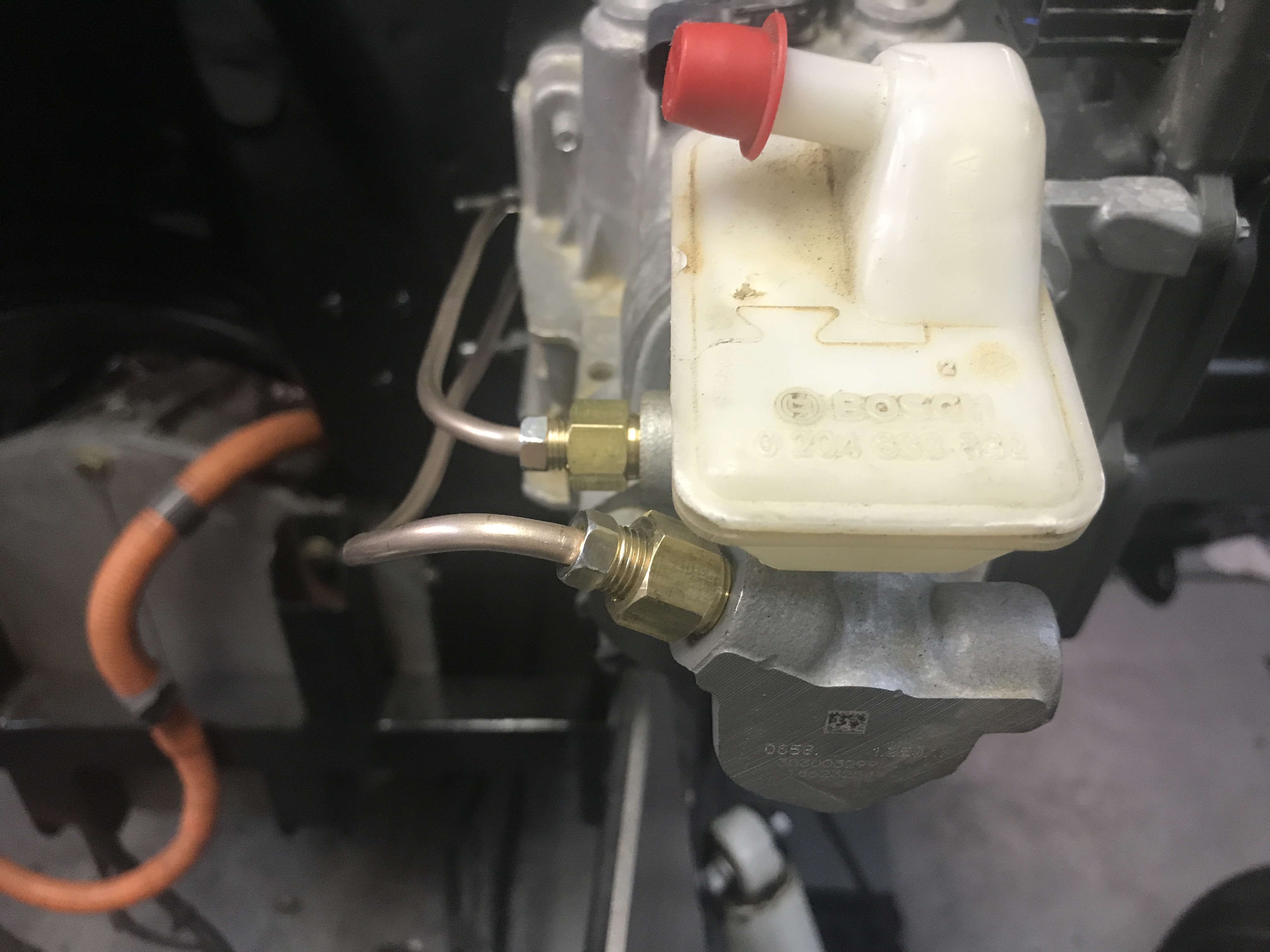

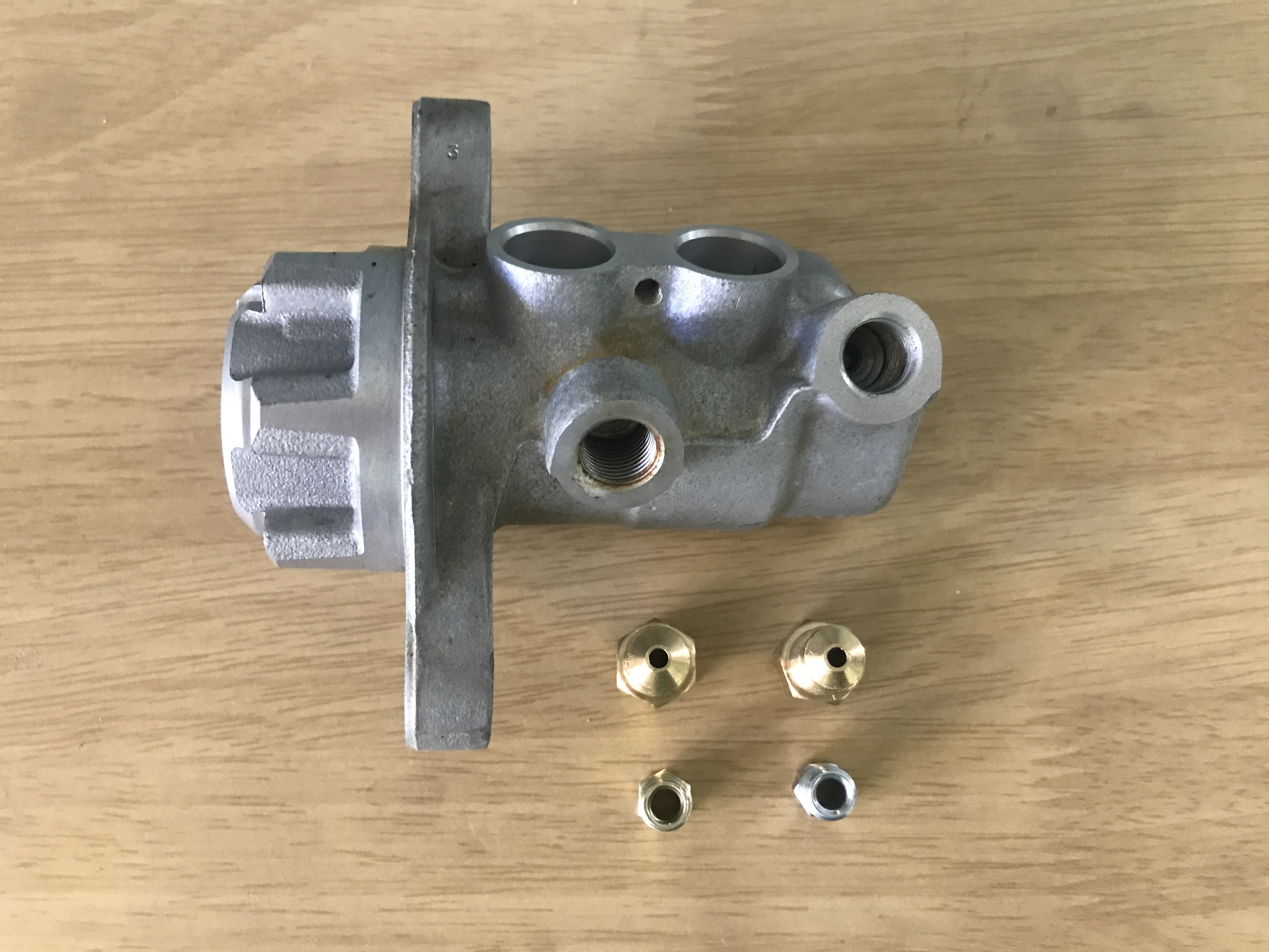

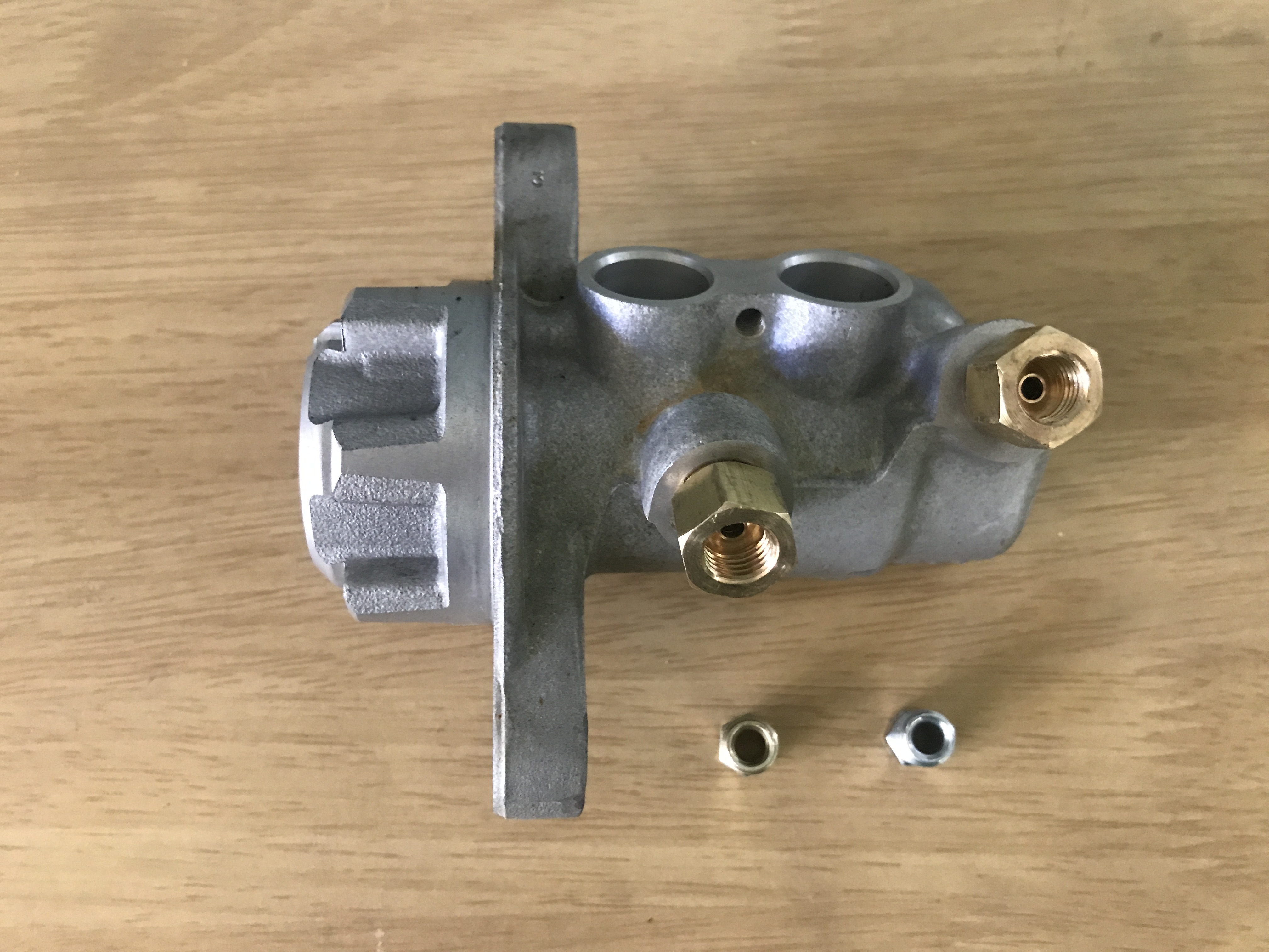

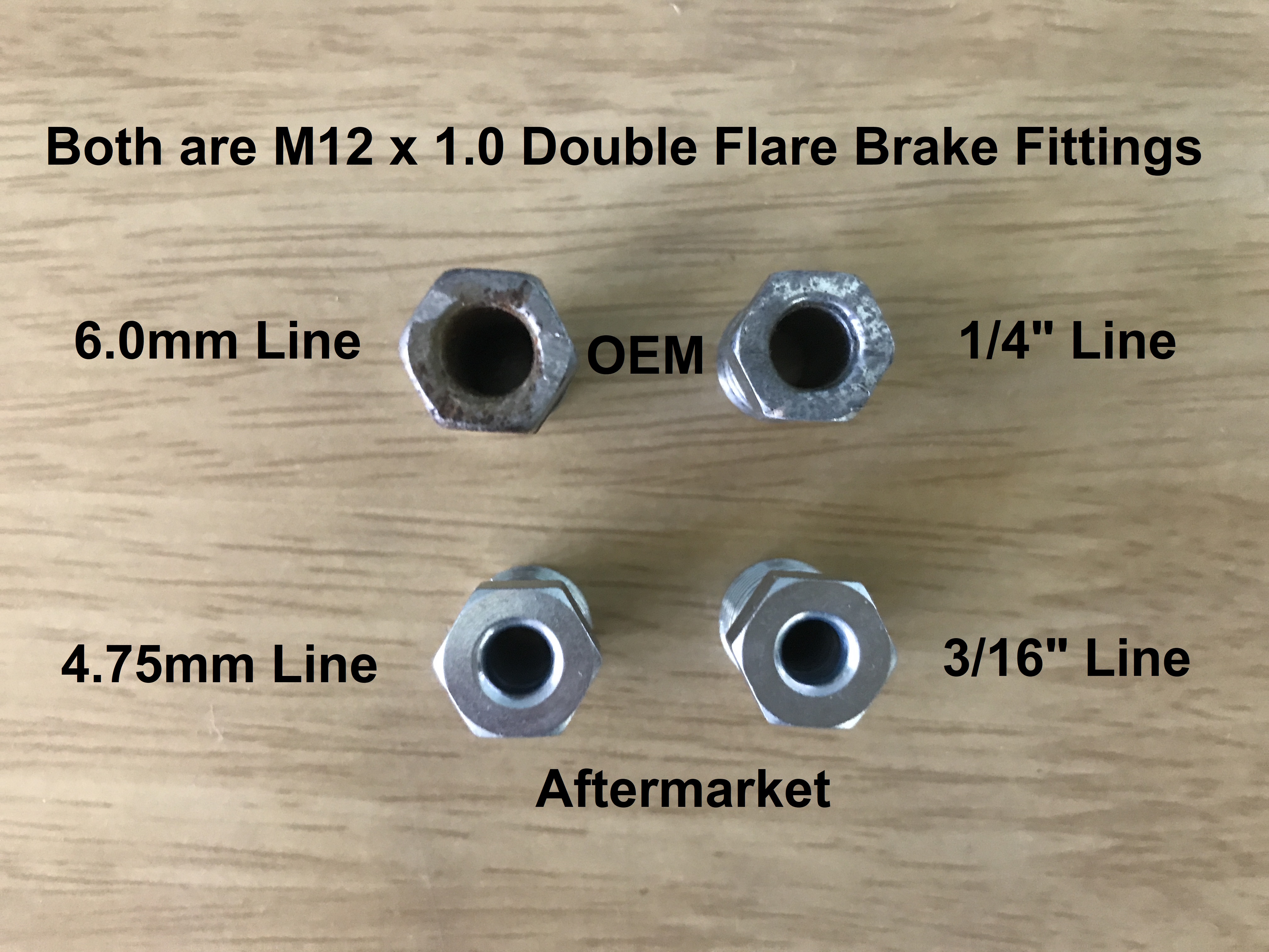

and this is where the fun starts for us inch lovin' Americans
adapters, adapters, adapters
Why do this, why use adapters?

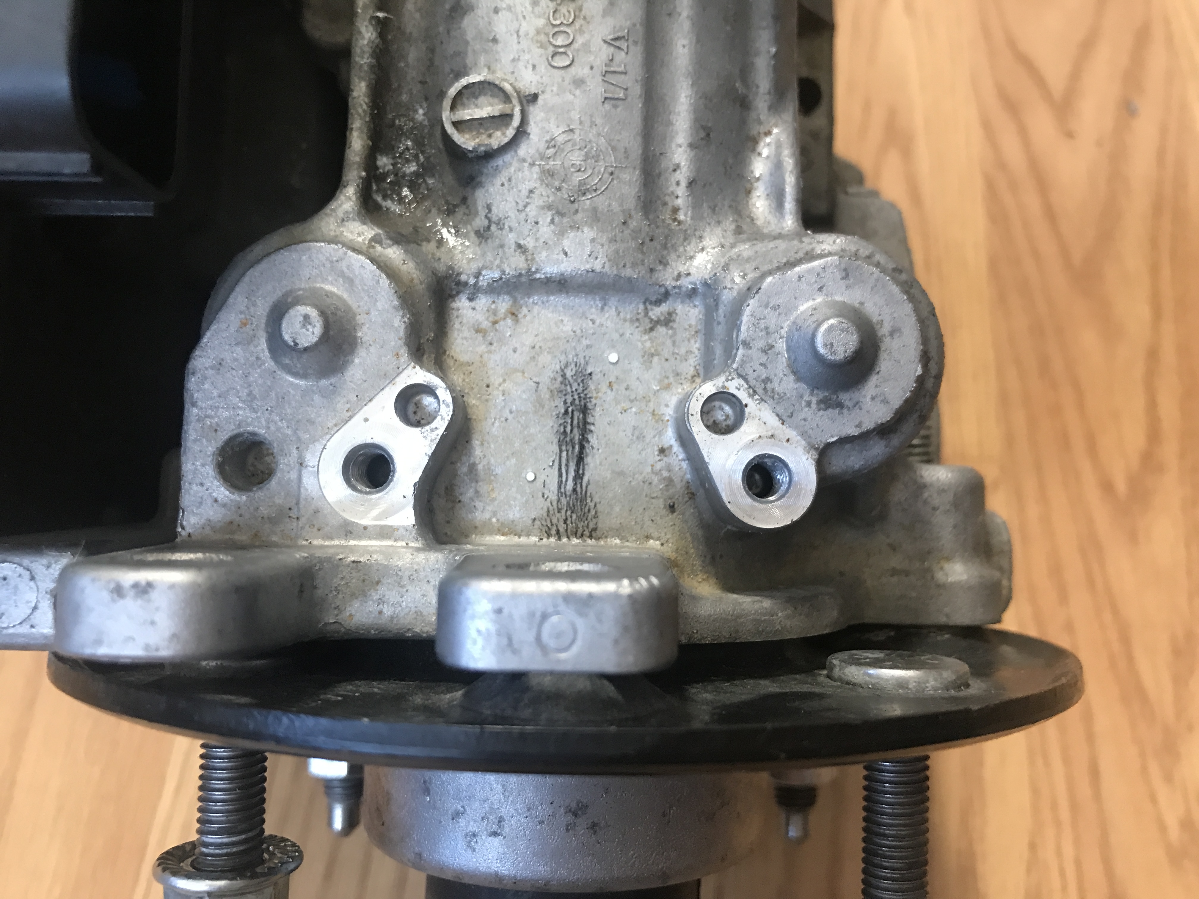

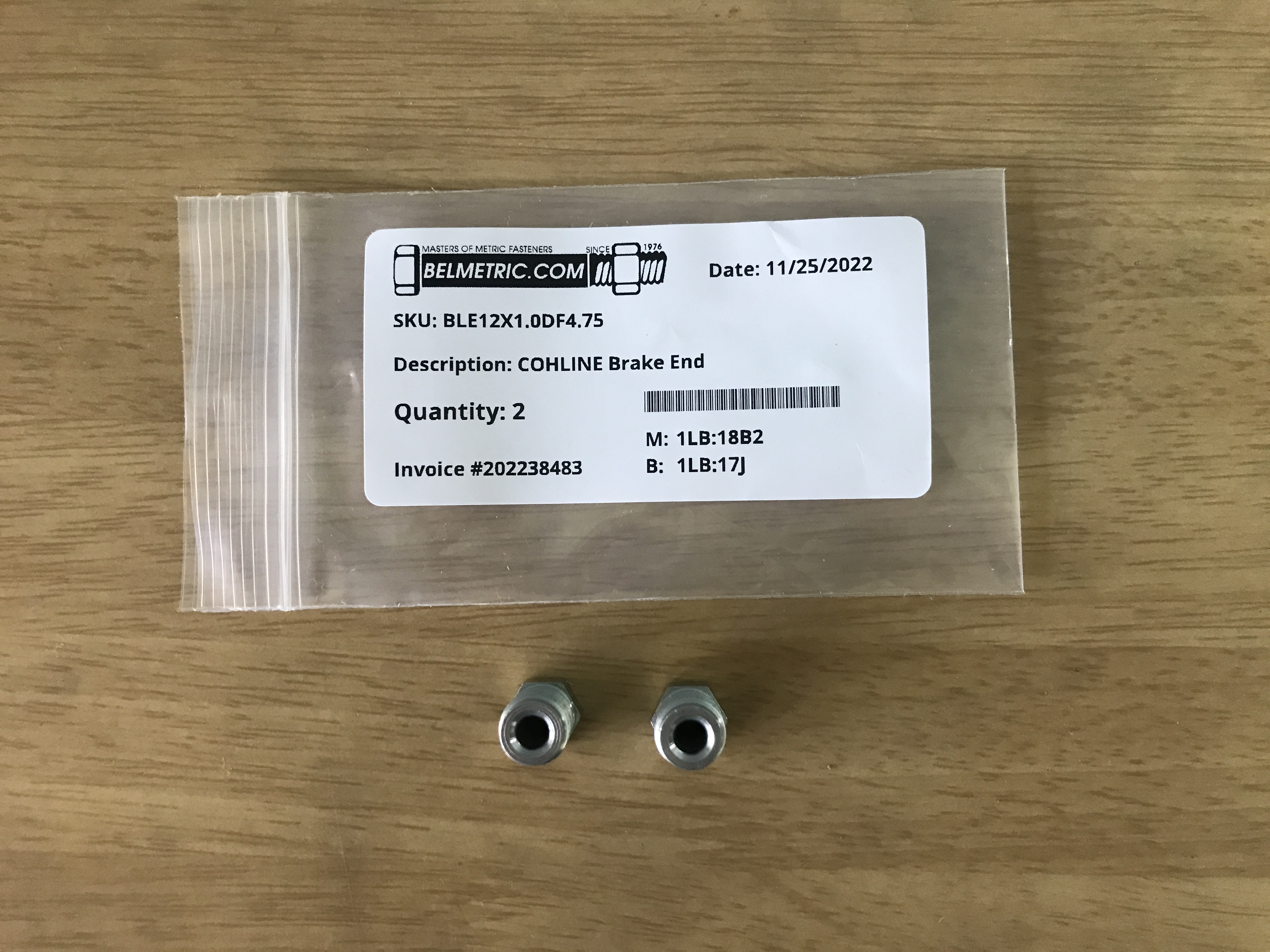

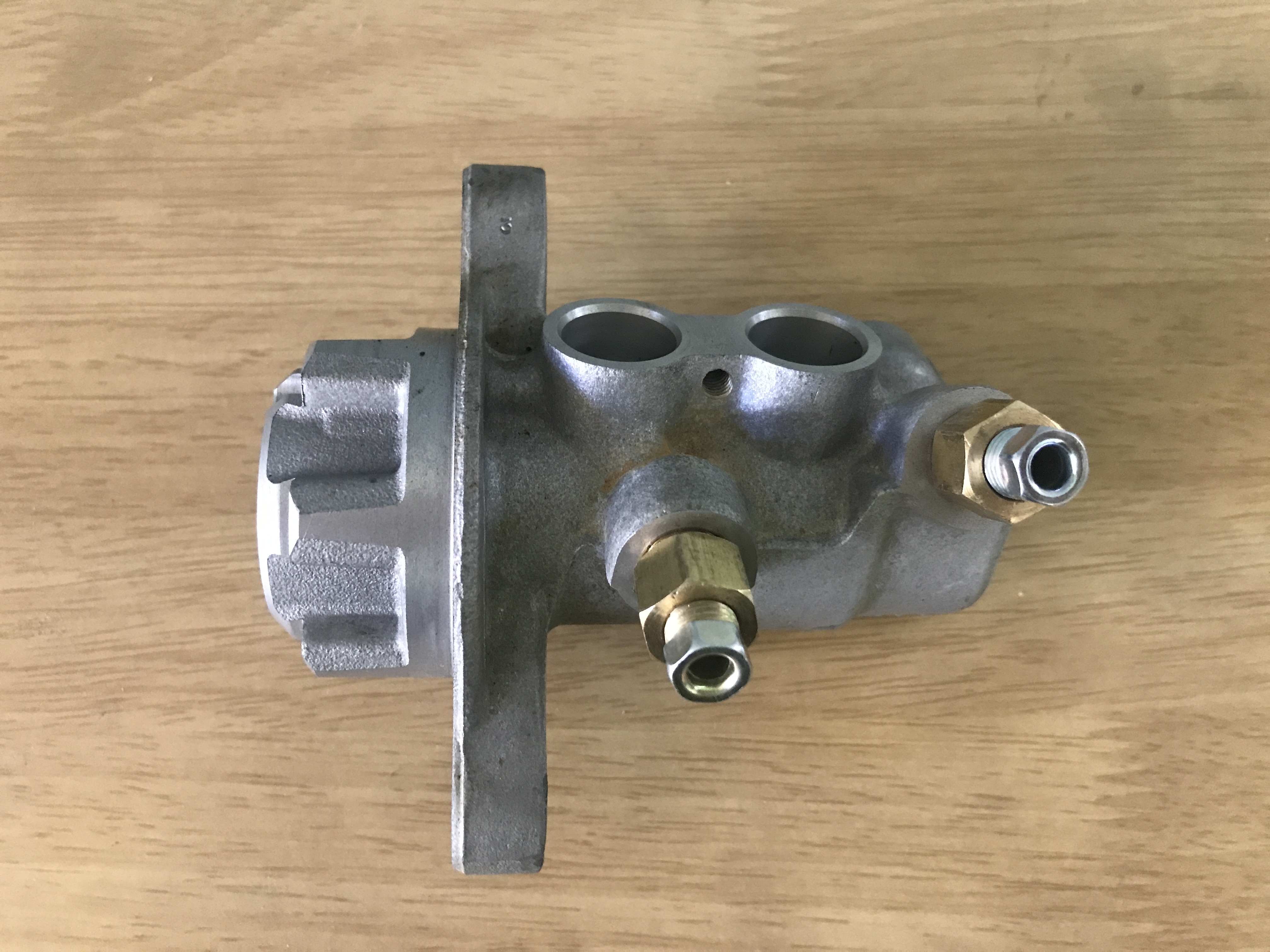

The stock master cylinder is metric and therefor uses bubble flared brake lines. So one reason to go the adapter route is if you only have a double flare brake line making kit, or or you have an older (pre 1995 American vehicle) and plan on reusing the original double flared brake lines.
these are the bubble adapter fittings, in other words they just fool the master cylinder into thinking there's a brake line in there
this allows us to go from Metric bubble flare lines to Standard double flare aka inverted flare brake lines
and to use a smaller 3/16" (4.75mm) brake line
so a baggie of the bubbles
and a different baggie of the little nipples

Gregski wrote: Sun Nov 27, 2022 5:12 pm these are the bubble fittings, in other words they just fool the master cylinder into thinking there's a brake line in there. this allows us to go from Metric to Standard. and to use a smaller 3/16" (4.75mm) brake line.
*runs and checks old pics for what type of brake line and fittings he bought for this 2 years ago*
Hopefully it's 1/4" and M12s. *crossing fingers*
Surveeey says?:
3/16" and M10s.
Great.
So I'm in the same boat you are, needing these stupid bubble fittings.
Unless I could solder/weld/braze a few inches of 1/4" tubing over top of the 3/16" tubing, and then just flare it directly and re-use my M12s? All to save $8 and probably $25 in shipping. This is for the brakes which... *checks notes* ... apparently stop the vehicle. Well I dunno if that's really that important.
Hmm...
Say Gregski... buddy ol' pal... looks like you bought a pack of 15 and only need 2...

MattsAwesomeStuff wrote: Mon Nov 28, 2022 9:41 am *runs and checks old pics for what type of brake line and fittings he bought for this 2 years ago*
Surveeey says?:
3/16" and M10s.
Great.
Hmm...
Matt all is not lost, you sometimes are just a fraction of a second ahead of me in what I am trying to explain. What car are you building, if it is a vehicle with drum brakes in the rear than you will need a Willwood proportioning valve and that one takes the 3/16" tubing that's why I had to step mine down from 1/4" to 3/16" more on this soon
and yes absolutely they are yours for free just message me your address

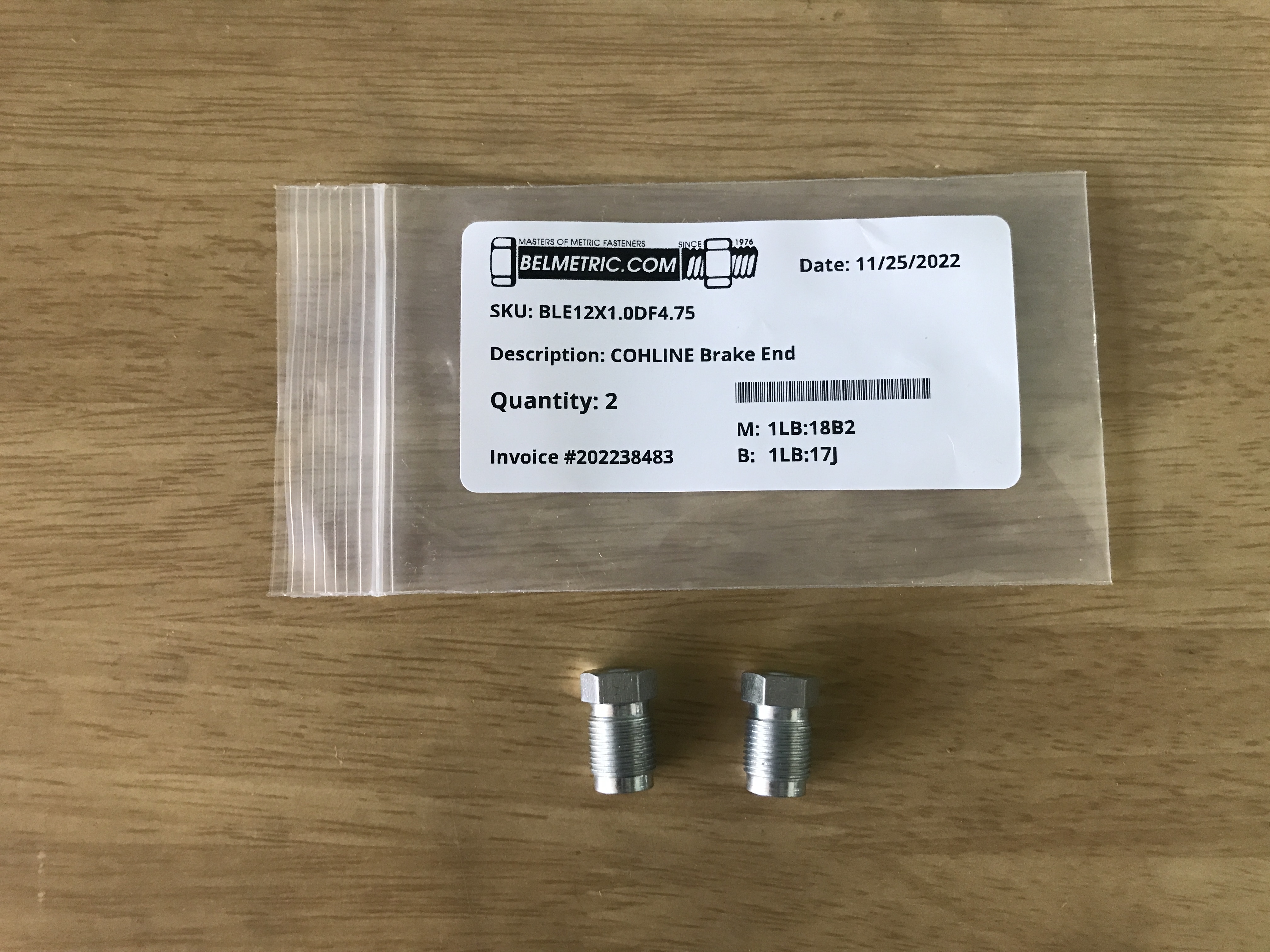

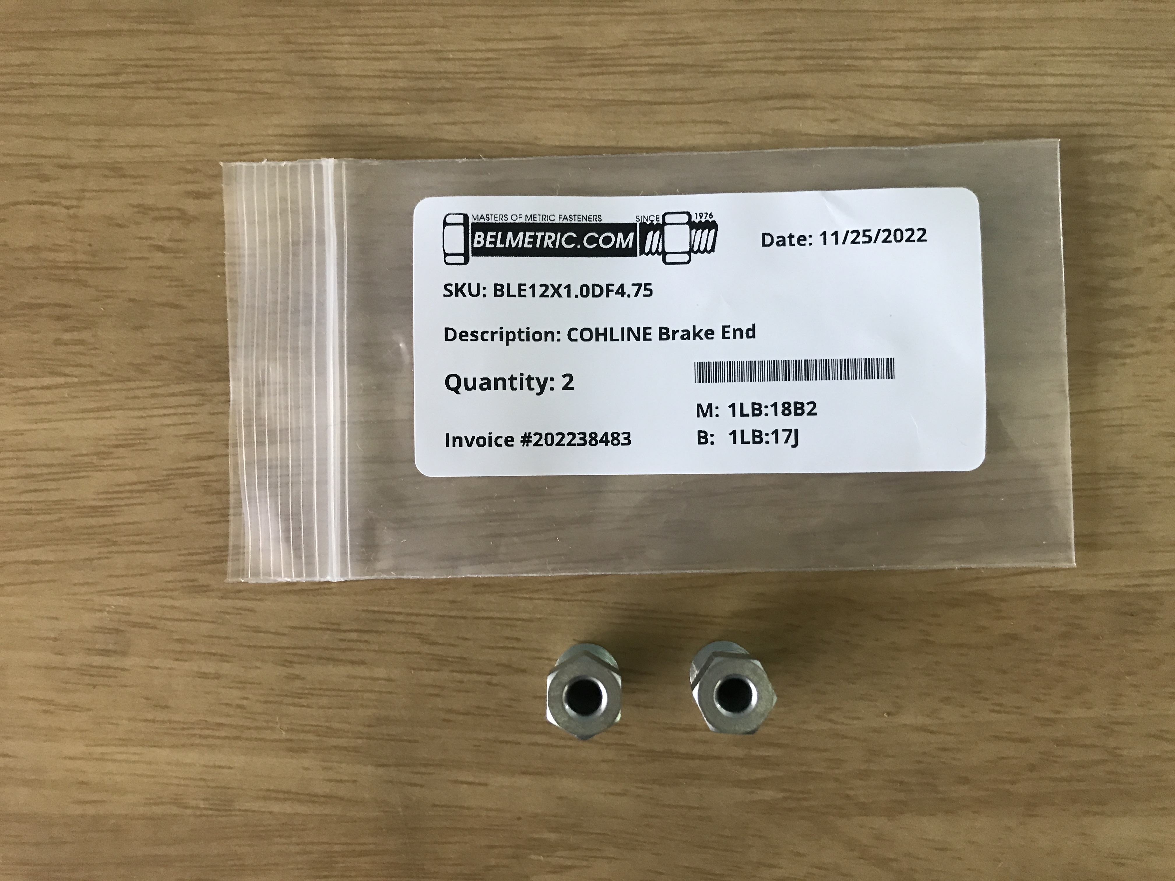

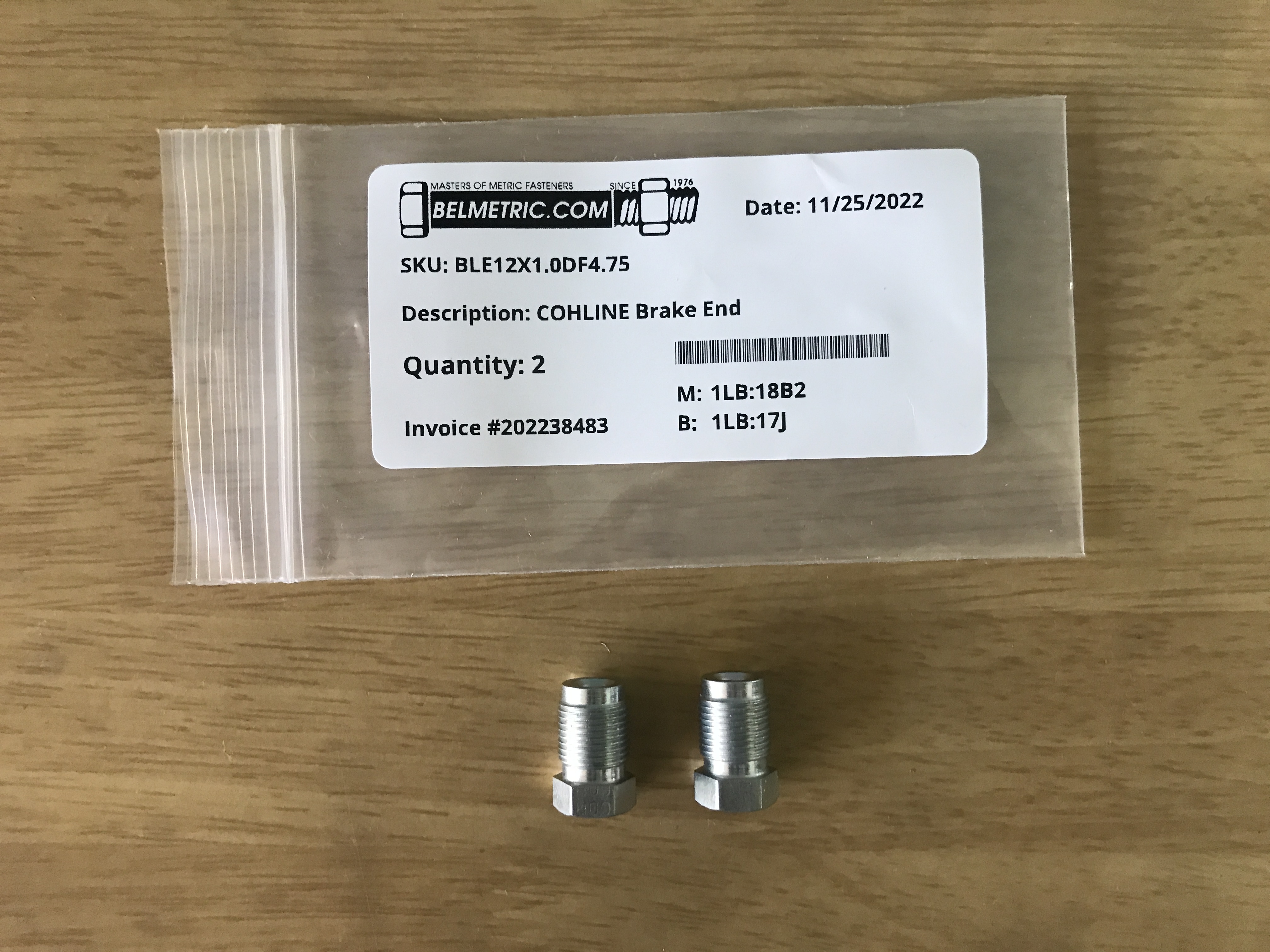

alternative to them 12mm bubble fitting adapters, they do have 12 mm "double flare" fittings for the smaller 3/16" aka 4.75mm lines
if you are like me and don't like adapters (pronounced: "more places to leak")
Please note these are not bubble ends

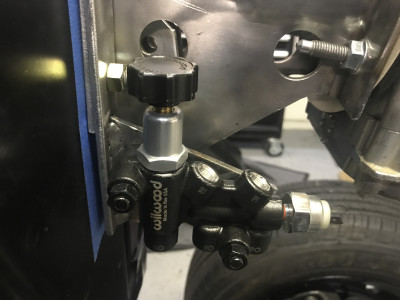

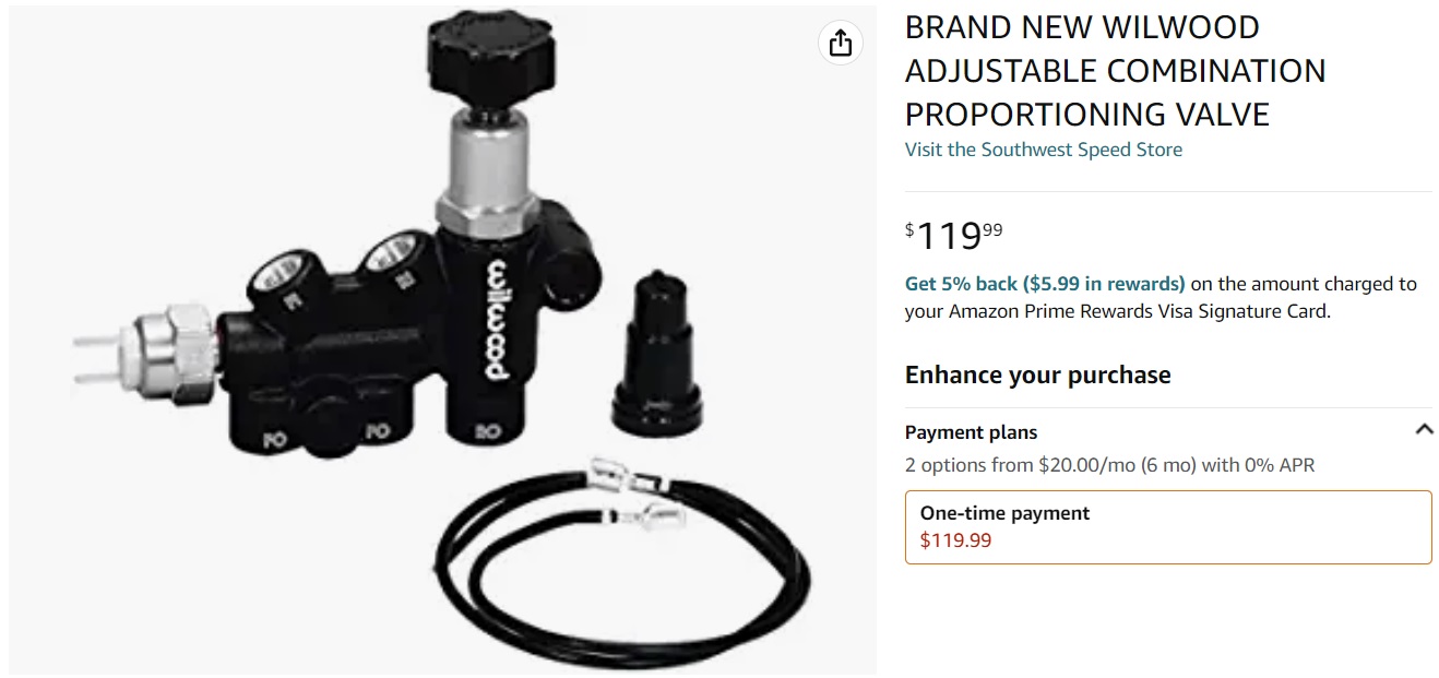

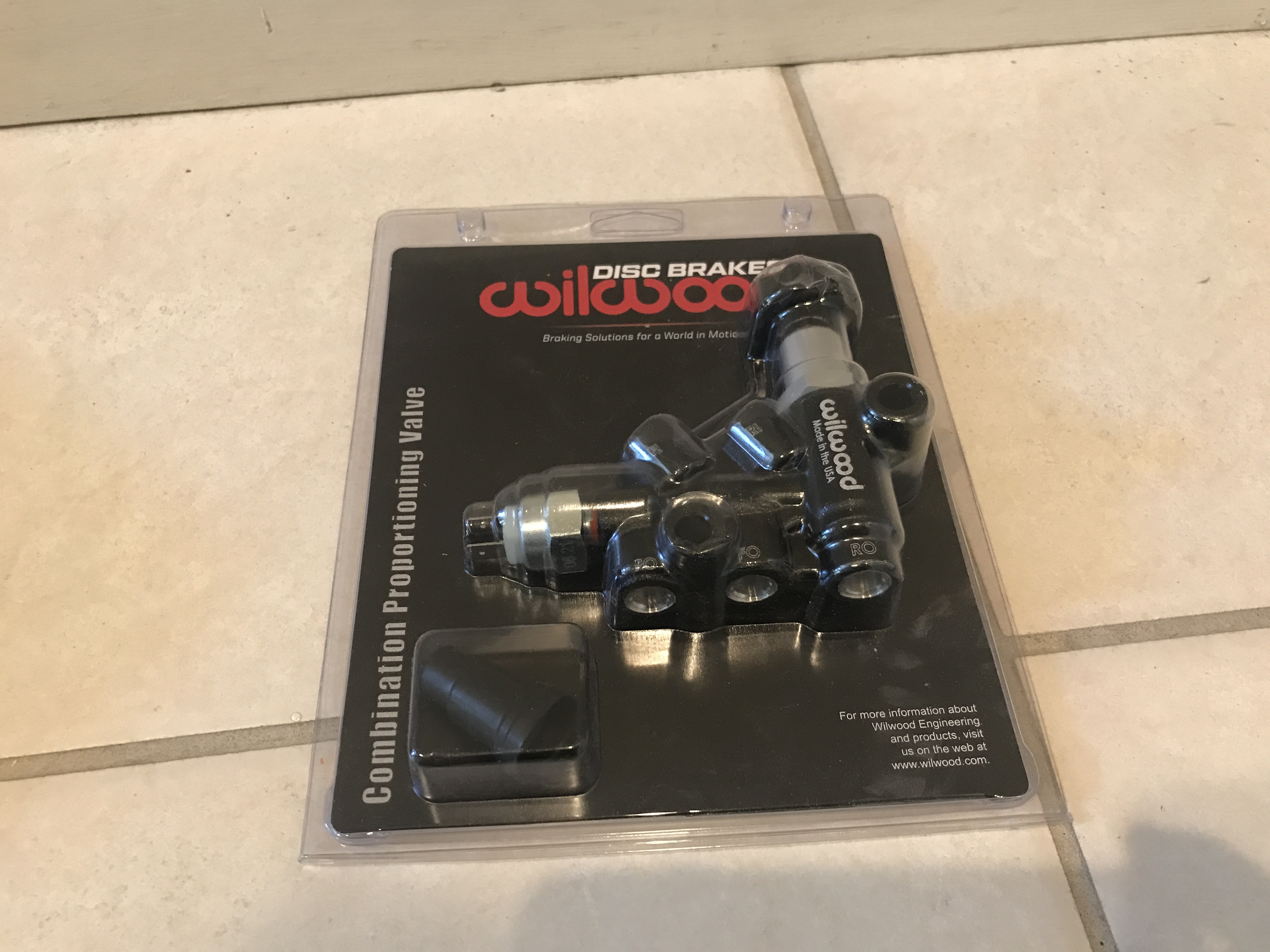

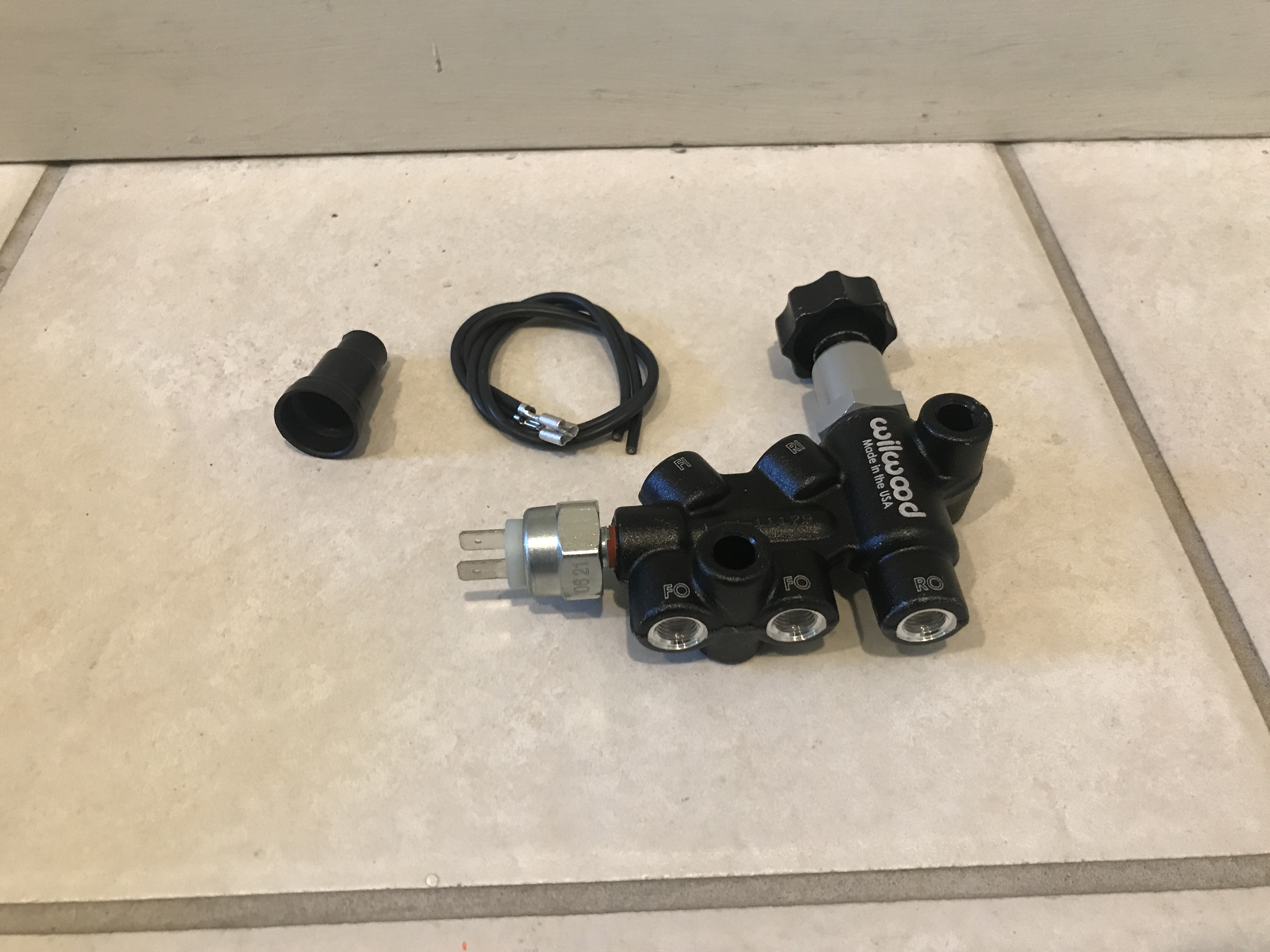

if you are installing this iBooster on a vehicle with drum rear brakes you will need a proportioning valve, like this Wilwood [pronounced: "expensive"] brand, think of a proportioning valve as a faucet with a knob you turn to control how much brake fluid goes there, it only has the knob on the line to the rear brakes it only controls the rear aka drum brakes
this guy is what forced me to use the smaller brake lines as it takes the 3/16" and not the 1/4"
the plug sticking out of it's butt is just a brake light switch

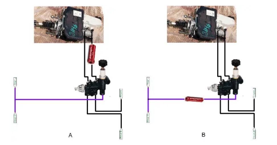

again all of this is beautifully explained on the EVCreate website here: iBooster in cars with rear drum brakes I am just trying to share my experience of stepping through the process and augment it where I can (so dumb it down)
the proportioning valve can be plumbed in one of two ways:

Gregski wrote: Mon Nov 28, 2022 3:35 pmWhat car are you building, if it is a vehicle with drum brakes in the rear than you will need a Willwood proportioning valve
1970 Opel GT.
Discs in the front, Drums in the back.
I've heard about this proportioning valve, I didn't know if it was mandatory or not.
Hrmph. So, once again, my "$55" cheap solution is actually a $250 not so cheap solution.
Well, for the $200 difference, I think I'd rather make an adapter plate to mount my original Master Cylinder to the booster. (And by "make" I mean "Try to make, get distracted, forget about it for a year, come back to it, give up and pay $200 to not have to mess with it anymore"). Hrm. The choices everyone will have to make.
I've somehow never read that last page on the EVCreate page. The calibration shudder on the Gen1s every time you boot, and the necessity to hold the brake pedal in to calibrate it is also a near deal-breaker for me. Apparently only a Gen 1 issue, the Gen 2 doesn't have the 12v enable line and must calibrate some other way. ... Depends what it does, I hold the brake pedal in when I turn the ignition on anyway, if that'll do, then no problem. But if that tells the booster to calibrate "full pedal depressed = zero braking", and I have to just barely hover the pedal at the start of its travel every damned time I start the car... I'll probably throw the whole thing out and buy a Gen 2.

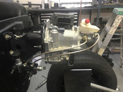

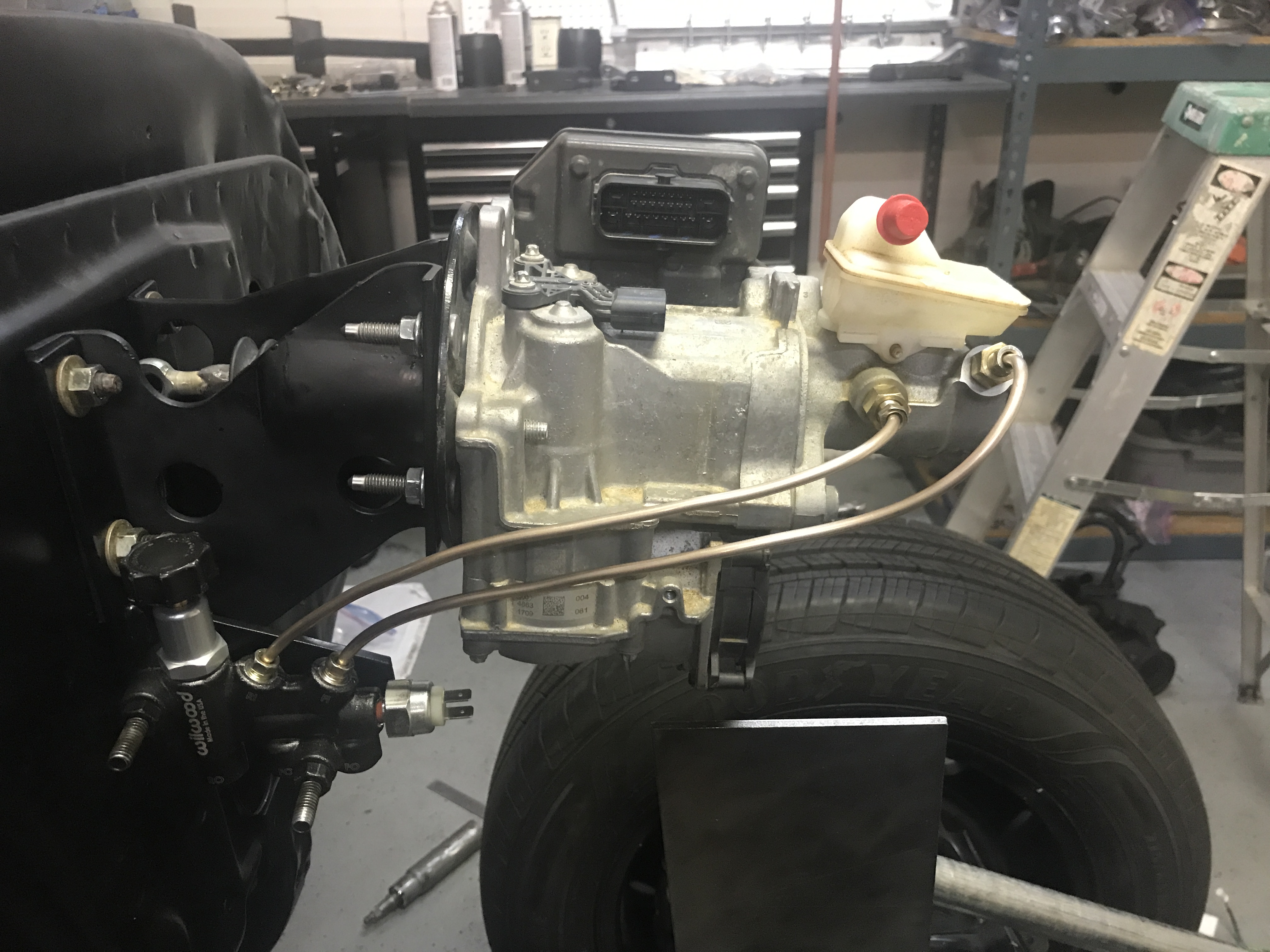

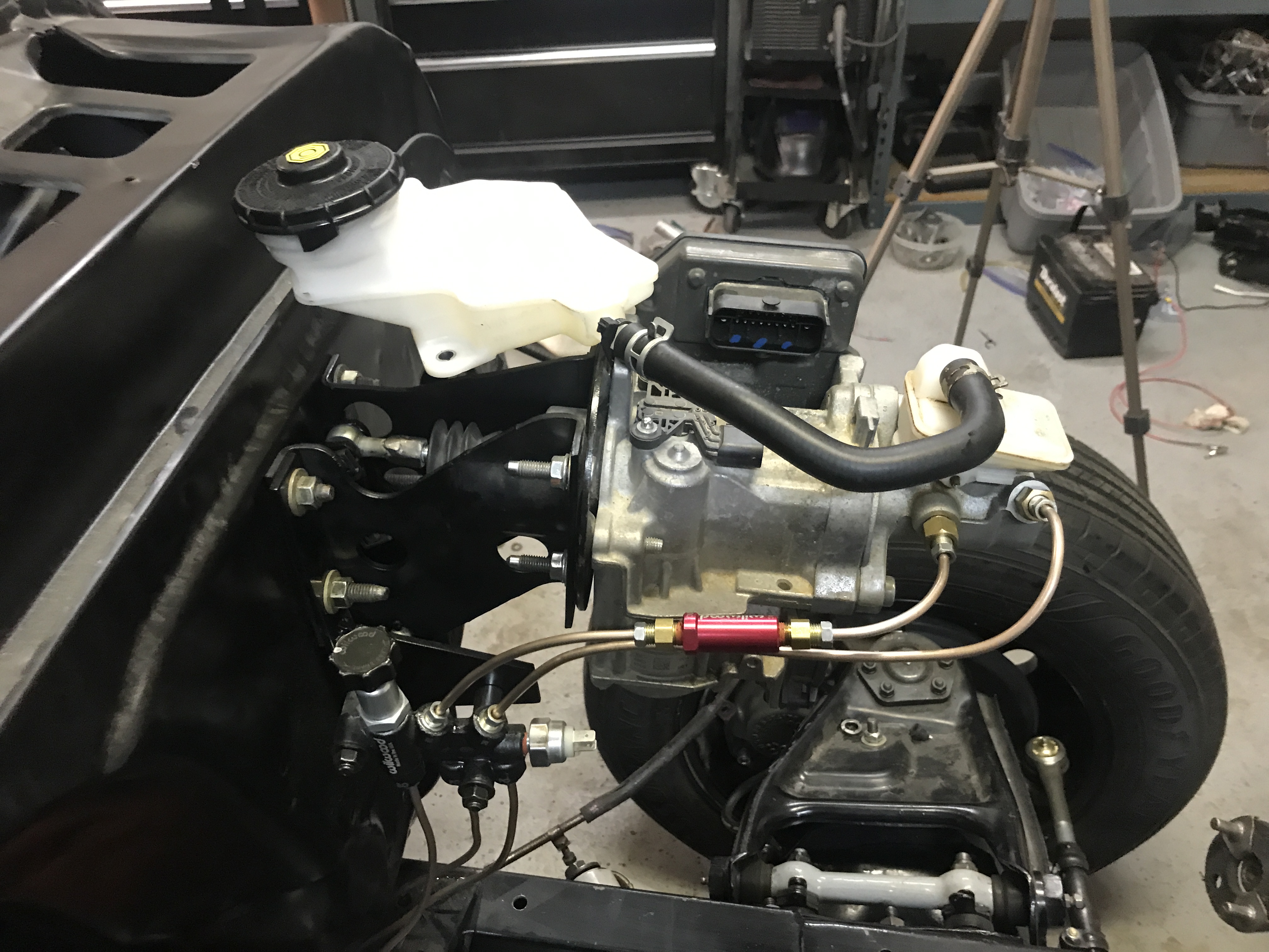

and here is the Honda CRV BOSCH iBooster and master cylinder installed on my 1971 Chevy GMC C10 pick em up, ain't that a thing of beauty? actually NO, no it's not... keep reading !

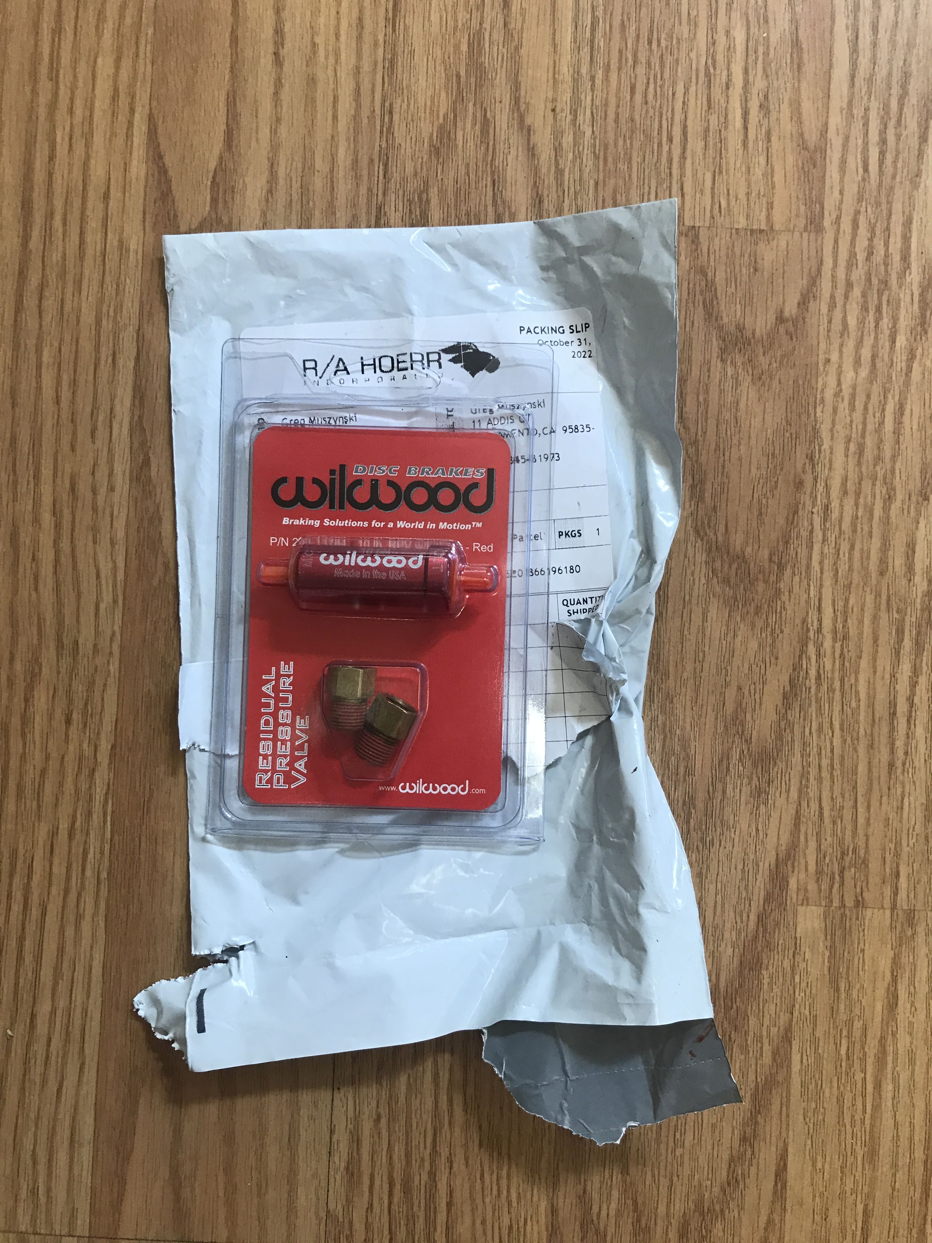

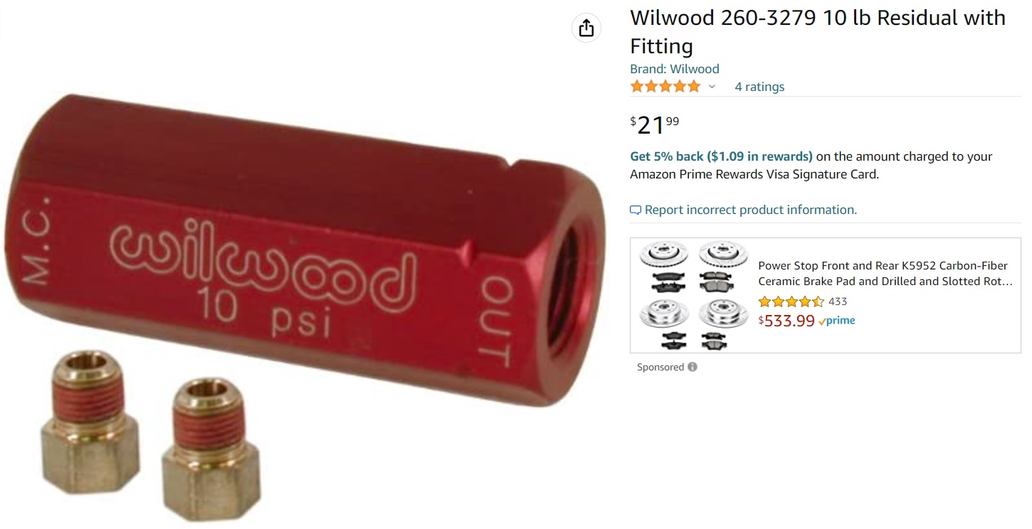

you see, this is what happens if you do not visit EVCreate.nl and READ, I totally forgot to install the red thingie
this is a 10 pound residual valve as opposed to the black thing above aka the proportioning valve, this red thing is needed if you have rear drum brakes, and both valves work together in concert, again read more about it on EVCreate.nl where Lars explains it properly
notice I also added the remote canister aka bigger reservoir

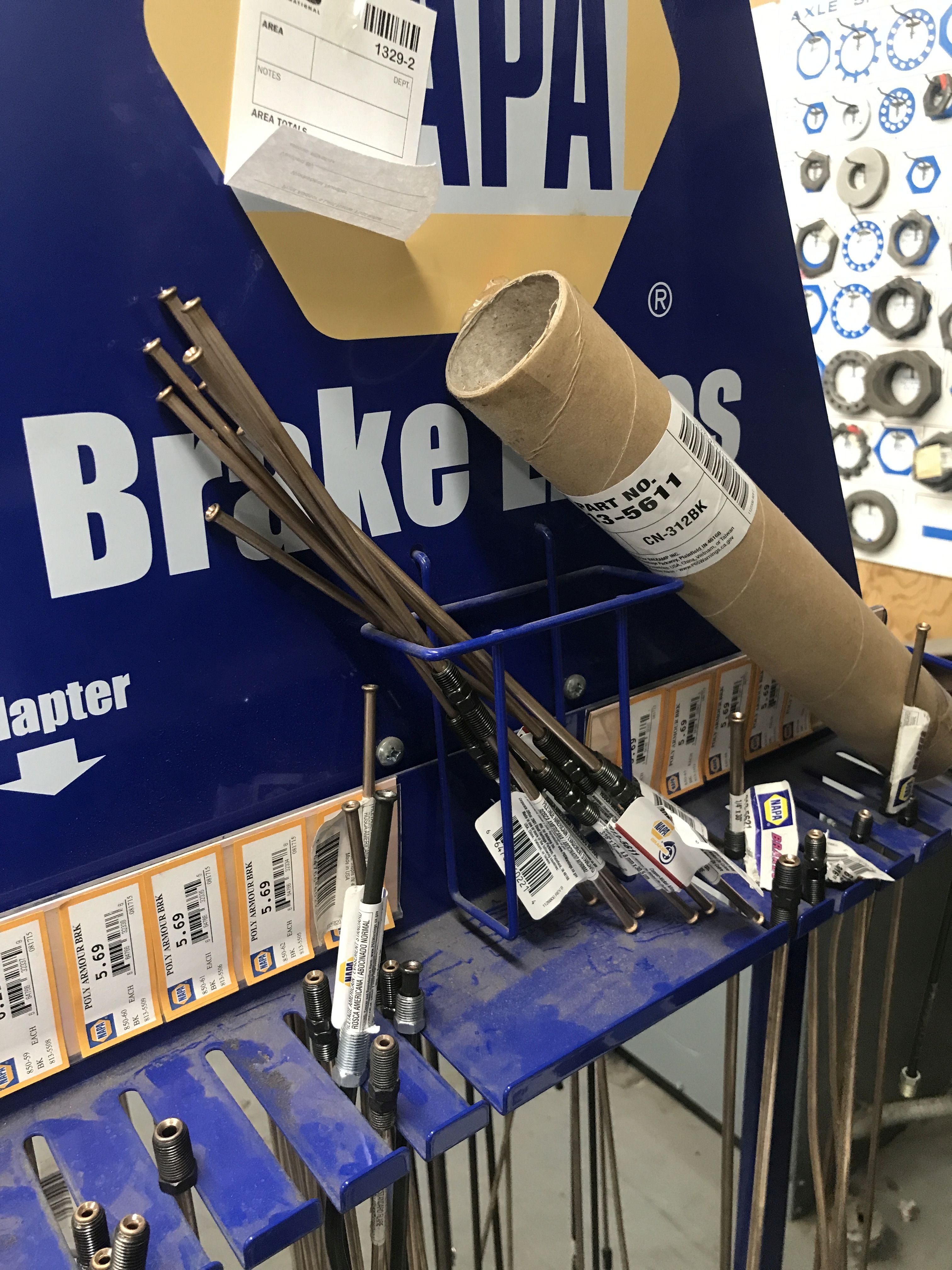

Fun Fact: in the States if you go to NAPA auto parts store and ask for Platform 9 and 3/4 they will take you in the back where they stash premade brake lines of all lengths and shortnesses and fitting combinations, a real shame they don't keep this display in front for the Muggles to see

So I asked around on the car forums about this whole residual valve and proportioning valve.
It's been suggested I likely won't need either unless I'm drastically changing the weight balance of the car.
Also, re-re-re-reading the EVcreates page, it seems like the important piece is the (cheaper) residual valve, not the (expensive) proportioning valve.
The residual valve is to replace the built-in residual valve that was likely part of the original master cylinder, and it's not to prevent the rear from locking up, it's to prevent the rear spring from pushing way too far back and delaying the brake fluid from arriving to the drum brakes (instead of the shoes hovering right near the drum ready to move, they'll be seated farther back).
If you put a 4-wheel disc MC onto a drum-rear vehicle, that MC will lack the residual valve.
And, after that, if you still need to fine tune the braking so that the rears don't lock up before the fronts, then you might also need the proportioning valve.
At least that's my understanding, I'm going to run it by the folks on the DIY EC forum too.

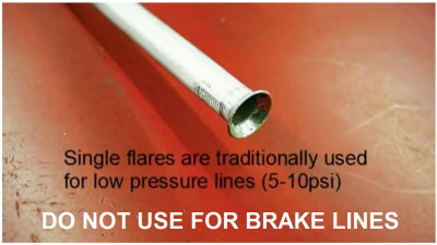

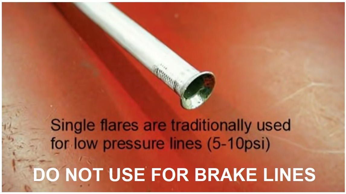

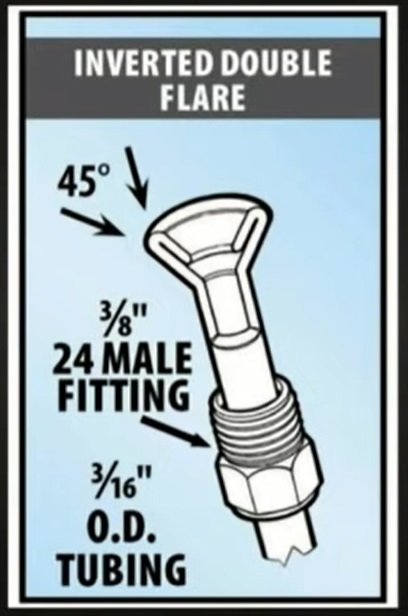

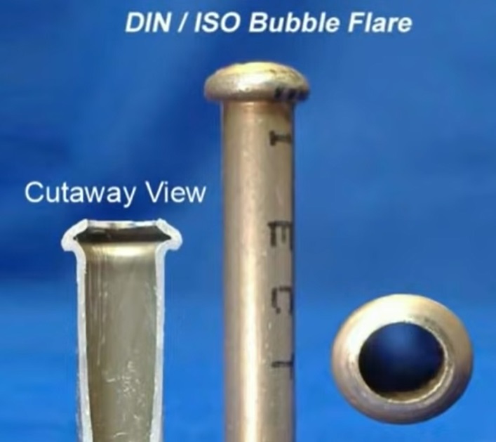

probably one of the more better and least condescending explanations of flares, bubble flares, single flare, double flare, inverter flare, double dare, I don't care videos out there, I suggest you watch it and file it under "More than I ever wanted to know" section of your project
TYPES OF FLARES:
Single Flare aka half ass flare
Double Flare aka whole ass flare "American" style
Bubble Flare, European / the rest of the world flare aka non "American" style

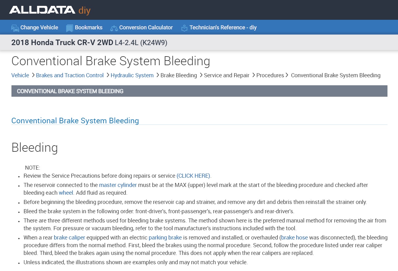

yes The Greg once again took one for the team and subscribed to ALLData to lay his eyeballs on the 2017 Honda CR-V Service Manual, all this to bring you the proper and much debated brake bleeding sequence, so here it is in both native screen shot form as well as cut and pasted text
CONVENTIONAL BRAKE SYSTEM BLEEDING
NOTE:
• Review the Service Precautions before doing repairs or service.
• The reservoir connected to the master cylinder must be at the MAX (upper) level mark at the start of the bleeding procedure and checked after bleeding each wheel. Add fluid as required.
• Before beginning the bleeding procedure, remove the reservoir cap and strainer, and remove any dirt and debris then reinstall the strainer only.
• Bleed the brake system in the following order: front-driver's, front-passenger's, rear-passenger's and rear-driver's.
• There are three different methods used for bleeding brake systems. The method shown here is the preferred manual method for removing the air from the system. For pressure or vacuum bleeding, refer to the tool manufacturer's instructions included with the tool.
• When a rear brake caliper equipped with an electric parking brake is removed and installed, or overhauled (brake hose was disconnected), the bleeding procedure differs from the normal method. First, bleed the brakes using the normal procedure. Second, follow the procedure listed under rear caliper bleed. Third, bleed the brakes again using the nomal procedure. This does not apply when the rear calipers are replaced.
• Unless indicated, the illustrations shown are examples only and may not match your vehicle.

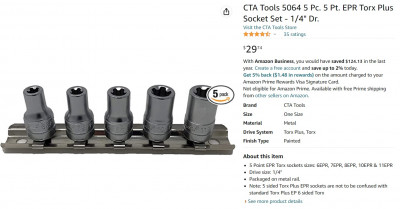

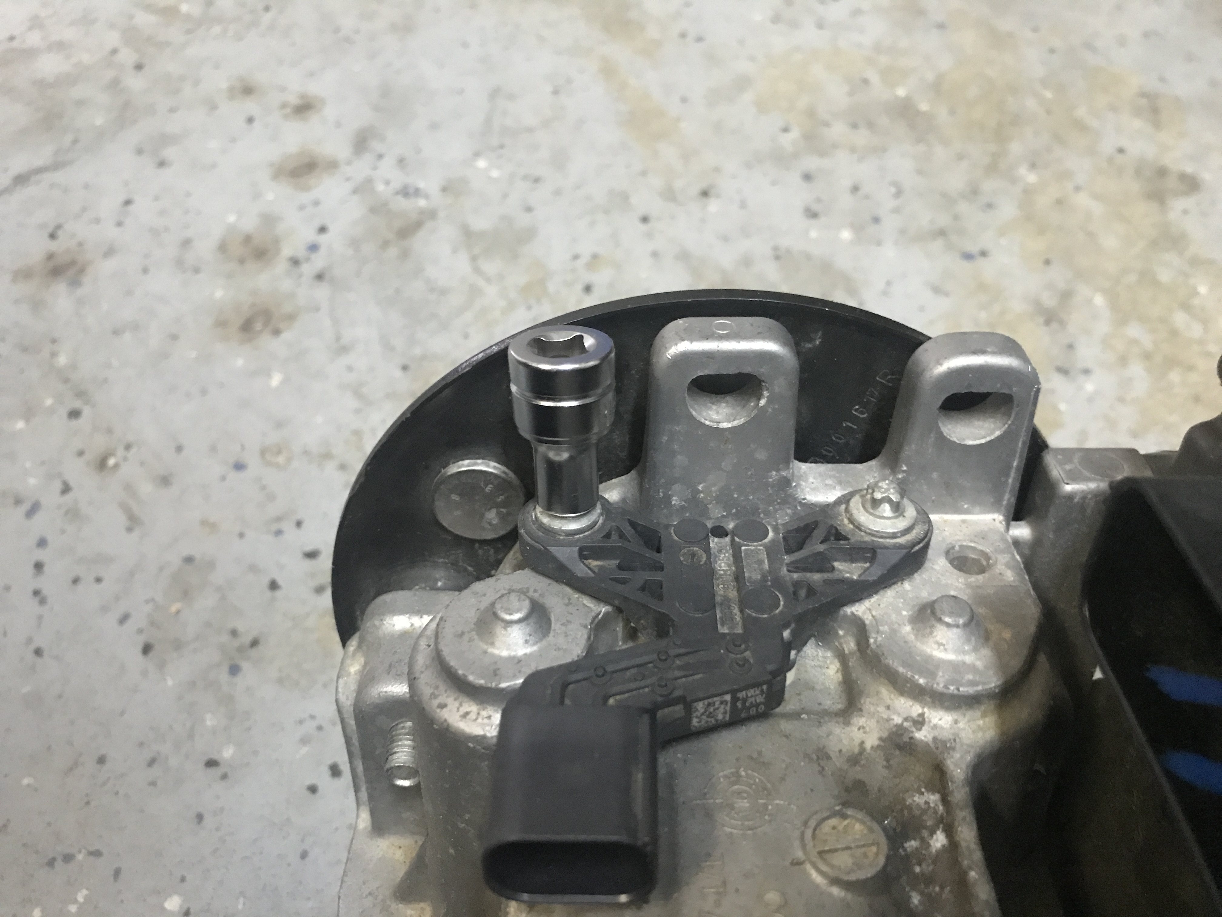

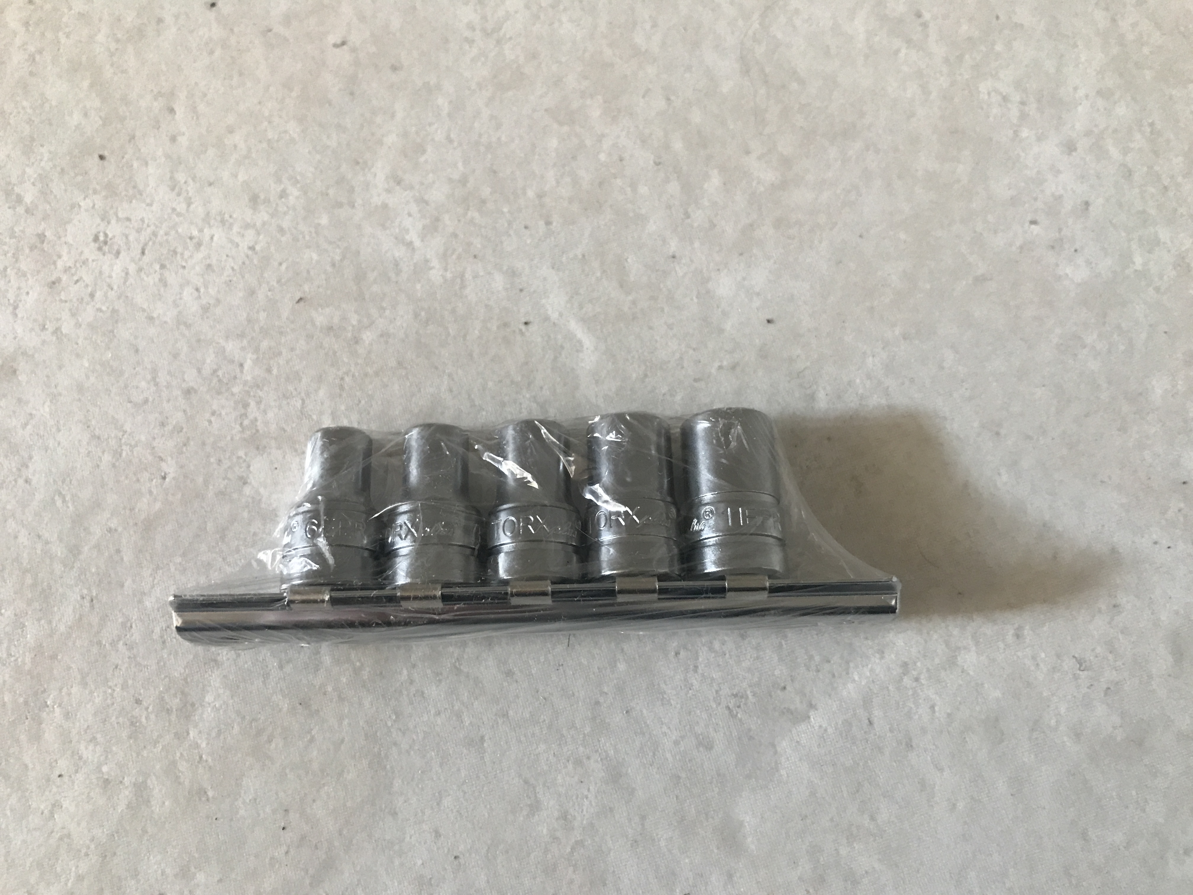

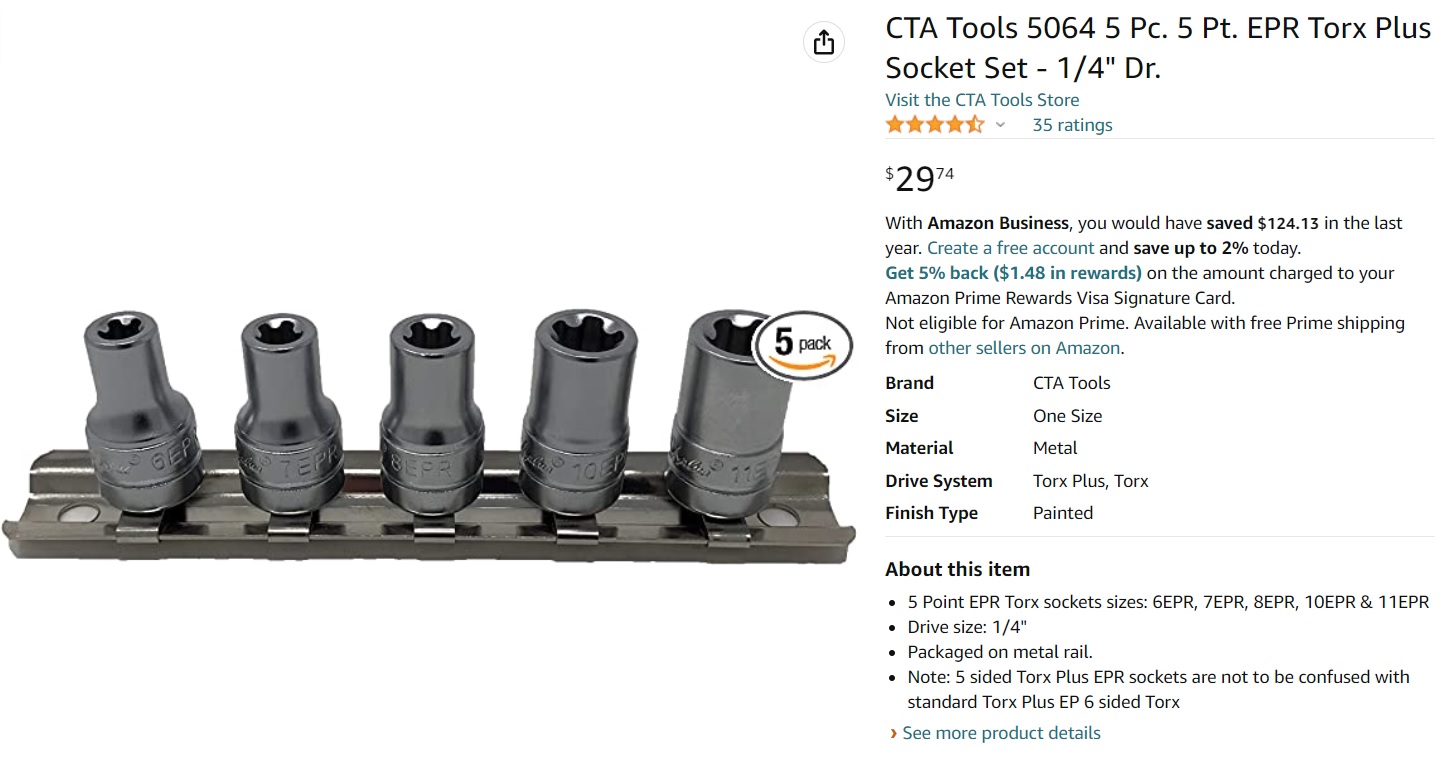

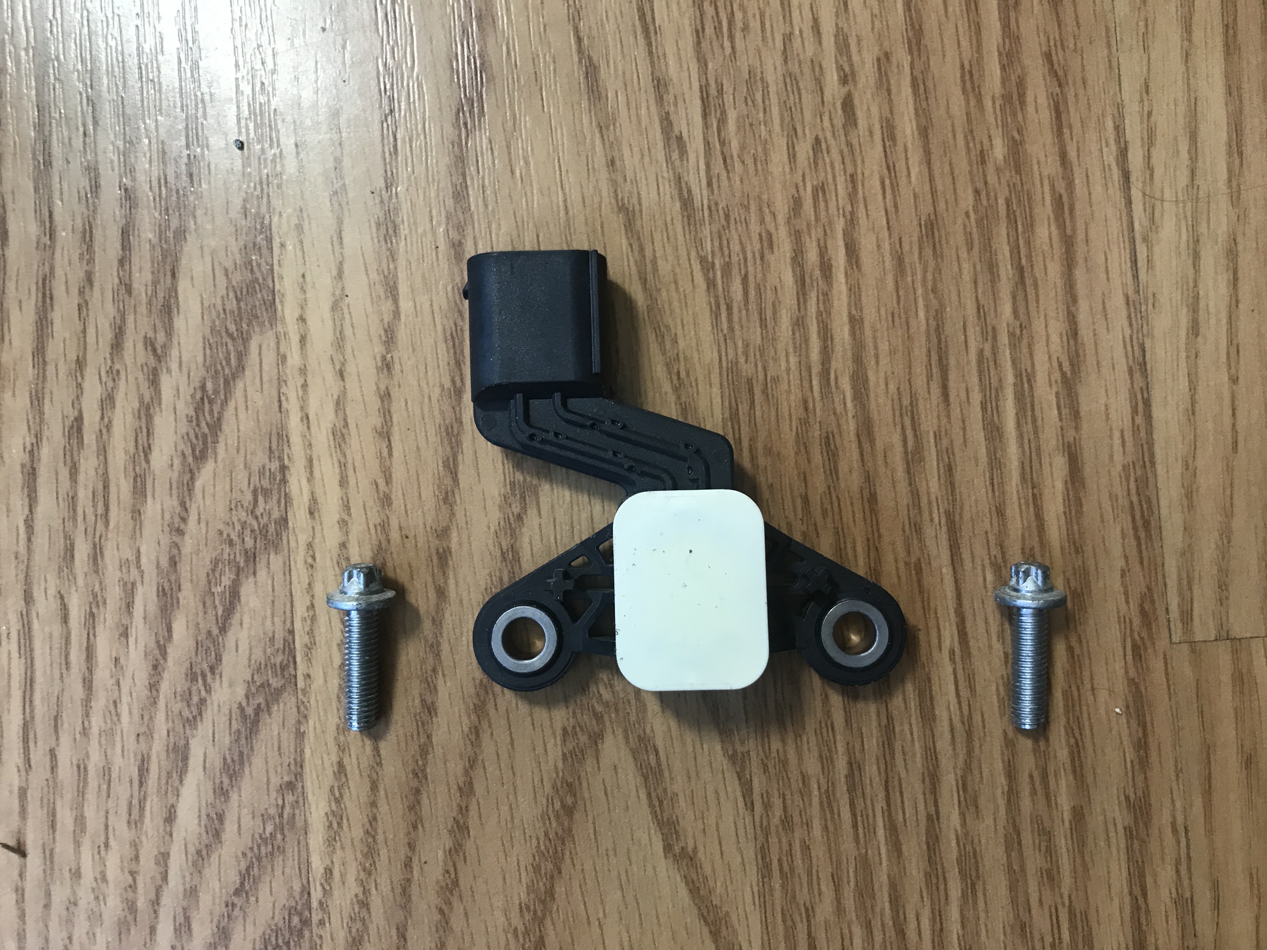

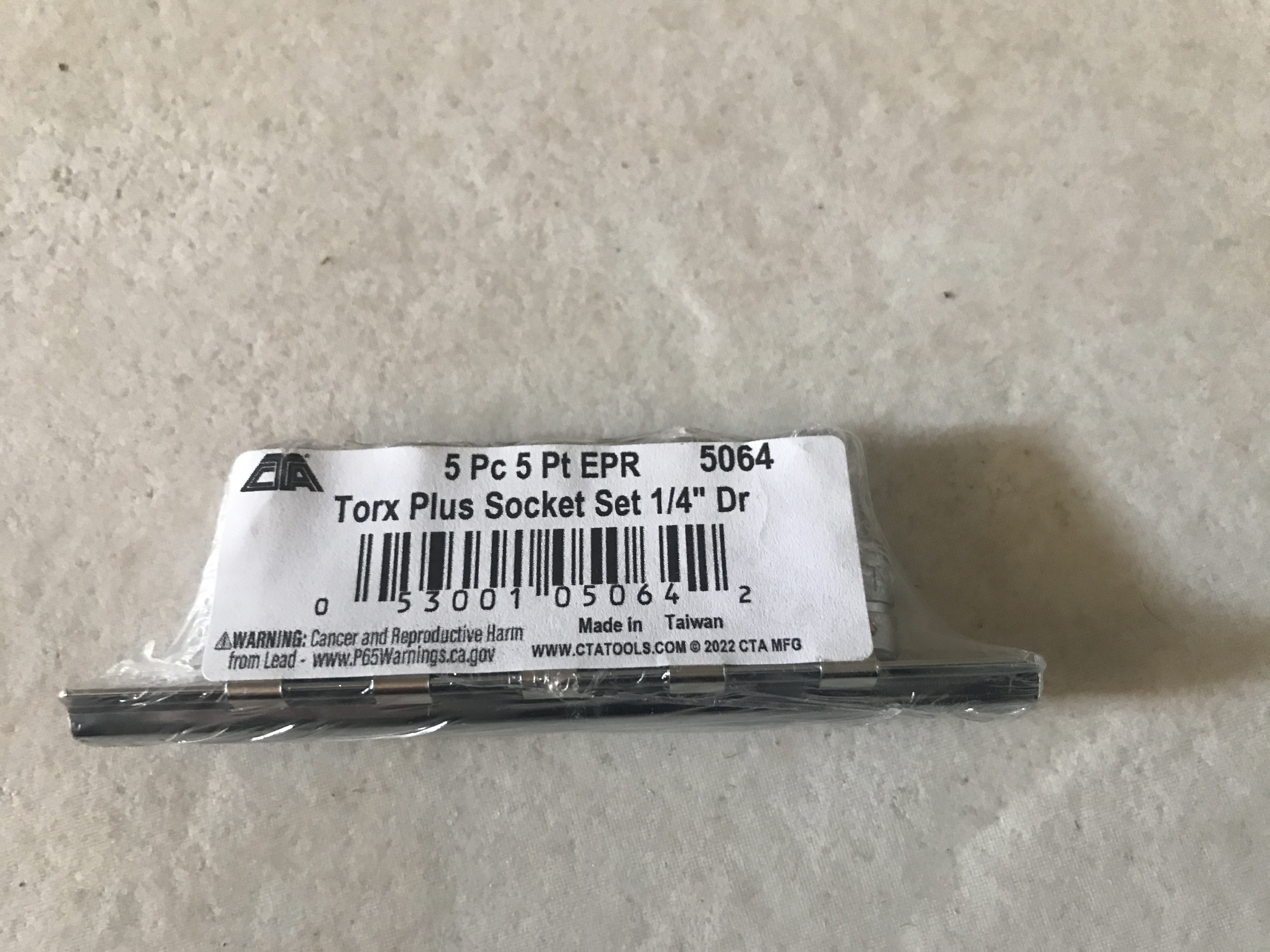

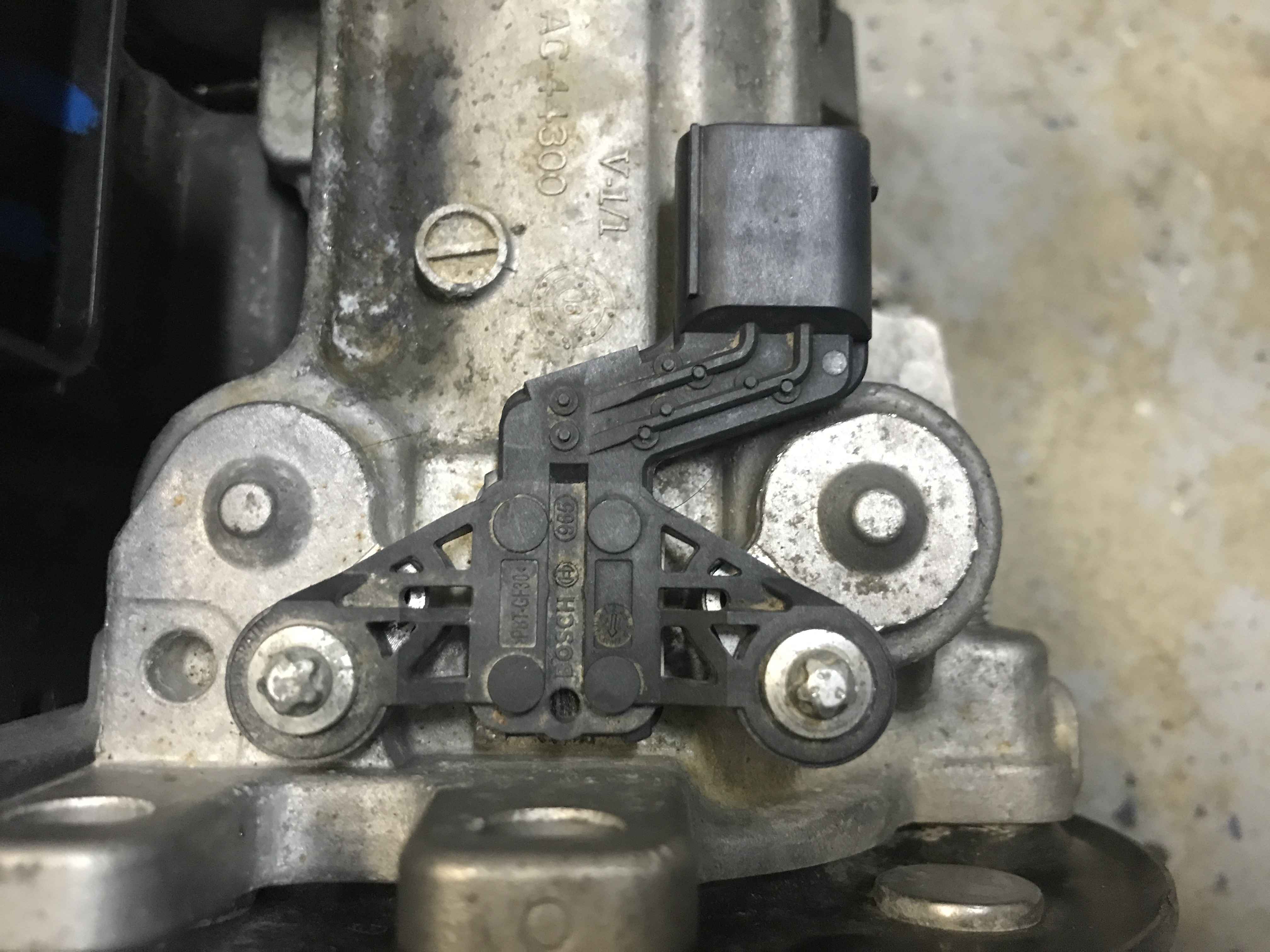

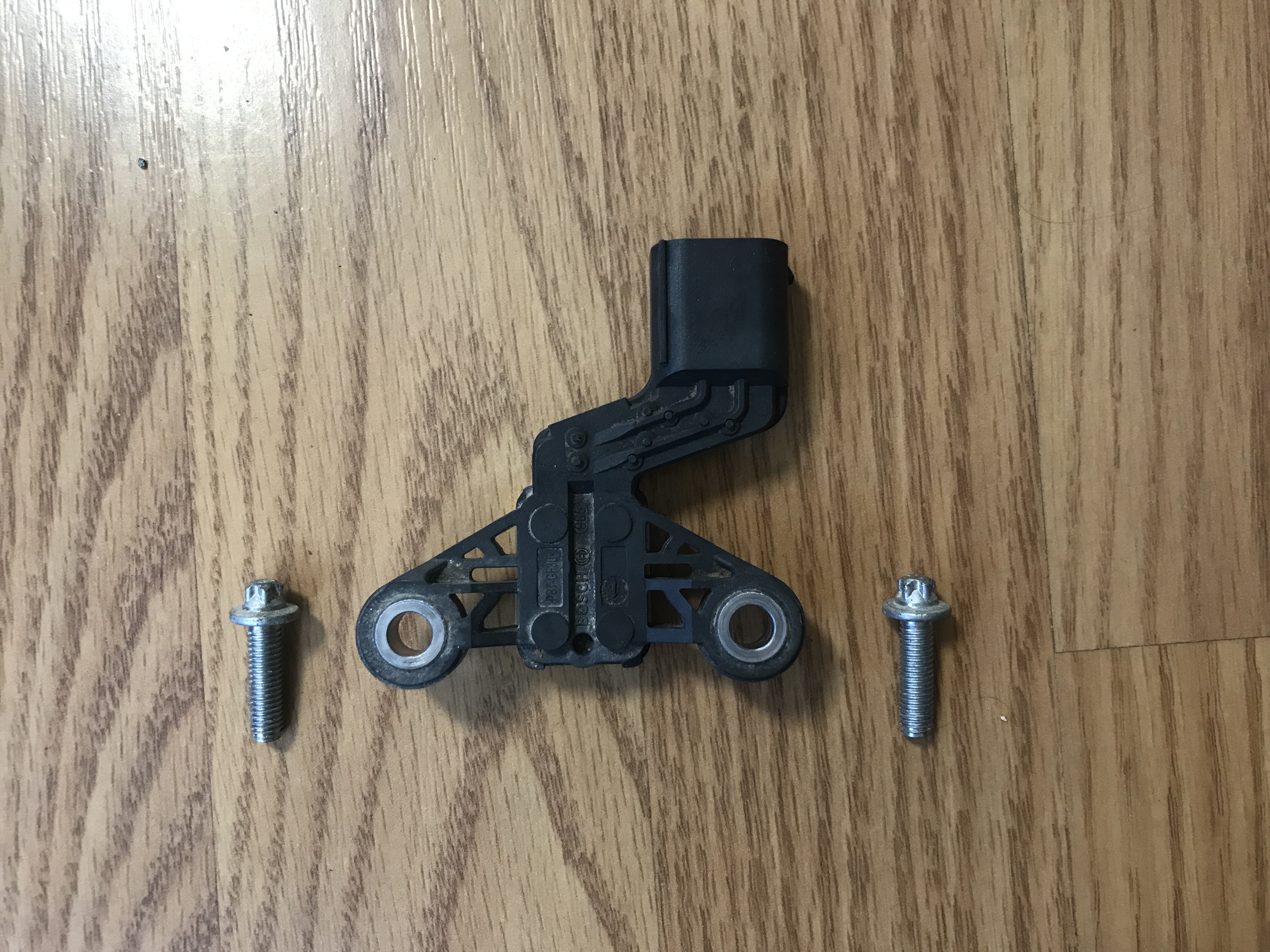

it appears what I would call the pedal sensor is held on by 5 Pt. EPR Torx bolts, don't take this for granted, these are not the dime a dozen 6 point torx we are familiar with

Post by Gregski »
and delivered ahead of schedule, praise be to Bezos !
and we in business

I must admit in all my days and days of experience working with this thing, I did not expect this pedal sensor to look like this:

Post by Gregski »

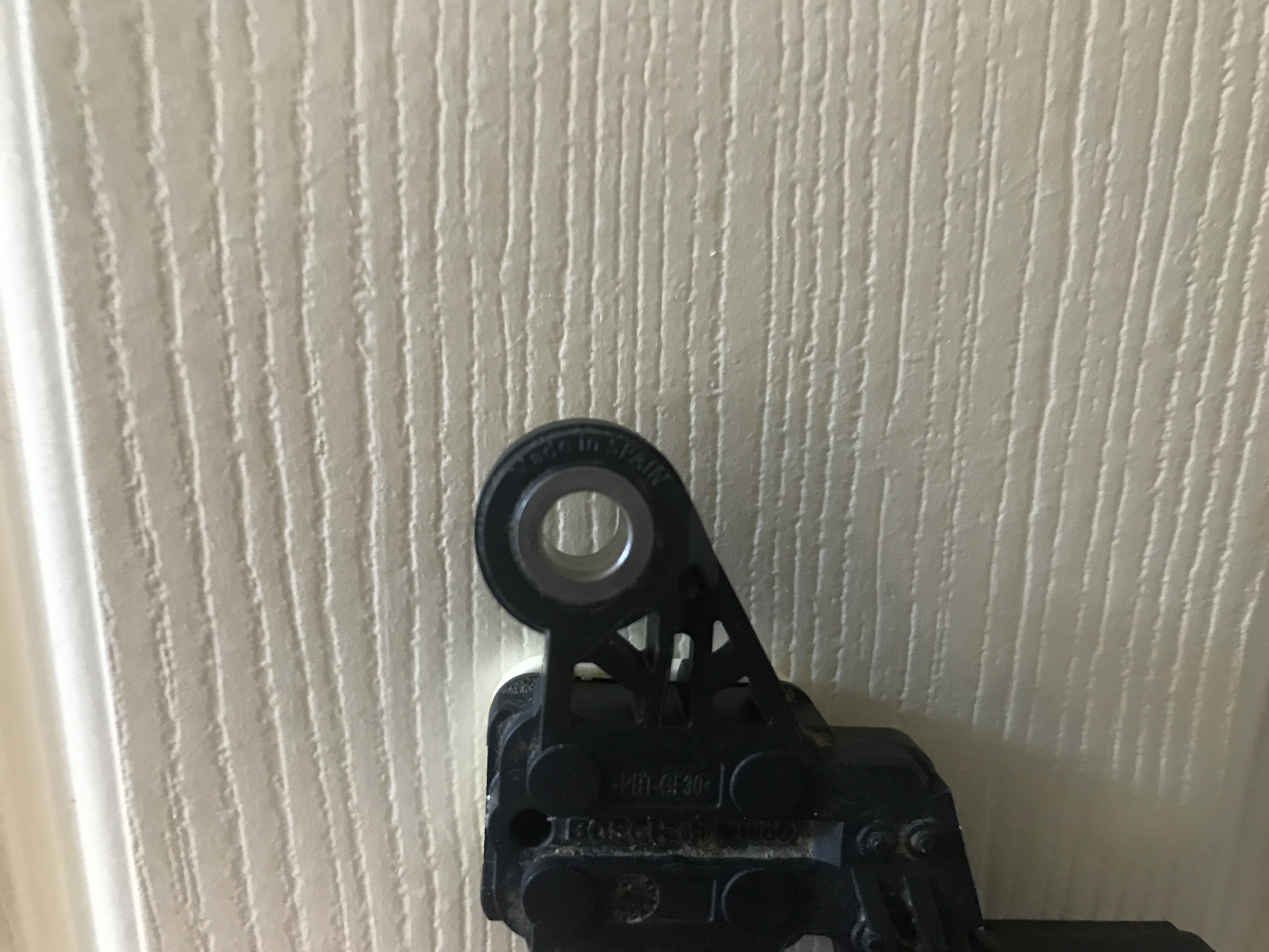

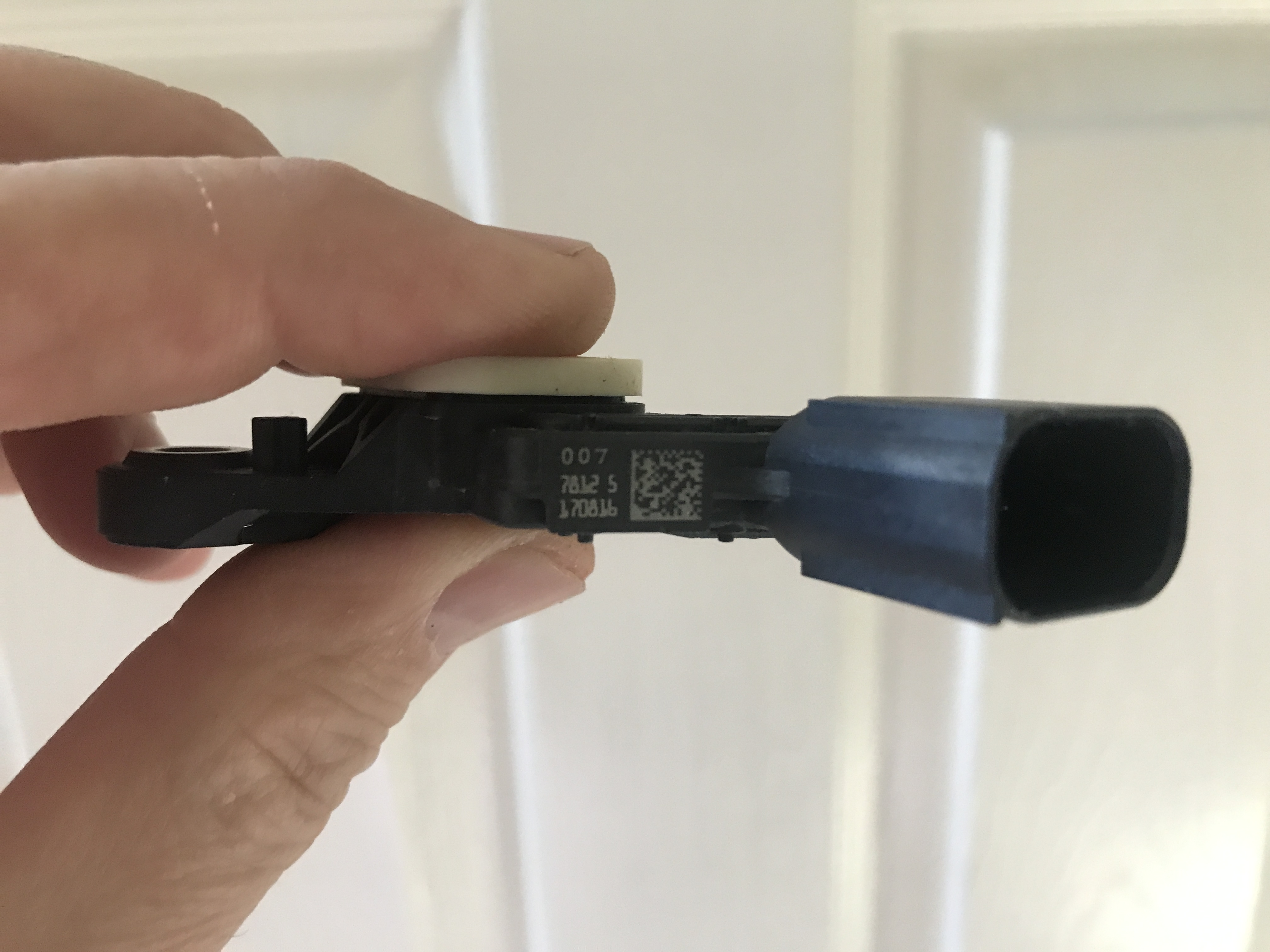

and here is what I recon is the part number, the little square doo dad did not make my iPhone go anywhere, but I can't help but wonder if it is the same part number as the one on my Tesla Model S first Gen iBooster
Part Number: 7812 5 170816 (maybe ??? not sure if that's really what it is)
and I think that reads: Made in Spain (ahem, Johannes... you have some explaining to do?!)

Gregski wrote: Fri Dec 16, 2022 7:38 pmit appears what I would call the pedal sensor is held on by 5 Pt. EPR Torx bolts, don't take this for granted, these are not the dime a dozen 6 point torx we are familiar with
As someone once said to me when I asked if they had a security torx bit set...
"Yeah, here's my security torx bit set"
And then they slid over their drill bits.
Or maybe it was a dremel and a slot screwdriver.
Either way. Eeesh. $30 + shipping for the 1 bit you'll need, once.
