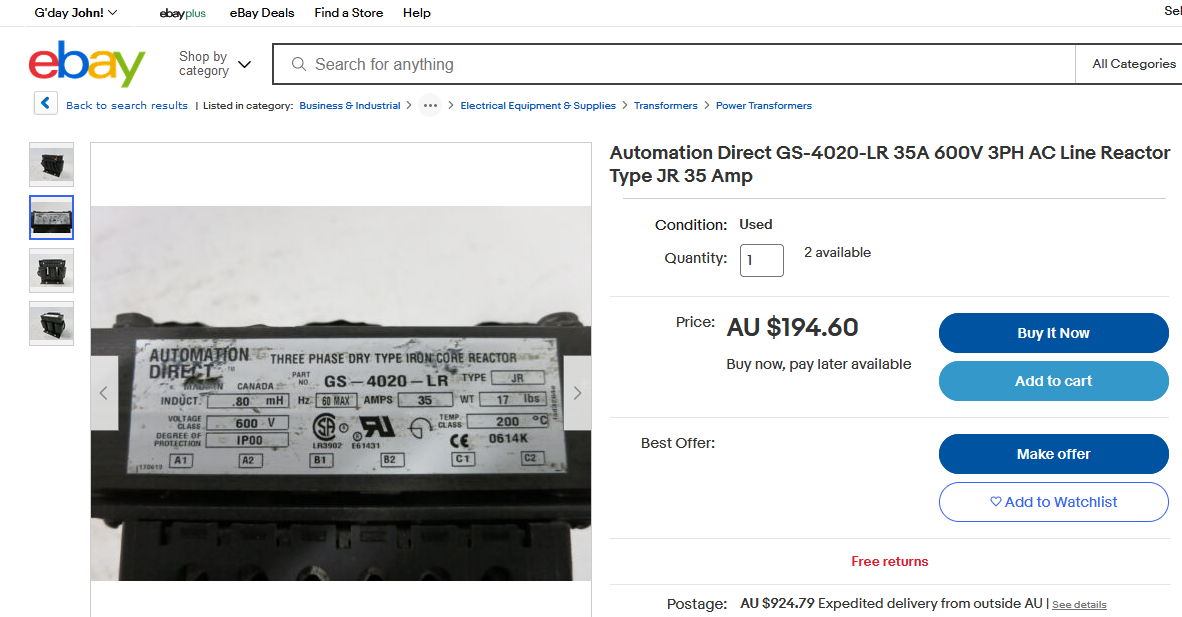

For Addvalue, I would use an inductor rated for 2x what you want it to put out, ie 2x 16A = 32 Amp rated, for thermal safety.
I would use a microwave transformer 1uF capacitor to create a low pass filter.
Hate the price, so I would look around.
