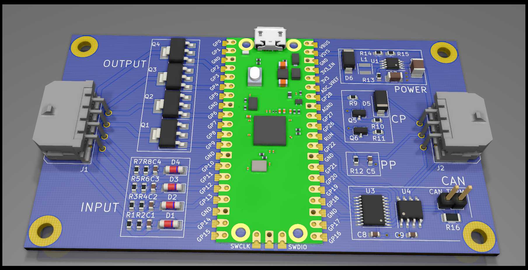

Indeed - there were 2 reasons I used the Pi Pico:
1) PIO - no MCU can implement this proprietary serial protocol in hardware, so the only option is to "bit bang" it. PIO essentially gives you dedicated CPU cores for exactly this purpose.
2) Availability. I have started using RP2040 (Pi Pico) instead of STM32 because their minimal use in industry, and single SKU means they are readily available, unlike pretty much every other MCU right now!

Thanks! You will need to check whether your particular pack has a bq76PL455A chip in each module, if so, this should work.sigdigits wrote: ↑Thu Apr 14, 2022 6:42 pm This is awesome! I'm looking into options, and most seem very overpriced for what they are. I wanted to verify if this would work with the battery pack from a BMW 530e? I assumed yes, since its a phev with the LG cell packs, but wanted to check. If so, it seems like a way better option than the over $600 SimpBMS!
If you are comparing this with SimpBMS, you have to realise that Tom's BMS provides a complete, tested, supported, configurable BMS. Whereas mine, while free and perfectly effective, is quite barebones, and will likely require some basic development skills and understanding of CAN to use effectively.

This is correct. This BMS board does only the following:Swing wrote: ↑Mon Apr 18, 2022 9:27 am So it seems to me that your board/solution can decide to do balancing on its own and it can communicate with CAN bus chargers. However, it does not offer the full set of the aforementioned SimpBMS which controls a contactor. And can measure from a shunt to release the contactor based on current information.
So this means there should always be some kind of master device controlling this (contactor and shunt)
Is my view of the situation correct? I did not read the whole github yet.
* Cell voltage monitoring
* Automatic balancing
* Transmitting CAN packets with voltage information
* Module temperature monitoring (though this is likely specific to the LG modules I'm using)
I have also designed this (very similar looking) companion board, which has CAN, CP/PP, 4 x 12V inputs and 4 x switch outputs. It is intended to fill in the gaps in functionality that you describe. It can be found here, but note that is has no software yet, and even when it does, it'll likely be a very vehicle-specific thing. https://github.com/catphish/ev-charge-controller
For my vehicle, I intend to program this board to do the following:
* Communicate with EVSE
* Enable/regulate my CAN controlled charger
* Switch on coolant pumps when needed
* Enable / disable the inverter to prevent driving while charging
* Communicate over CAN with ISA shunt and gauge cluster to display current and state of charge
I wouldn't describe either device as the master as they both operate independently and perform different functions.
I believe contactor control is better left to the inverter to handle, and again this will be independent of the other modules.
I will definitely not do this. It is a sure way to destroy a Tesla inverter if it's not already destroyed

Nothing stopping you editing the code (or hardware) to suit your particular use case...
The pl455 'measures' temperature just as analogue inputs (and spits out the raw analogue reading). Most battery modules will have a thermistor to measure temperature, but no guarantees that the CATL modules use the same thermistor and potential dividers as the BMW modules!

Yes, this is absolutely the case. In fact the first iteration of my firmware just acted as a slave to SimpBMS, but then I realised for my case, it was simpler to have my board act standalone and do the balancing itself.Swing wrote: ↑Mon Apr 18, 2022 10:57 am Ok in general I understand that your solution tries to be more like a master CAN module (master of information only), aggregating information and letting other entities decide.
So you are not trying to be a full fledged BMS, protecting the battery against everything.
I allow other devices to handle other protections. For example, my inverter will shut down on under-voltage, and my charger will shut down on over-voltage. I realise some BMS systems do all of this, but it seemed redundant, in my case, and potentially harmful to the inverter. It would potentially be useful to have some additional protections and warnings, but I haven't felt the need to implement them.
This is absolutely why I designed the second board. Basically I ran out of IO pins on the microcontroller, so I split off the charging logic to a second board. It's pretty much independent, but through the magic of CAN, it can of course use voltage data from the BMS board to shut off the charger if required.
The bq76PL455A has 8 general purpose analog inputs. In my battery modules, two are used for temperature sensors on the PCB to monitor the temperature of the balancing discharge resistors. Two are used for external NTC temperature sensors, and one is (I think) used for an internal NTC temperature sensor. There is no reason to assume that a different manufacturer would have used the inputs for the same purpose.
In terms of the overall goal, unless you *just* want balancing it is indeed best to see this board as one module in a larger solution. It has IO for 3 x battery strings, 2 x 12V general purpose inputs, and CAN. It can do anything that's possible with those IOs. Anything that doesn't fit into those IOs will need the expansion board, or third party CAN connected parts, and some programming

After some more investigation, and re-reading datasheets, I intend to test the following changes:
Increase inductance of common mode filter from 22uH to 100uH. Datasheet recommends minimum of 50uH, 22uH was definitely a mistake.
Increase capacitance of isolation capacitors from 1nF to 4.7nF or 10nF. Datasheet is a little unclear on this, but recommends 2nF in noisy environments, and to double it when using a capacitor at both ends of the link, to 1nF is definitely too small.
Increase resistance of pull-ups and pull-downs from 1k to 4.7k or 10k. This is a total guess, the official implementation doesn't require these at all.

Just had a look through the data sheet and it's a little contradictory in places! In particular is states that the total resistance of the COMML lines must be less than 20R but then specifies that a 10R series resistor should be used at each end making this impossible! It also states that this resistance is needed to limit in-rush current so I'm wondering if it should read at least 20R. As you mention it also says to double the cap value if two are used but then on the diagrams showing two it still has 1nF shown.
Changing to the 100u choke is a good move.
The caps will probably make the biggest difference. Looking at the impedance at twice the comms frequency (and assuming default of 250k baud and Manchester encoding) each 1nF cap will have an impedance of around 300R which is going to dominate compared to the choke and series resistor impedance. I would probably go with a 2n2 or 4n7 only increasing further if the voltage levels on the 485 seem marginal. Don't forget to use a high voltage parts for these!
On the pull up/down there is a comment in the data sheet in 8.1.2.1 which mentions 100k. There are no terminating resistors in this application so all the pull ups have to do is hold a large enough voltage across the transceiver input impedance to keep them in the idle state. 100k suggests that the bq76pl has a pretty high impedance on the inputs (makes sense for a low power application) but your 485 driver will be lower so needing a bit more current. A few 10's of k would seem plenty.
Assuming that the bq76pl COMM lines are probably only 485ish the best way to select the components would be to measure the voltage levels on the daisy chain for both bq to bq connections and you bq to 485 connections in both the idle and active states and tune the components on your board to keep them similar (but also ensure that you meet the 200mV minimum level for the 485).

One more thought on the pull up/down. The 1k values make for quite a heavy load to drive through the coupling network, you must be losing 2/3 of the signal. If the drive strength of the bq76 a bit on the low side too it may struggle to reach the 200mV RS485 threshold.

When I reread the datasheet last night, I found exactly the same set of contradictions. Thank you for confirming that I'm not just misreading it!Pete9008 wrote: ↑Thu May 05, 2022 10:47 am Just had a look through the data sheet and it's a little contradictory in places! In particular is states that the total resistance of the COMML lines must be less than 20R but then specifies that a 10R series resistor should be used at each end making this impossible! It also states that this resistance is needed to limit in-rush current so I'm wondering if it should read at least 20R. As you mention it also says to double the cap value if two are used but then on the diagrams showing two it still has 1nF shown.
Agreed, 1n is definitely attenuating the signal too much. In testing I have dramatically improved performance by simply bypassing them, but obviously I'd prefer to leave them in for additional safety if I can do so without causing a dramatic loss of performance. I have ordered 4n7 and 10n capacitors to test. Is there a significant disadvantage to going too large with these? I'm using 1000V caps to voltage shouldn't be a problem.Pete9008 wrote: ↑Thu May 05, 2022 10:47 am Changing to the 100u choke is a good move.
I am fairly sure I have made a mistake by loading down the signal with the 1k resistors, but wasn't able to quantify this so thank you for doing some maths here! I have ordered 10k replacements. These may still be needlessly strong to hold the lines in the idle state, but will hopefully be large enough to give a significant improvement.Pete9008 wrote: ↑Thu May 05, 2022 10:47 am On the pull up/down there is a comment in the data sheet in 8.1.2.1 which mentions 100k. There are no terminating resistors in this application so all the pull ups have to do is hold a large enough voltage across the transceiver input impedance to keep them in the idle state. 100k suggests that the bq76pl has a pretty high impedance on the inputs (makes sense for a low power application) but your 485 driver will be lower so needing a bit more current. A few 10's of k would seem plenty.
Thanks again for confirming that the changes I am making are sane. In my initial design, I chose a lot of the values hastily, and since it appeared to work, I didn't give it any more thought until I started testing in real vehicles and realised it wasn't going to be good enough.

Not really. The bigger the cap the more energy is pushed through it and into the TVS diode during pack connects/disconnects (that's why the TVS diodes are needed in the first place) but it's less than a mJ even with the bigger caps so can't see it being an issue. It's possible that you could start over driving the inputs, but again unlikely. It's also a case of diminishing returns as you still have the 1nF at the far end (so I think my earlier comment where I said the caps will make the biggest difference is in error, it's changing the pull up/down that will make the biggest difference). My approach would be to put the 4n7 caps on, measure the signal levels and only if there was insufficient margin try the larger size. That way you end up with the smallest value that gives you the design robustness you need.
Sometimes, when you don't have all the information, the best way forward is to just quickly design it, build it, try it and see what works!

I've just reworked a couple of boards with the new parts: 10k, 100uH and 10nF. Everything still works on the bench.
I currently have 2 vehicles I'm testing this in. In both cases, the cables from the BMS are fairly long (1-2m), the original design didn't work unless I bypassed the isolation capacitors, and failed as soon as the motor started spinning.
