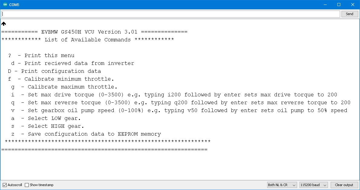

and I am pleased to report that with zero effort on my part, meaning having soldered nothing to the board myself, as you can see the WiFi adapter is just laying along side of the PCB we can talk to the VCU via a USB cable and the Arduino free software called IDE, which stands for a fancy text editor on steroids and a compiler, Integrated Development Environment
you are welcome to Google Arduino or watch me try to ride that Bronco in a companion thread called Any Isabellenhütte IVT-S Ninjas on here?
Posted: Sat Nov 06, 2021 5:06 am
by Gregski
Essentially we are simply using the free Arduino IDE software as a Terminal Emulation program to serially talk to our VCU since some companies decided to no longer include a perfectly good Terminal Emulation software in their Windows Operating System [yes I'm looking at you Microsoft]
so yeah it's as easy as point and shoot, just make sure your Arduino software knows which COM port to look for the VCU on like so
and then dial in your Baud rate (pronounced: how many symbols we can send per second)
and if we type ? and hit enter we get the Menu
the menu is case sensitive so lower case d gives us the received data from the inverter
