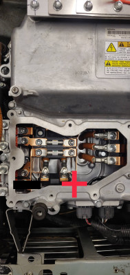

Hi
Just starting to power up the inverter, motor to go in a Grandin Dallas Jeep
can someone post a photo of the HV battery + and - screw terminals polarity ,please
Cheers

Positive is on the fuse side.

Hi
trying to get this to spin on 128v as a test. Is there a minimum as having no joy ?
What is the max voltage for the rear inverter also ?

Minimum 200V. Not sure of maximum, at least 395V possibly 420V.

Inverter shuts down over around 405v.
