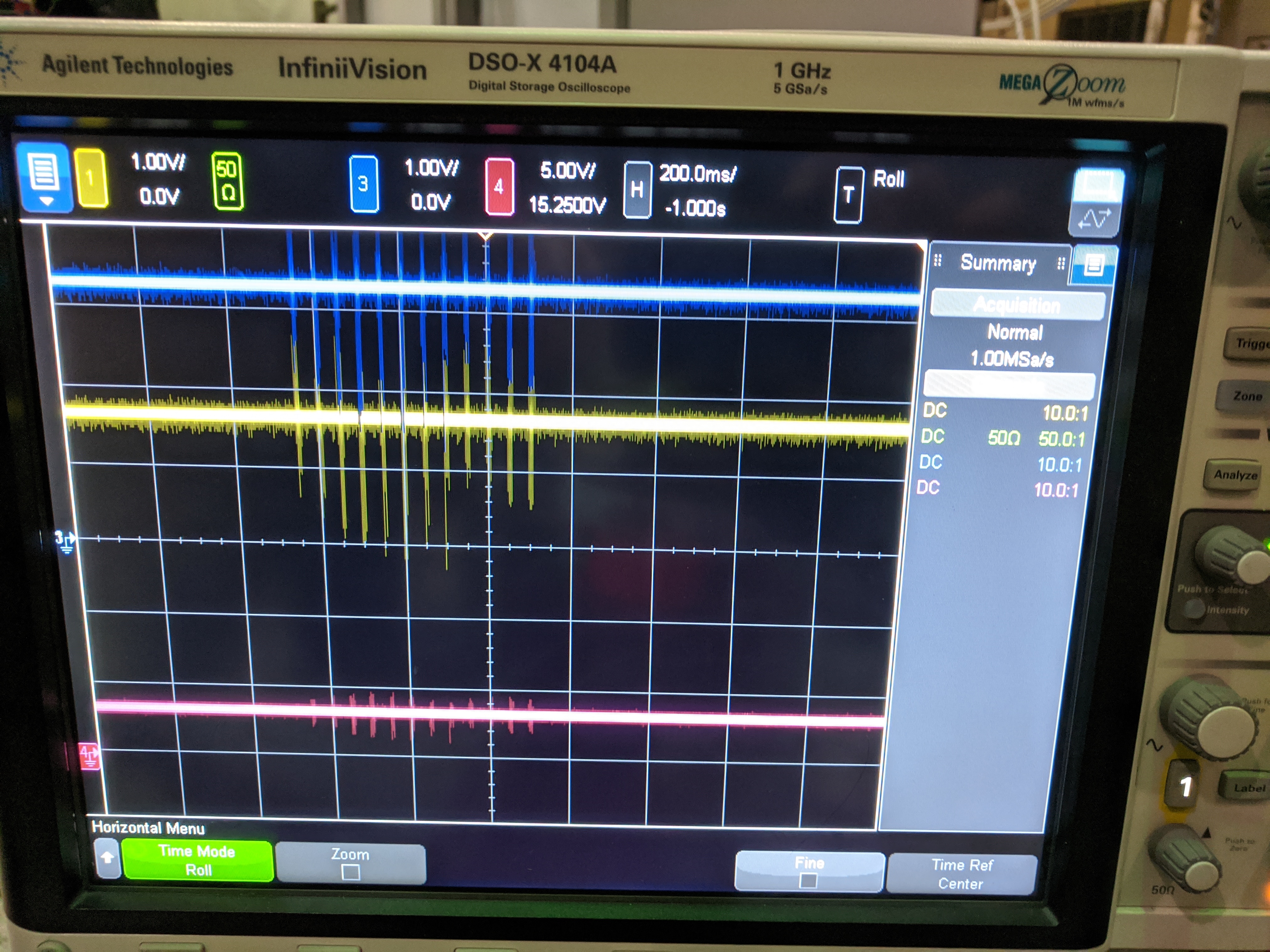

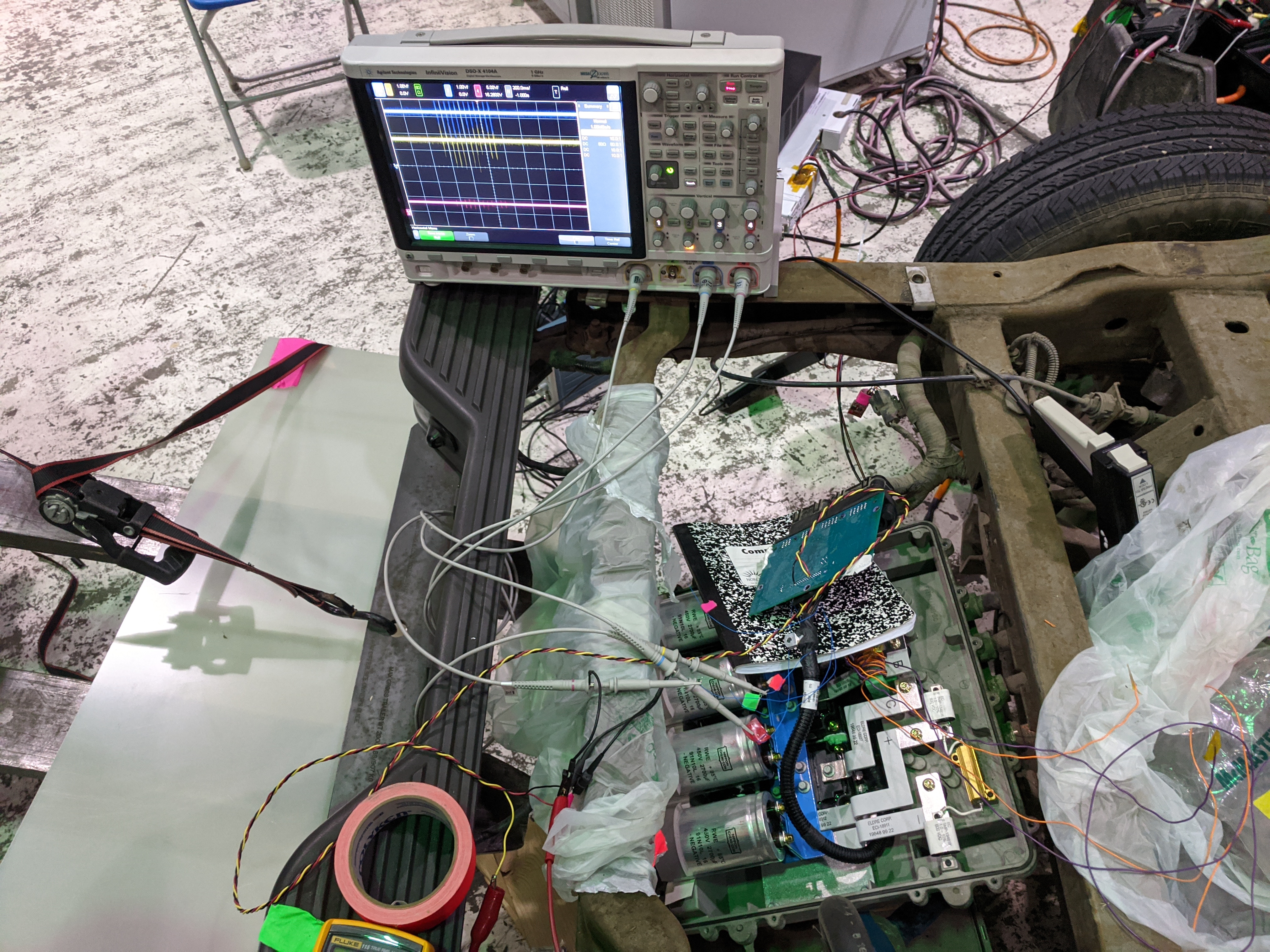

We conducted the test mentioned in a previous post in which the brake pedal was depressed after the ignition is on and the gear is in drive. The main contactor opened again even after the firmware update and parameters updated.
The oscilloscope in the photo captured a spike at the moment of the brake depression that may the source of the over current error. We were measuring one of the comparator circuits. I will update tmrw which circuit exactly we were measuring.
We also noticed similar spikes while switching the gear selector. It's possible the comparator circuit is picking up some noise that is causing it to send a possible erroneous signal which may seem like a current surge and opens the main contactors.

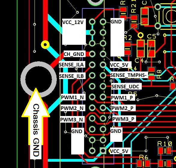

There is a bug in the board version that you have, that may be relevant. The chassis ground in to the board has one function, and that is to give ground to the gnd shield in the current sensor signal wire. You could solder a wire with ground lug to this screw hole in the board.
I have not done this in my truck or others, but it would not harm....
Chassis gnd is located here:
BUT more important!! if you don't have the braided ground strip that should go from inverter casing to truck chassis, you have no chassis ground at all, that is not good for emi noise

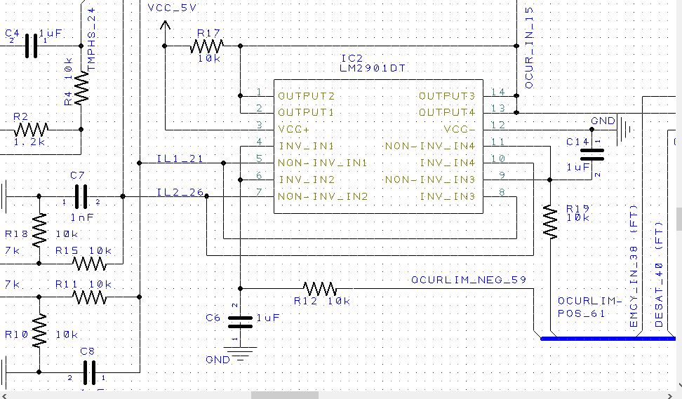

Did you read the current or run a plot on the web interface, when you did the wrap wire around current sensor test.
If you could repeat this test, and simulate pos and neg current of 0 to 400A with wrap wire around current sensor.
And with the car in "RUN" mode and not let go off brake, best is to disable creep mode (disable idle speed/creep set idlespeed to -100), then you don't need to press the brake.
And run a slow plot in the web interface, with log on spot value: din_ocur, il1 and il2.
Then you can see exactly at what current level the overcurrent error appears.
If it trips at the wrong current level, there is some hw error in the comperator resistor divider...... Or some EMI noise....
Maybe some more aggressive filtering would be needed, to depress "false " (noise) current spikes.

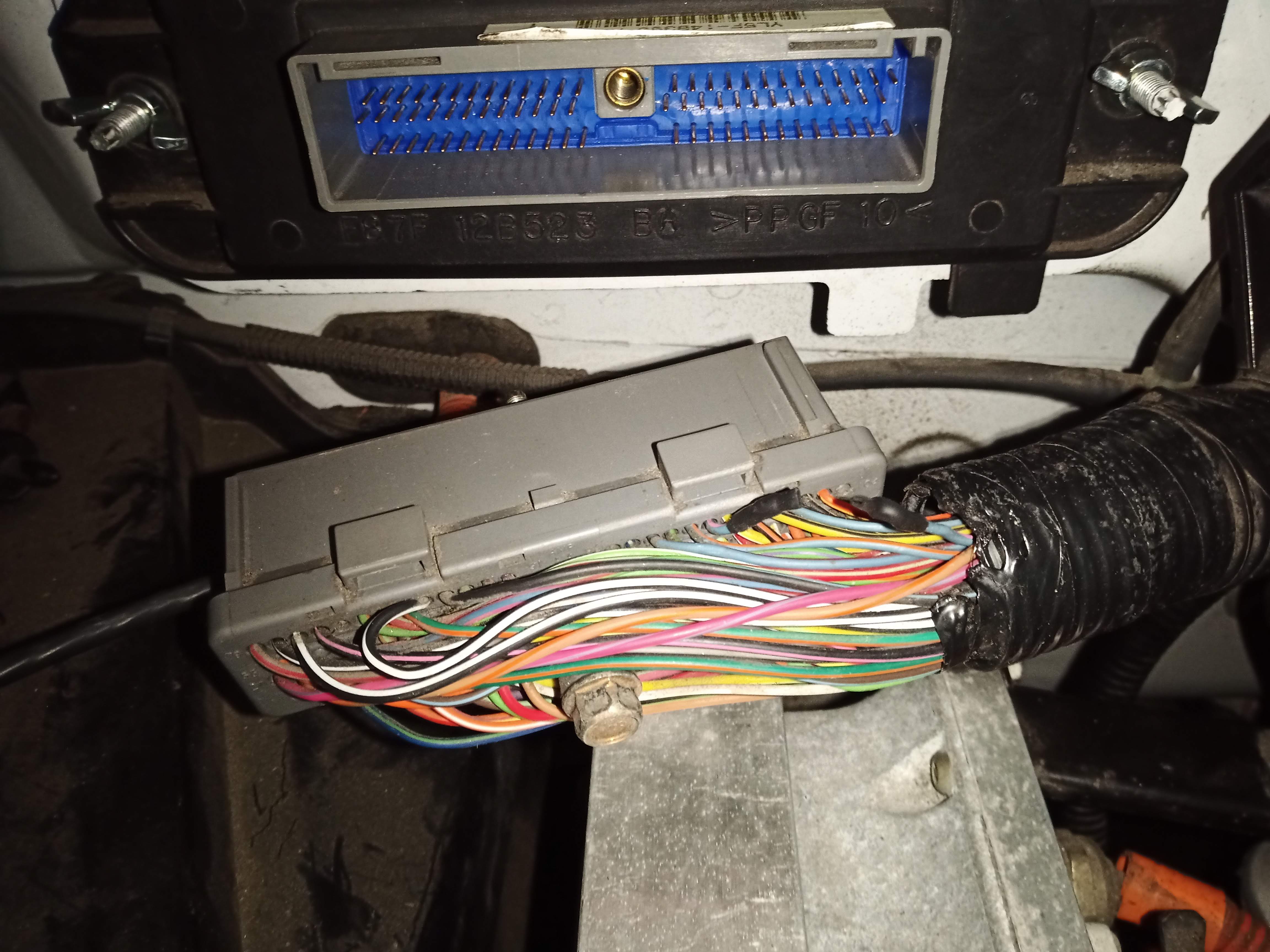

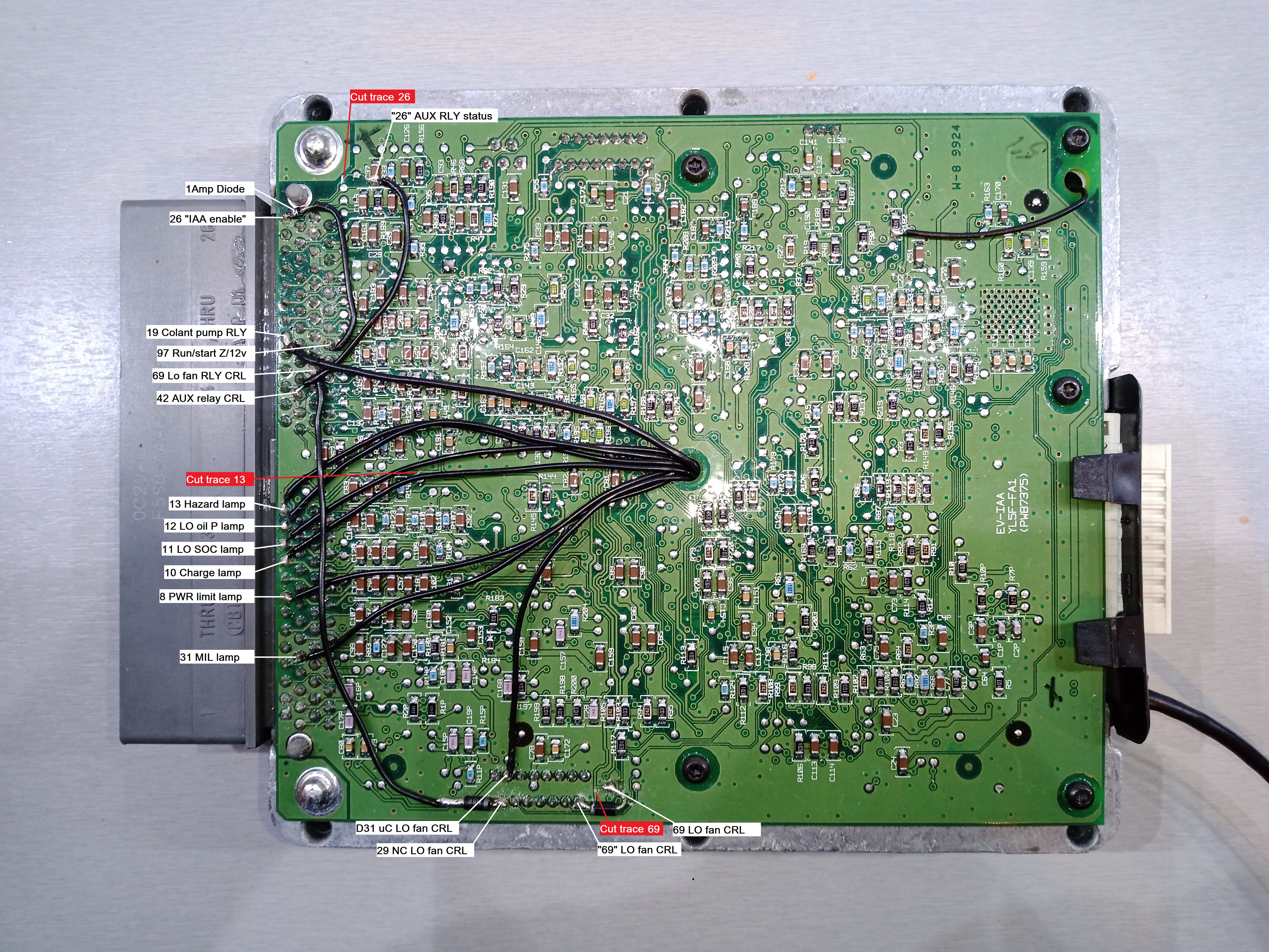

Hi, allenwrench.
Maybe a little premature, but just wanted to give you this info, before you start to remove more chips.....
The IAA module has many important functions, that will work even if the BCM is removed!
Controlling:
High voltage AUX relay and feedback.
DC/DC and temperature sense of 12V battery.
Air condition and cabin heat.
Vacuum pump.
Coolant pump, coolant temperature sense and radiator fan.
The list go on.........
All this will work if the IAA is enabled AFTER precharge of high viltage AUX circuits.
If you want to use original wires (recommended) you have to do some mods to the IAA circuit board.
(right click and "open/save link" to get big picture) Cut trace 26, red textbox. Solder diode and wire between pin 26 and pin 97 (run/start).
Then connect your BMS precharge output to your precharge circuit.
Connect the BMS pos contactor output to the IAA "new" pin 26, which now is IAA enable.
You must also cut the wire from ignition (run/start) at the IAA connector pin 97, so you don't get IAA enabled from ignition (before precharge) but from BMS.
The new IAA enable, will also be used while charging, with modified original charger or other charger.
Have a look at my setup with the Simp BMS, maybe some of it have similar functions as your BMS.
Ranger_setup_new_8 - Schematic.pdf
viewtopic.php?f=16&t=187#p1870

Re: Ford Ranger Inverter board Support Thread
Don't forget this mod, if not you will burn your HV AUX relay after a while, because the IAA close the AUX to fast, before the BMS has precharged the AUX circuits.
IAA cut pin9 7 295 (LB/PK) wire, run/start.
And run new wire from the BMS to the IAA pin 97.
