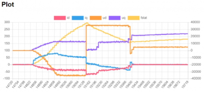

I have done a lot of test drives in the last weeks and although I made some progress, the motor is still not working as expected.
Mainly, the unwanted regen is still there, although it is shifted to only happen above ~2800rpm and it feels not as strong as in the beginning, even though it can reach ~50A regen current. This is at curkp=250, curki=3000, curkigain=0, syncof=47500, syncadv=10. Increasing syncadv decreases this regen current all the way to 15A at syncadv=40 and increases the subjectively perceived torque at sthe same time. At this high value however, the car accelerates on its own when letting go off the throttle above ~5500rpm.
Here (
viewtopic.php?p=38910#p38910) it is mentioned that syncadv should stay at ~10, as it is just meant to compensate the time lag of the resolver readings at high rpm. So I stopped experimenting with it.
I have also tried every one of the 4 permutations of the resolver pair polarity combinations, but two of the combinations didn't worked at all and the other two were identical. Going through the whole range of syncofs values also did not reveal any improvement.
Thus, my latest attempt was to modify the firmware (v5.17) with custom MTPA constants that I found online for the Prius Gen3 motor:
static const s32fp fluxLinkage = FP_FROMFLT(0.124);
static const s32fp lqminusldSquaredBs10 = FP_FROMFLT(0.00074); //additional 10-bit left shift because otherwise it can't be represented
static const s32fp lqminusld = FP_FROMFLT(0.00085);
Furthermore, I integrated the corrected (?) MTPA formula from here (
viewtopic.php?p=28867#p28867).
s32fp term1 = fpsqrt(fluxLinkage2 + ((lqminusldSquaredBs10 * isSquared) >> 7));
idref = FP_TOINT(FP_DIV(fluxLinkage - term1, 4*lqminusld));
iqref = sign * (int32_t)sqrt(isSquared - idref * idref);
I also tried the original MTPA formula and it feels like the correct one causes more torque at low rpms, however there seems to be no difference at high rpms between the two. Sadly, there is also no difference compared to the original constants, the unwanted regen remains unchanged.
Here is another interesting plot when driving downhill: (parameters from above were used, ffwstart = 400Hz = 6000rpm -> no field weakening)
The car accelerates till 81852 where I completely let go off the throttle. Unwanted regen starts off at ~35A and tapers off to 20A at 83800. The motor stutters barely noticeable and then just freewheels with 0A. As I am going downhill, the rpm starts to increase again but there is no regen current. Hence, it seems the unwanted regen is not dependent on rpm alone.
Other notable quirks of the car are, that torque and power feel really good at low rpm (motor input current ~100A), but quickly taper off (e.g. only 60A at 5000rpm). It seems like the inverter can't push il1 and il2 above 90A (slightly dependent on syncofs), no matter how high I set my throtcur.
Also, driving backwards at syncof=47500 causes the inverter to quickly heat up and overheat. Lowering syncofs to 41000 gets rid of the overheating, however the motor now has only very little torque in forward direction.

Thanks for those experiments. The behavior in reverse reminds me of my Leaf setup with wrong pinswap.
I think I'll make an MTPA-less firmware again that lets you configure throtid/throtiq separately.
Question: I take it that you disabled regen via parameters?

One thing I noted and that is also visible in the plot above is, that the absolute value of id increases when letting go off the throttle. I would expect both iq and id to immediately (or as fast as the PI controller are able to) go towards zero, just like they do after the unwanted regen. I redid the same scenario as above (equal parameters, driving downhill) but plotted uq and ud as well:
So before letting go off the throttle, ud seems to already max out at ~-35000. (this may be connected to my rather low power at high rpm?). Immediately after letting go off the throttle pedal, it jumps to ~35000 and again, reaches a maximum value as it seems. So the PI controller wants to increase id to 0 but as a result, id decreases even more? This goes on till id slowly creeps close to 0 and then suddenly everything is ok again. No unwanted regen, id=iq=0 and ud and uq are at some sane value, opposing the back-emf. So there definitely is a problem with id and its PI controller not being able to control it.
I also quickly tried the firmware with an alternate fw controller (
viewtopic.php?p=38670#p38670) and implemented my MTPA constants and the new formula. I also used the parameters linked in that post. On the one side there is no unwanted regen anymore, however now the car just accelerates on its own when going above 2800rpm and only stops so when bringing the car to a full stop. As soon as the car goes into auto-acceleration, ud is maxed out again:
