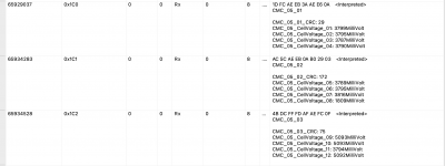

Anyone seen a BMS board reporting seemingly wrong voltages?
Using a multimeter they all measure ~3.8v
