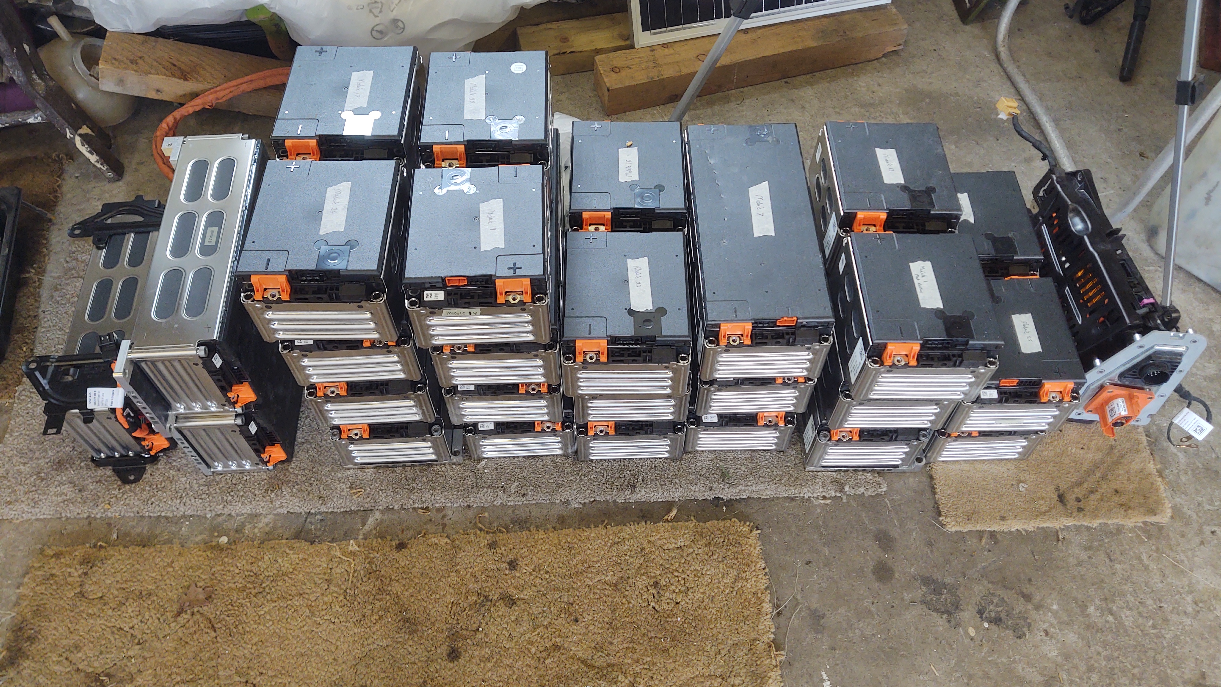

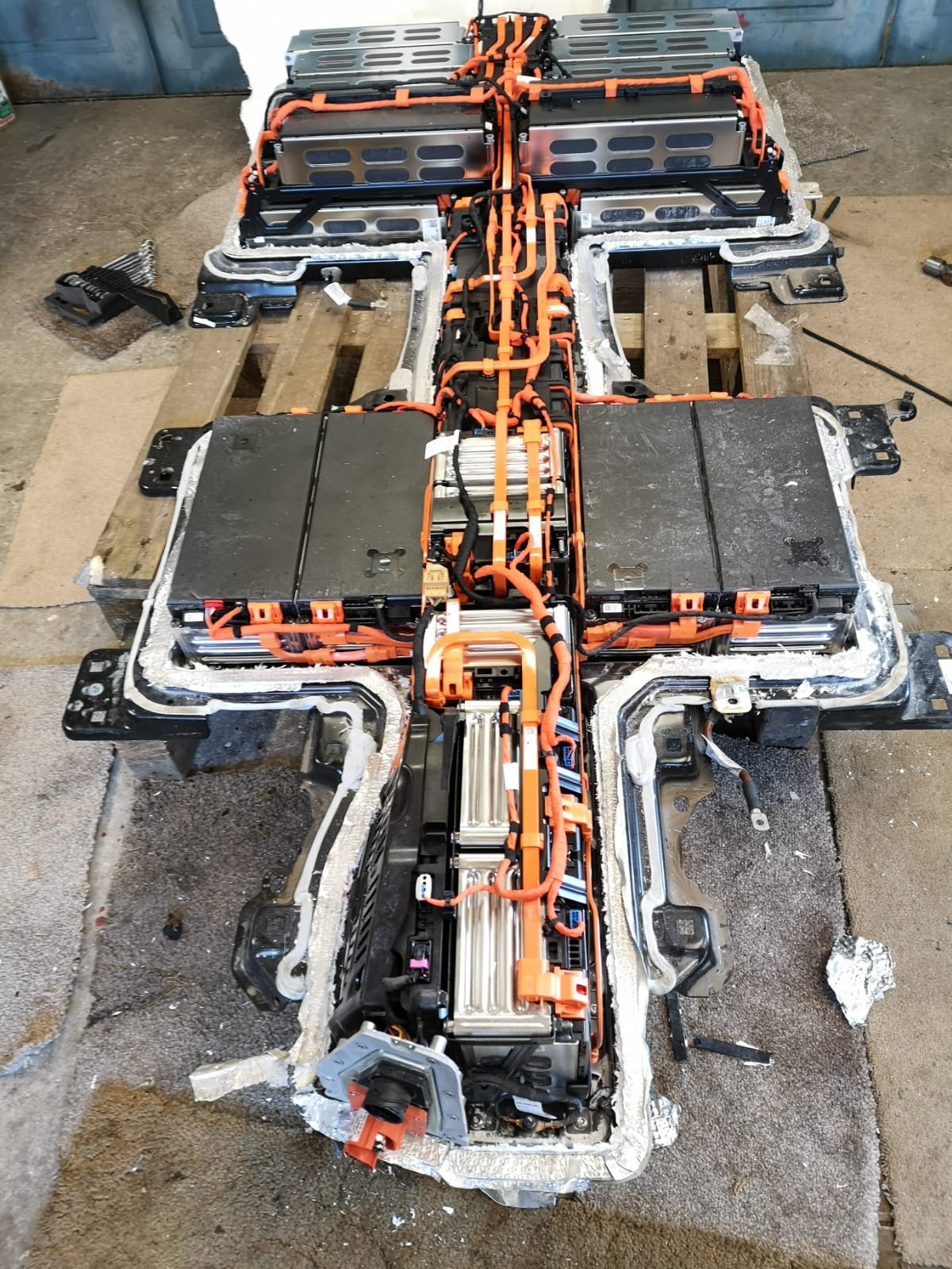

Here is a pic of the battery pack opened. I'll be posting a video about it sometime but wanted to ask you guys if there is anything you want me to do before I dismantle it.
I'm in the process of following the pixie path through the pack and marking each module and connector so once out of the box I should be able to reconnect everything as is but with better access.

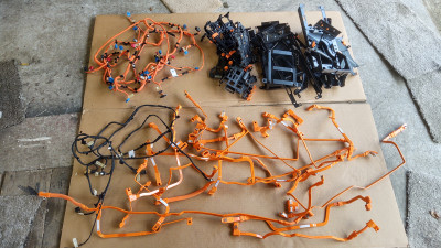

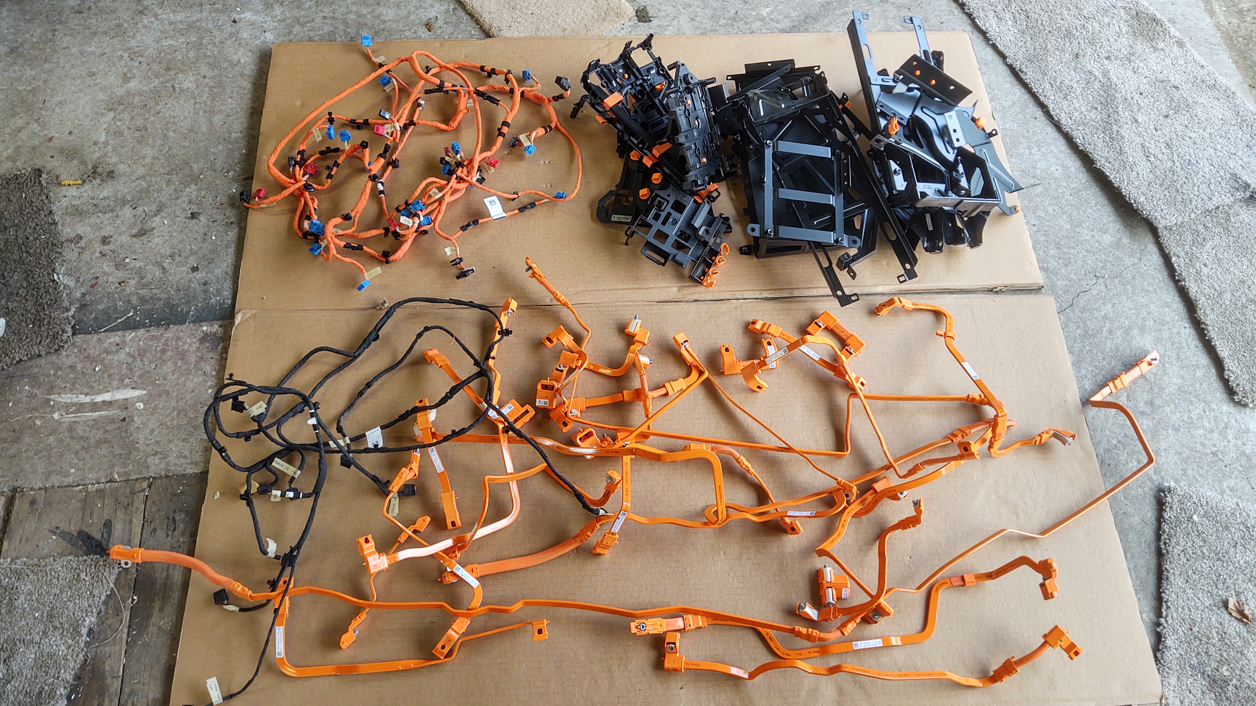

Allright, here we go. I will flood your PM with questions and pictures when I get to my parts and notes in the evening..
Lets start with finding out if you have the same wiring harness part numbers that I have? And I will find my drawings where I have traced the wiring. If you could add the HV side module arrangement then we are good to go if we sometime want to utilise original contactor and BMS box.
Modules look the same as mine, you can separate large module types from the sticker location on top and the other type has connectors in bots sides of module.
I must add that I allready cut my BMS orange harness in half because there was a point where only 1 wire goes on and I will have 2 packs.

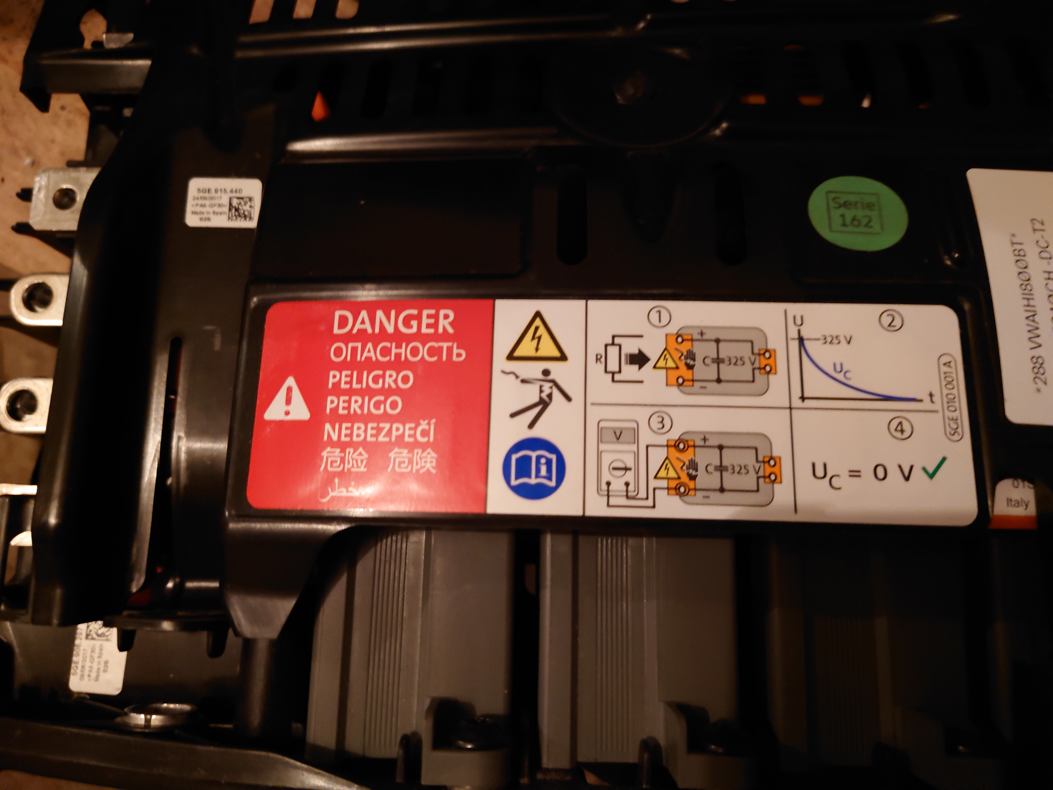

Allright, so we are basicly at the same expertism level here.
If I would have a full pack, I would discharge one cell a little with a light buld etc. And then try to find a way to start the VW BMS to be able to sniff if it wants to balance it and how. But mine is in parts and I don't know how to "start" the pack.
Please look at this before you continue taking it apart, there is capacitor in there to discharge.

I took out a couple of links yesterday to make it a bit safer and the cap is still at 290V.
Before I strip everything I'll stick a resistor across it.
Also I'll use a precharge resistor before reconnecting.

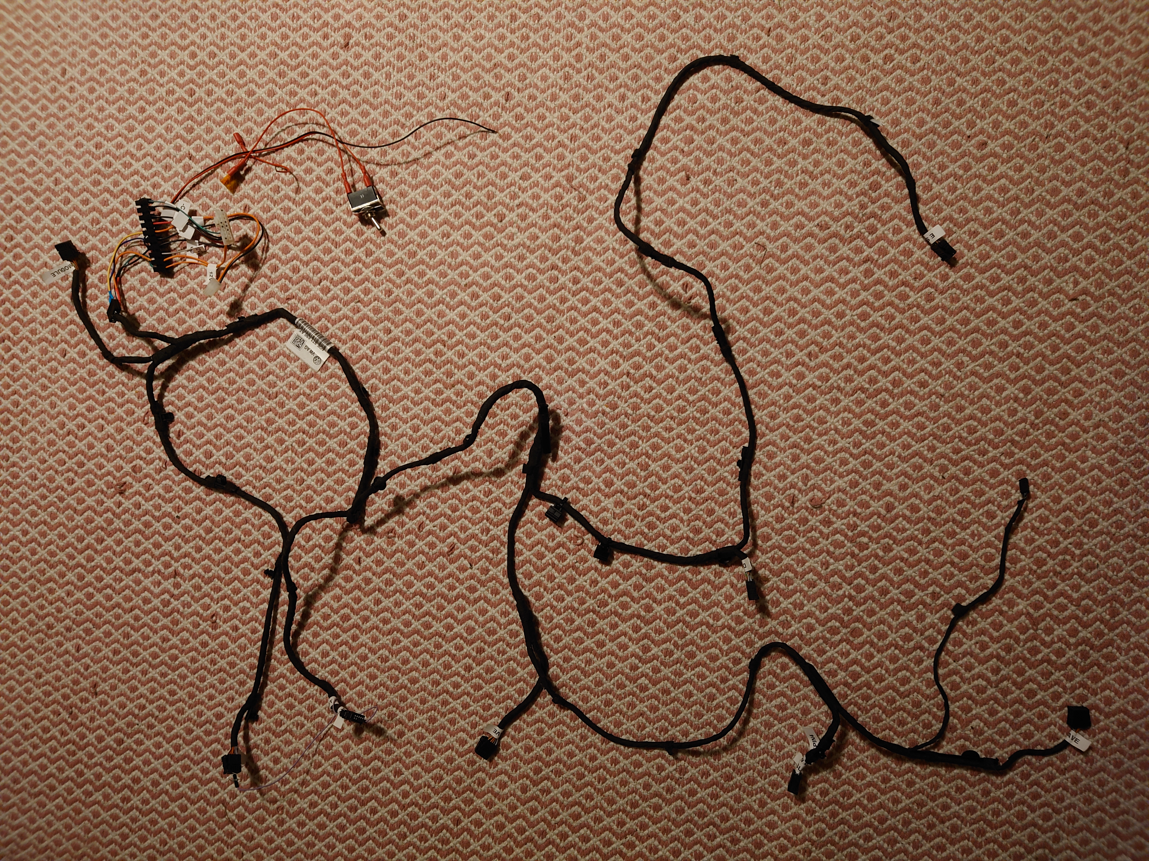

I also sent you my notes for those orange BMS and black CAN wiring between packs..
but they are made for my labeling of harness without pack, so might mess with your labeling of modules in the pack. But anyways, have fun.

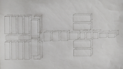

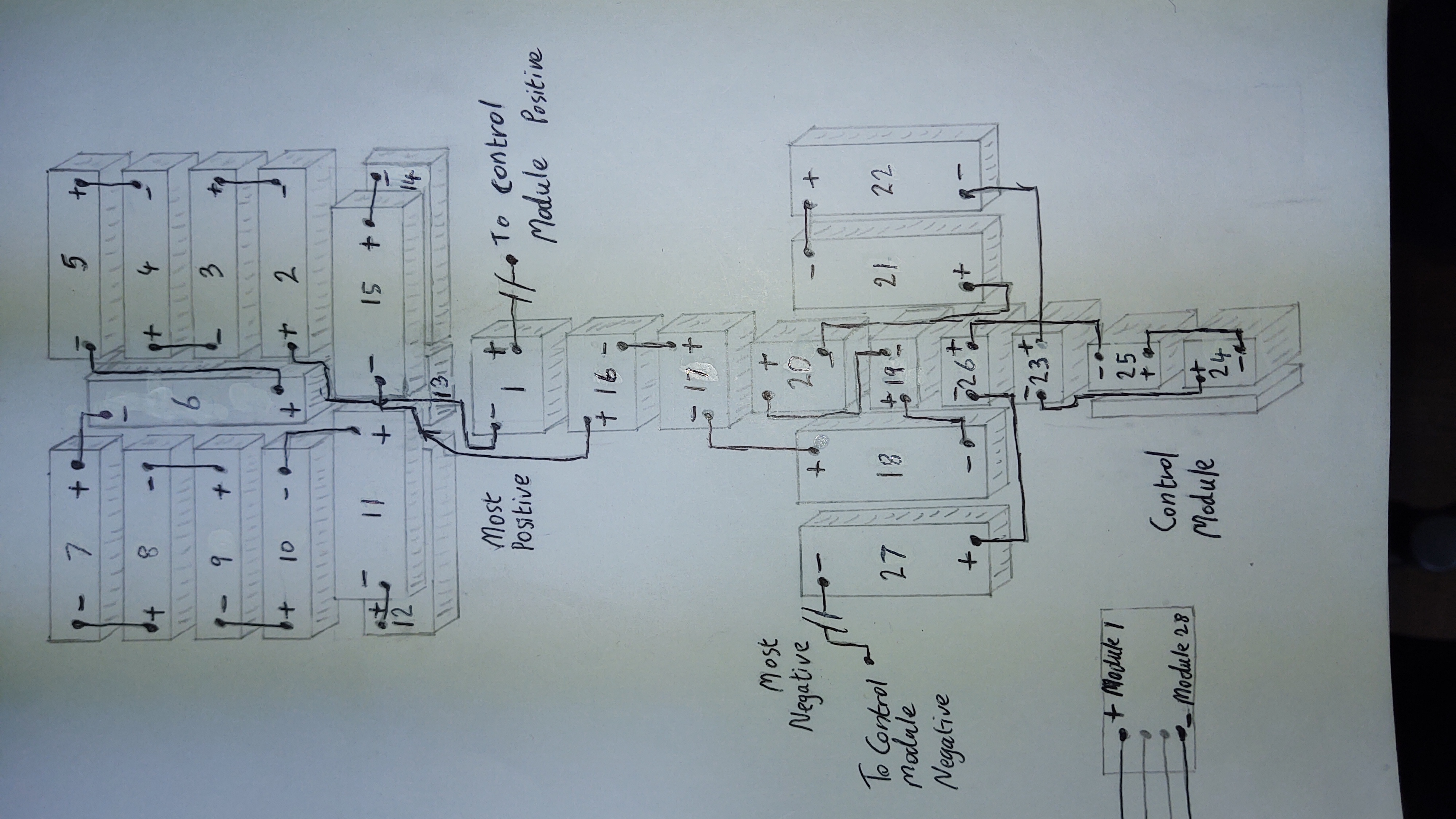

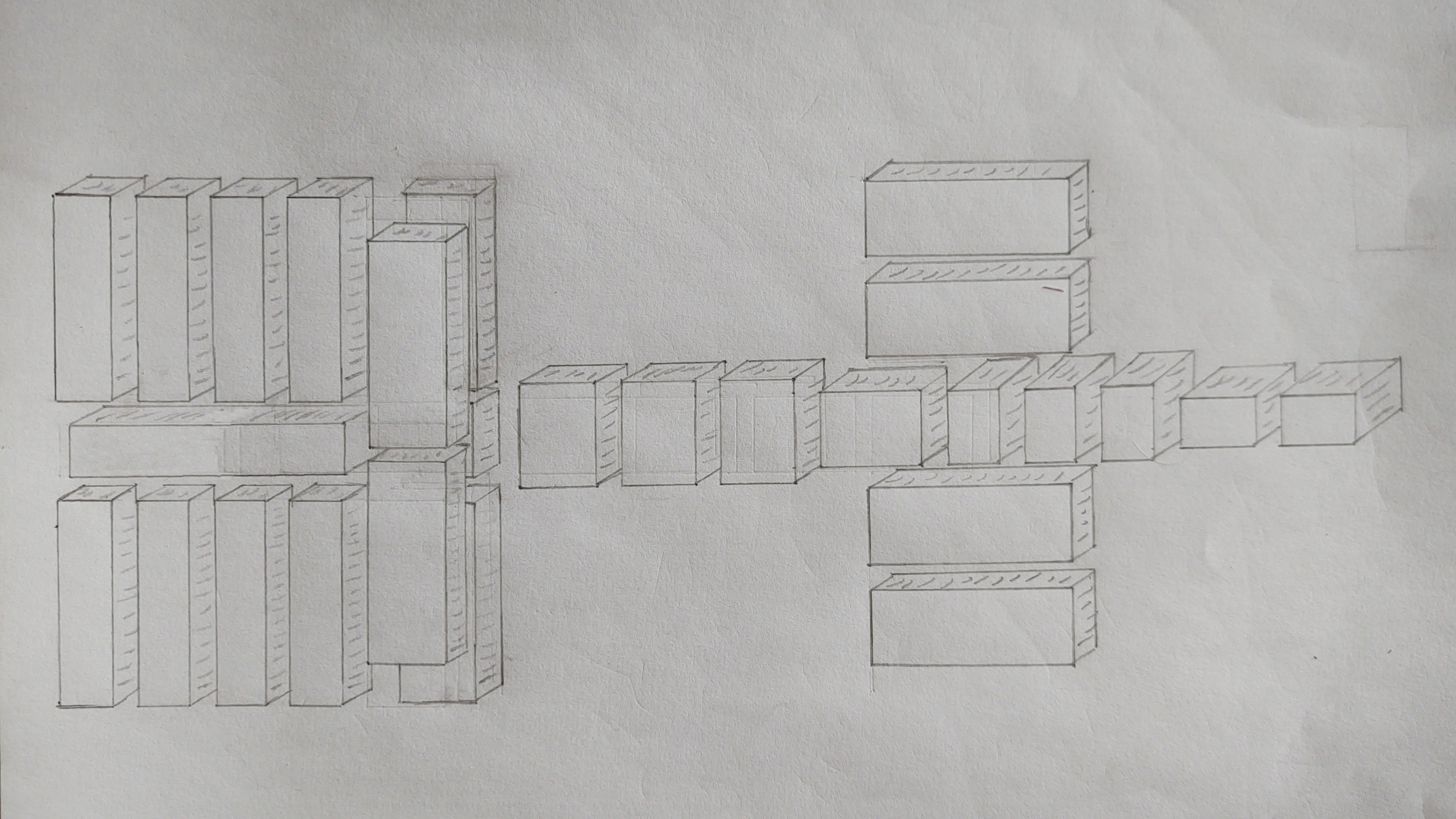

I've traced the pixie path and drawn a diagram to show the battery modules from number 1 (Most Positive) to number 28 (most negative) I still need to dismantle the pack and label the BMS and CAN cables so wish me luck on that.
Hopefully this will be useful to someone. Excuse the terrible drawing but an artist I ain't.
BTW This is edited with corrected battery module layout so forgive the tipex glare.

Alibro, please check you module 6 and 7, for I think it is only one big 4S module.
I will look at your module arrangement and compare it to my wiring measurements I sent you, if get a
moment I will share it here.

Oh bo() #*s!JaniK wrote: ↑Wed Apr 07, 2021 2:01 pm Nice, I just realised you are charging the vw modules with outlander charger. Many thanks for pioneering, I plan to do that too. I have SimpBMS also here.
I will look at your module arrangement and compare it to my wiring measurements I sent you, if get amoment I will share it here.
Your right janik, when I first opened the pack I thought there were two small modules and never double checked but it's only one. I'll fix the drawing and repost later.
Meantime I'm relabelling the pack.
Alibro
- Posts: 1113
- Location: Northern Ireland
- Has thanked: 507 times
- Been thanked: 325 times
Re: E Golf Battery pack

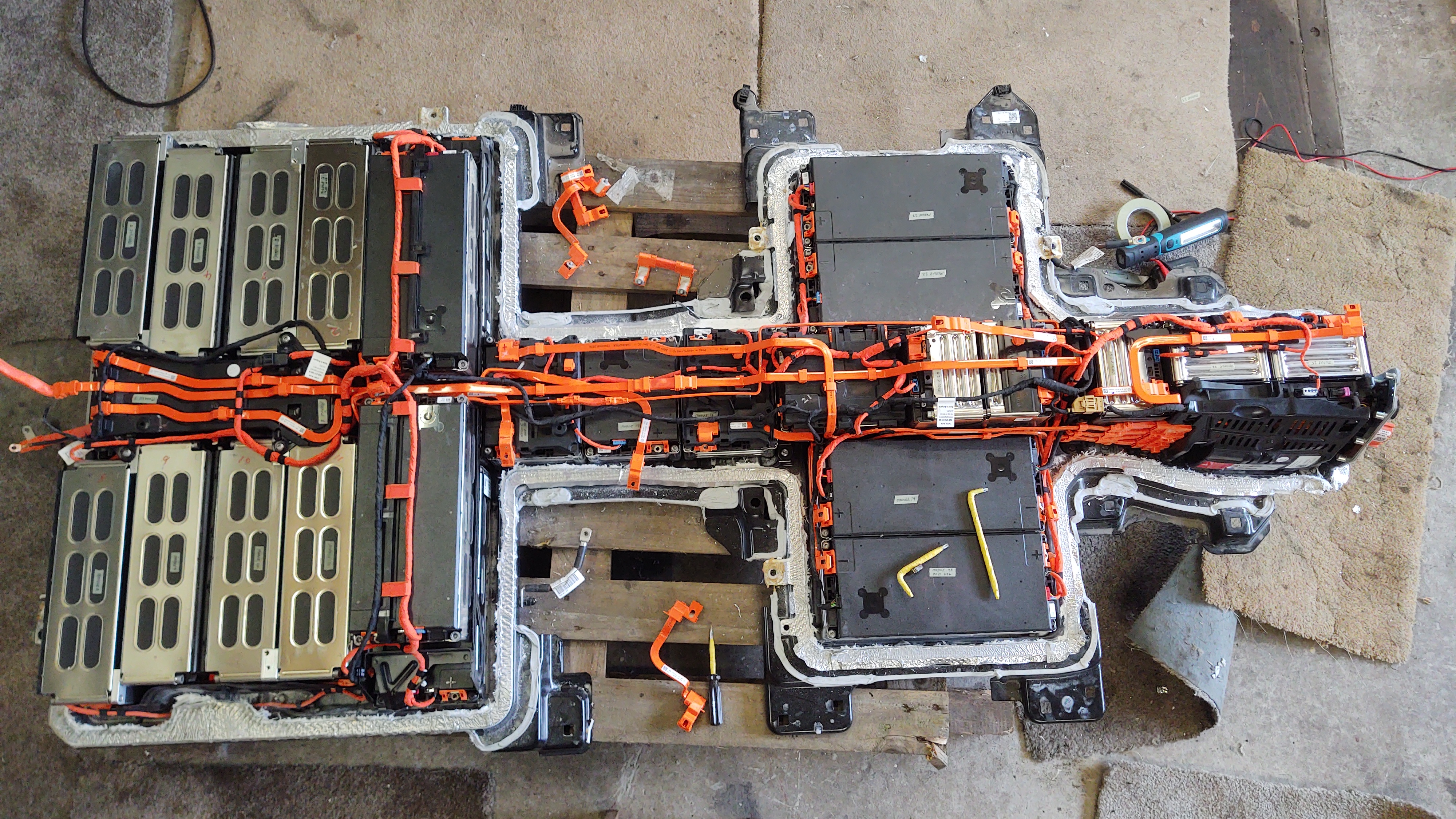

New photo's copied into the post above with (hopefully) the correct battery module layout.

Comparing my multimeter mayhem and your HV order.
My
From BMS Master,
black cable to module # and orange interconnect.
27, orange interconnect to 26-23
22, orange interconnect to 21-19
18, orange interconnect to 17-16
15, orange interconnect to 14-13
12, orange interconnect to 11-10
9, orange interconnect to 8-7
6, orange interconnect to 5-4
3, orange interconnect to 2-1
Alibro?

It will be a day or two before I can confirm this Janik. Life gets in the way and it will take many hours to label and dismantle the pack but when I can I'll get back.JaniK wrote: ↑Wed Apr 07, 2021 7:58 pm Comparing my multimeter mayhem and your HV order.
My:
From BMS Master,
22, orange interconnect to 26-23
18, orange interconnect to 26-23
15, orange interconnect to 26-23
Alibro?

I have now traced and figured out the black BMS wiring according to Alibro's picture of opened pack and my separate wiring on the floor.
I allready got SimpBMS wired up 7 months ago to it. But then I tested only 1 module group for verify that SimpBMS works with the Samsung modules. And didn't know the og HV wiring.. There will be more...
The orange one is easy because it actually consist of smaller harnesses that are used to connect the BMS slave modules to the next modules with the dummy BMS PCB. The orange wiring just makes the Cells in the modules connected together act as a group with the one that has the black BMS harness. (Didn't now that until I had measured all of the wiring with multimeter)
There are 5 different types of module groups in pack.
Total of 8 groups.
The flow of the CAN wiring trail in black harness is not the same as flow of HV current.
Flow of the input enable signal is, and it is a loop.
Maybe that will have something to do with balancing?
Ok next, draw a readable schematic?
Or maybe I send my notes to Alibro and after he double checks them later with the full pack we will share the info.
Total of 8 groups.

Hi all, I'm a bit late to the party... but I've taken apart quite some of the gen1 and gen2 e-golf batteries..
there is no need to cut the pack open! I only cut the tabs where bolts are, to get access to the glue.
with a 'long box cutter' style knife you can cut the glue and then pry the cover open a bit (some wooden blocks to keep tension on the glue) and cut the rest of the glue. 30-45 minutes maximum.
when removing gen2 cover I do cut a little bit of the front so the charge connector comes free easily.
wiring: just unwrap all orange wiring, they are 90% the same pinout but different length.
most 'master' modules (module with CMU) connect to 8s of other modules, some connect to less and have some special wiring to keep CMU working.
comms wiring is 'daisy chain style' but not really daisy chained (only the enable signal I believe)
contactor assembly I don't know much about, I just take them apart... they differ between the years btw.

Thanks for this,boekel wrote: ↑Tue Apr 13, 2021 5:32 pm Hi all, I'm a bit late to the party... but I've taken apart quite some of the gen1 and gen2 e-golf batteries..
Now I have the lid off and have tidied up a bit I realise you are right about using a sharp (short blade) knife to cut the pack open.
I have all the modules removed now so my next move is to reconnect it all on the bench.
