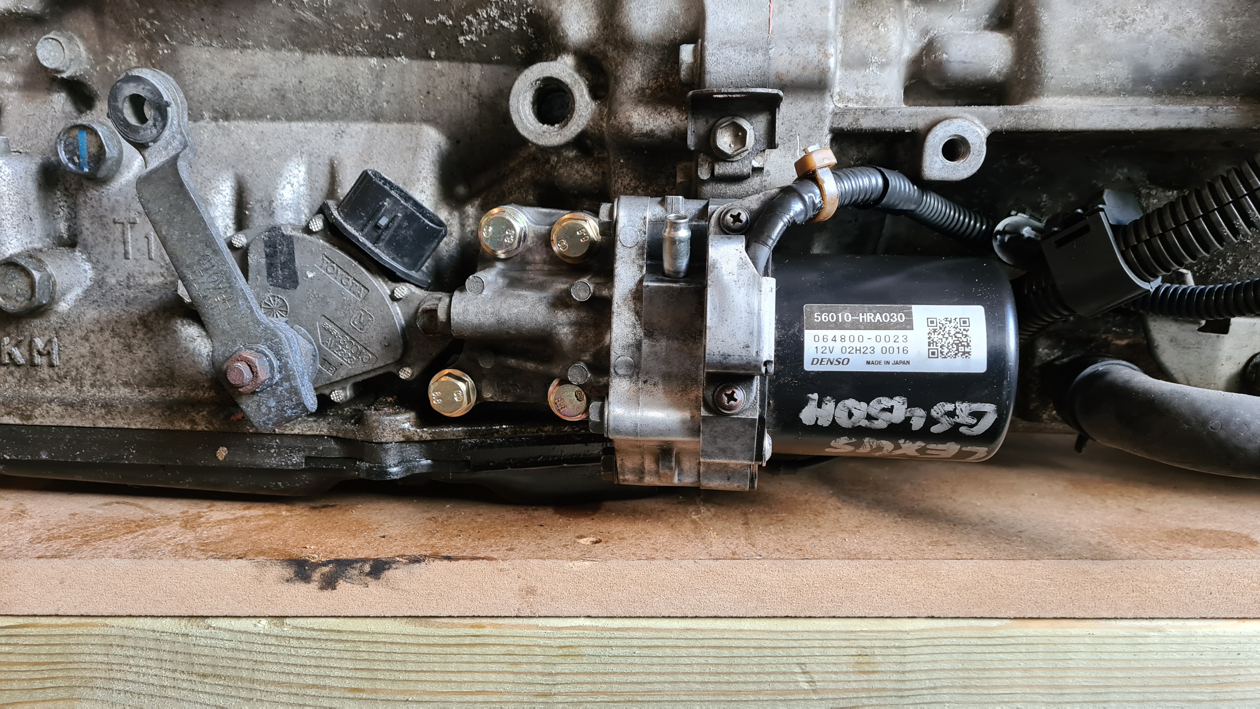

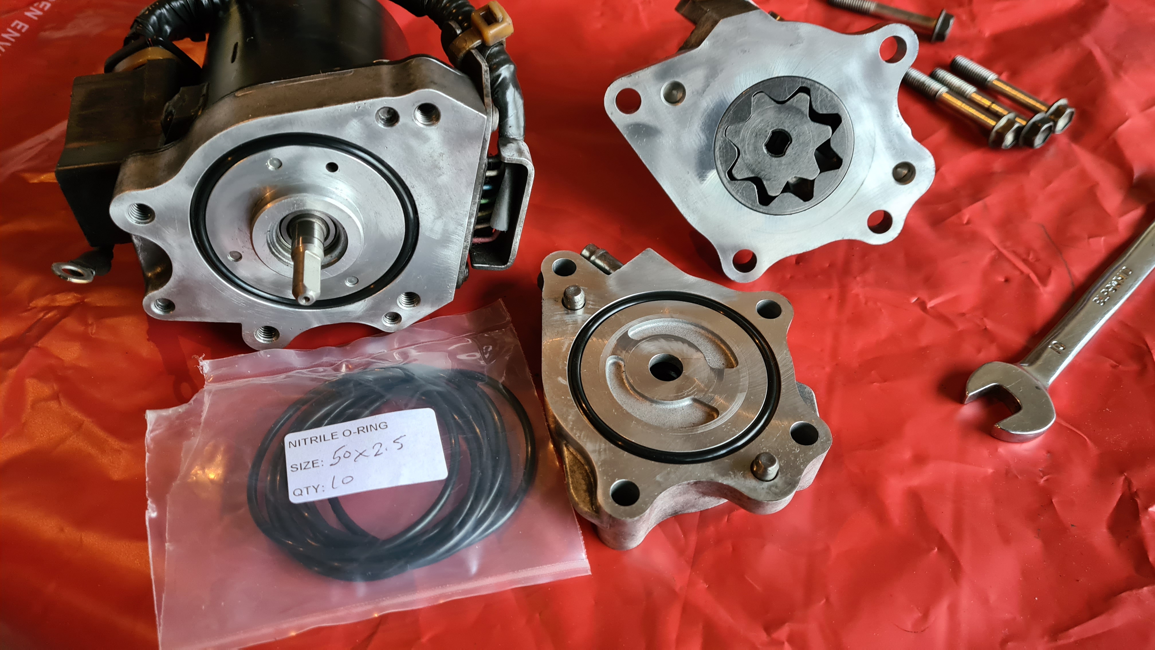

Bought some screws to replace the ones I accidentally stripped trying to disassemble the oil pump.
(new one on left, old one on the right)
Then whilst the oil pump was apart I cleaned up most of the rust (not sure why it was rusty, left in a junkyard in Romania for a few years perhaps)
Next I replaced the second bearing (on the rotor) which I believe to be 608-2Z.
I looked into making a puller plate like SciroccoEV suggested but sadly I just don't have the kit to make one. Instead tried to use flat screwdriver and lever against the rotor. It worked but time will tell whether I've done any damage!
Just need to replace the rubber O rings now (think it's a 55 mm internal diameter ring between the stator case and first plate, then two 50mm O rings between each of the other plates).

Anyone know where I could find out what bolts I need to reattach the oil pump to the GS450H transmission?
(I bought them separately and forgot to ask for the bolts. Top tip for anyone else using this Lexus GS450H transmission, buy all the parts together!)

Have replaced all the o rings in the oil pump as they were corroded.
For others who are refurbishing this oil pump (part no. 56010-HRA030) if you need new o-rings you'll need are:
1 x 55mm int. diameter, 2.5mm cross section (For the black outer case).
2 x 50mm int. diameter, 2.5mm cross section (For between the two "layers")

Also, in case it's useful to anyone...
The replacement screws I bought (see above) work great, replacing the screws I accidentally stripped...

slanceley wrote: Sat Jan 30, 2021 12:31 pm Anyone know where I could find out what bolts I need to reattach the oil pump to the GS450H transmission?
I just used these, M8x30mm I think. Just sense check the depth of the threaded hole in the gearbox case.

I measured the depth required and it's about 35mm.
xp677 and ggeter in another thread confirmed the bolts as M8 35mm long, with thread of 30mm, 1.25mm pitch. Ordered some, arriving next week!

M8 35mm bolts arrived so I've fitted the refurbished oil pump.
(Next job is to test the pump runs ok before I continue.)

I'm having trouble understanding the wiring for the GS450H transmission oil pump that's on the wiki.
Could anyone tell me how to test that my oil pump is still working.
I'm assuming it's 12v applied... but don't know where to hook up the + and - wires....
Can anyone help?
Re: Reliant Scimitar SE5 (1971) with Lexus transmission
Posted: Wed Feb 10, 2021 7:40 pm
by slanceley
Never mind! Electric_SLK explained it all to me!
Seems obvious now: the oil pump motor is three phase, hence the three pins in the white connector! I need the oil pump controller (and he suggested that the controller needs to share the same ground as the 12V supply). Next stop, ebay and some lexus breakers yards!

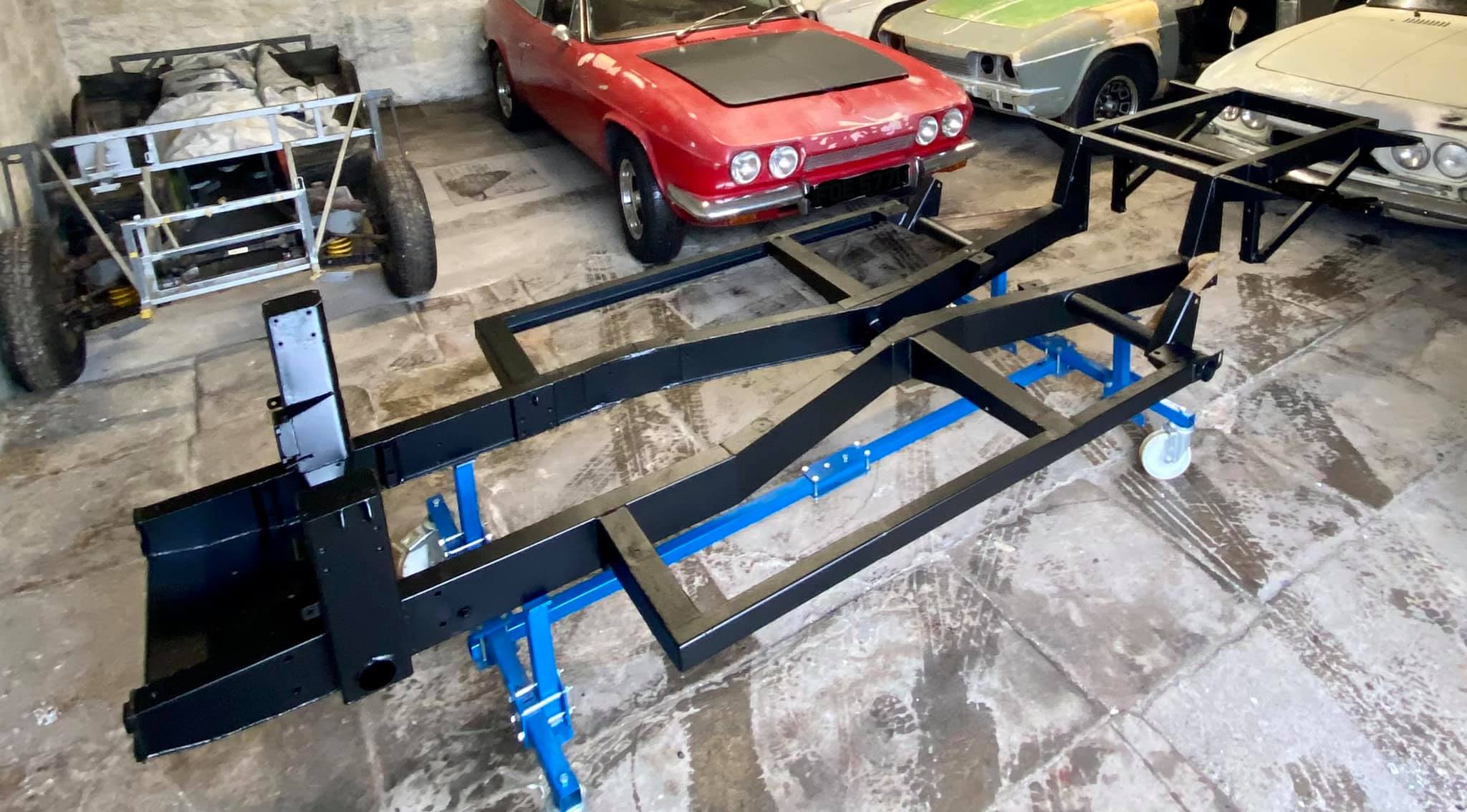

Anyway, today I found a good deal on a really well refurbished chassis for the Scimitar, so once lockdown has eased I'll arrange the collection. (The parts of my current chassis are either rust or have long ago crumbled away to nothing, so it was well worth the investment)

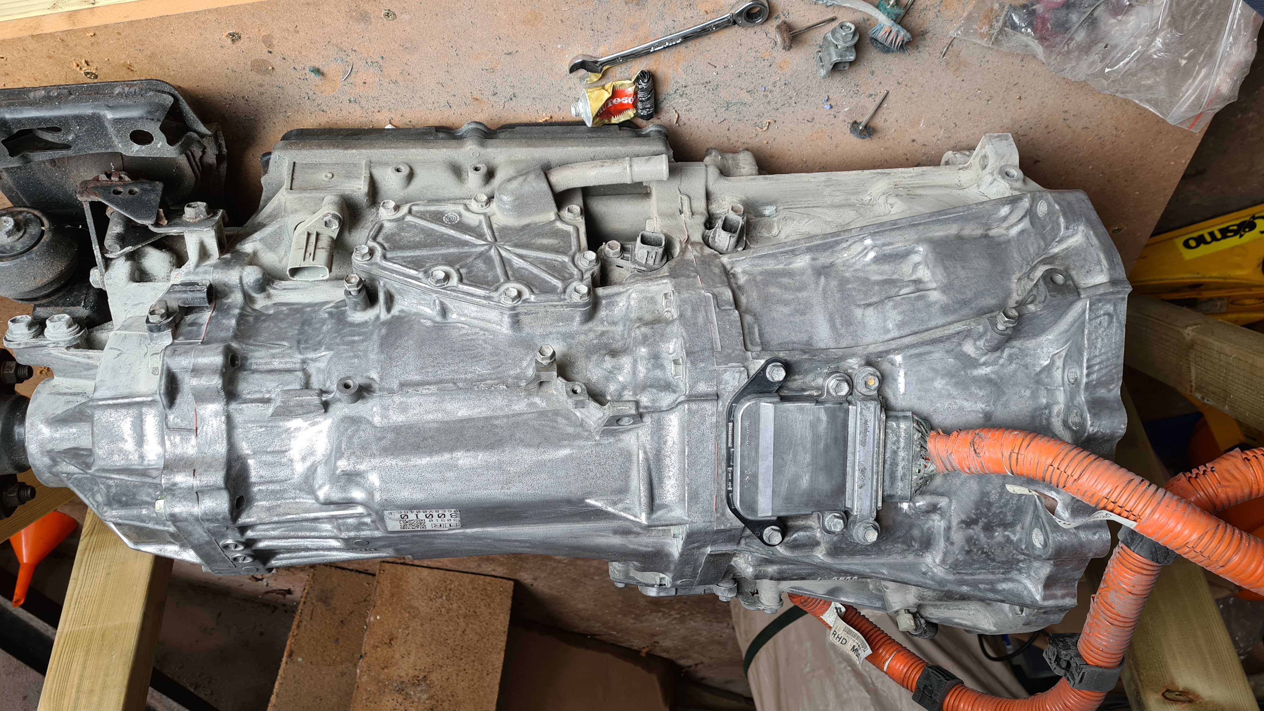

The Lexus transmission had a lot of oxidisation on it so I decided to clean it up with lots of Autosol and my Dremel before it's mounted in the car.
(Broke the Dremel somehow and took it apart to see if I could fix it but I think it was a broken wire right inside the windings so I gave in and bought a new one).
Probably totally unnecessary but quite therapeutic!

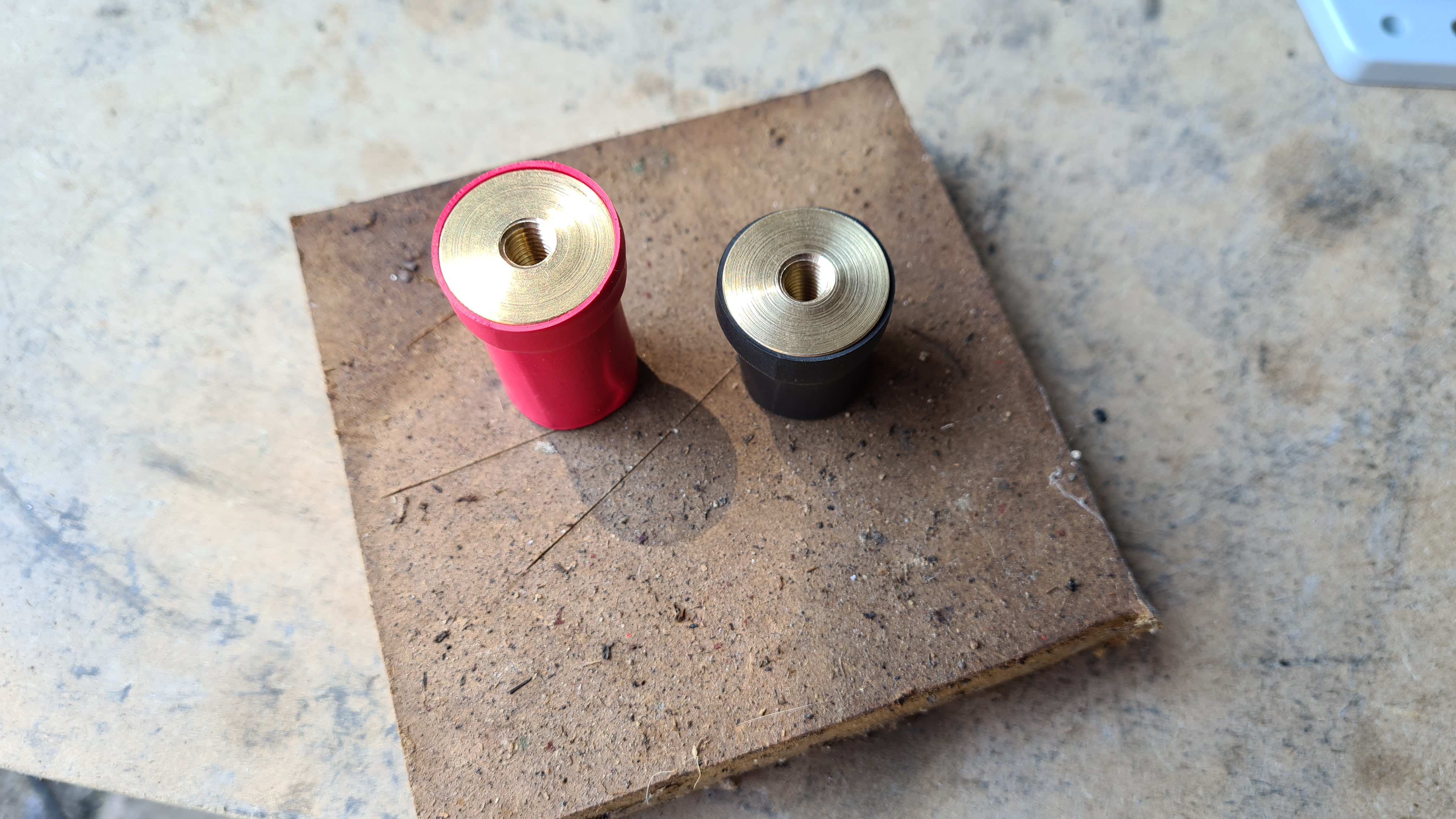

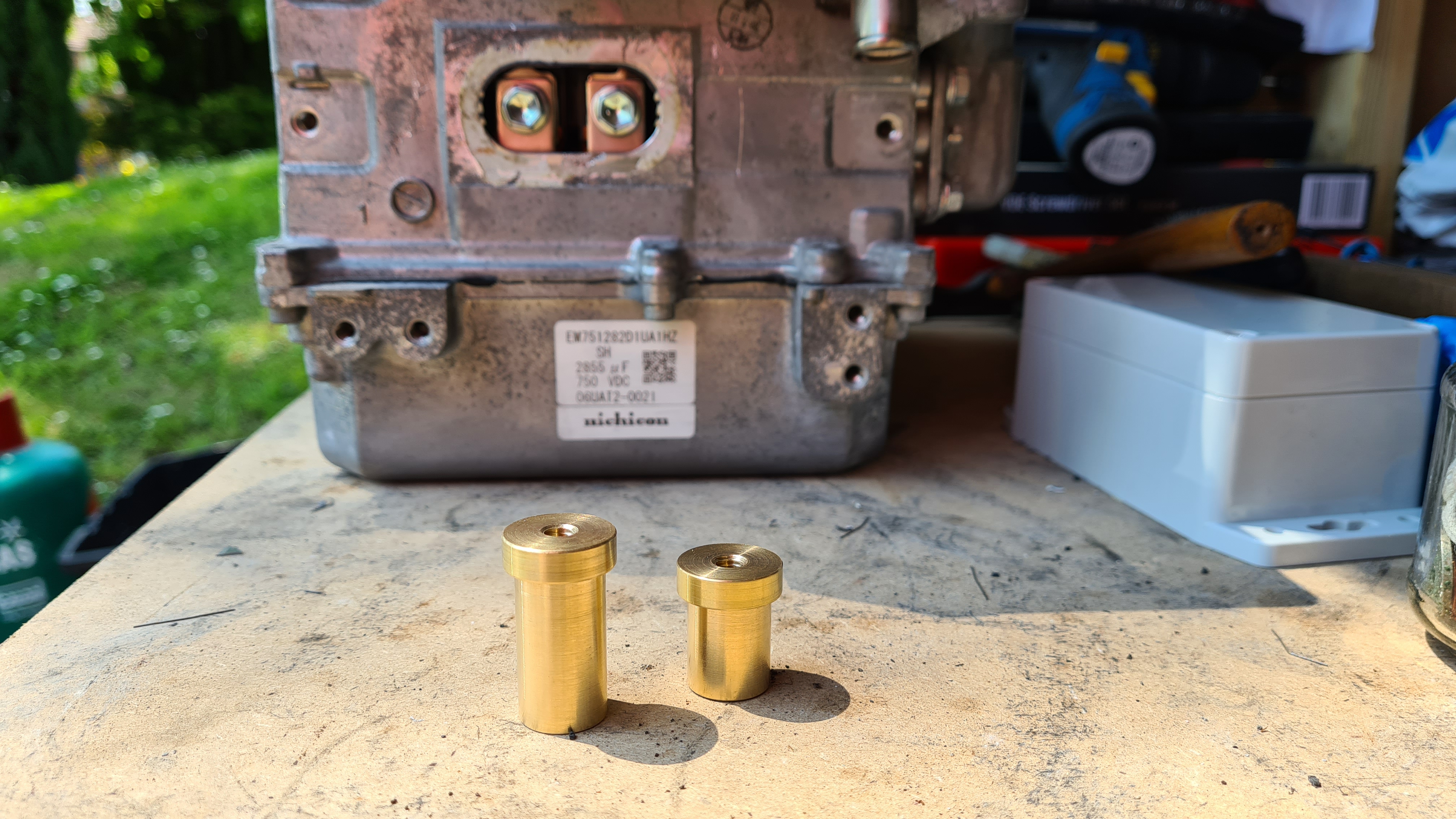

Made a mess of opening up the buck/boost converter part of the inverter, to allow access to HV terminals, but it'll do...
Then spoke to some of the other guys from the New Electric conversion course and took their advice on how to create HV terminal stand-offs for my Lexus GS450H inverter, and added in some of Damien Maguires terminal design features too.

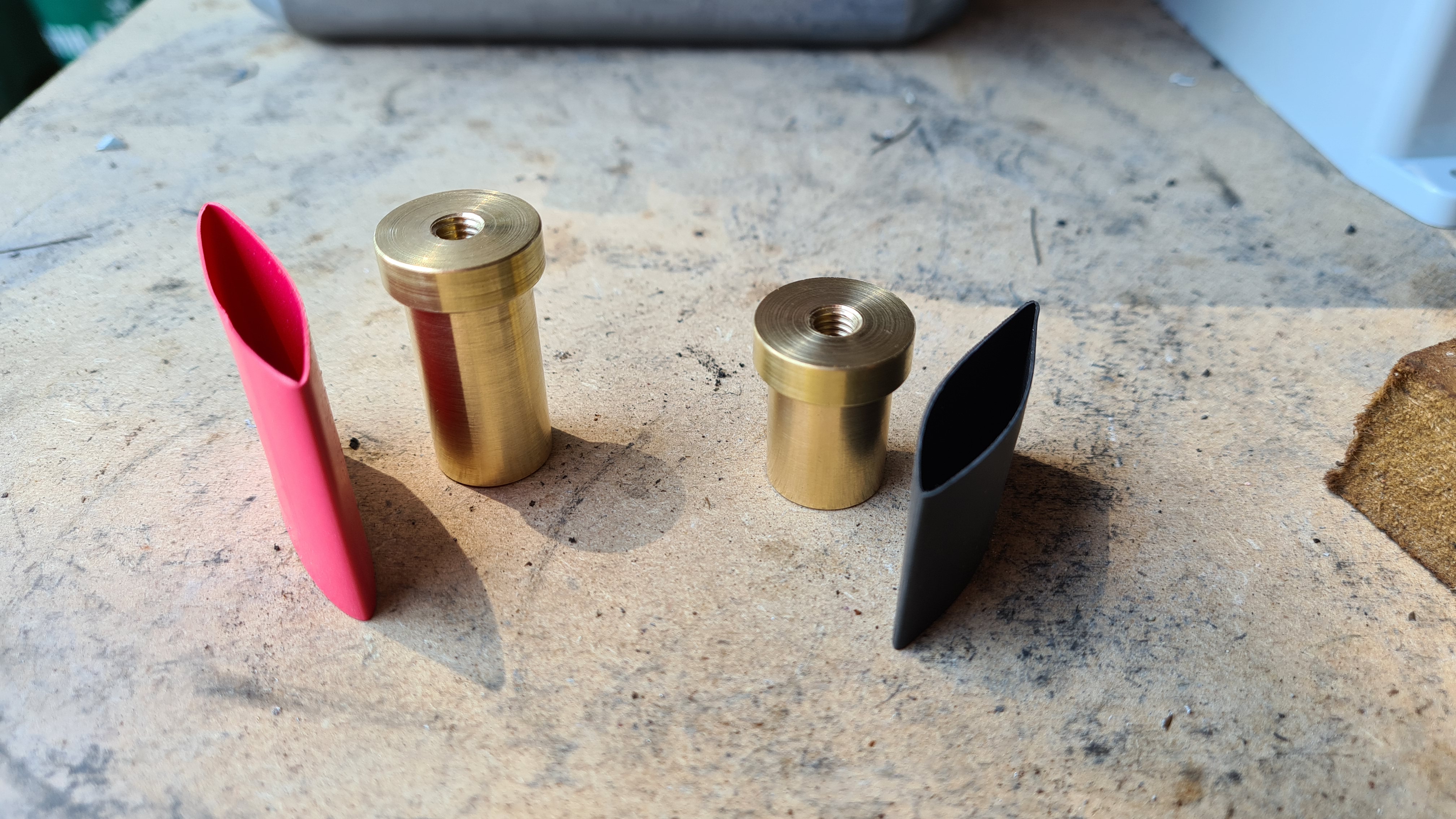

Then found this guy on eBay who made me a pair of brass terminals for £23...
https://www.ebay.co.uk/itm/324625667283
They are M6 threaded brass standoffs, one 25mm long as per the picture and the other is 35mm long.
(I'm assuming the different lengths of Damien's design is a safety feature in case either terminal becomes loose and spins to create a short)
I've used some 25mm heat shrink (red/black) for safety and identification...
Tried to find nickel-plated brass M6 bolts but the best I could find was 200 of them for £70! Was suggested to me that nickel plated brass would improve conductivity, but I can't justify the expense really, so I've ordered some brass ones instead. Hope they'll do the job)

Bolt is for compression, not conduction. Plated steel, or stainless (A4 grade) will do.
