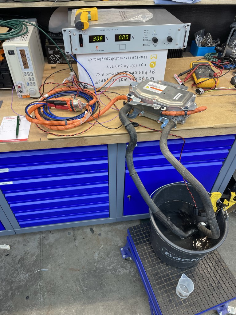

My voltage is 370Vdc. I am using Chevy Volt gen2 battery 96S.
It should work there since every component from Outlander PHEV worked up to 400Vdc, tested!

Received mine yesterday and immediately tried some things;
- 0x398 byte0 goes 00->01 as soon as 0x285h is received.
- 0x398 byte4 seems to be inlet temperature
- 0x398 byte5 seems to be outlet temperature
- 0x398 byte7 h70 when HV is <175Vdc, h00 when HV >175Vdc. So 175V seems to be the low-voltage limit.
With a lot of fuzzing, replaying of Outlander logs without water heater and combinations of both, nothing else then above appeared.
I also had watercirculation applied so we can exclude there is some kind of an internal flow detection that blocks operation.
@arber, in what case did you get 0x398 byte0 at '02' ?
I think we are really in need of an outlander-logfile that is equipped with the electric heater.

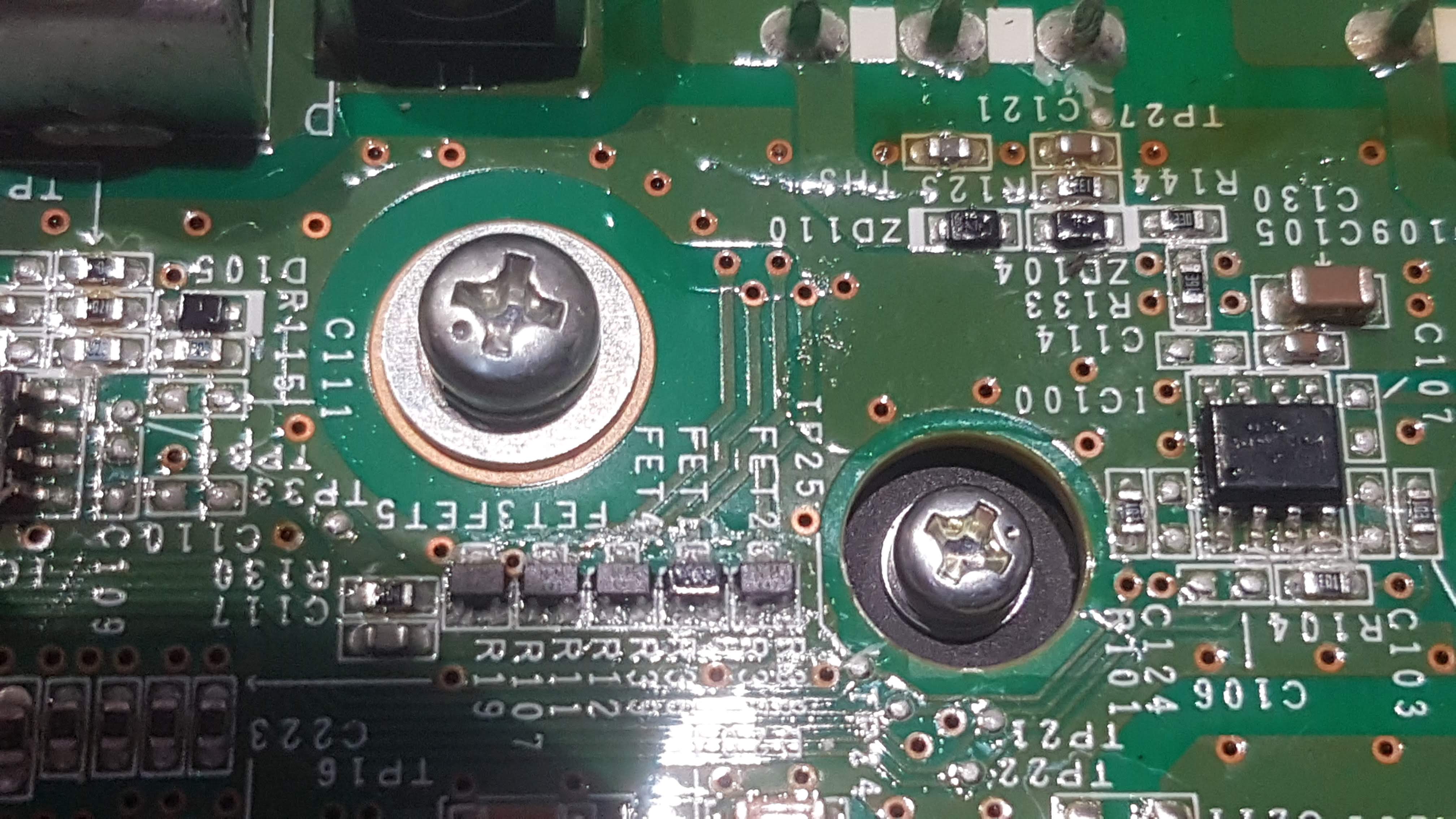

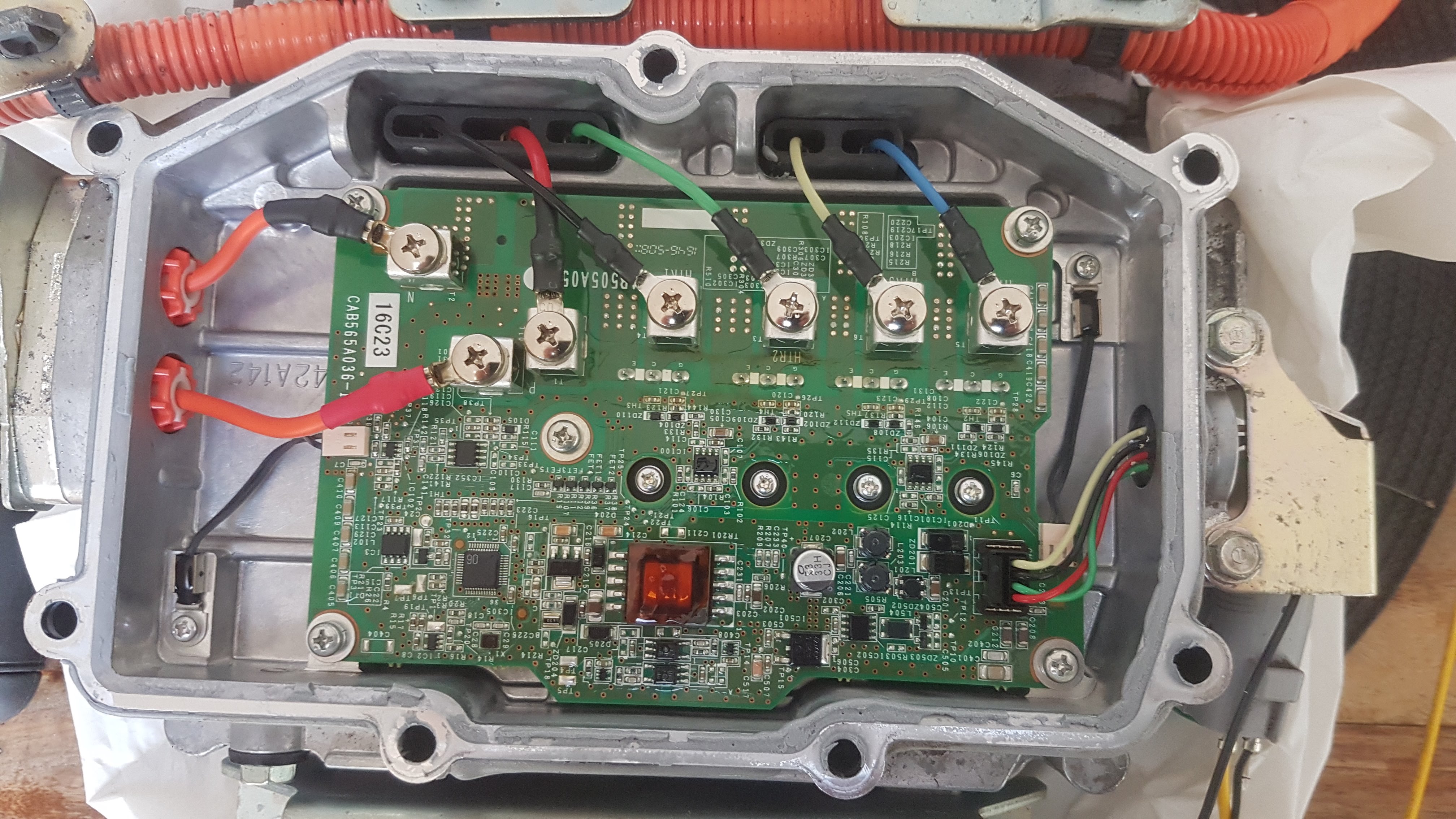

There's also the nuclear option. FET2 -> HTR1 Gate
FET1 -> HTR2 Gate
FET3 -> HTR4 Gate
FET4 -> HTR3 Gate
The can transceiver is a NXP TJA1049, its RX and TX pins are connected to the opto closes to the edge of the board.

I'm thinking, as it still puts the temperatures on the can bus, hard wiring a couple of the heaters so they're always on, and using a contactor externally as a work around for now.

What about the FET lines? How are they activated, High or low logic? I would assume they are normally pulled high and gate needs to be pulled low to open the FET. My DUE board could work with that. I use UL2003A and there are 5 pins left unused. No need for another contactor, only main contactor needed. You have a better photo what is behind those FETs? One could remove those fets and use wires directly....Bigpie wrote: ↑Fri Nov 05, 2021 12:19 pm The attached log isn't of usedon't think we're going to get a log from this guy that's of use, his car is a 2014 with the older heater that isn't can controlled. Fuzzing is a bust so far.
EDIT: Or we could make a circuit board which would connect to OEM brain and put it in reset. Then we could use another chip to hijack its CAN connection and output pins to a CAN to our desire. A PIC18F with CAN would be sufficient i think...

You mean a photo of the underside of the board?

Re: Mitsubishi Outlander PHEV heater
The little FETs and Gates they are connected to for the PTC heaters are 0v when off with the looks of it.
