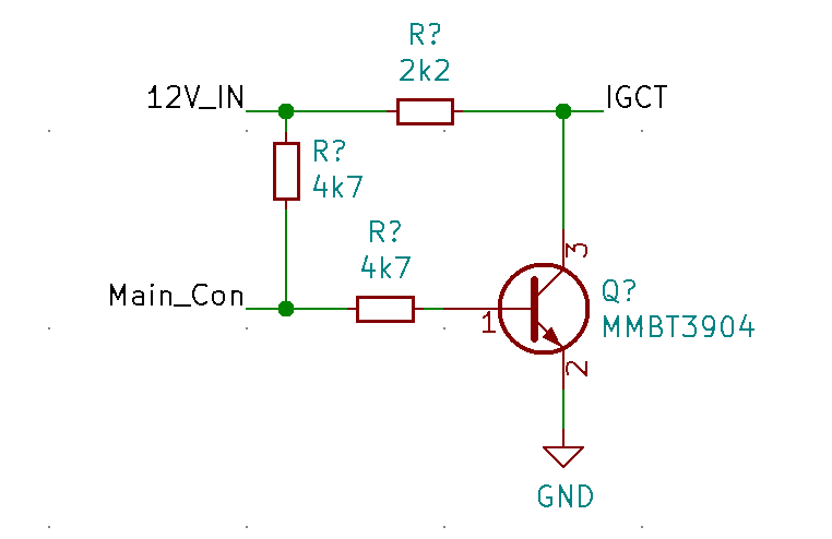

Thanks! Great! I will then look into what HW is needed to use precharger as DC/DC enable and PB9 for PWM generation control signal.
Been thanked: 1918 times
Re: DC/DC converter in Auris/Yaris and Prius Gen3 inverter
Tested the precharge idea, works :) I'm pulling up IGCT with a 2W 680 Ohm resistor and letting the precharge relay driver pull it low. As soon as start signal is issued the DC/DC converter starts.
Also instructing the boot loader to engage precharge, as in my case precharge is on as soon as I switch the car on. That would lead to the DC/DC converter briefly switching on at startup and also during software update. Maybe not good for the precharge resistor.

Elegant solution with very little added components but the drawback of having no control in certain situations makes me want to add some more components.
Maybe better using main contactor output and 180jacob:s idea, but that will increase the BOM with one p-fet. I would also use LBSS84LT1G instead as it has higher Vgs voltage (20V), but not in stock at jlcpcb...
viewtopic.php?p=19902#p19902
Or maybe like this, no new parts but haven't figured out the time delay part yet...
