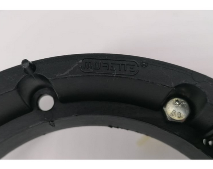

Fair enough. I have 5.75 nch headlamps using morette rings which are spring loaded and adjustable with wingscrews from the rear inside the engine compartment.

manifold wrote: Wed Nov 05, 2025 7:44 am Fair enough. I have 5.75 nch headlamps using morette rings which are spring loaded and adjustable with wingscrews from the rear inside the engine compartment.
Interesting. I probably could drill out the captive nuts on my mounting rings and weld bolts on the front then have a similar arrangement with nuts on the back. Worth thinking about.

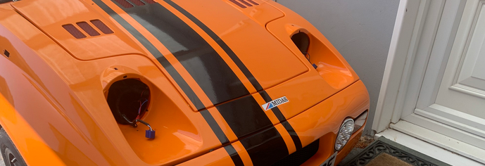

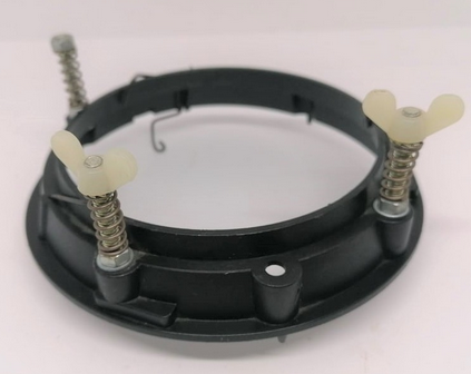

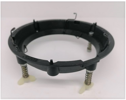

They are quite handy because it will reduce the need to take the lamp covers off every time you need to adjust the lights. Eg for an MOT.
Heres a few images of them to give you an idea of what they look like to fabricate.
The spring presses against the back of the headlamp pod housing/moulding with a hole drilled through it for each bolt. - the wing nut and a spring locking washer is on the other side (engine bay side).
You can see on the orange car the little holes drilled out for the adjusters in the headlamp housing area. I hope that helps give a picture of the idea.
