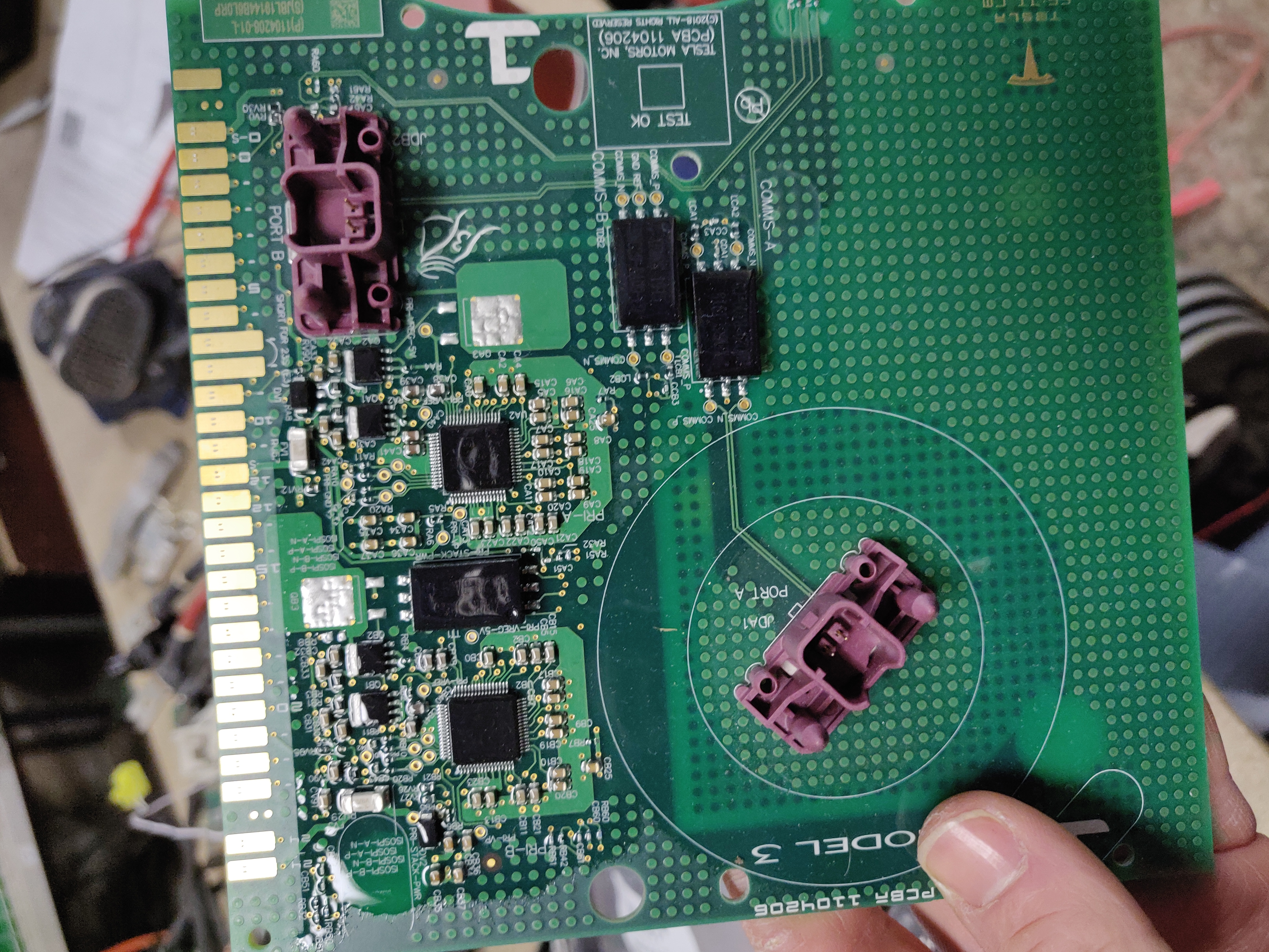

Nice work! You mention intent to add in other BMS functionality to the board.. Would it still work in conjunction with SimpBMS as mentioned before, or be standalone, or work with Arduino?
- Posts: 4000
- Been thanked: 1114 times
Re: Tesla Model 3 Battery Hacking

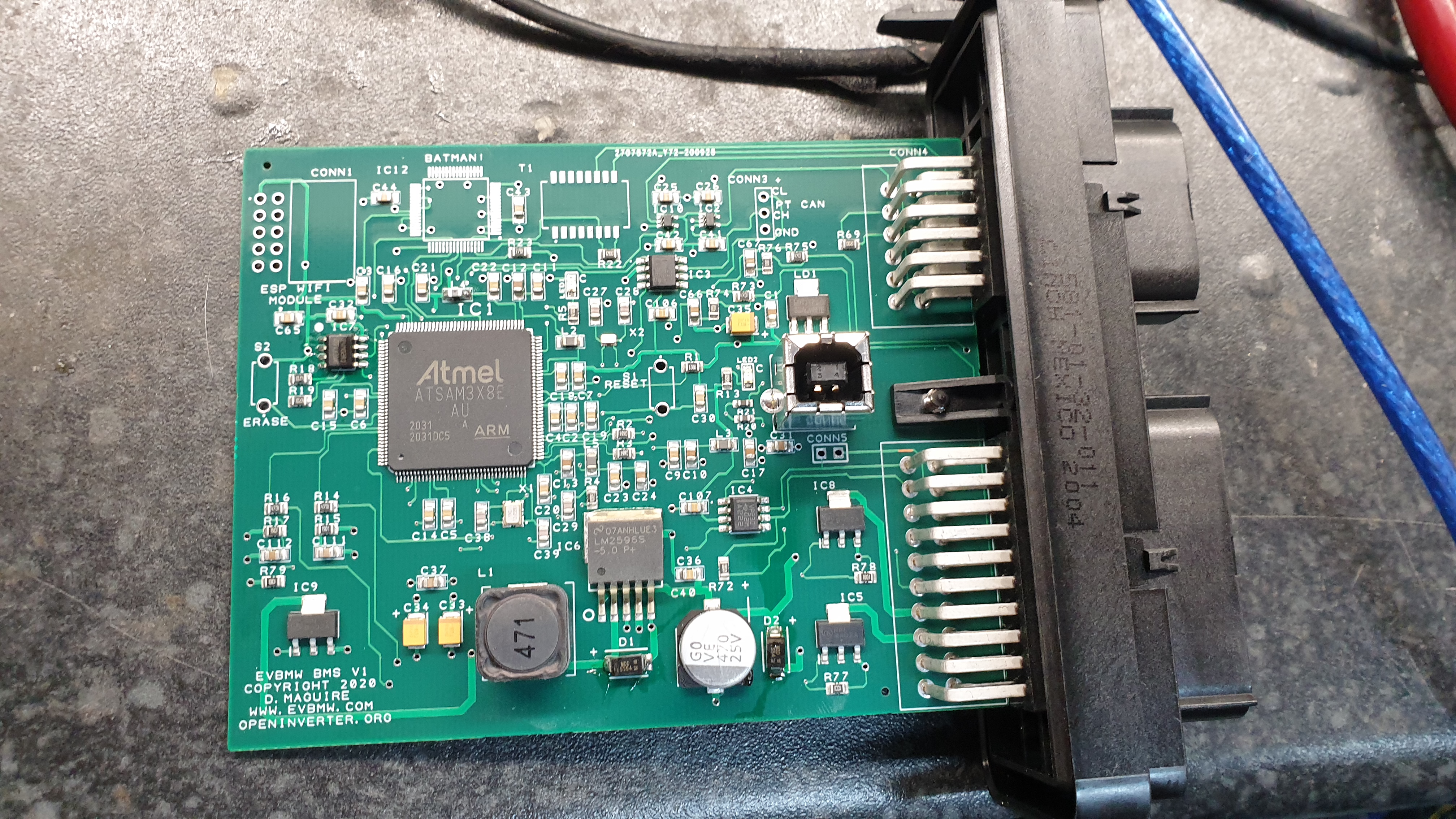

As of now its a simple interface between the Tesla form of ISO-SPI and normal 3v3 level spi. You decide what/how to communicate.
- Posts: 4000
In the hopes of encouraging colaboration and furthering the effort, I have released the full sources for an FPGA based Model 3 Iso-Spi decoder. At this time it works in receive only and does have some glitches. FPGA used is a Xilinx Spartan 6 at 50MHz. Design done using Xilinx ISE.
To Do : Clean up receive and implement transmit and debug.
I would think it needs to go to 100MHz to work more stably but thats probaly due to my crappy Verilog:)
https://github.com/damienmaguire/Tesla- ... attery-BMS
To tide things over and provide a "today" solution, the prototypes of a Batman based controller have arrived for testing.
