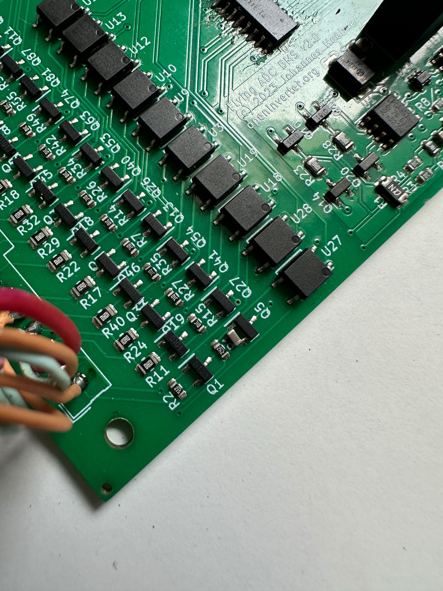

i ll be soldering my 6x17 caps today. and fix so muxshort fets.
the caps fit nicely between the fets legs. so that would make it easier to solder

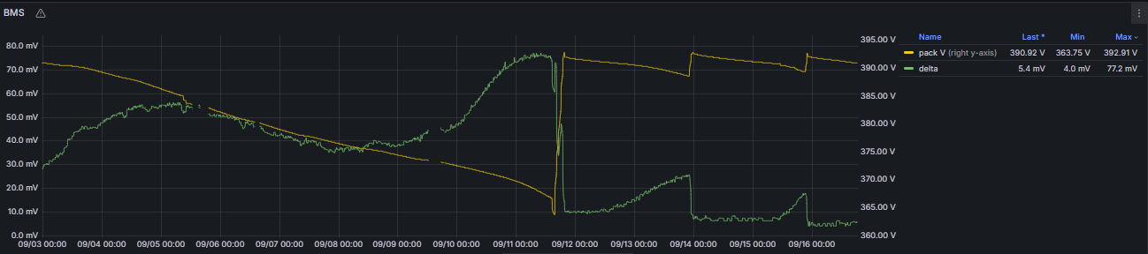

I did capacitor patch on all boards and uploaded newest firmware on August 28th. First I powered BMSes without battery and it was ok.
Then I powered up with battery connected and all worked like a charm. Balancing about 1 mV per day.
On September 2nd I decided to test what power Prius inverter will handle and fried it (have a record of 894 A for 10 ms from the battery with ISA shunt) and welded main contactor also. :) Was driving it on 140+ kW from the battery few days before that.
That resulted with car stationary until I sourced replacement inverter and, because I noticed that smallest delta is when cells are above 3900 mV I kept battery in that range.
Result is that yesterday all cells were under 5 mV delta. All great. In the mean time I got replacement inverter and contactors and today I decided to replace contactor and inverter and disconnected battery. That means turning BMSes off because they are powered from the HV battery via Meanwell DC/DC.
After replacing inverter and contactor I powered BMSes up and forth BMS in the line id: 13 reported muxshort, errinfo 988. When I reported muxshort few months ago, it was other board but also on the id: 13 and I was thinking it is because of my dodgy work on that board and replaced it with new one. Now, that new board is also reporting muxshort.
If it matters, I'm powering boards by applying 12V and then enable signal. Enable is always live.
First power up 8/28 was with battery about 375V and today it's 390V+.
I know that I need to go and replace broken FETs but, do you have any idea why this happened on the same id (13) twice and with different boards?

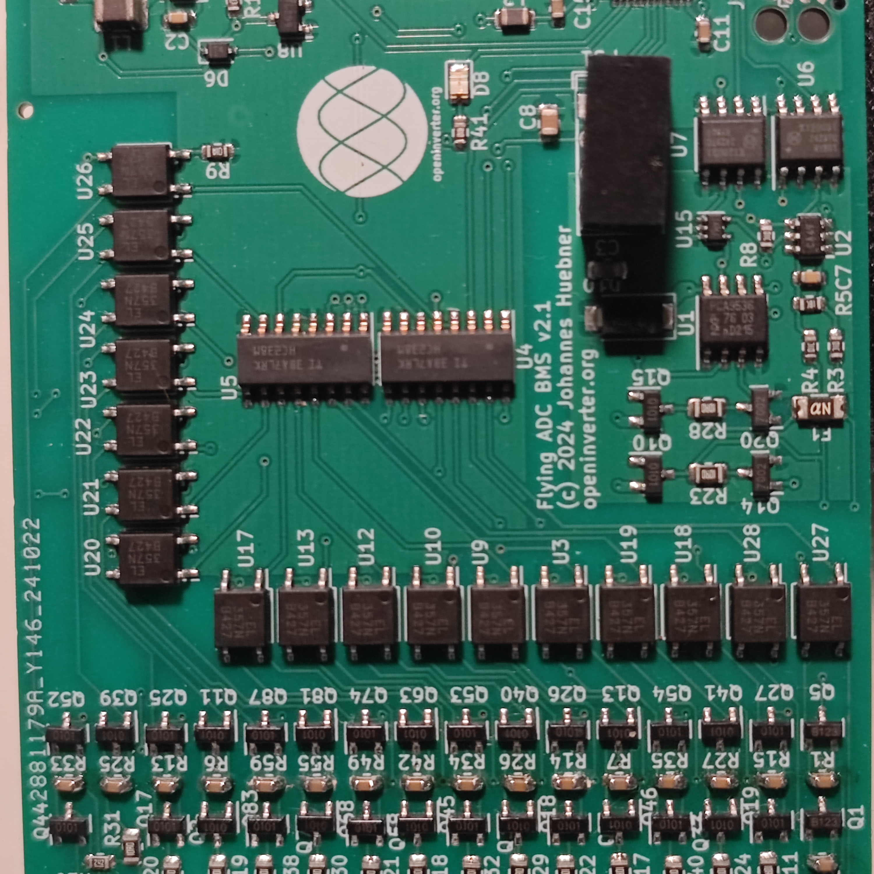

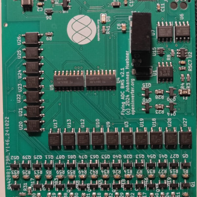

@johu I tracked it down to Q5 being defective and replaced it.
All the other components look fine, and I’ll connect the BMS back to the battery.
Do you have any recommendations to avoid stressing or burning components on startup?
Would it make sense to disable balancing before power-up, or is there a better approach?
