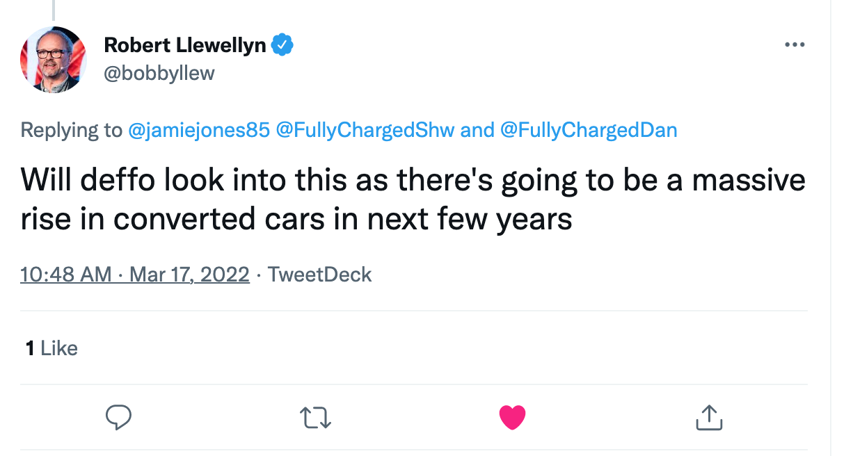

Got Fully Charged interested
Can people send their info to production@fullycharged.show regarding this issue.

I spoke to Robert about a year ago and although sounding interested at the time, when I actually sent him the details, got no reply until I repeatedly chased it and then a reply from someone else that they were too busy to do anything about it, but we had their moral support.Bigpie wrote: ↑Thu Mar 17, 2022 10:51 am Screenshot 2022-03-17 at 10.49.50 am.png
Not the outcome I was hoping for.

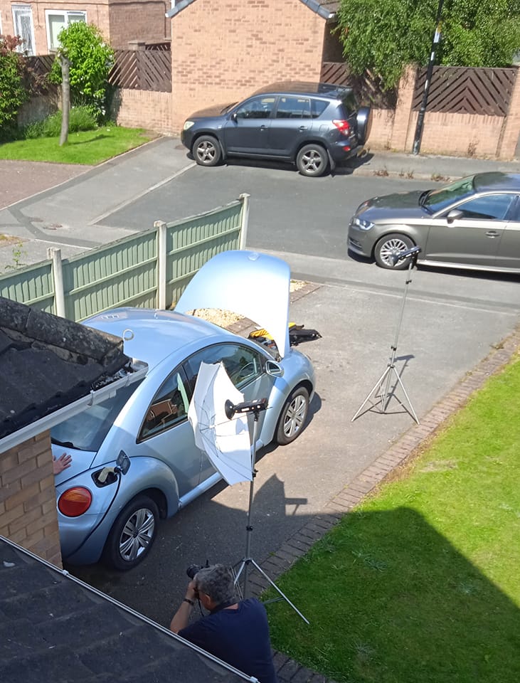

The Telegraph are covering the issue over the Jubilee weekend. I've had them round taking photos etc.
