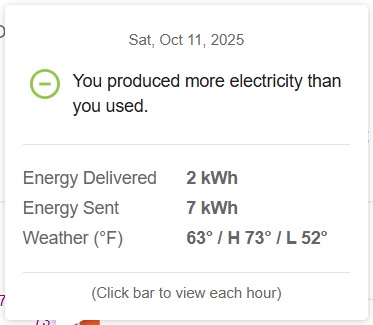

Posted: Thu Oct 16, 2025 4:18 pm
by Gregski
I just love days like this:
(did I mention I have three electric vehicles)
