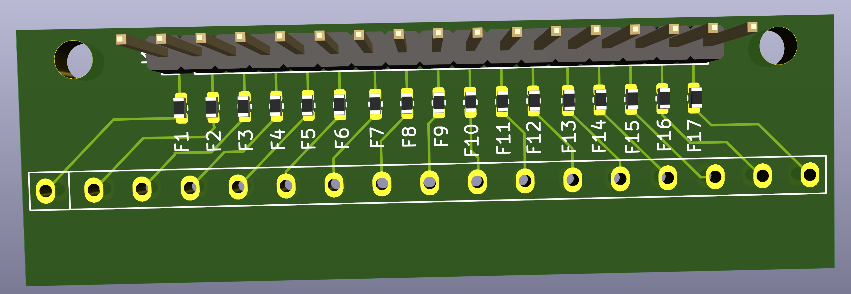

Here is the kicad source + production files for a tiny adapter board to fit at the end of your BMS design to accomodate a 17 pin phoenix pluggable terminal + has 0603 footprints for extra inline fuses or 0R. Maybe someone finds it useful. Edited to update borked silkscreen order
battery-fuse-adapter.zip
(413.72 KiB) Downloaded 173 times

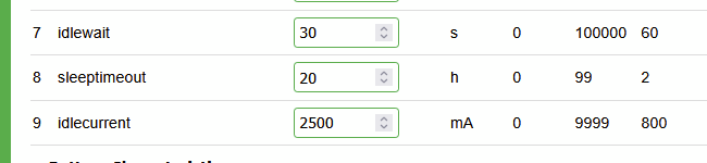

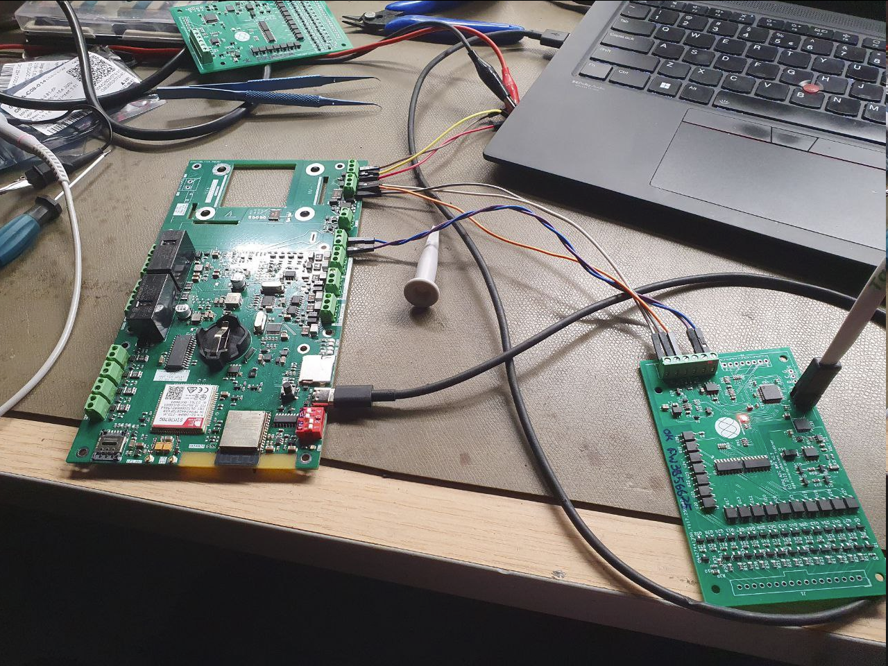

I finally got some time to hand assemble some bootleg copies for my scooter. Flashed both bootloader and fw ok, now slowly vibe coding fw for controller. My previous assumption of having uninterrupted 12V source on the scooter turned out to be wrong, so HV-12V dcdc will have to be added, no biggie, I already had provisions in place, but not sure what Iq will be on a relatively small battery which may see sporadic use.
The pins GND and 12V must be connected to a permanent 12V source in order to ensure correct operation. In other words, don't connect 12V for example to your cars ignition 12V that is interrupted whenever you stop the car.
Which lead me to wonder- what would the outcome be if 12V gets interrupted? Can the mux end up in a weird state and bork the cells? I must admit I have not carefully studied the schematic to probably come up with an answer myself.

skr wrote: Sun May 04, 2025 6:32 pm Which lead me to wonder- what would the outcome be if 12V gets interrupted?
Yeah this needs clarifying. The BMS uses the STM32 NVRAM to store some long term process values, most importantly SoH. If you don't care about the latter you might as well interrupt the supply completely.

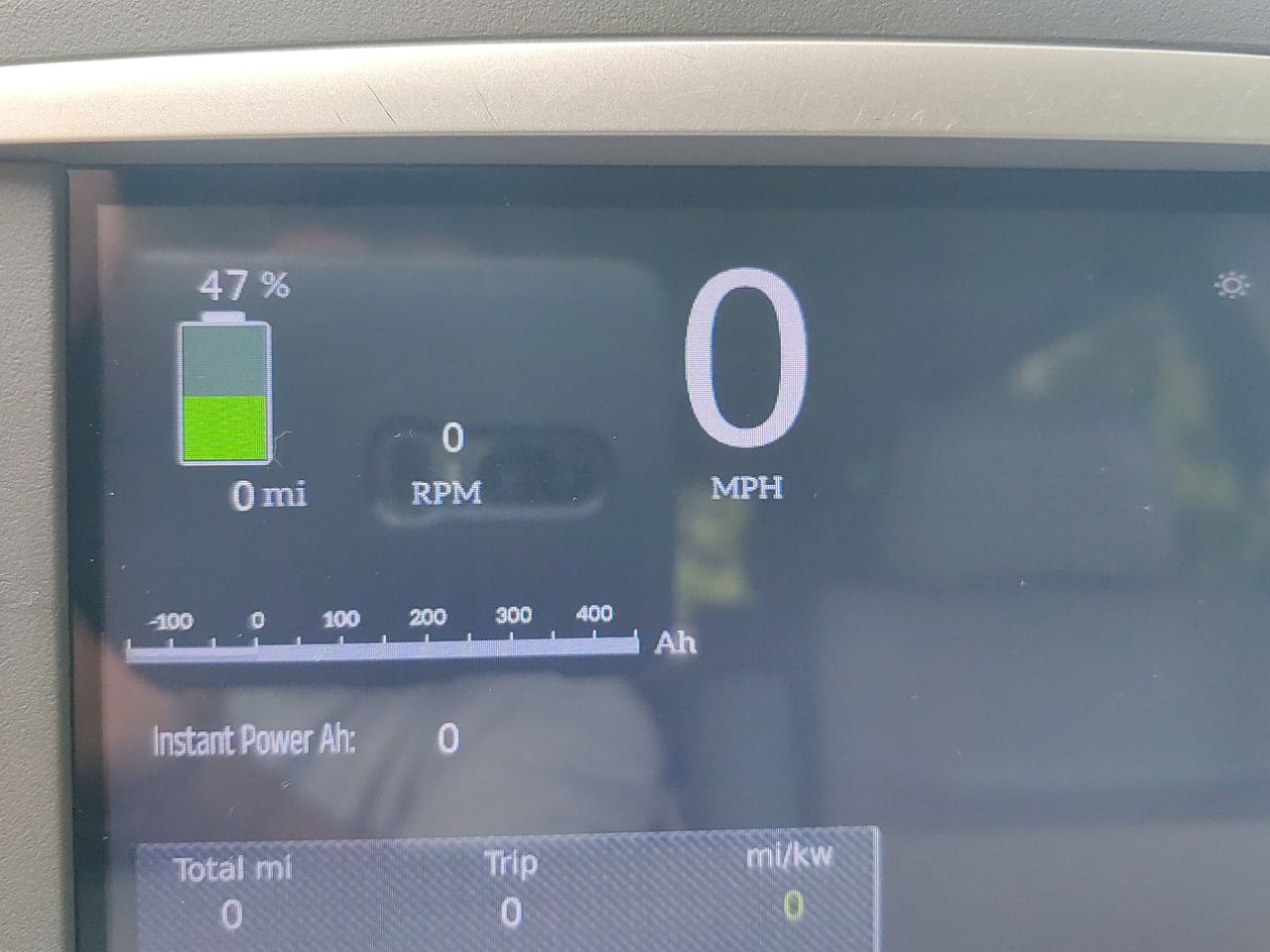

@ johu, can I use the BMS to get the state of charge of the battery and bypass the ISA shunt?
Been thanked: 1913 times
Re: Switched ADC BMS
Yes that is the plan. Right now you'd need to connect a separate analog current sensor to the first board but I do plan to make this CAN mappable

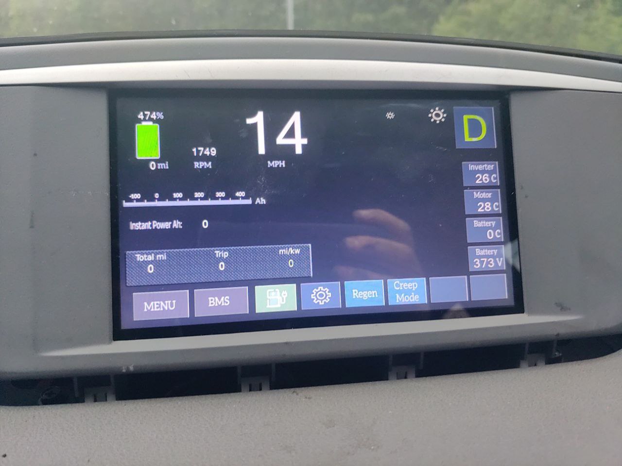

@johu
On previous version for BMS I was getting 2 digits for SOC. now with the new boards I am getting 3 digits. is that something you changed on the latest code? 0.26R
474 I am guessing is 47.4%?

Proton wrote: Fri Jun 27, 2025 2:46 pm On previous version for BMS I was getting 2 digits for SOC. now with the new boards I am getting 3 digits. is that something you changed on the latest code? 0.26R
Yeah that was a sort of recent change to show more resolution.

johu wrote: Fri Jun 27, 2025 5:57 pm Yeah that was a sort of recent change to show more resolution.
Can I downgrade the v2.4 BMS version or that is not recommended? Even if I can make it show 47.4% it would not look good on the screen and is not needed.
Proton wrote: Fri Jun 27, 2025 6:06 pm Can I downgrade the v2.4 BMS version or that is not recommended? Even if I can make it show 47.4% it would not look good on the screen and is not needed.
No way, pre-0.26 has to little dead time and will fry the FETs for sure. You can add a new custom mapping for SoC or change your display software to divide by 10

Post by Proton »

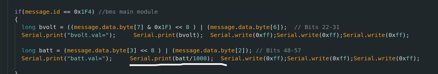

johu wrote: Fri Jun 27, 2025 6:22 pm No way, pre-0.26 has to little dead time and will fry the FETs for sure. You can add a new custom mapping for SoC or change your display software to divide by 10
I tried divided by 10. maybe I need to divide by 100 just in case you are sending 4 digits.
Just delete and recreate the mapping or do I need to do anything special to display 2 digits?

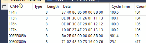

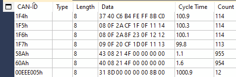

johu wrote: Fri Jun 27, 2025 5:57 pm One thing I noticed with the Sungrow is that it doesn't really like the additional "internal" BMS CAN traffic. It doesn't fault out and it does sort of work but drops power from time to time. I've tried higher CAN ids but that didn't help. Maybe a slower cycle time would help. Will play with that.
Was it with Web tool connected or not?
Here is approx 10s without web tool:
Here with web tool:
With web tool it gets a bit more spammy on the bus.
I did try rate limiting the bms messages down to 1 second updates and it wasn't bad.
For ESS you would probably also want to send cell voltages (either 3 messages packing all cells or just delta update on any changes), now the esp web tool reinits the driver on node switch to interrogate each bms in an inefficient manner, packing cell data in a, say 1s PDO update rate cycle would probably be cool, as everyone wants graphs and whatnot.

Post by Proton »
I divided by 1000 and it works. I tried before 10 and 100 but I had to add another 0.
