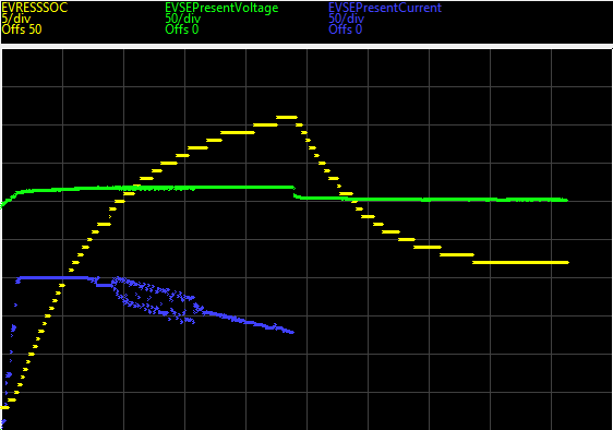

Logs from today. I added the user's perspective descriptions of what happened during each.
This was an awful experience. It's a charger with a big super unresponsive touchscreen and unclear instructions for how to use it. I think it couldn't even get to the precharge stage, not sure if it was trying or not. I don't think it detected the car at all?
EDIT: No PLC comms seen in log.
Worked nicely.
Worked nicely, EXCEPT that when I started my charging session, it stopped the charging session of the car that was already charging on the other plug. When a new session was started for the other car, mine stopped charging. Super weird.
Didn't work. The UI seemed to indicate it was trying to establish comms. I also tested Chademo which worked fine.
Didn't work. It gave the classic cryptic ABB "waiting for the grid to return" error message. (not the exact wording, translated from Finnish) Also looking at the logs it somehow semi-permanently confused my session management and logging system into repeatedly launching pyPLC (this is supposed to be based on the PP line - weird). I also tested Chademo which worked fine.
Worked nicely. Car was pulling 250A for a long time. Current was varyingly limited by other cars sharing the capacity and finally by my battery getting full.
This was a Tesla v2 supercharger. Seemed to work nicely, except that the charger only charged for some seconds before ending the session. This could be repeated with no apparent differences. I also did a third session on a different stall requesting only 100A but that didn't change the behavior.
EDIT: Looks like Tesla has figured out the most efficient and non-disagreeable way to end a charging session: Just stop all comms right there and then. The car will figure it out no doubt and the engineers can be assigned to more productive tasks. But this doesn't give much clue why it stops. DM Musk on Twitter to get the logs?
The only thing I can think of is the charger assigns some sort of window the car's SoC report has to stay within and my super bouncy SoC doesn't fit inside said window. This seems far fetched though. I hope you have better ideas.
Worked nicely.

The final log for the day.
It is a 1020 second log, of a succesful charging session, where no DHCP requests can be found. I think I'm set for a new attempt at the Tesla Supercharger. That'll be for another day though.
Overall this is definitely the smarter method to this. Always test changes on this nearby charger first until it works, and then make no changes before going for a longer test run.

python pcapConverter.py
python scope.py
