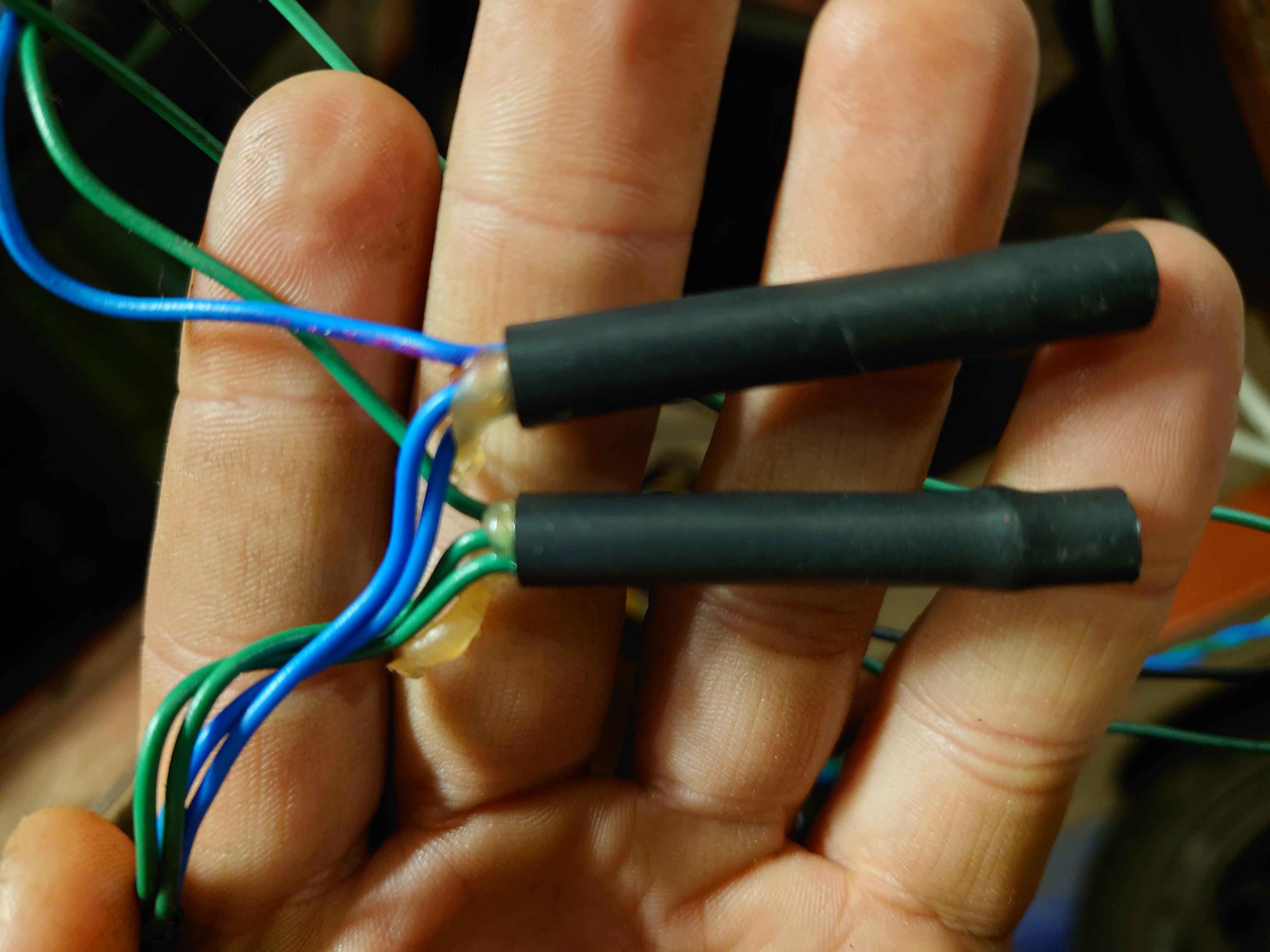

I just posted an update on my project thread: viewtopic.php?p=33241#p33241
and i decided to jump the Nissan Inverter CAN between the headers so i could connect in my ISA shunt that lives in my junction box. I'd be super welcoming of any feedback on this. From what i could gather im 98% sure these are on the same bus.
regarding the USB pins, I don't need these if i plan to just pull the pcb from the enclosure and connect directly, right?

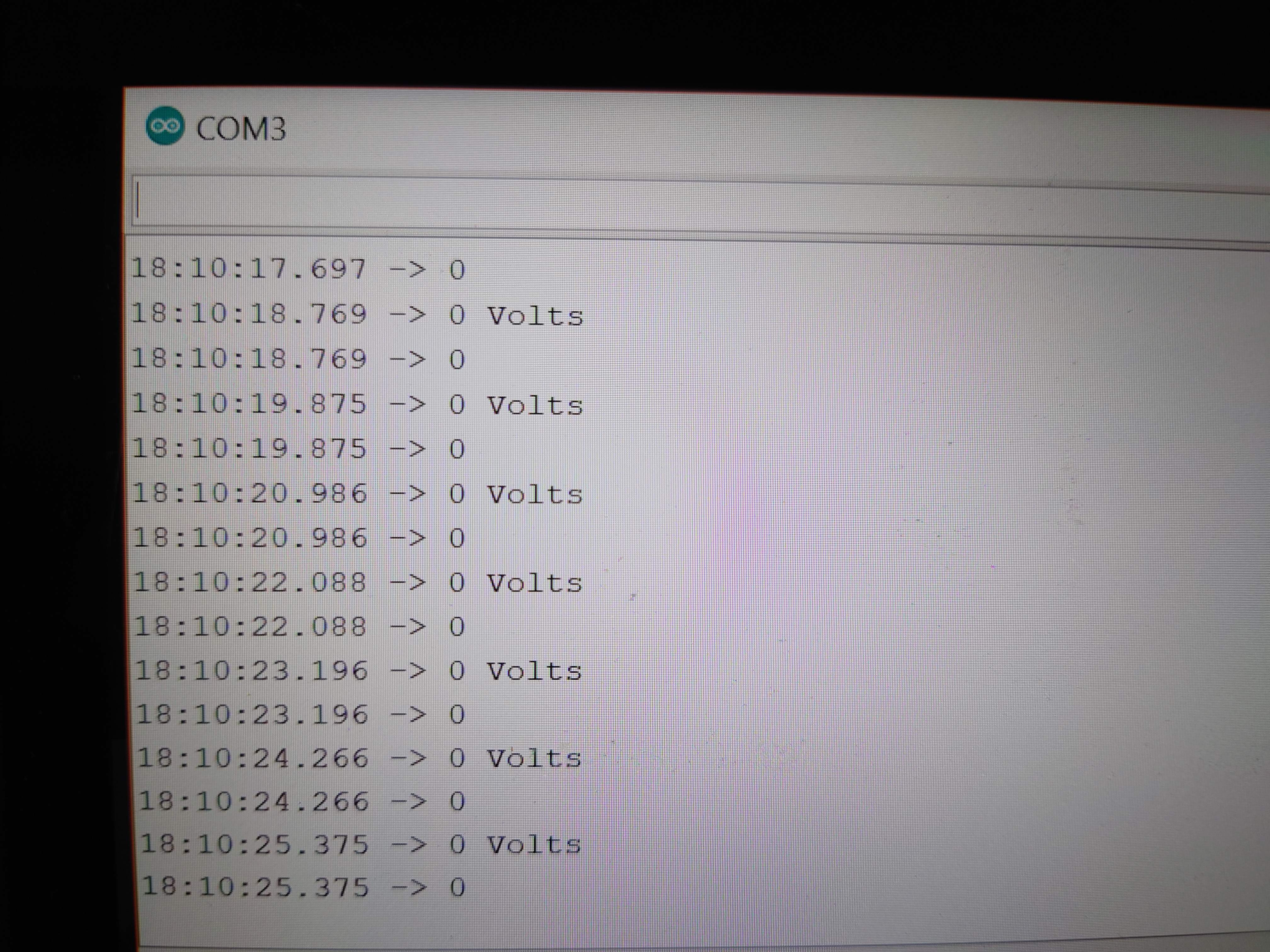

There is a problem with my VCU - inverter CAN.
And I don't know what it is. πŸ˜…
I have HV connected and precharge works, but I only get reading of 0 Volts on serial USB. Even If i disconnect the can connector, it shows that, so I think something is wrong with the Leaf CAN.
Any ideas? I have the original Leaf wiring that I just Hacked the CAN from VCU to its twisted pair green and blue wires.
Edit: Measured harness,
When connected to VCU, CAN H/L has resistance of 120ohms.
When not or only inverter connected, it doesn't have any resistance at all.
The Cables I just measured intact.
Inverter plug gets +12v on green and light green.
GND on black
And CAN on the twisted pair.
What is the purpose of these? Just doubles the CAN bus wires?
What am I missing?
I only have 170Volts now, but shouldn't it still give some error or something other than 0V measured?

It spins !
Reading 200V @ HV system, +12V from old ATX power supply.
I was looking for another 120R resistor, when I thought I'd read the thread once more..
- The problem I had was that I had printed out a drawing by cookie that has CAN H / L flipped and just connected my inverter like in this picture: NOTE download/file.php?id=3185&mode=view
- I also thank Fiachra for posting picture of the connector and a right CAN H/L schematic in this message where I saw the CAN bus colors flipped.

I should have suggested checking the voltages of the CAN wires as CAN Lo is a lower voltage than CAN Hi
Re: Leaf Gen 1 Inverter Board
Posted: Tue Oct 11, 2022 7:53 pm
by JaniK
Alibro wrote: ↑Tue Oct 11, 2022 5:40 pm Well done mate, good to see it spinning.
Agreed, Cookie's photos are great. :)
Yeah that would have revealed the error. I was allready feeling unlucky that something is broken, but it was just user error and now it spins, so I got a smug look on my face all day 😁
